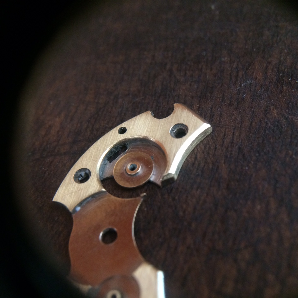

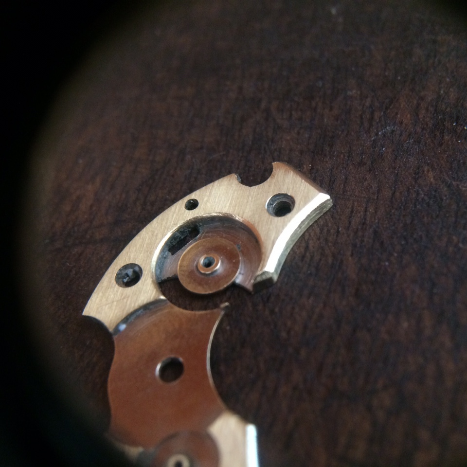

If you ask me, I would make limited watches (max 10) with custom made case and dial. Powered with reliable swiss movement but heavily decorated. Few years ago, took apart old russian Molnija movement and made beveled edges (anglage) using cheap needle files. It took a while but it looked good. Too bad I didn't finished it and left it somewhere in the box. Maybe I should try to do this again but this time with Unitas 6498. Just to cure this covid depression 😁
Here is a photo Molnija bridge with "fat" beveling.
