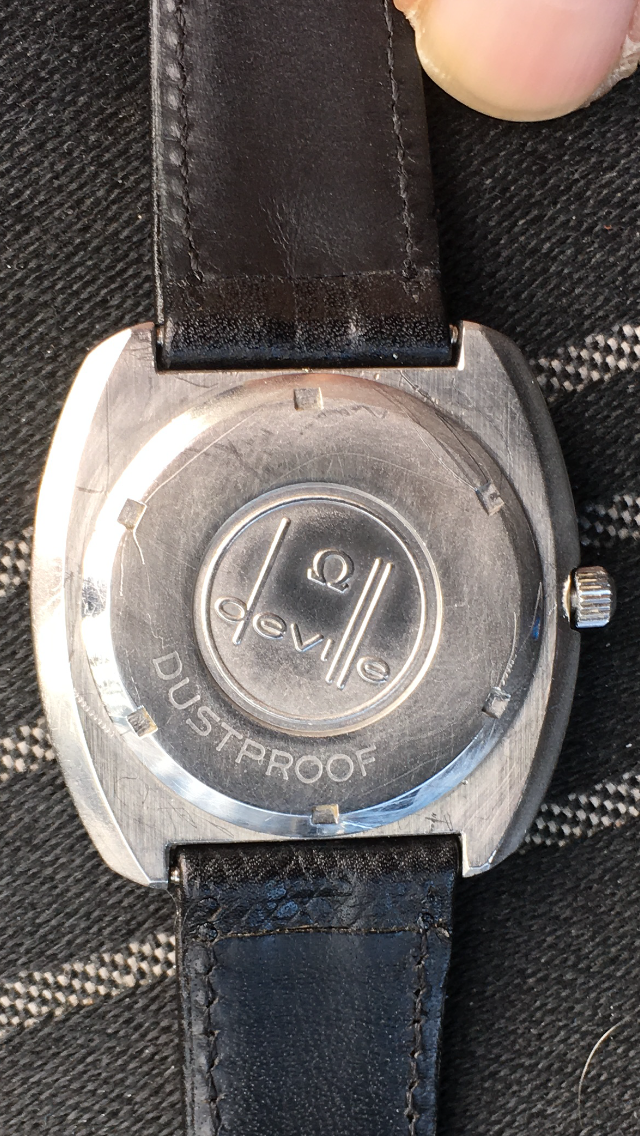

Borrowed this pic from man_on_moonwatch here on OF.
How many meters of dust is this one certified to manage? And at what pressure? Can one swim in dust with it?
