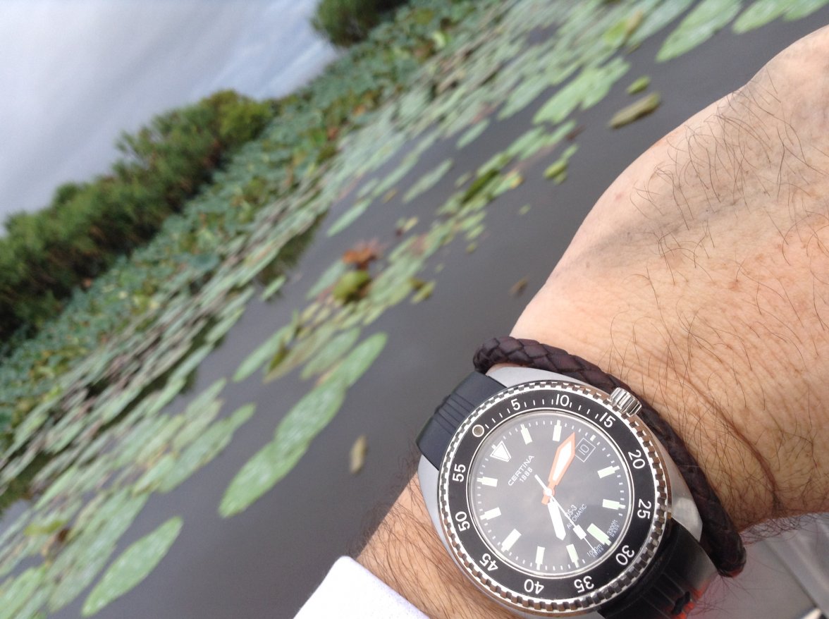

I have a Certina DS-3 that most examples had original hands changed as soon as they were bought. Hard to find one with original hands
