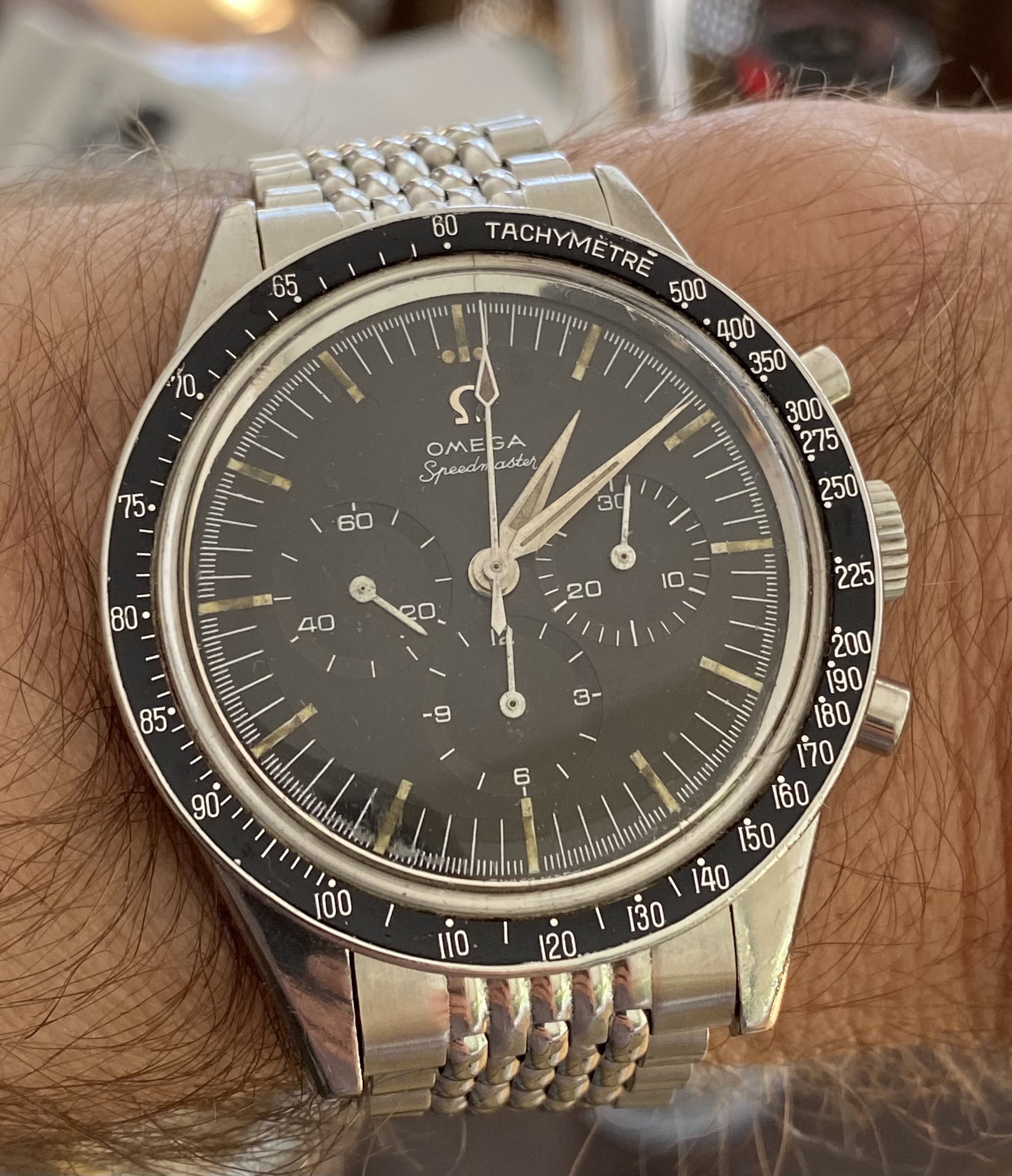

Hi All,
Could you please give me your POV on this 105.002 that a French watch community member proposed me yesterday?
Mov. is 19.83m (no picture, EoA pending), small pushers, silver tension ring, Swiss made dial.
Claimed by the owner as fully original.
Here are all the pictures I have received so far :
Cheers from sunny France.

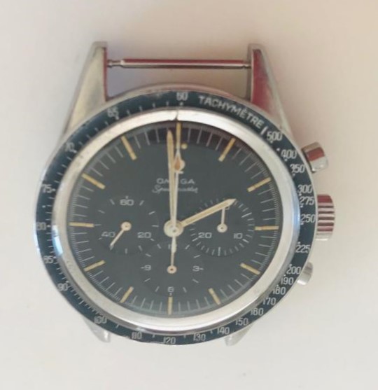

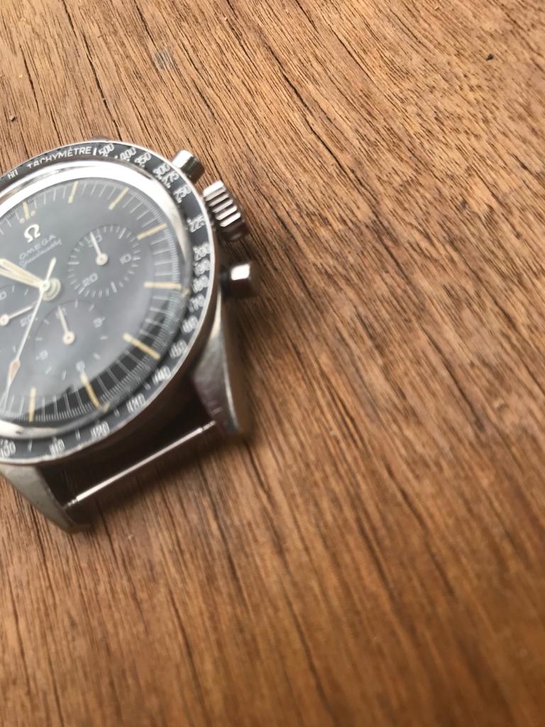

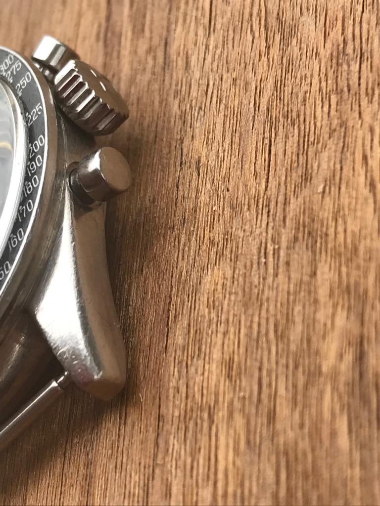

Maybe I'm wrong but those pushers look like 003 pushers.
I'll measure them once in hands. 😉
1,072
1,482
I would want some much better dial shots.
1,583
10,359
Looks like polished until death
Looks like he should learn how to make pics with a phone... not even 1 correct ! 😲

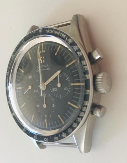

the style of the watch looks great, hopefully you can get some better pictures
140
168
The seller seems to have an old smartphone. I am trying to get better pictures.

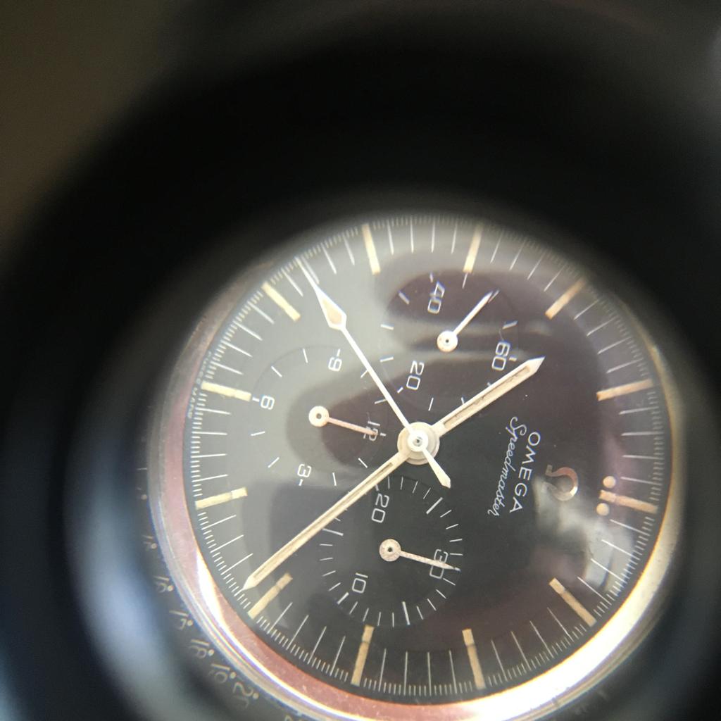

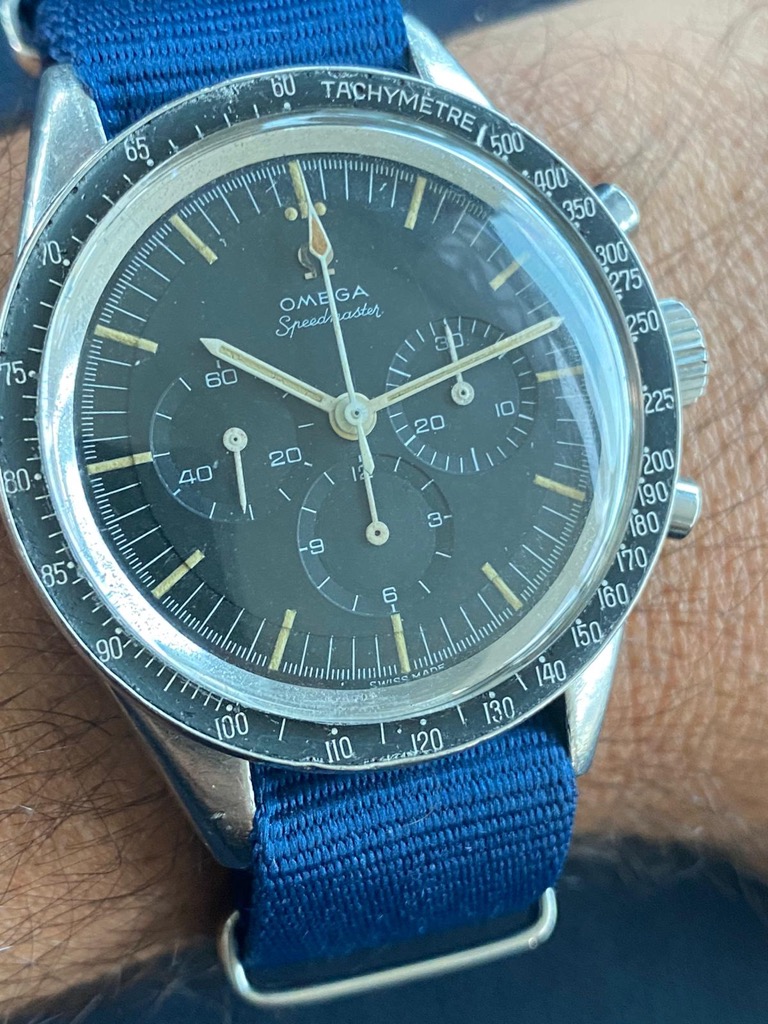

Here is the dial I got today.
140
168
My concern is how polished the lugs are.
So here are some (bad) additional pictures I got today.
But is is a 60 yo watch so it looks kinda normal to have polished/used lugs.

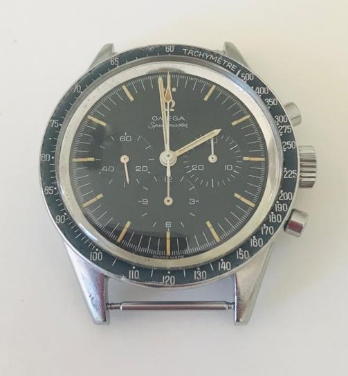

I would be concerned about the hands.
Movements south of 20mm normally sport alpha hands.
North of 20mm have the batons.
edit: MWO confirms this.
140
168
Thanks you Geminis.
Is this a sharp turn at 20m or is it approx 20m as 19.83m is not that far ?
Finding some Alpha hands might be a challenge (and cost !).

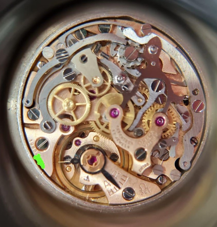

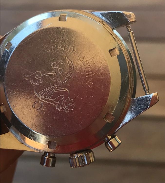

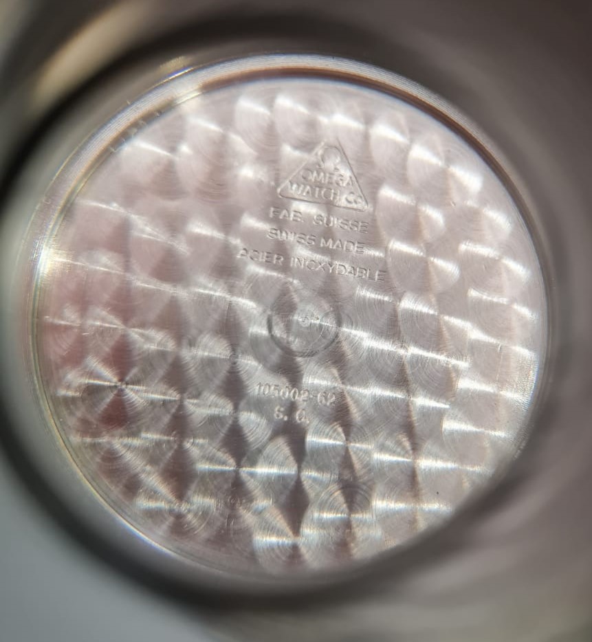

A bunch of petty observations.
1 - movement is pretty nice considering how polished the case is and how worn the bezel is. Maybe nothing, but…
2 - the pebbling on the caseback makes me wonder what the hell did that and why it doesn’t appear anywhere else.
3 - those hands were repainted and relumed, apart from being wrong for the serial number, and the work is such to make me question what else might have been so imperfectly ‘restored’, like…
4 -… I wonder what that dial really looks like. I’d want to examine the dial’s lume in hand, with a loupe to allay any suspicions
5 - based on the circle on the caseback inside, the watch does not have a period correct inner cover. Not hard to correct, but another little warning sign.
6 - I’m not as picky about cases as some others here, but even I feel badly for how soft the case is.
I’m not comfortable with the watch. Of course, if I wanted (another) one and it was cheap enough…
P. S. I waited a few years before I got lucky and found correct hands for mine. Very expensive and very tricky to be sure before you’ve committed funds. Some people try to modify modern hands to fool the unwary.

Thank you for this extensive feedback.
Owner said movement got overhauled in 2019 by an independent watchmaker. That might explain why it looks so clean vs. case/bezel.
I also questioned about the condition of the caseback. The only answer I got was " I bought it like this".
Now I can see some extra materials on hands that I did not pay attention to before which indicates that some rework has been done in the past on these hands.
Nice catch on the circle in the inside of the caseback. I'll bring this up with the seller.

Like other vintage Omegas, the movement numbers for the 105.002-62 were issued in batches. The baton handed examples normally are seen in the group of 2052xxxx.
140
168
Thanks for confirming. Has this always been the case for all Omegas ? (as we can see from MWO batches infos).
So Alpha hands should be in place here...🤔
