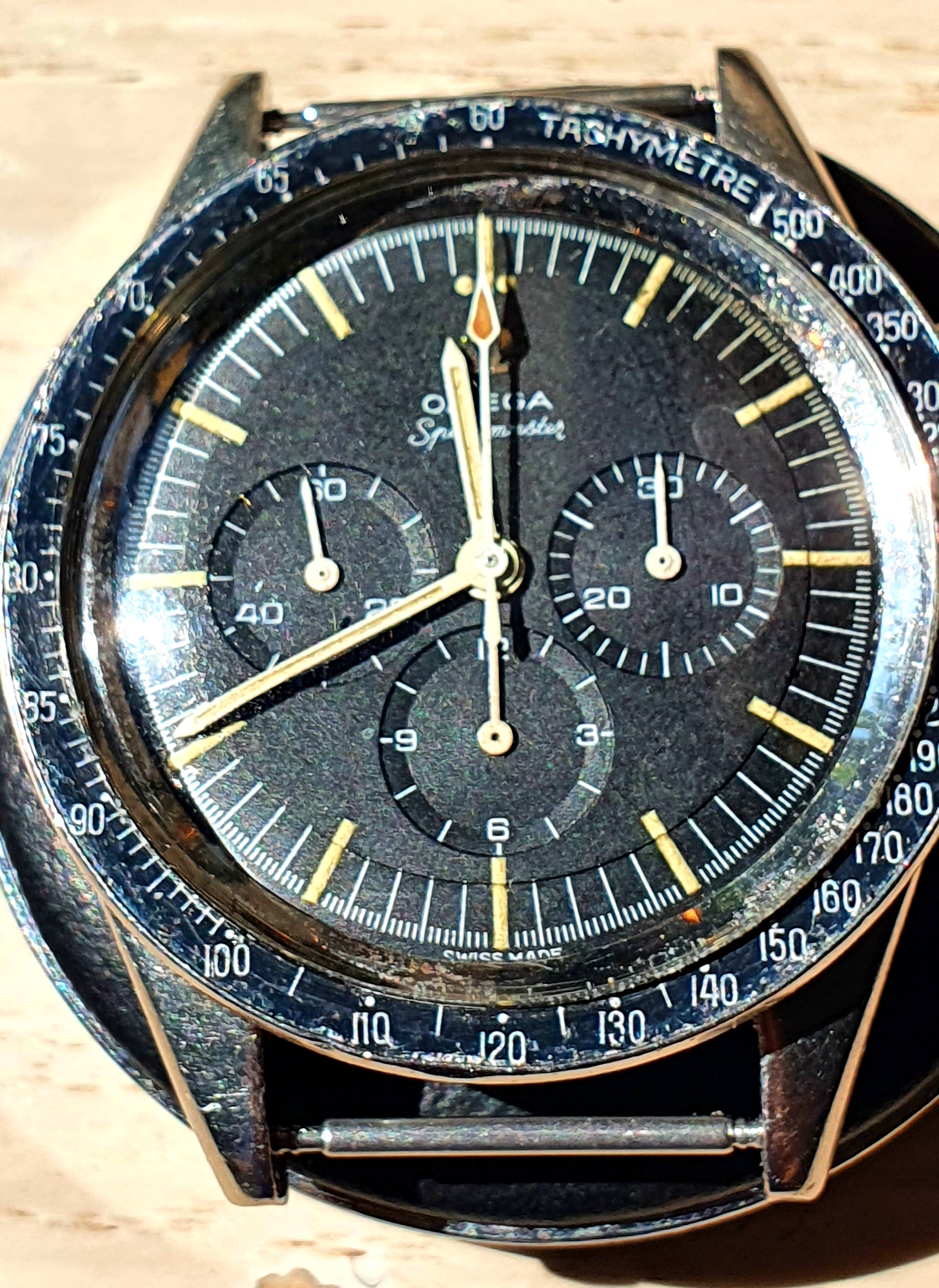

Any thoughts on this 105.002
140
168
Personally I would have to stretch to put this as Good.
remember also chart is reflective not predictive, nor proscriptive, and that prices for this kind of watch are open to debate.
when a watch falls out of Very Good, it’s often got more than one minor originality queries as well as potentially serious “attraction” issues.
so we step away from box ticking for correctness and originality, and the value becomes dependent on how attractive it is. Often a large part of the attraction will be how cheap it is.
a fine 105002 might easily sell for $30,000 or more with provenance and accessories. So one with a few problems for $8,000 might be fun. It’s that middle ground price, 15k, which is getting harder and harder to justify, without something to make you look twice.
this watch, being sold on these photos, does not deserve a risky price - that means it’s about double what many here might want to offer, given the risk.
of course those who favour condition above all else will rightly dismiss it as not worth considering.
I am not sure the seller is ready to significantly drop the price thanks to all the feedbacks I got here. Main concern is the wrong (relumed) hands in place.

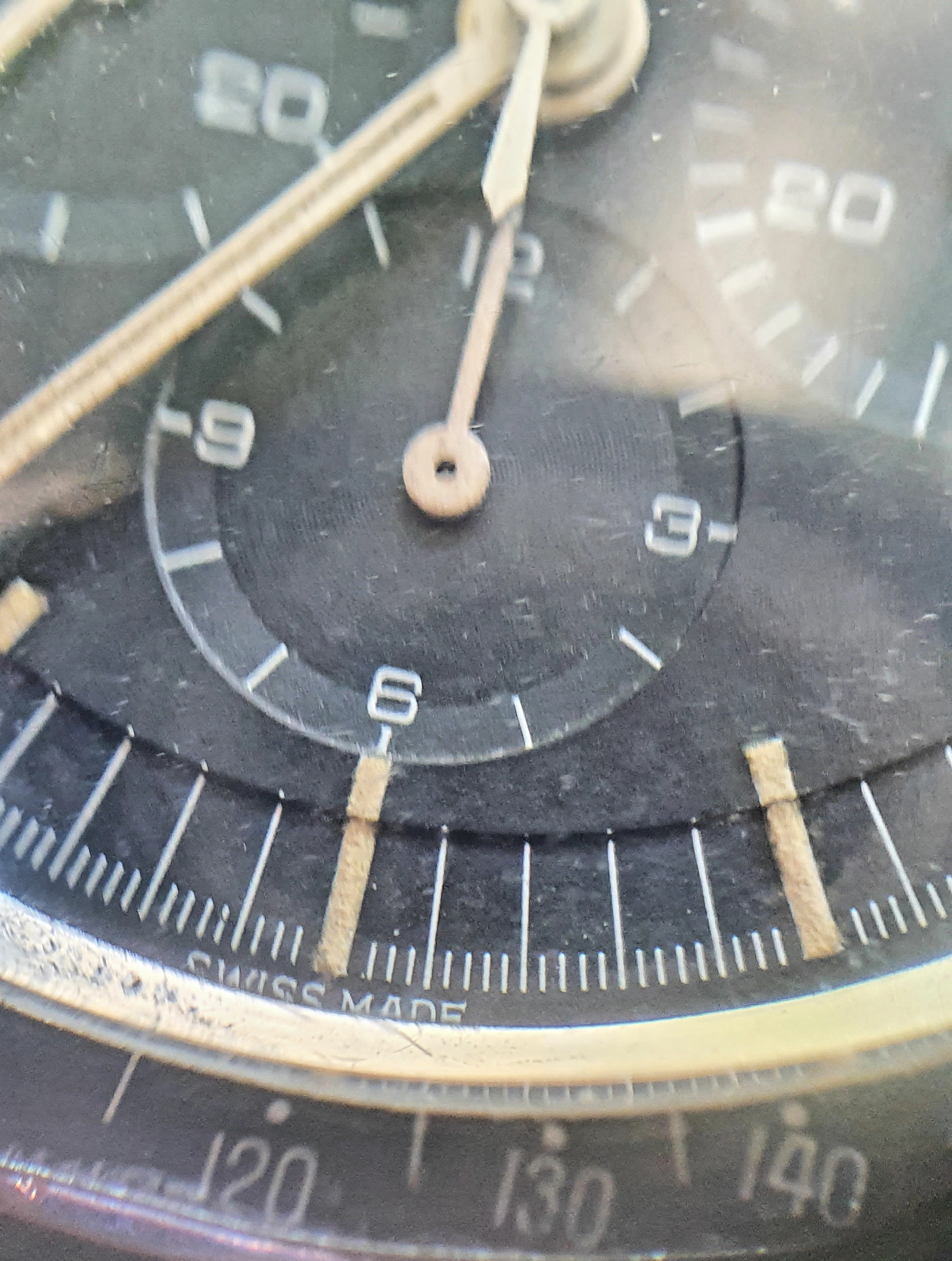

Old. Ask the seller to move ALL hands away from 12 to the 3 /9 position. And take a sharp picture .......kind regards. Achim
Another high time ticket item camouflaged behind very poor pictures. I can take sharp scans with a 12 year old iPhone. One has to wonder how can a seller achieve such poor pictures?
140
168

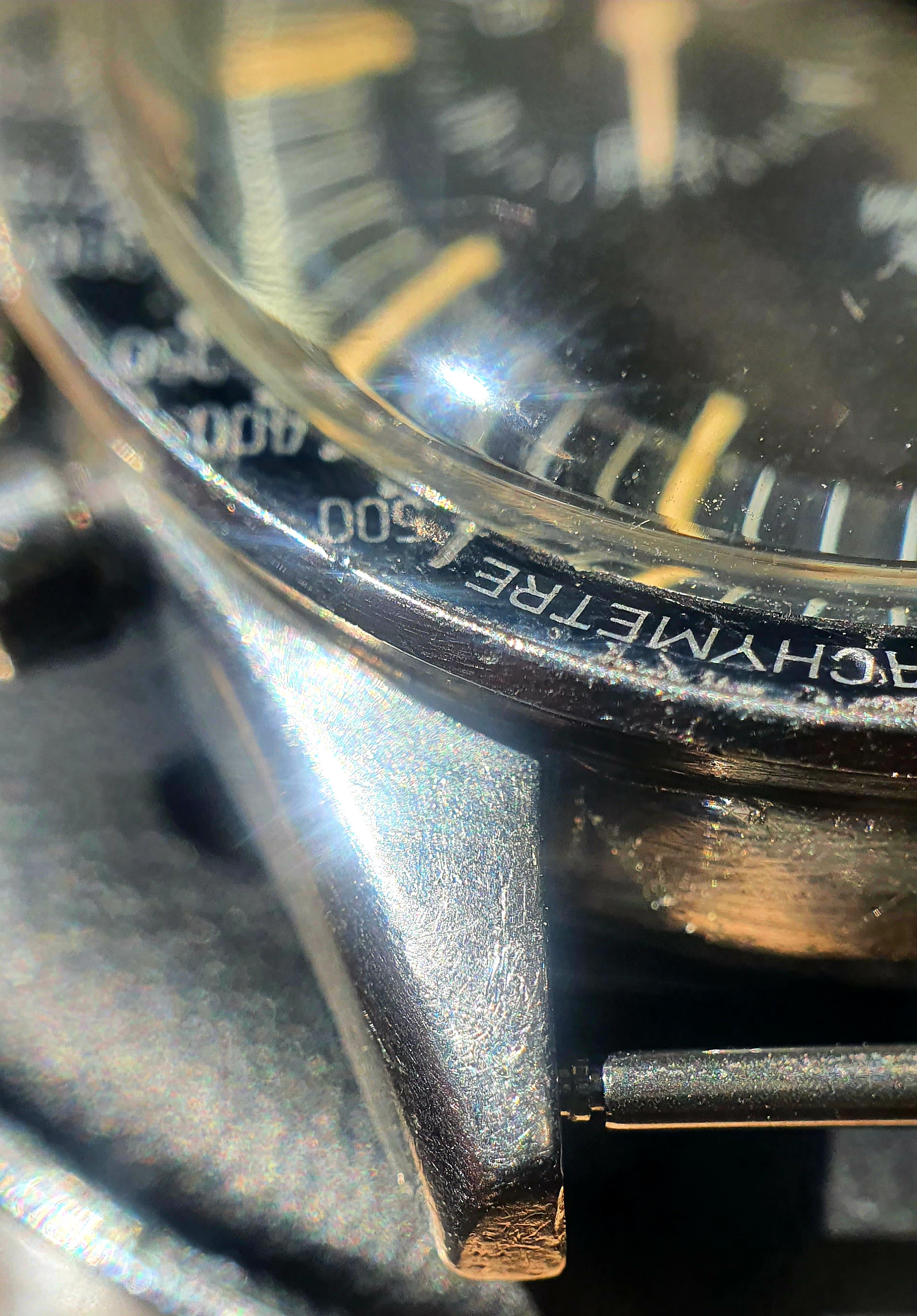

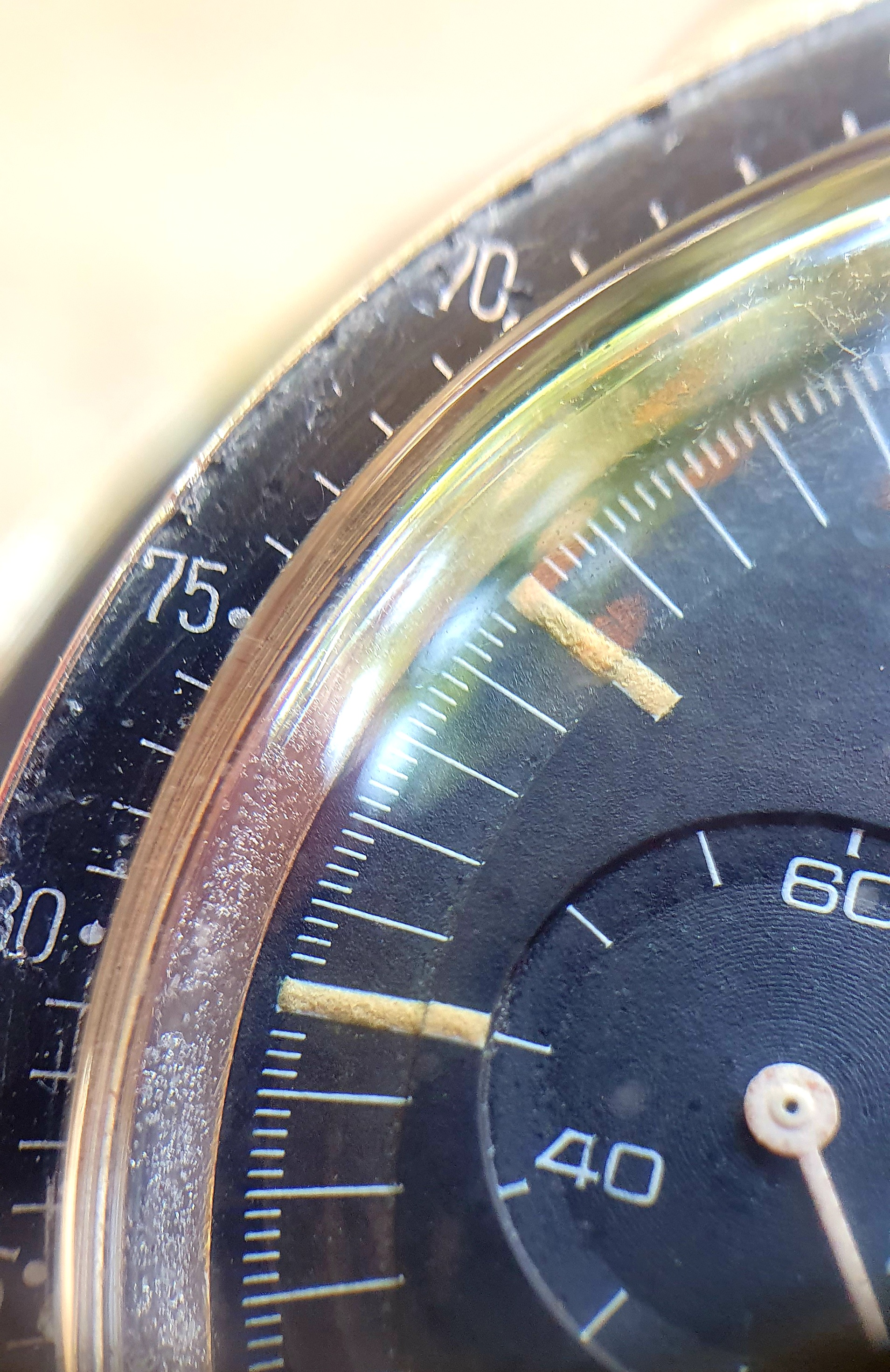

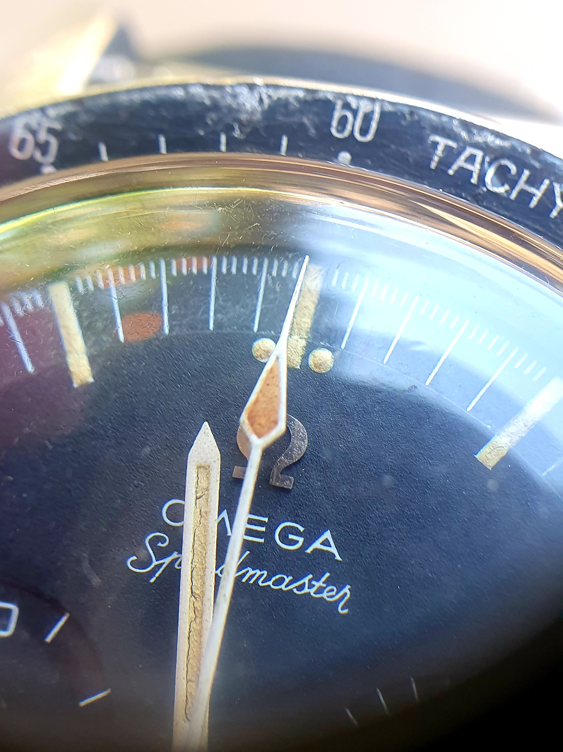

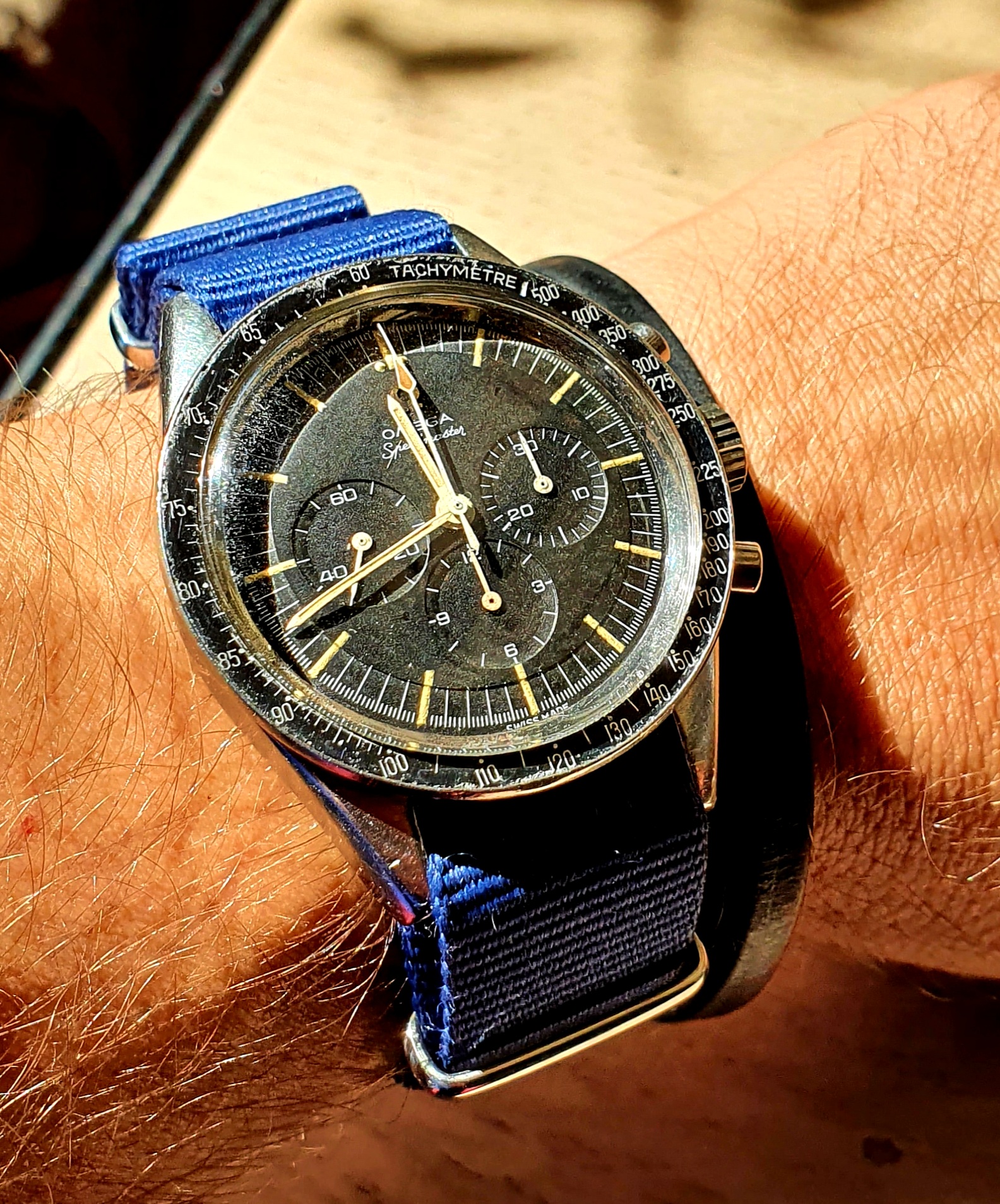

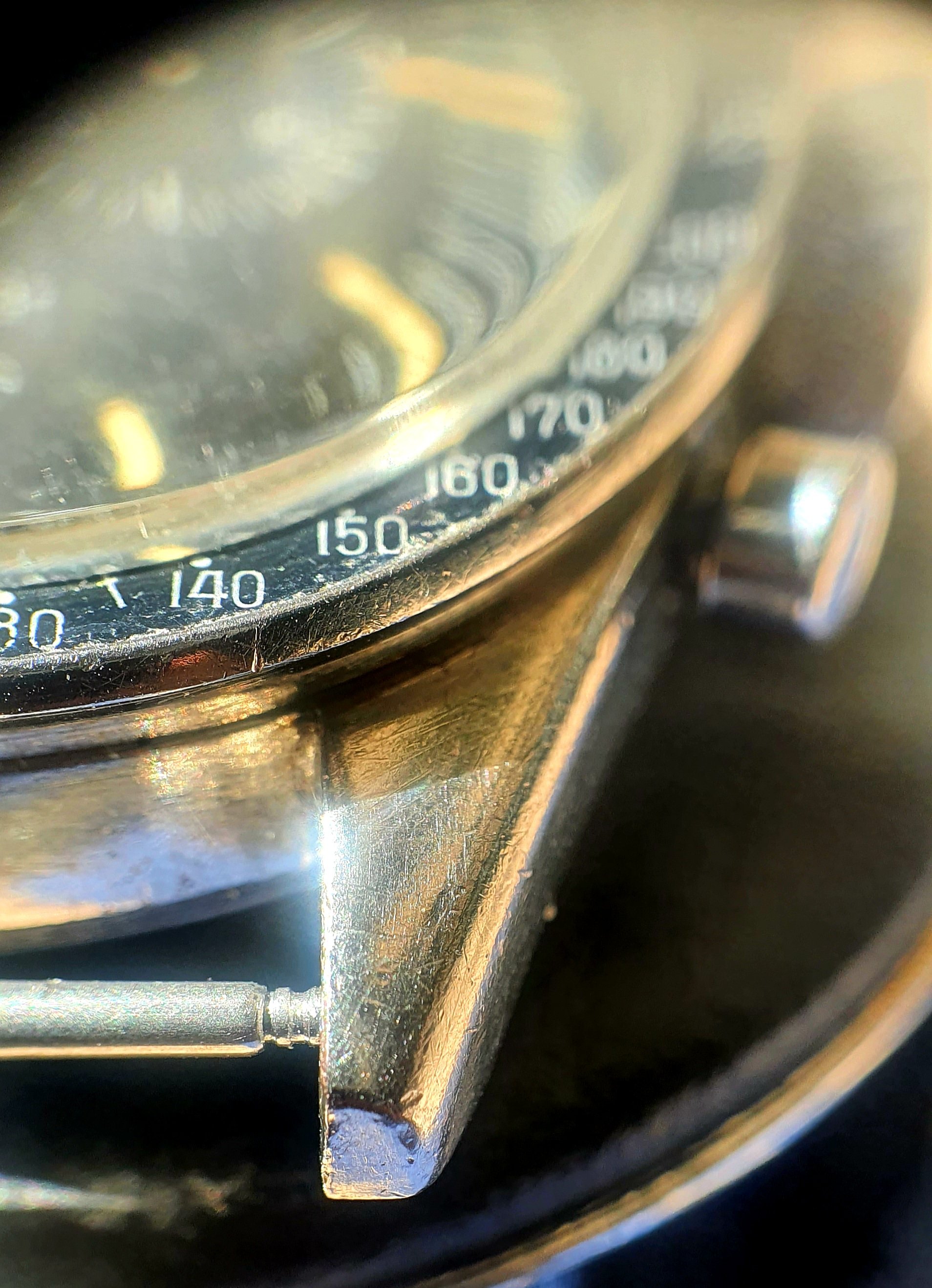

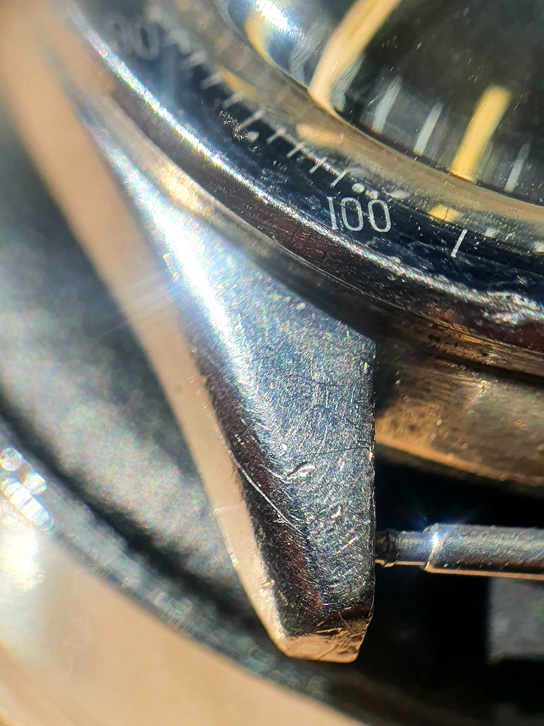

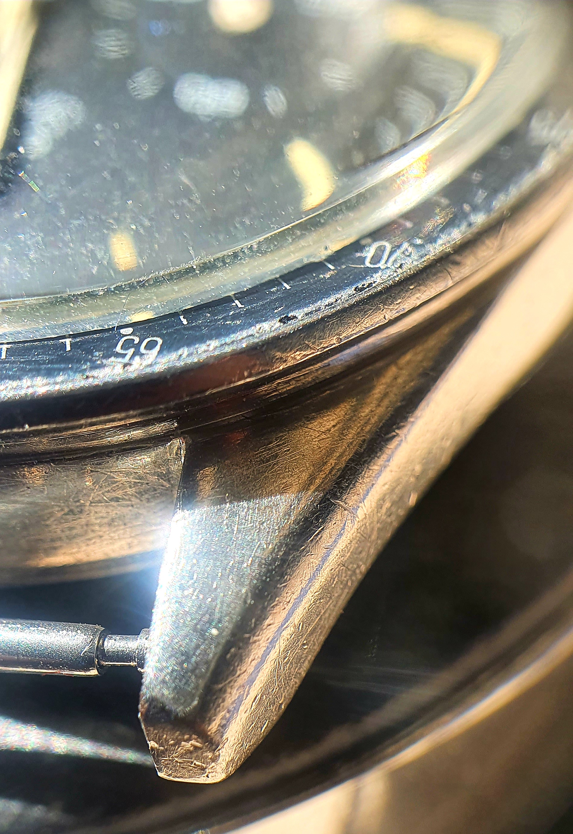

Here are extra pictures of the watch I finally had in hand. Dial is nice. Bezel is ok as well. Second chrono hand is relumed.

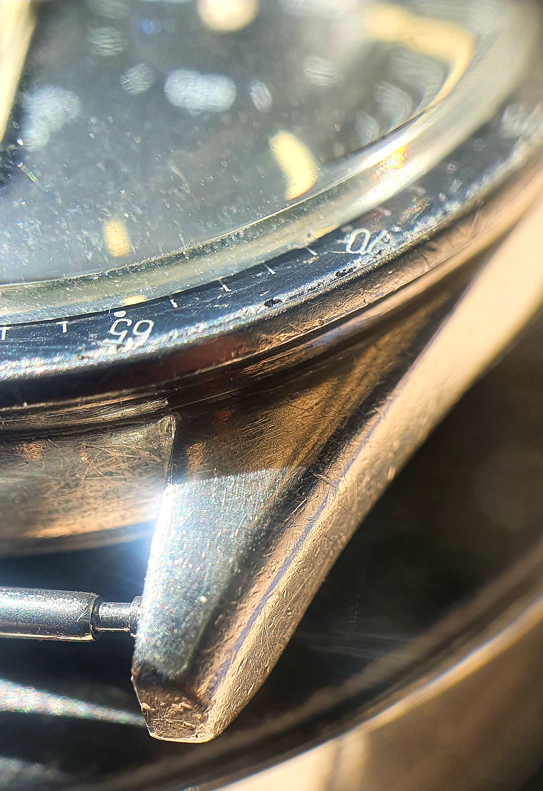

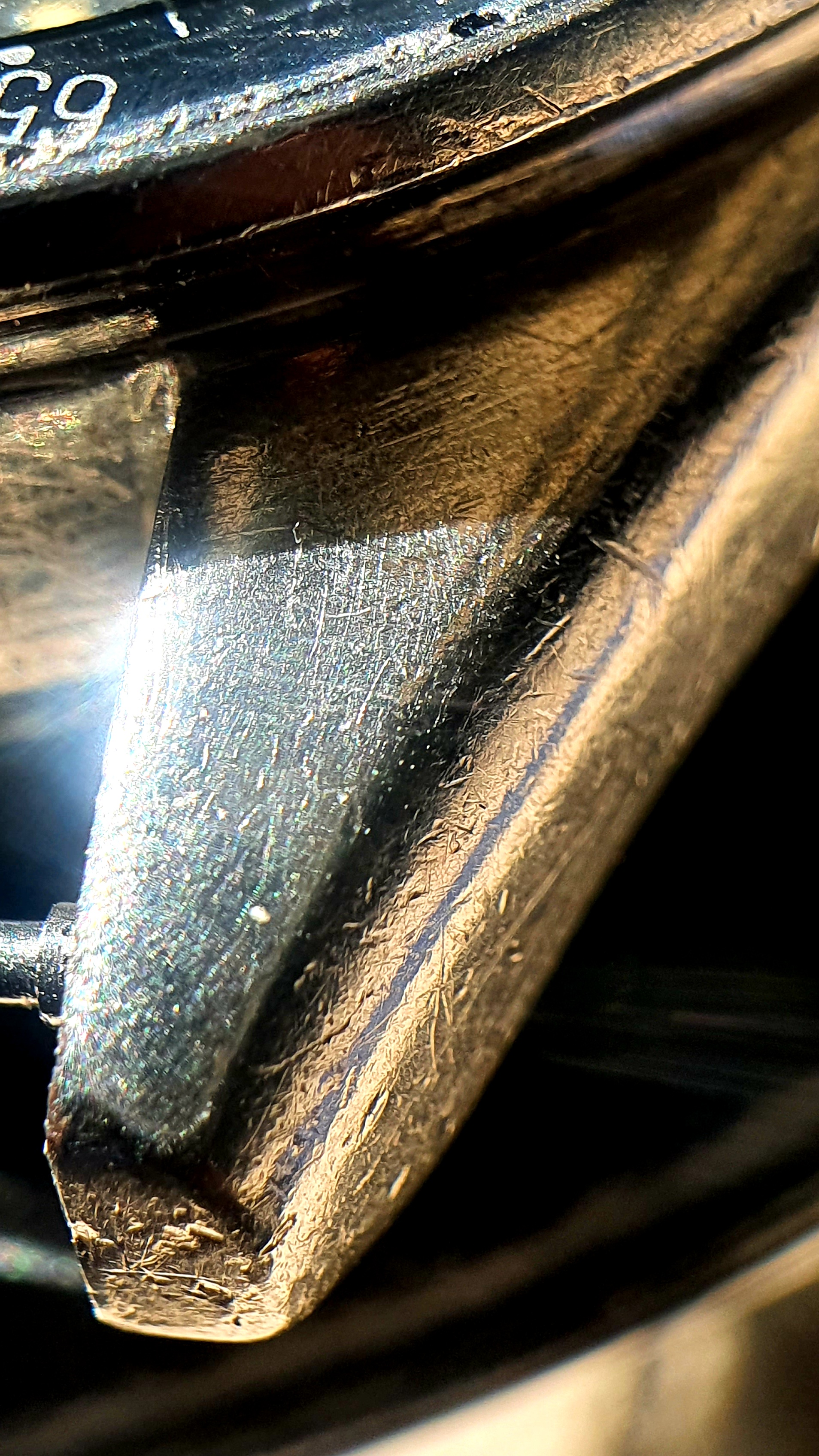

Lugs edges are more than soft...my cousin who is jeweller does not even want to refresh the case a bit because of its condition...
101
356
Looks like polished until death
It's a crime what people do to cases. I'd rather have an original case with lots of nicks and scratches than refinished case.
