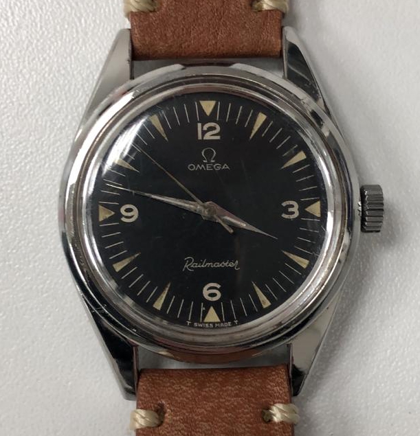

Posts 98 Likes 65 Marcello130 ·Apr 19, 2021 Hey Folks, I am considering purchasing this Railmaster. Only have these two pics. It looks to me like the dial could be slightly misplaced. What do you think of this example? Any further comments from the experts? Many thanks for your help! All the best Marcel
Posts 5,861 Likes 16,802 gemini4 ·Apr 19, 2021·Hoarder Of Speed et alia Perhaps there’s a reason the pics are so unclear. Need reference number, caliber, movement number. To me, second hand is incorrect with BA hands. TT dial could be an early service replacement dial. Edited: Apr 19, 2021
Posts 5,727 Likes 9,513 watchyouwant ·Apr 19, 2021 Looks like a reprinted dial to me with these pictures. Can't see luminous wells in these pics. If there are , TSwissT will be a later dial.

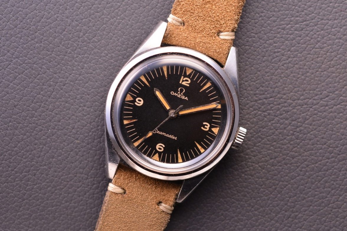

Posts 5,861 Likes 16,802 gemini4 ·Apr 19, 2021·Hoarder Of Speed et alia I’ve seen a few TT Railmaster dials. Even a PAF Seamster TT. I think they are early 1960’s and legit Omega but not necessary original to the watch.
Posts 98 Likes 65 Marcello130 ·Apr 20, 2021 Thanks for you replies! Ref of the watch is 2914-2 with an additional serial number of 16852983, indicated cal is 284. Does that give additional insight ?
Posts 5,861 Likes 16,802 gemini4 ·Apr 21, 2021·Hoarder Of Speed et alia To me, the caliber is correct but the movement number is more indicative of a later RM.
Posts 98 Likes 65 Marcello130 ·Apr 21, 2021 Thanks guys .. ! so I don’t hear ab ultimate „hands off“ advice from you, that’s what I get so far?
