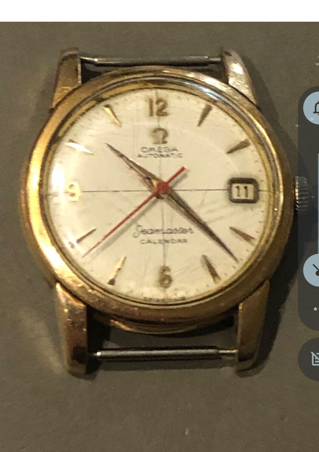

Hello everyone. Any opinions on this seamaster

Can you post an in-focus photo so we can check the dial.

It's very hard to tell you anything with this poor of a photo. It would be helpful if you could post in focus photos of the watch taken in natural daylight from all angles (front, back and sides). If you can get photos of the inside of the case back and the movement too, even better. Just based on this one photo, the watch looks fairly well worn to me, but it might clean up nicely. Most of the value of any vintage watch is the dial. If all of those marks are on the crystal, you might have a nice example here. If the marks are on the dial, then you can very likely find a much better example with a little patience. This isn't an uncommon reference.

A lot depends on price as well...

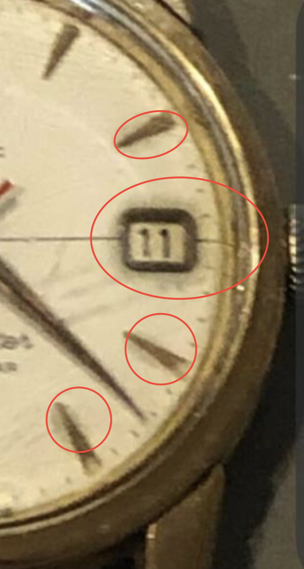

I’d be surprised if those dark marks around the date window and the adjacent indices were on the plexi tbh…

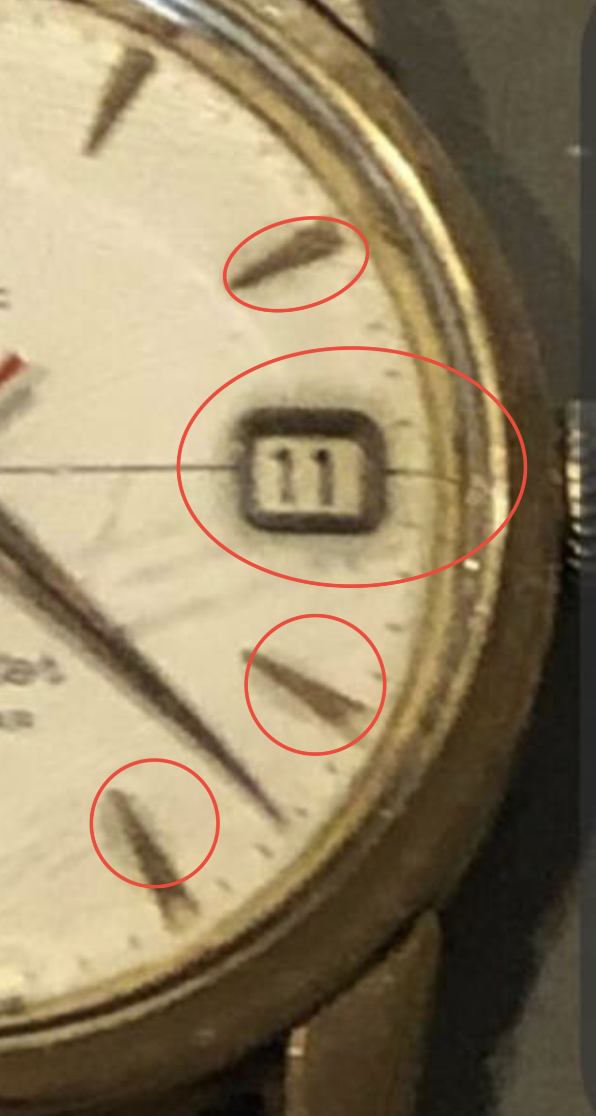

I’m inclined to agree.

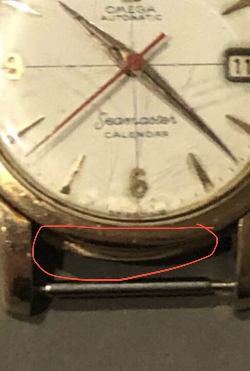

What’s going on with the case back? Is it popped off and resting beneath? I’ve never seen a lip like that before. Looks like I could pry it open with a tree branch.

Thanks everyone. I will post more pictures as soon as I can. I couldn't resist for 200 dollars.
58
36
Hopefully I can find a case back.

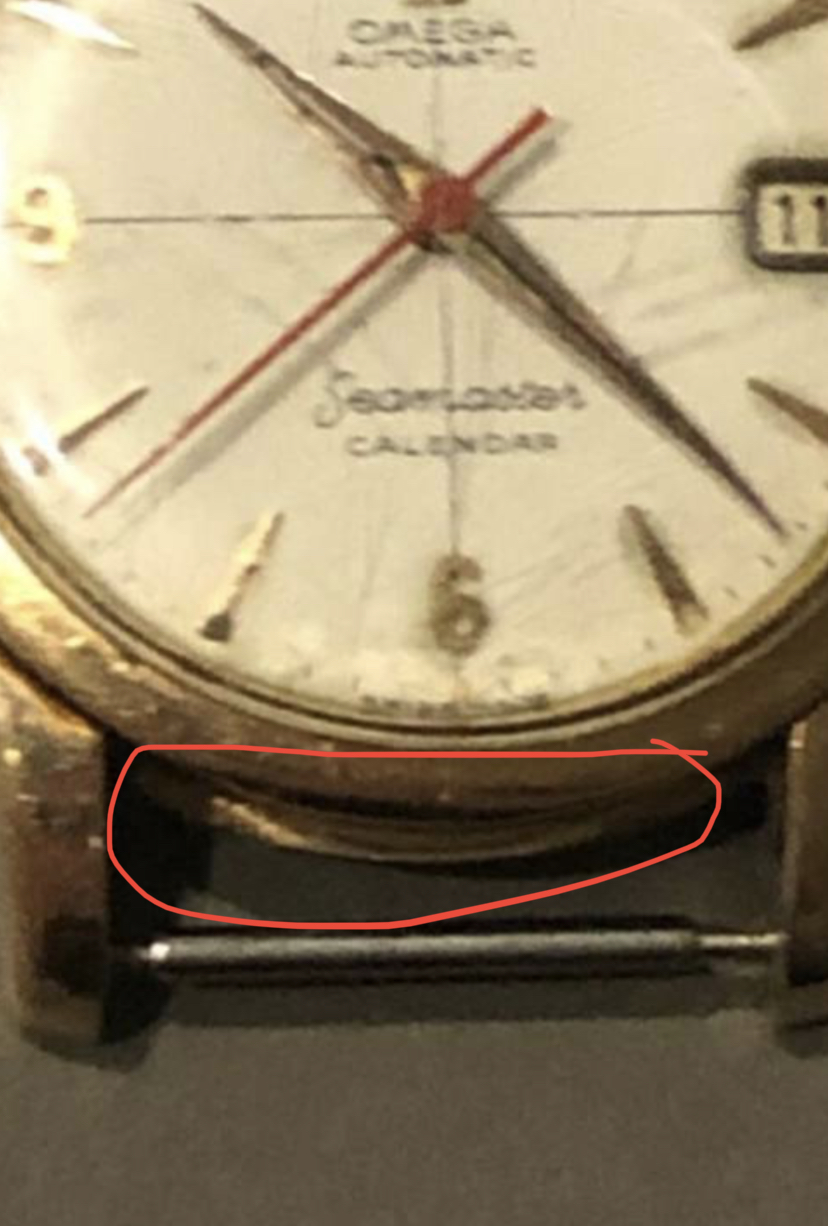

Casebacks are easier to find than case midsections. At least casebacks have identifying numbers 😉
