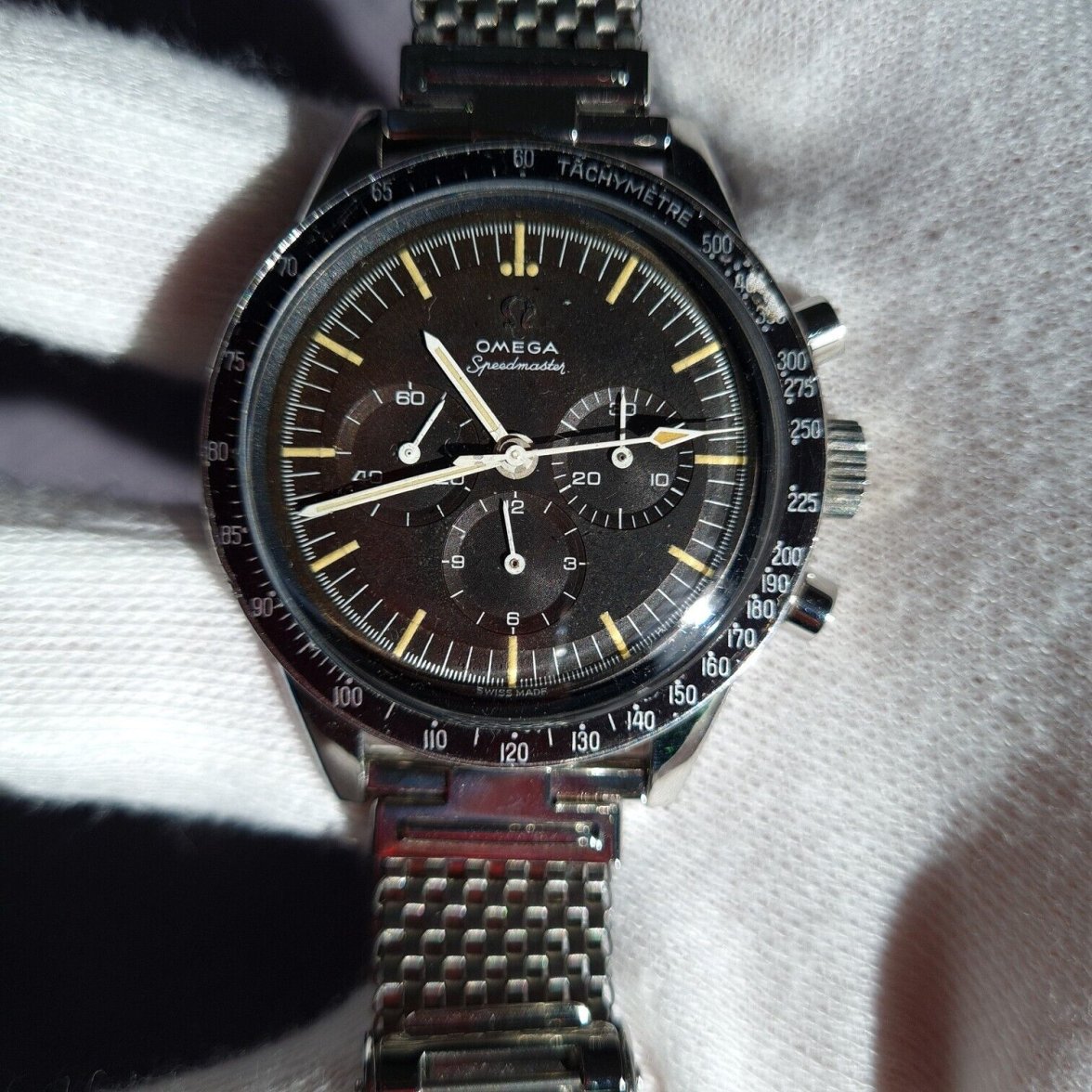

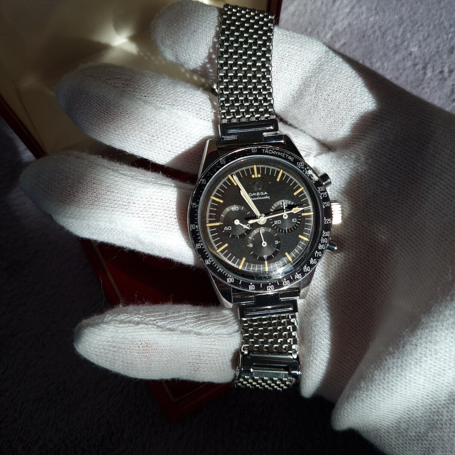

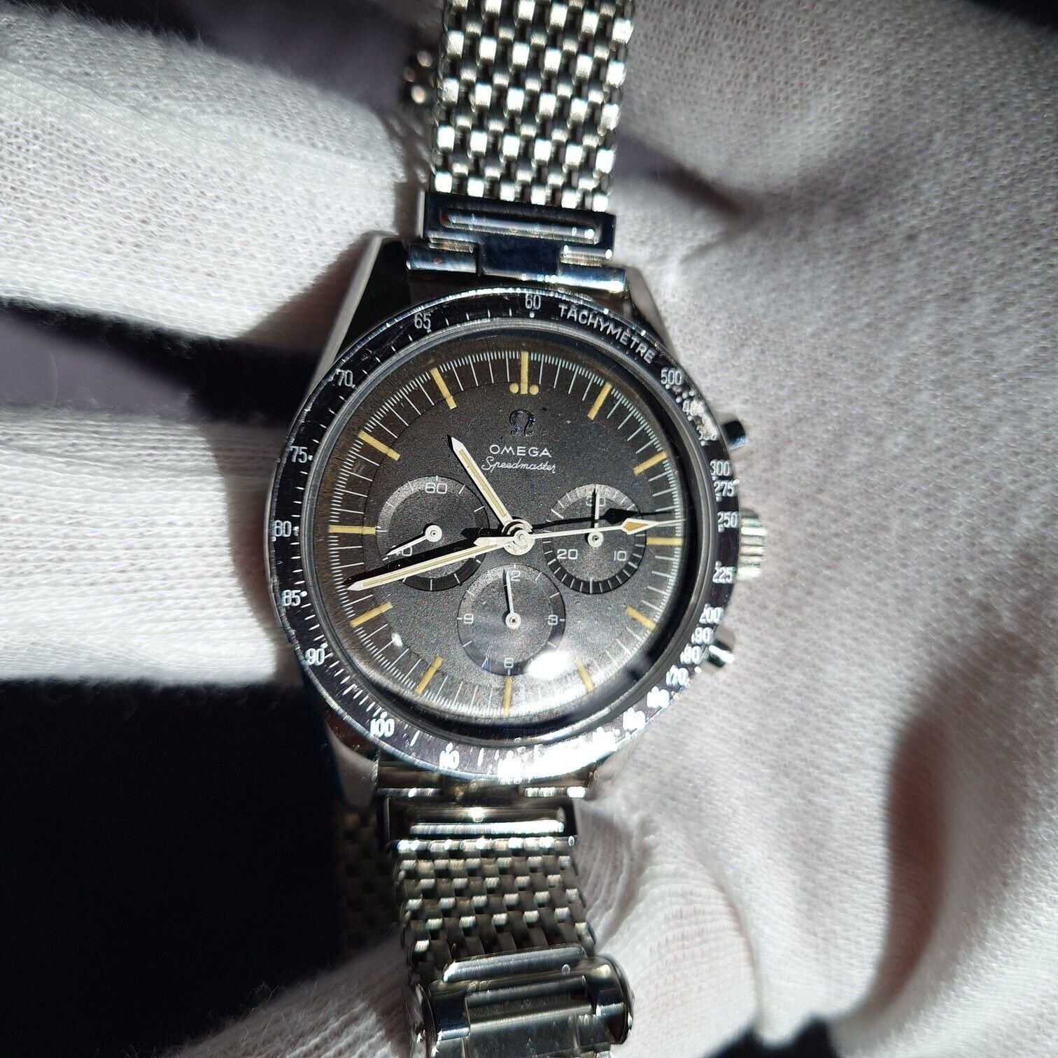

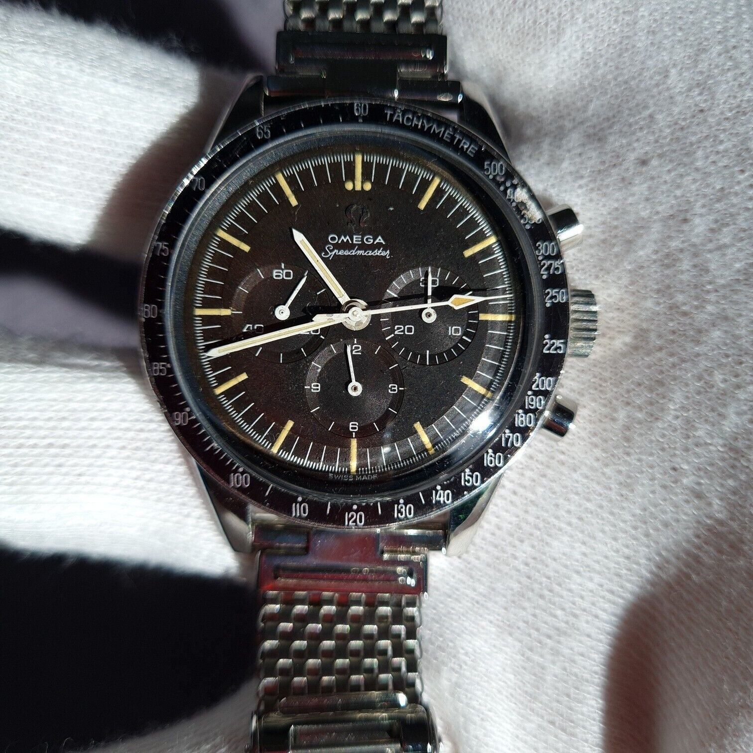

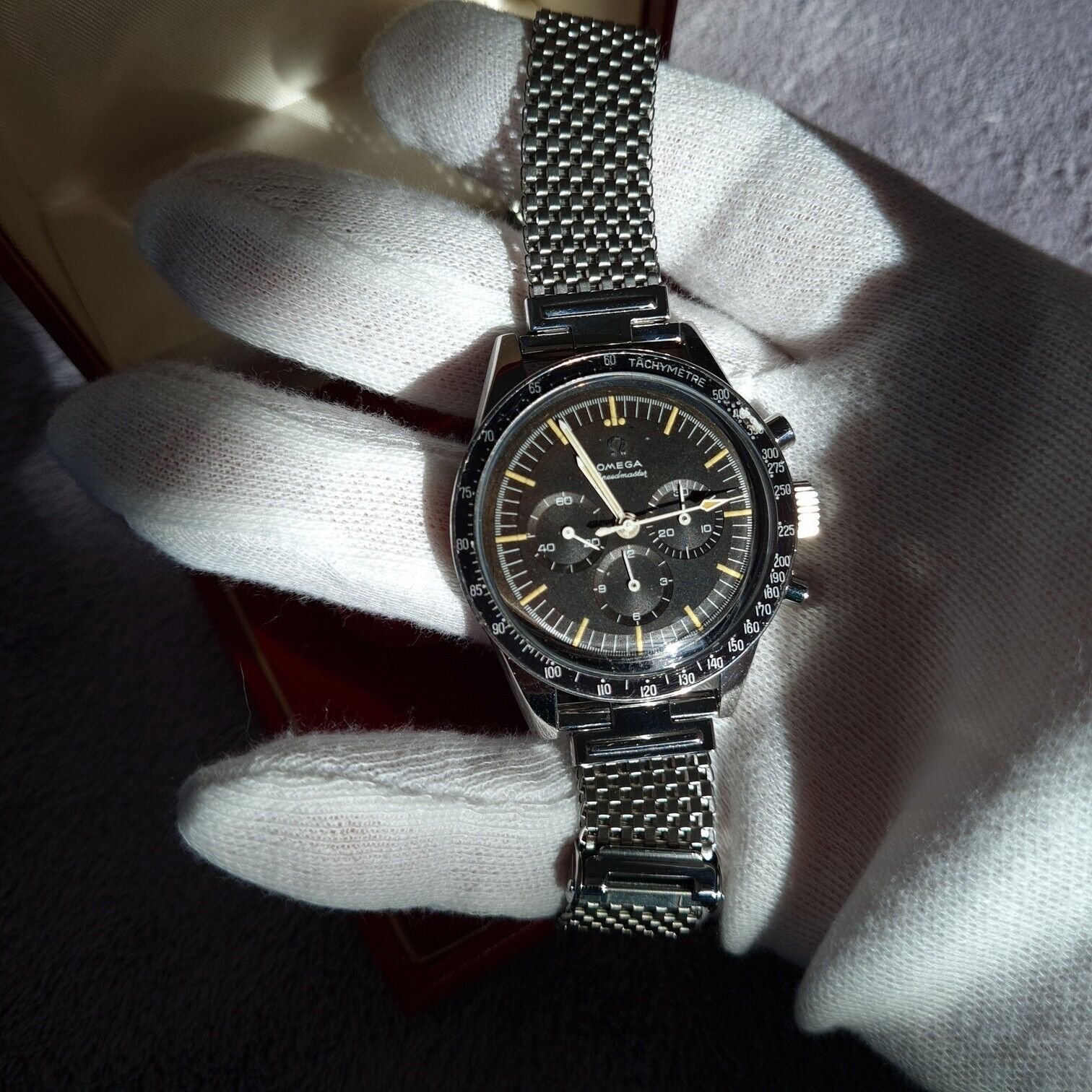

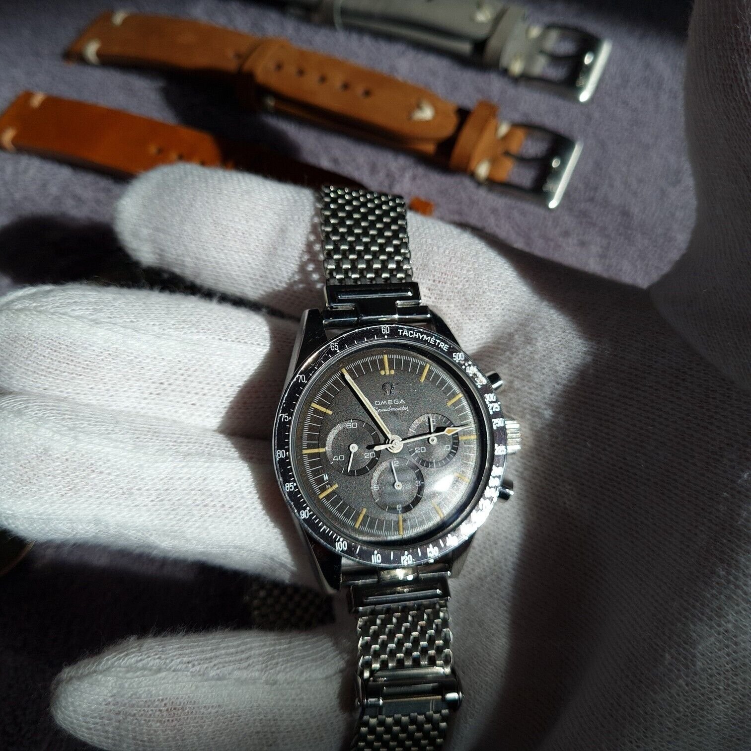

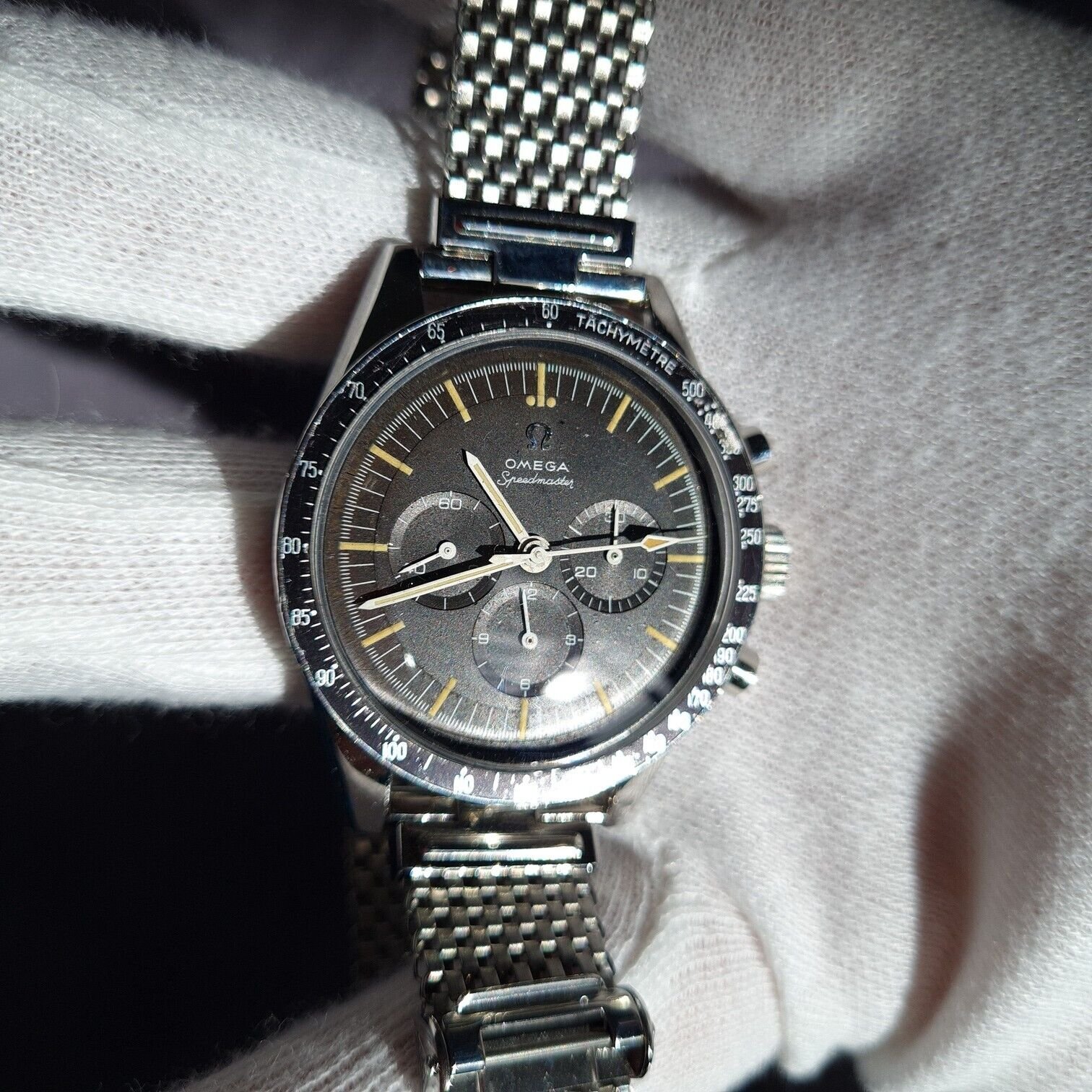

I was following on this watch and never expect it went this high in the end. I believe this is exactly the same watch discussed here(look at the pinch marks at the end of the chrono second hand): https://omegaforums.net/threads/need-advise-dial-105-003-63.154870/
The dial should not be a correct dial for 105.003, am I right? I believe all earlier -63s without T marking should have high SWISS MADE text.
465
461
+1 to this.
The OP is the A5 dial correct for Ref 2998-3 through 105.002. The earliest 105.003 (A6) dial without T is quite rare. Besides the high SWISS MADE, the minute tracks don't exactly reach the step.
