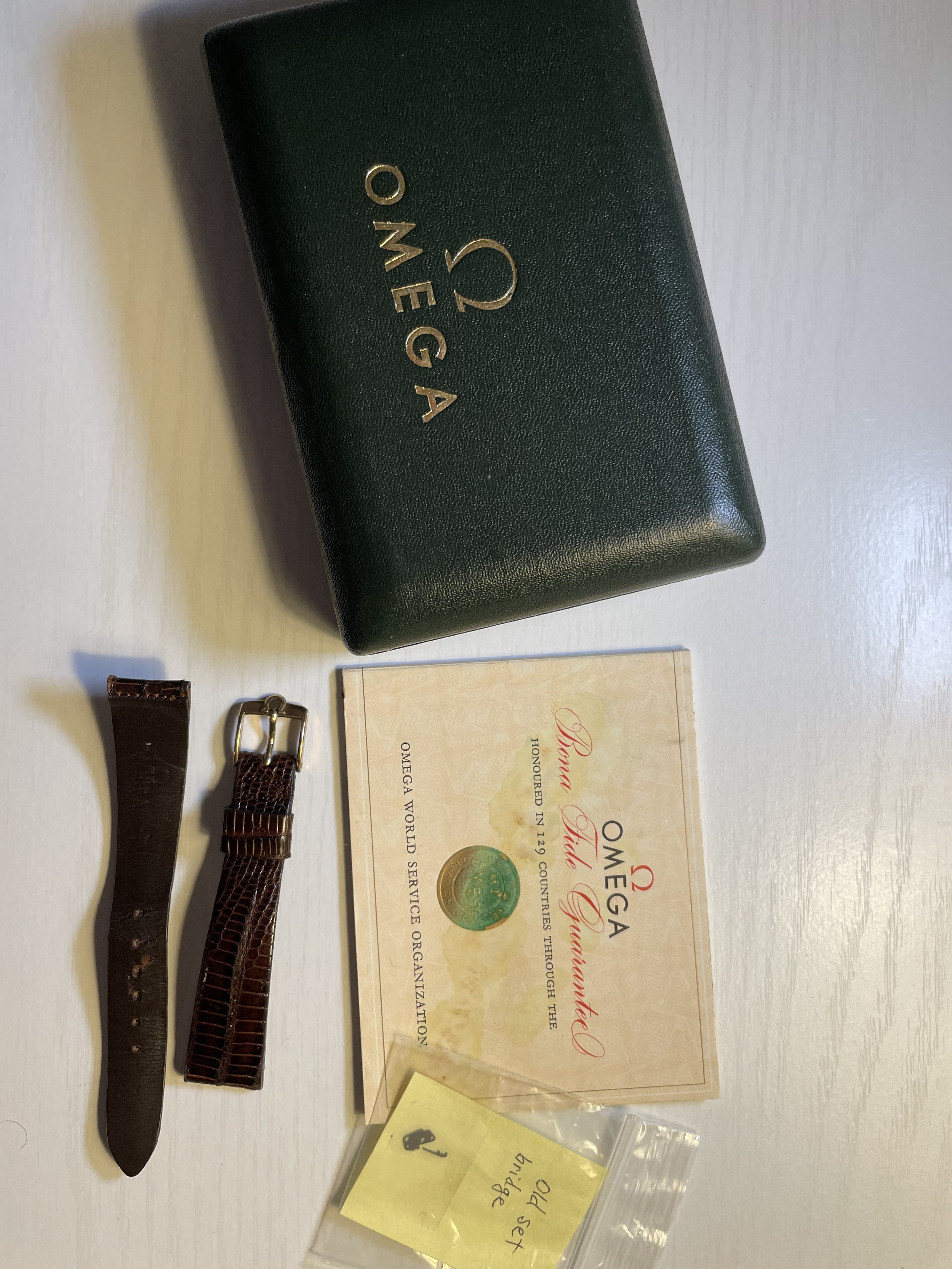

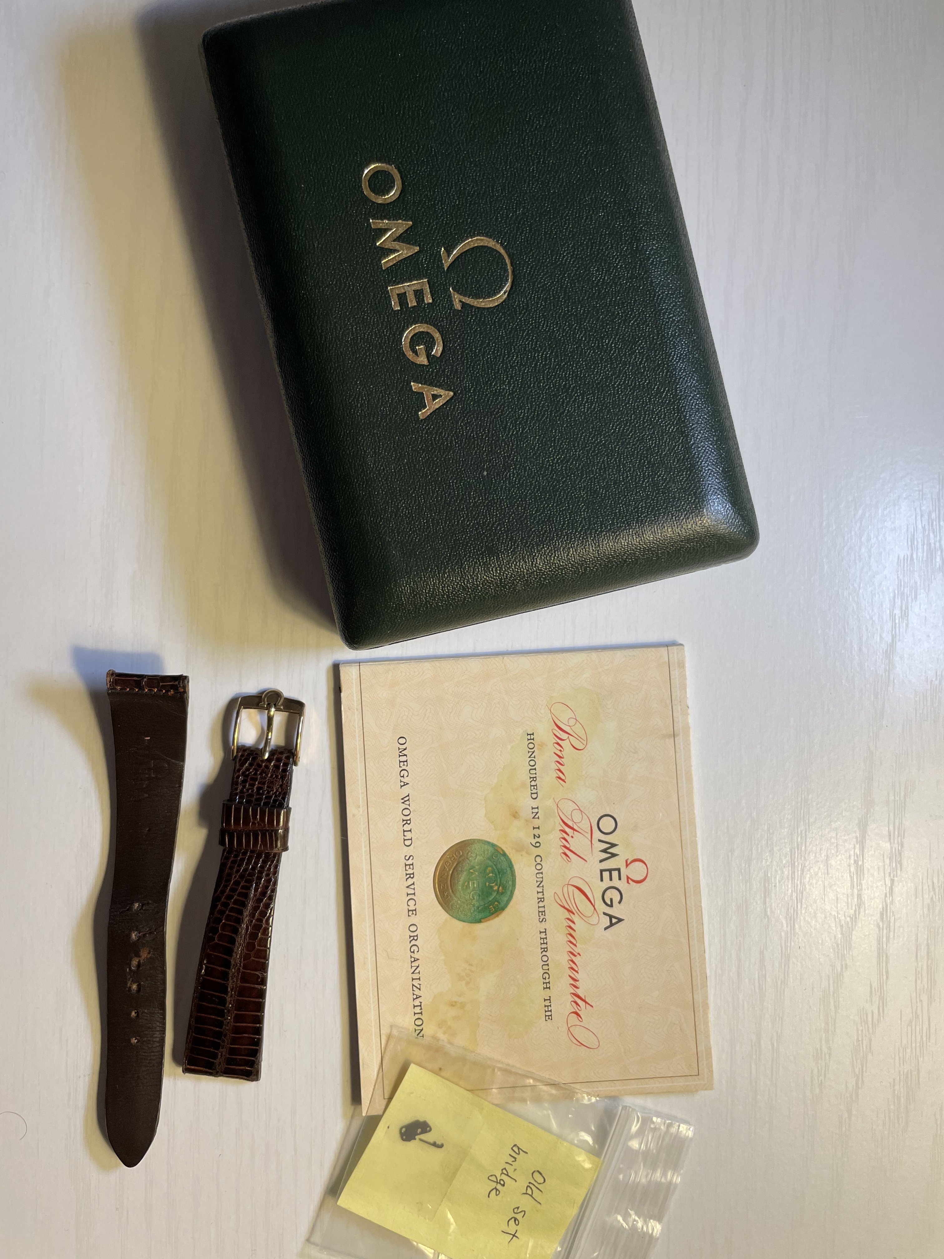

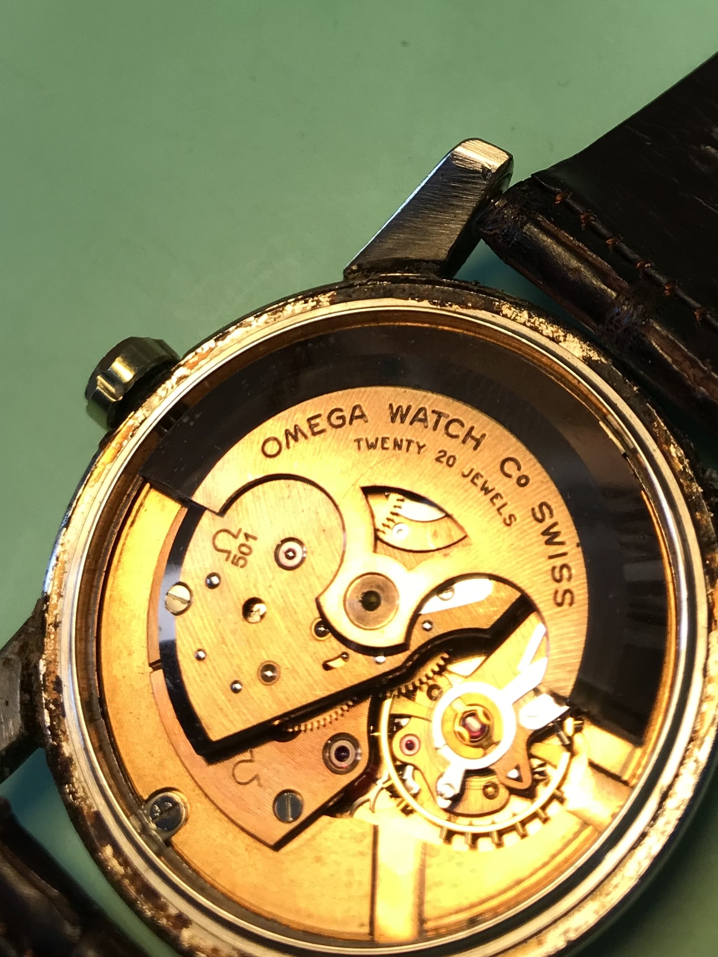

The original bridge set and crown stem were replaced by my watch guy, but he said he thought everything else was original. I still have the bridge set he took out. (see pic).

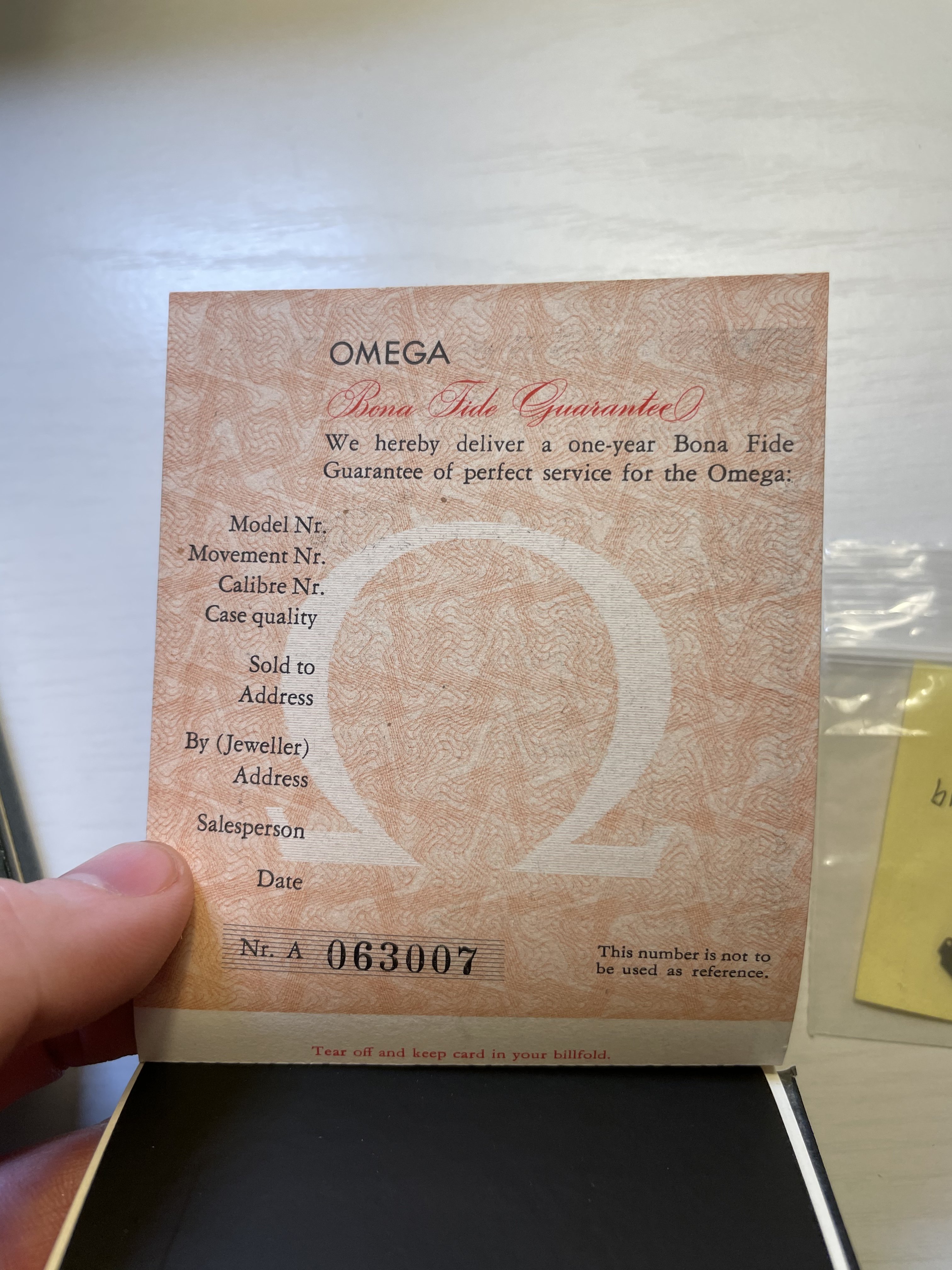

I have the box and papers, though the warranty paperwork was never filled out by the dealer. There is also an omega strap and buckle, but it is a 16mm strap even though the watch has 18mm lugs. I do not have a pic of the inside of the case back, but I do have the serial number written down somewhere.

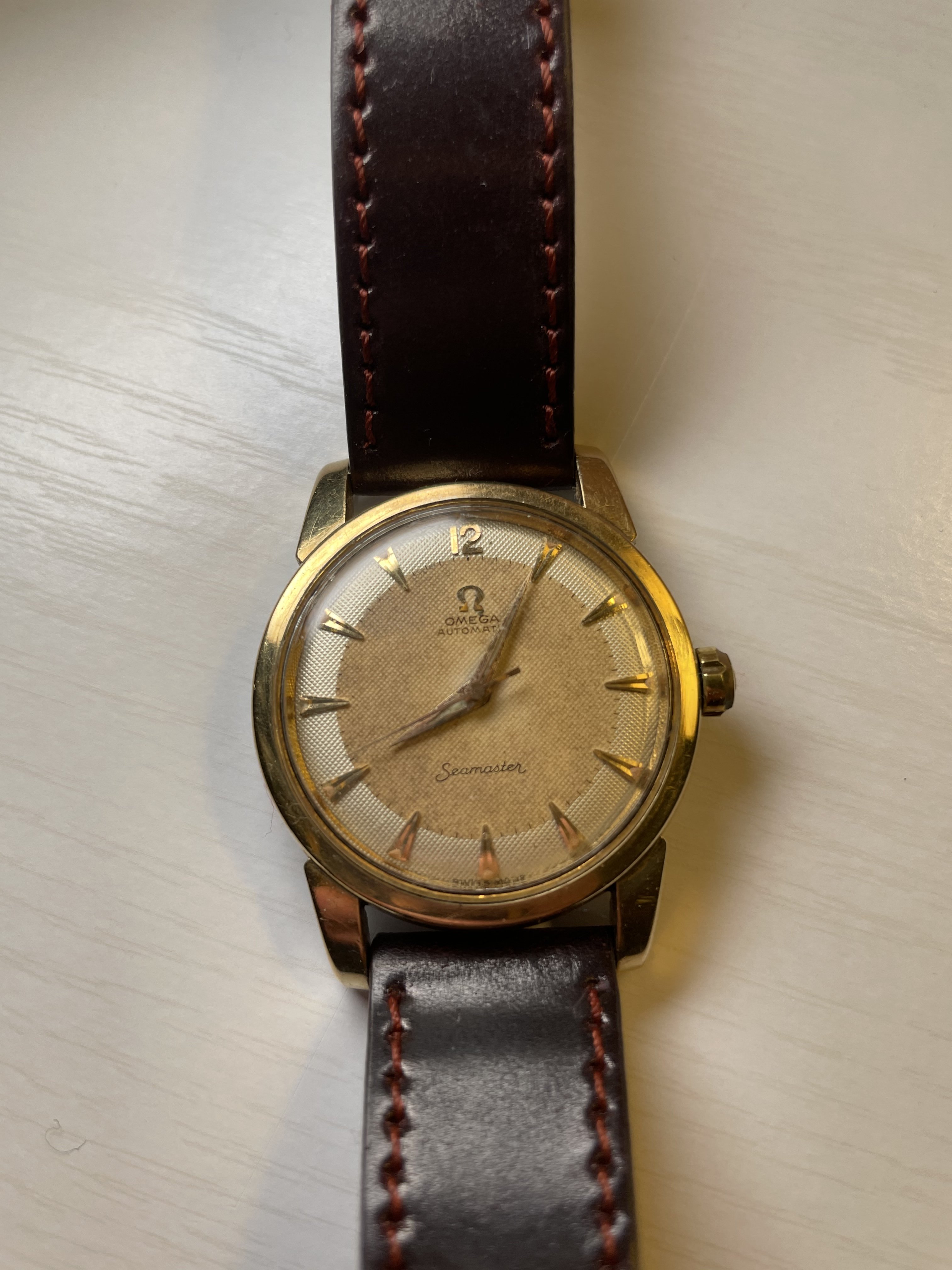

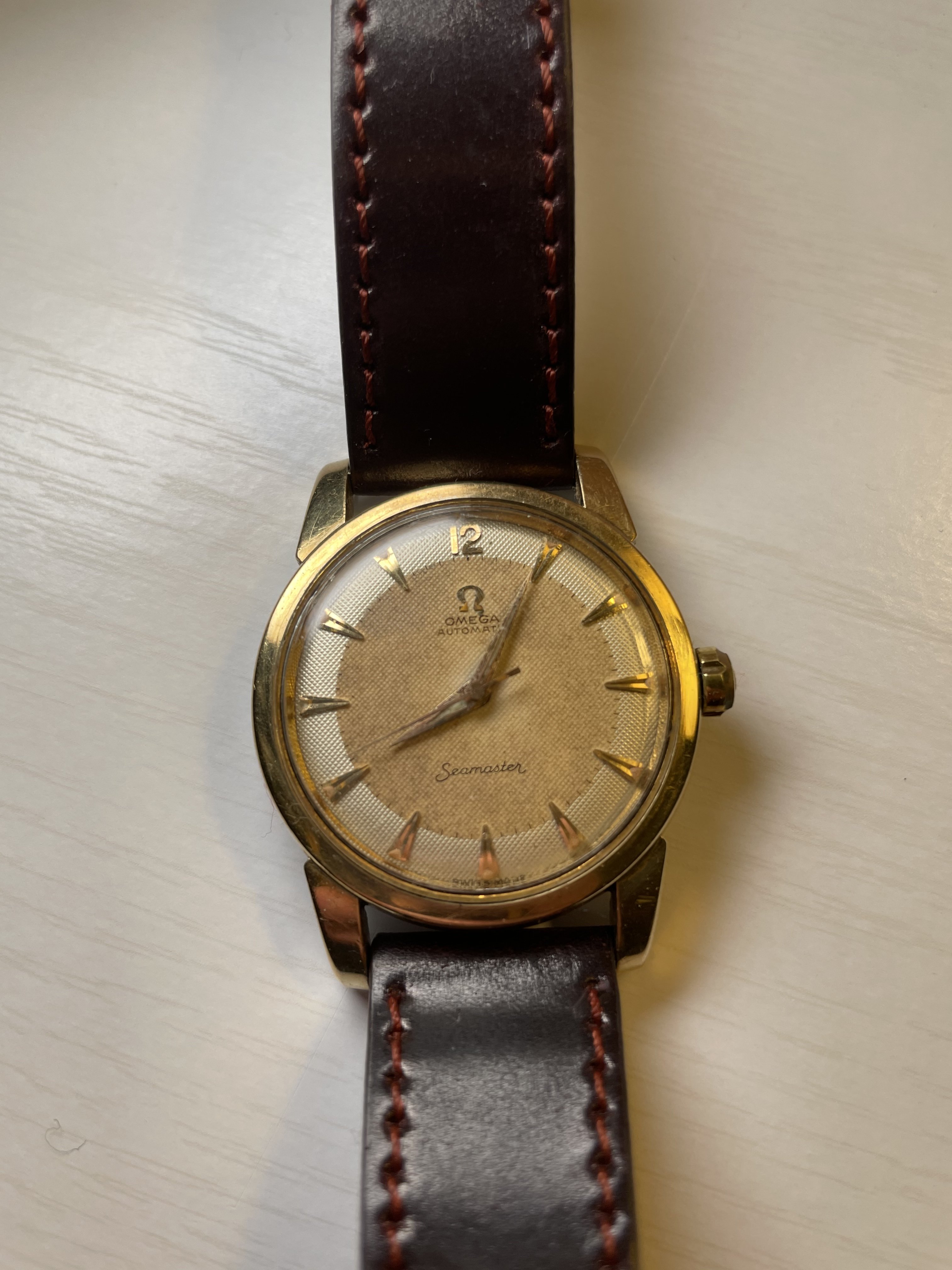

You can find the ref number inside of the caseback, looks like a 2849, for the year, you can check the serial number stamped inside the movement, under the rotor. The honeycomb twotone is nice, but the 'S' and the 'r' font in 'Seamaster' seem off. Could be a redial?!

Well the serial dated the watch to 1958, in that era, the 'S' should be pointy shape, the round 'S' is from 60s model. One more think to worry about.

Looks like a nice gold-capped Seamaster from the late 50s. I don't know the reference number, but it will be inside the case-back. Hopefully that photo is pre-service. Unfortunately, there doesn't seem to be anything that ties the papers and box to the watch, so they don't add too much value IMO. Still, I think it's worth at least $500 USD, especially because of the interesting textured dial.

More than likely a ref 2846/2848; gold capped isn't especially valuable/attractive, but the honeycomb dial's cool, even if (as @nanjingcigaretes notes) it's a service dial (I have no clue re the dial, honestly--I could be convinced it's original or a service; I'd've suspected Swiss Made at the bottom, as that's what all examples I've seen have said, but maybe I'm all wrong on all of it).

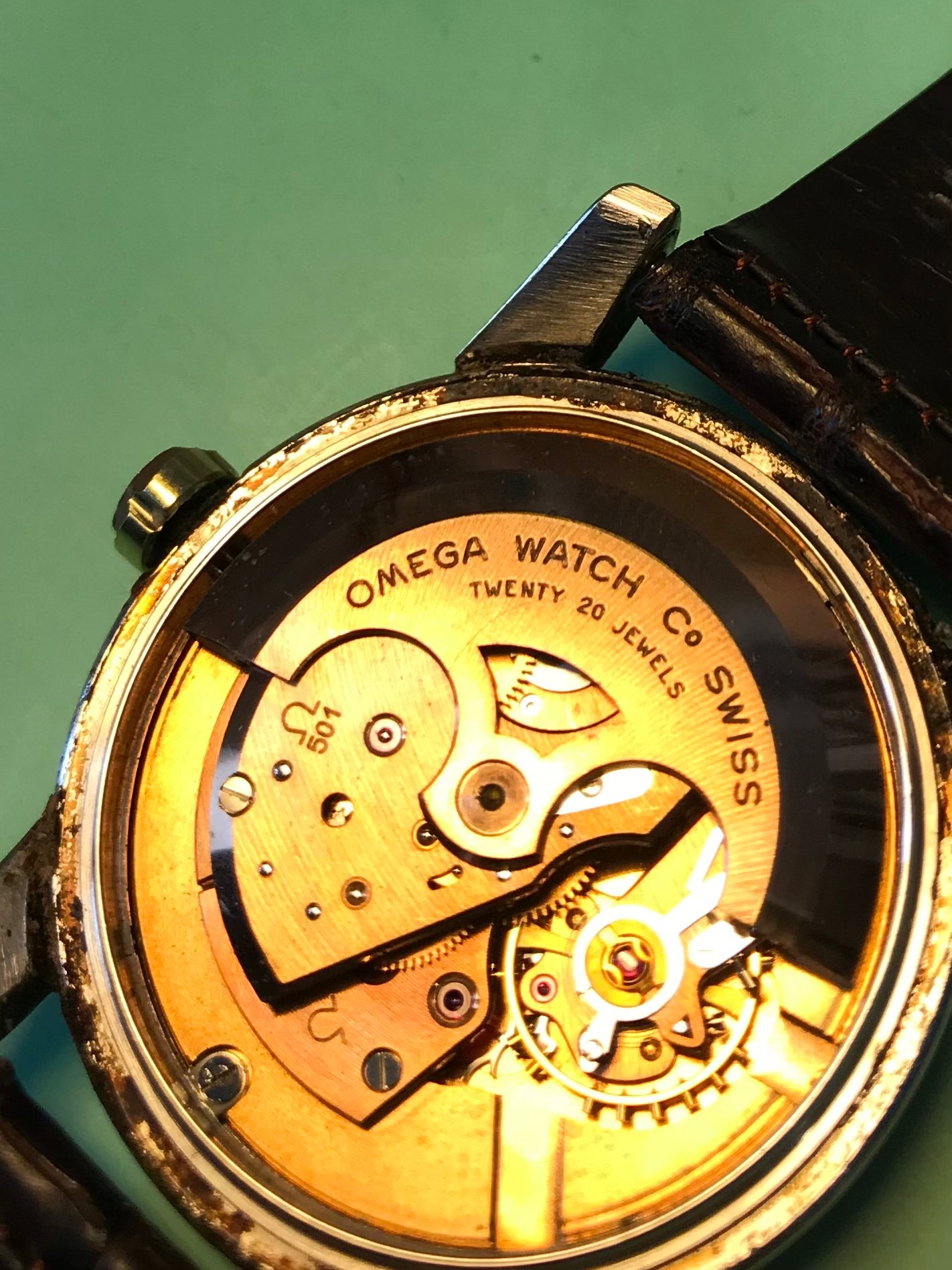

It makes sense that the box and paperwork can’t be connected to the watch, but it’s too bad. The movement picture is the only one that’s preservice, but I specifically asked my guy to only clean and oil the movement and not touch anything else at all. I like that the watch looks it’s age. Obviously, I’d have liked to hear that’s it’s worth more, but as my plan is to wear and enjoy it, I can be content there, too. Even $500 would be many times more than I paid for it. Knowing where it came from, I’d be really surprised if it was a redial, but I know very little about how to tell, so maybe. Thanks for all your insights/opinions. I think I’m going to wear it to work today. 😀

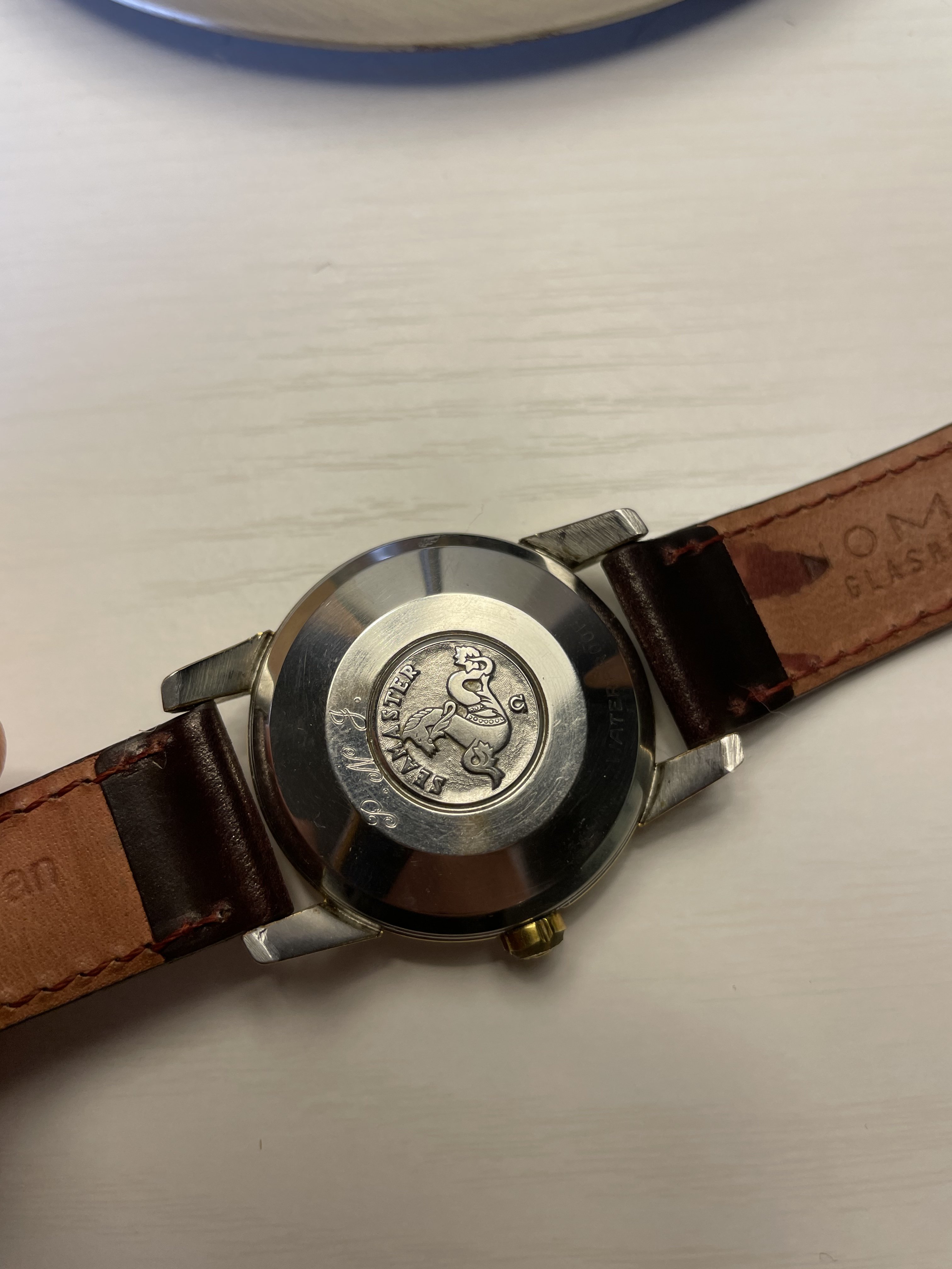

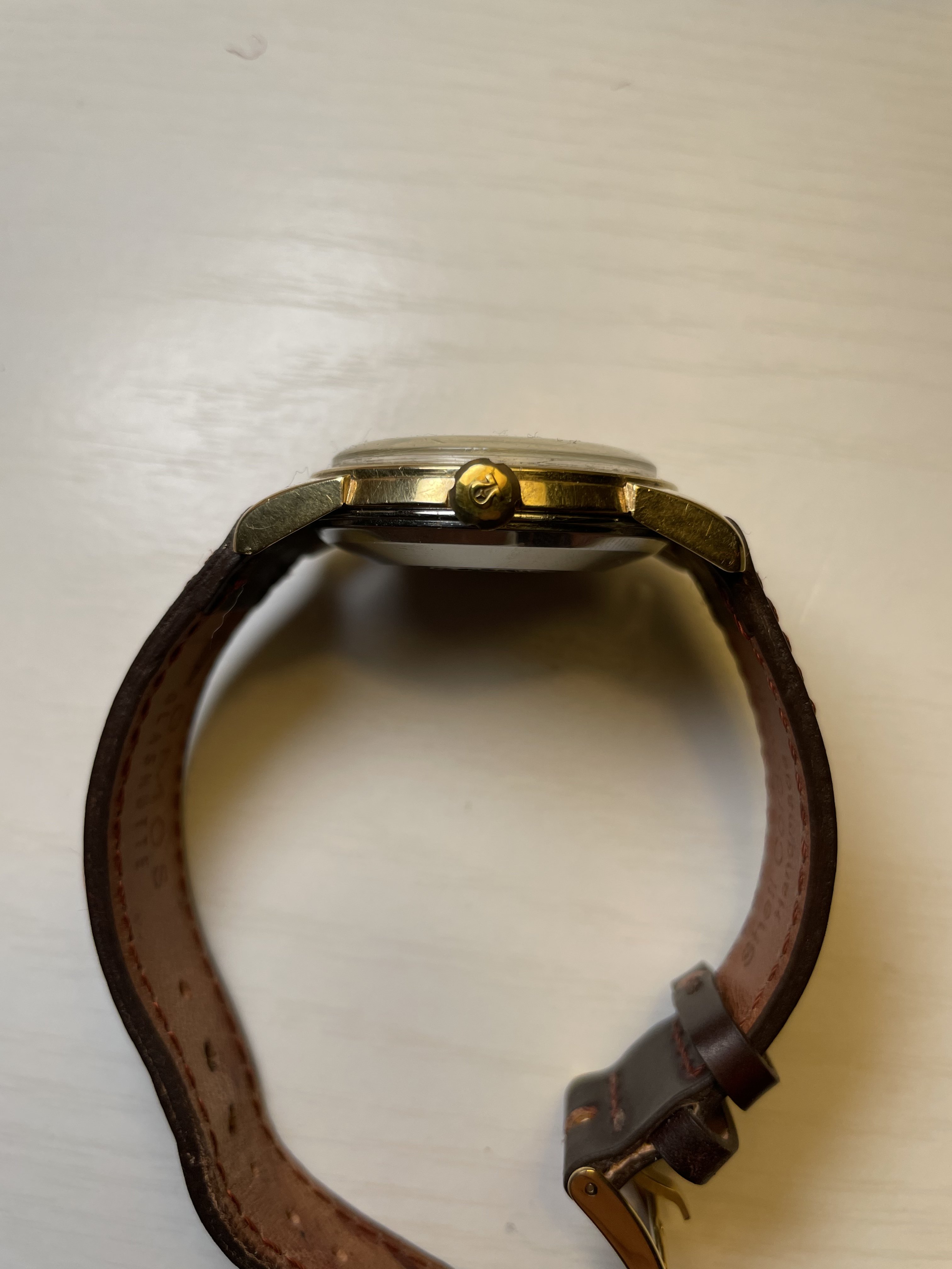

Snazzy watch and love the dial. I think that big logo snap case back was associated with 1958 versions. 👍

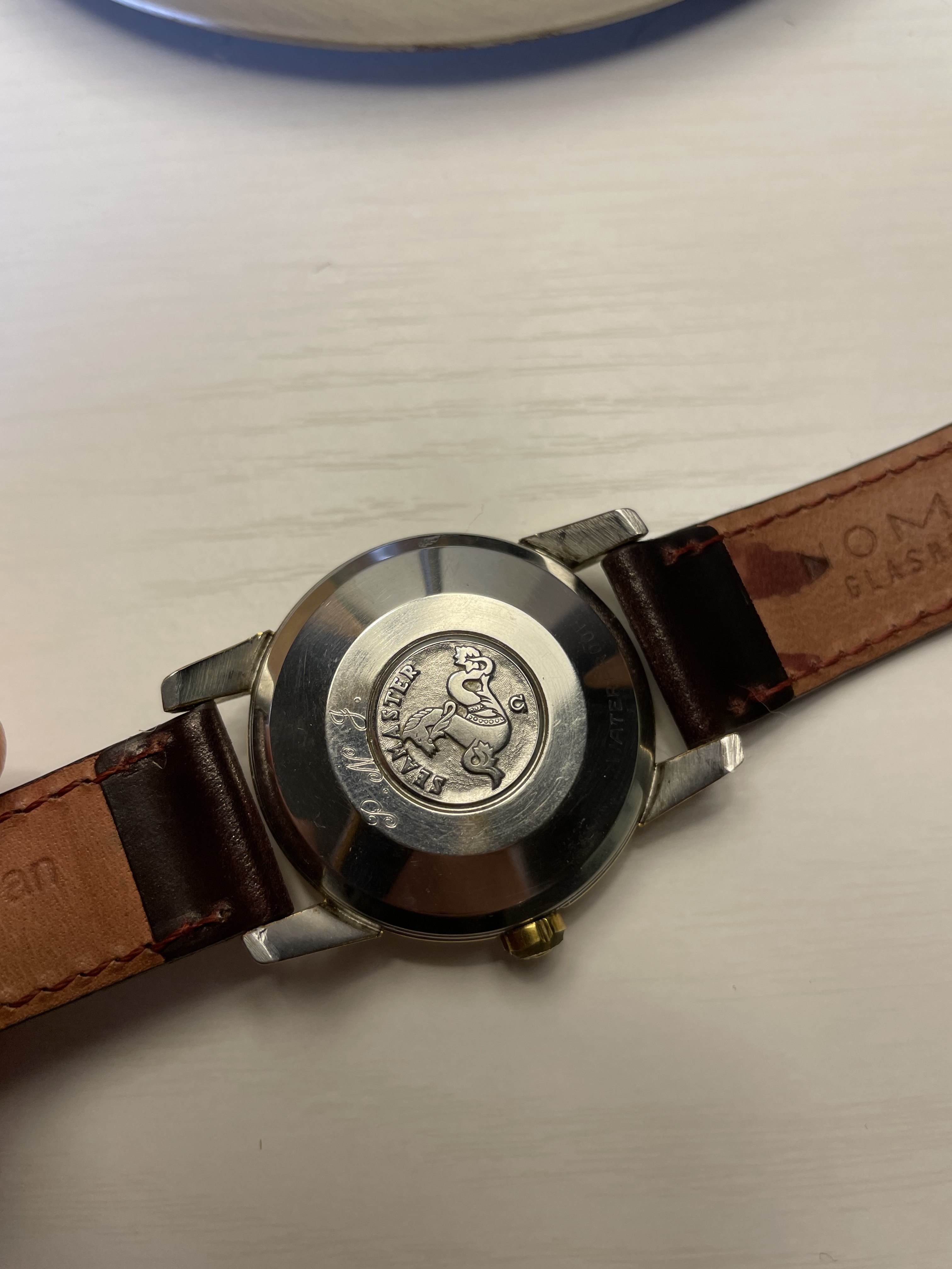

Just to note for the OP: that's *not* a large hippocampus caseback, it's just the standard snap-on Seamaster caseback. If for some reason you're curious, here's what big hippocampus ones look like.

The movement picture is the only one that’s preservice/QUOTE]
That's what I meant. There's a lot of crud around the back of the case, and I assume that's all cleaned up now.
Actually it isn't a standard style snap case back as many of them didn't have much of any logo in the center.
2,816
6,951
Pre-1958: no hippocampus
1958: big hippocampus
1959+: small hippocampus
There’s no “standard”, they just used different casebacks at different times.
The only thing that gives me pause about this watch is the fact that I don’t recall seeing this two-tone waffle dial and Seamaster font on a watch from 1959+. So it’s possible that either the dial or the case back has been transplanted. However, I didn’t mention it before because there are so many irregularities with these 50s Seamasters that this would be very difficult to prove.
Not really, the S styles varied considerably even then and the pointed S came in about 1959. The dial looks good to me.
