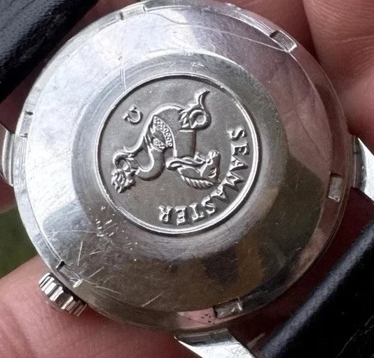

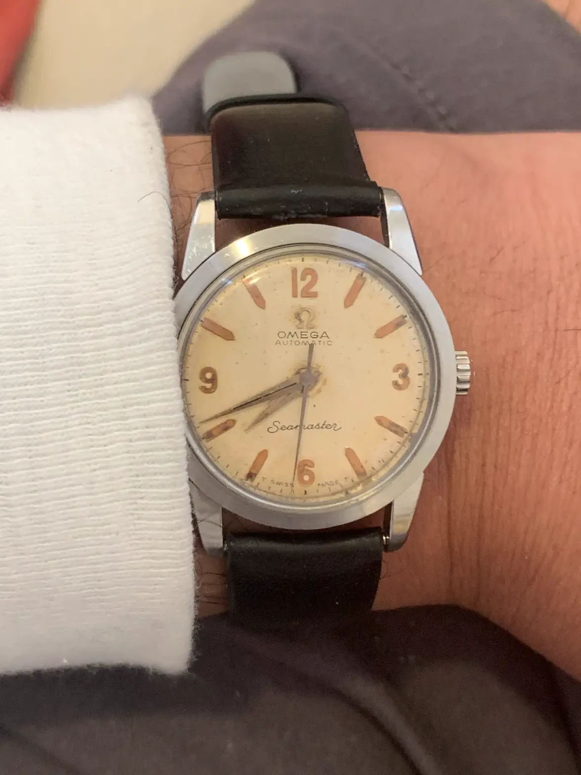

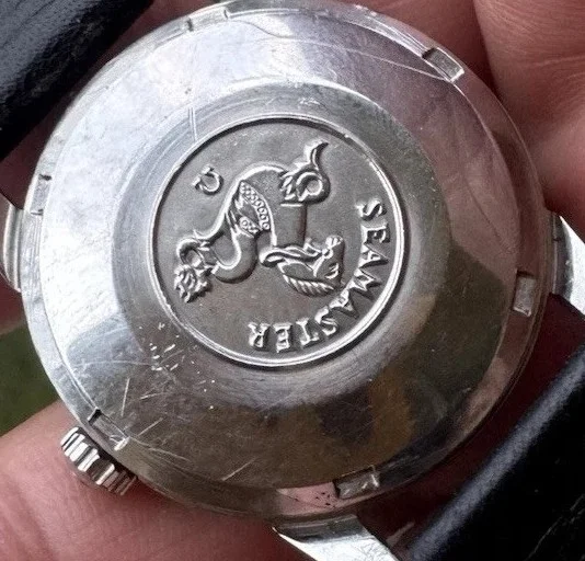

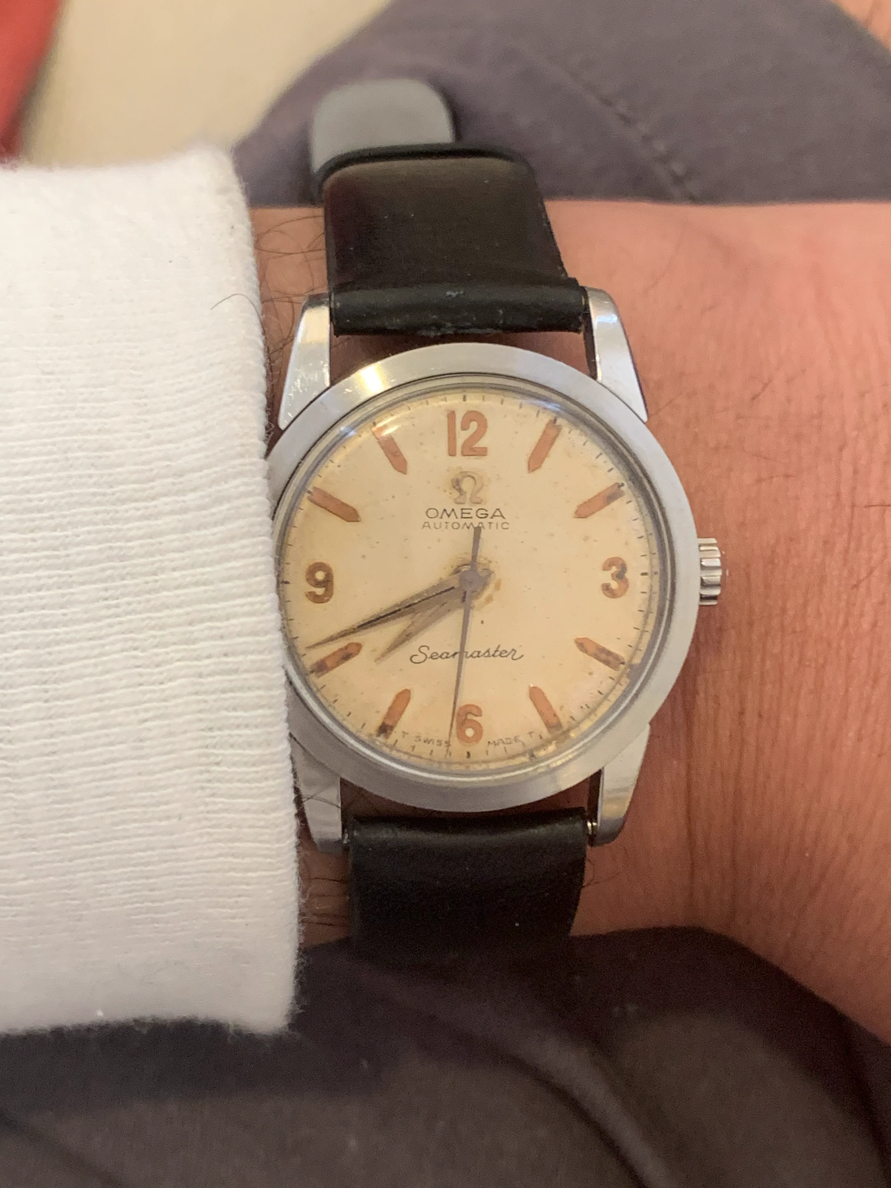

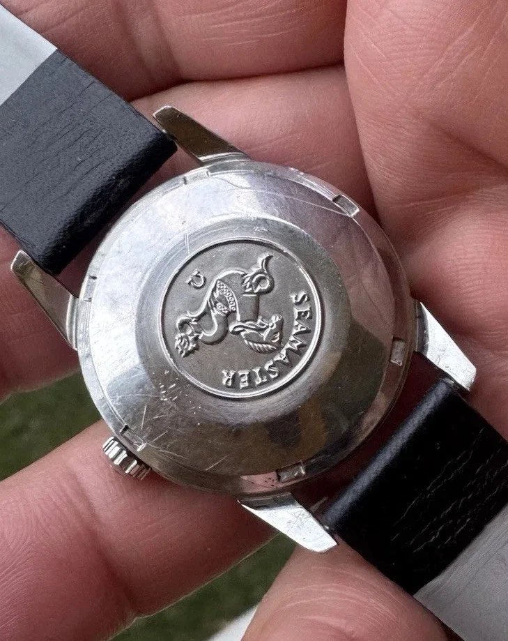

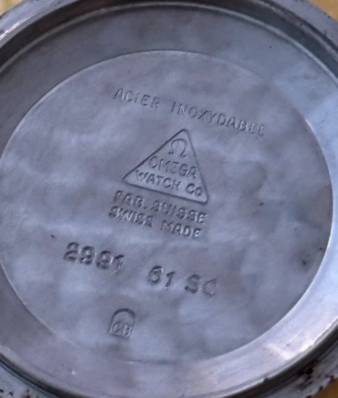

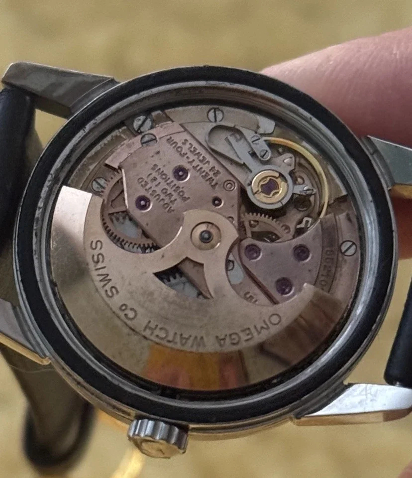

Is this omega rare and authentic (2991-61SC) CAL.571 and any information about it
160
35
I bought this watch, SEAMASTER/AUTOM. CAL.571, for $395, but there is no information or similar on the internet. Do yo believe all parts authentic and genuine?
160
35
I appreciate if anyone seen similar watch before and your opinion in general.

I don't like the dial. For a start a -61 iteration would not have T marks since tritium wasn't used until 62-63 and not marked for the first year. The markers are blocky and seem misaligned too. In short its perhaps not as original as you may have hoped.

Thanks you for comment, as I am still learning about omega watches, the seller listed that year manufactured
1960-1969, I have not seen any similar dial though but I am not sure as some people said all original and other said dial is refinished so I am confused

Dial is 100% refinished imo. The script actually looks reasonable but the presence of T’s either side of Swiss made and the fact this is above the minute track, not below, coupled with both the lack of lume in the wells at the end of the hour indicies and the fact the dashes that have replaced them are misaligned means it’s been repainted.

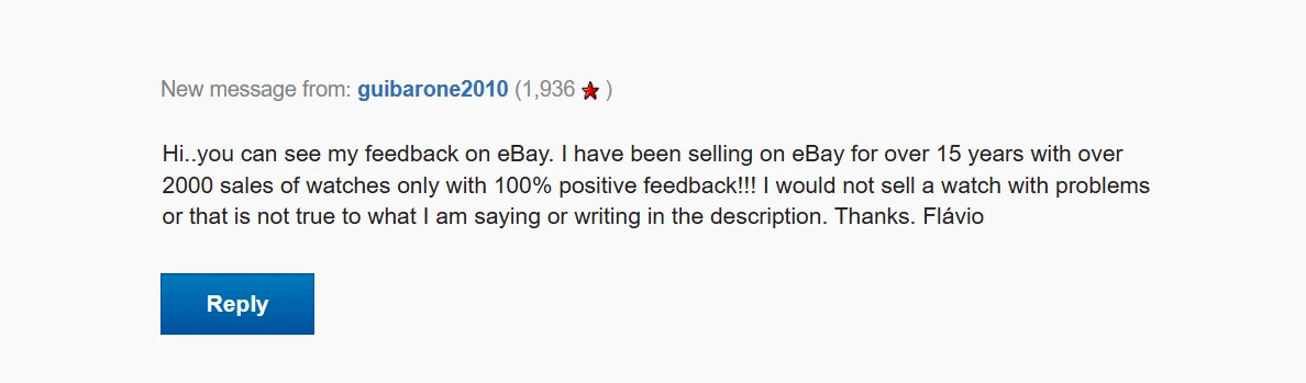

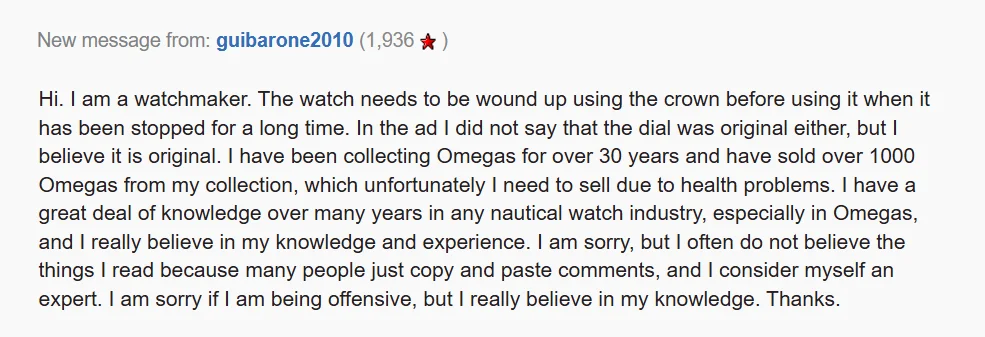

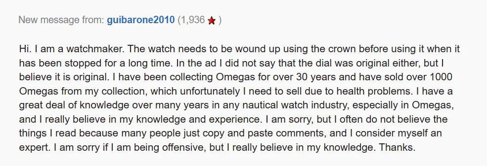

Just to keep you all updated, I approached the seller to understand better, and this was his comment, I do not want to bother him after he mentioned that he has a medical condition, he said has 30 years of Omega experience and sold over 1000 omega from his collection and he believe it is original, off topic can someone with all this experience and got confused with omega watches( is it that much hard skill) and is there any way or catalogue I can verify this watch and he I can learn about Omega watches in general, than you all your guidance.

The best way to learn about vintage Omegas is to immerse yourself in this forum, narrow down the references you’re interested in and read all the threads you can find to increase your knowledge.
There’s no one stop shop for learning the details on vintage Omegas but this place is close.
191
84
Ok, I gotta ask. What's your goal here? You've already heard from the people here who say that they believe it's a redial, and the seller believe it's original. This is a case of he said, she said. So what are you trying to do? Educate the seller who states he has over 30 years of experience? You think he's going to listen to you? He seems pretty set as he mentioned it 3 times in his reply. He states what he knows and trusts that. I understand you may mean well, but I think you're just spinning your wheels for no reason. I have purchased a few duds and I (like you) am still learning. Take this as a lesson learned for yourself and don't try to teach others just yet. I'm not even trying to do that, I'm trying to understand your end goal and also save you some heartache as I have had in the past with stuff like this.
