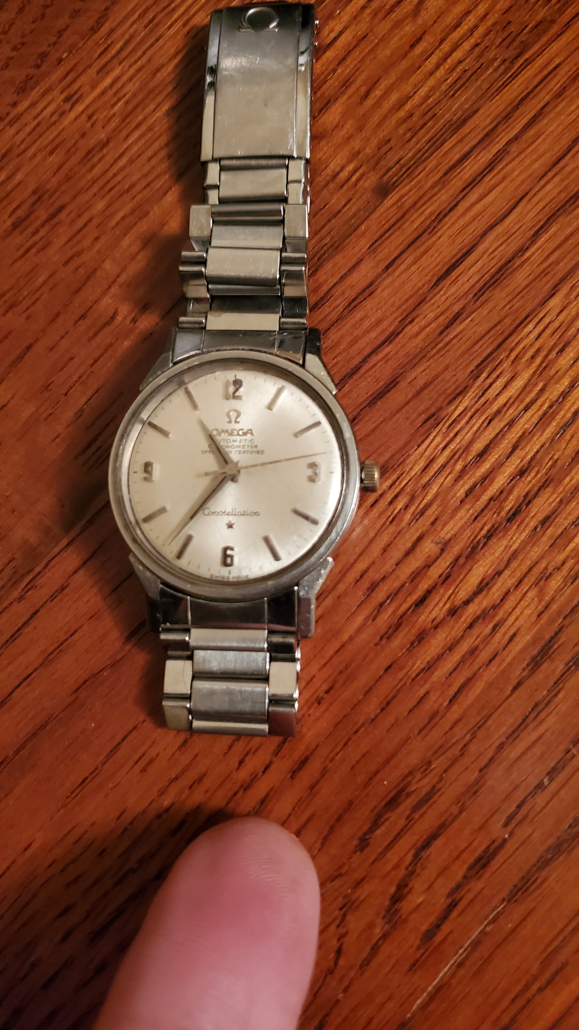

I inherited my dads watch years ago and don't know much about it. He bought it in Aug 1968. Here is a picture and some info on a card that reads ja-6100 #21220236..movement?
#1035 bracelet with 630 ends

Wanna sell it for $10? If I were you I'd sell it to me for $11 but seriously, go to an actual Omega Dealer and have them send it to wherever Omega has there technicians ( Rolex has them in Texas and New York ) to authenticate the watch and do a full service on the watch. This may cost you upwards of $500 or more, but if it's authenticated and freshly serviced it can be something you can pass down to your children. If you just want to know how much it's worth or what it is, it's an Omega Constellation and it's worth $10 : )

That's just a lovely Constellation. Not sure of the reference; seems likely a 167.005 (which'd have a caliber 551 inside). It looks to be a great example, and the bracelet's pretty stellar as well.

Do NOT send it to Omega. Omega unfortunately often does not respect vintage watches.
Serial number dates to ca 1964.
If you intend to wear have it serviced by an independent watchmaker versed in vintage watches. DO NOT have the case or bracelet polished.
Great looking watch with a fairly uncommon dial and bracelet, which is worth more than the watch head itself.

IMO that is bad advice - this watch does not need any authentication by Omega - the experts on OF can do this easily for you.
Have it opened by a versed watchmaker and post pictures of movement and inner case back here on OF and you will receive the information you need.
And as already mentioned by @X350 XJR do NOT send it to Omega - it will cost you a lot and there is the risk that they replace parts or polish the case which will considerably lower the value of the watch.
Have it serviced by an independent WM and have the wrong crown replaced then you will have a reliable heirloom which will bring you joy for decades to come.

Does it have the wrong crown?

I appreciate your comment on the polishing because i had scheduled it to be done and cancelled it.

Lovely watch.
Agree, no authentication is needed. It’s a genuine Constellation with a replaced crown but a valuable bracelet.
A good independent watchmaker will be able to service this so you can use it either for daily wear (although it almost certainly won’t have much in the way of water resistance) or on special occasions.

Welcome @Geryur
As above, nice watch.
It’s a167.005, dogleg, dome dial, with unusual Arabic quarter indices.
The movement will be a cal 551.
oddly enough it does have a valuable bracelet (some collectors like to pair this style of bracelet with more valuable vintage watches)
The crown should be decagonal but they are no longer available new I’m afraid.
if you are going to wear the watch do get it serviced - if you let us know whereabouts in the world you are you may get some recommendations for a watchmaker.

Yeah as said above it would be a shame to remove those beautiful chamfered edges on the dog legs which define this case model. The correct crown is the decagonal one but there are some variations so do your research prior to ordering one because they are a bit costly but are worth it and change the appearance of the watch! Thats a nice connie !👍

Agree do not send it to Omega Service, only a great local watchmaker (who is an expert in vintage omega watches)
But we cant tell you what you have to do 😉
