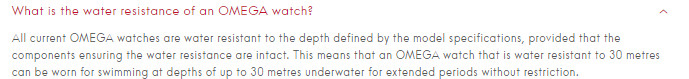

I’m pretty sure 50m (5atm) is above 70 psi. To put that into perspective, a good shower at home might be in the 40s. Even with the kinetic movements of a vigorous swim, I don’t know that most of us would expose our watches to anywhere near their pressure ratings.
All I’m suggesting is that if you’re just washing dishes and going for a casual swim, a watch that is well sealed enough to pass a 50m test is probably more than up to the challenge… no?
6,471
31,870
Yes, exactly what Omega states:
