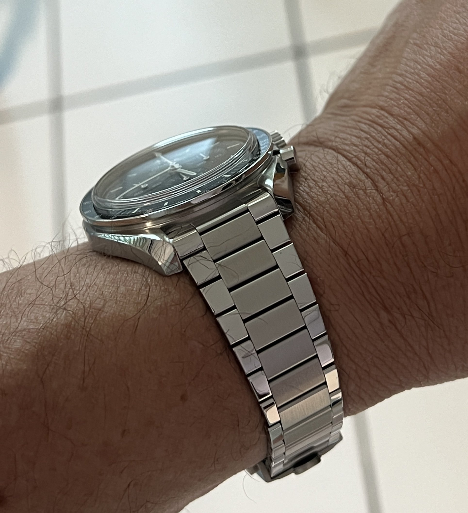

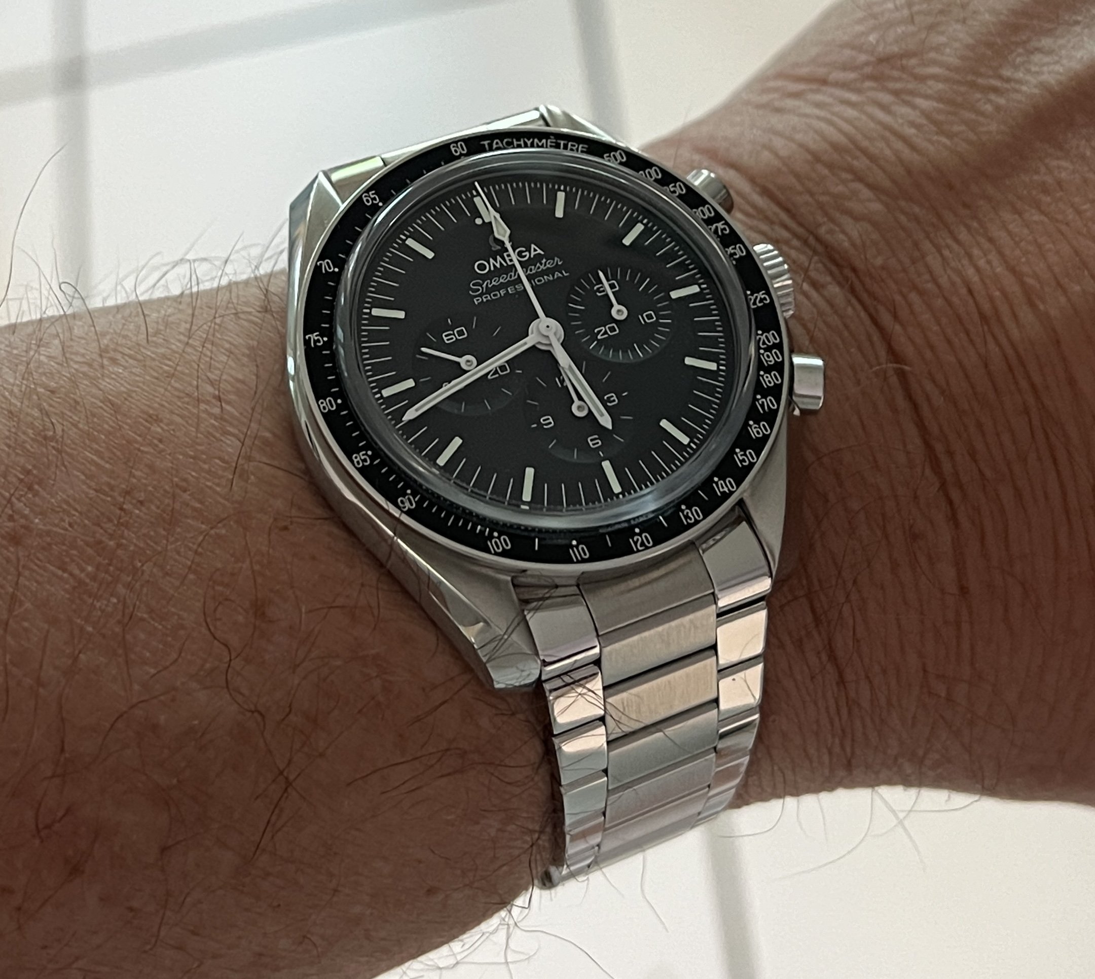

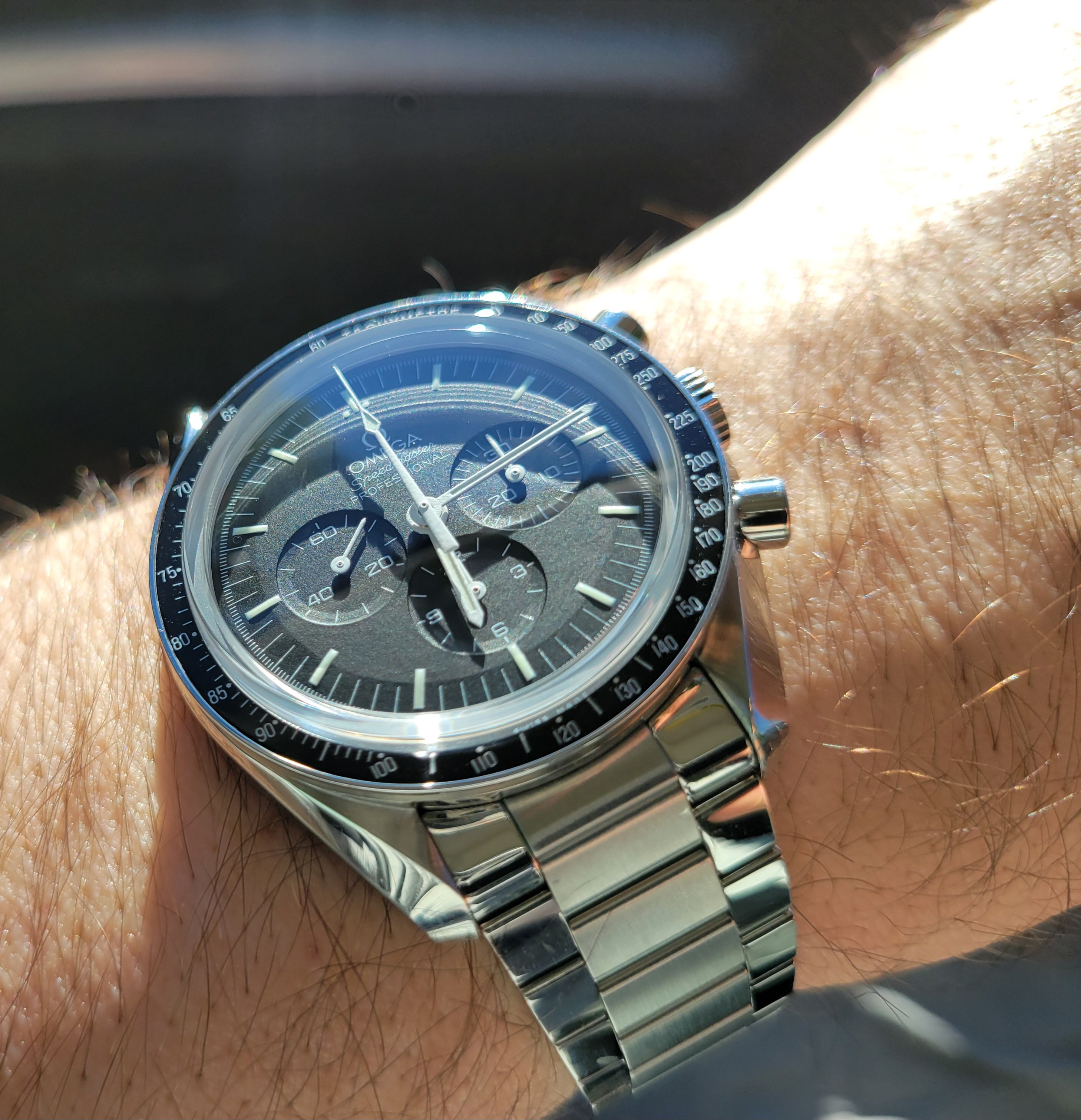

Thanks for sharing! Here my 3861 with the 50th anniversary bracelet (020STZ011628):
3,915
8,463
Thanks for the reply. So would you say the Forstner end links are a better match or should I jar try modifying the original omega endilinks? And how and what would you need to mod on them?
Sorry; I just saw this message. I used a grinding wheel on a dremel at low speed, and plenty of painter's tape to mask the endlink. grind down only the raised lip, go slow, and test fit as you go. You'll want to remove burs with sandpaper as you go so as not to scratch the case during test fits.
This looks fantastic, was any modification of the endlink required? I assume the A11 50th case and 3861 case are not that dissimilar.
EDIT: saw from the underneath shot that the endlink has not been modified and looks as if you fit it with a 1.6mm sprinbar?

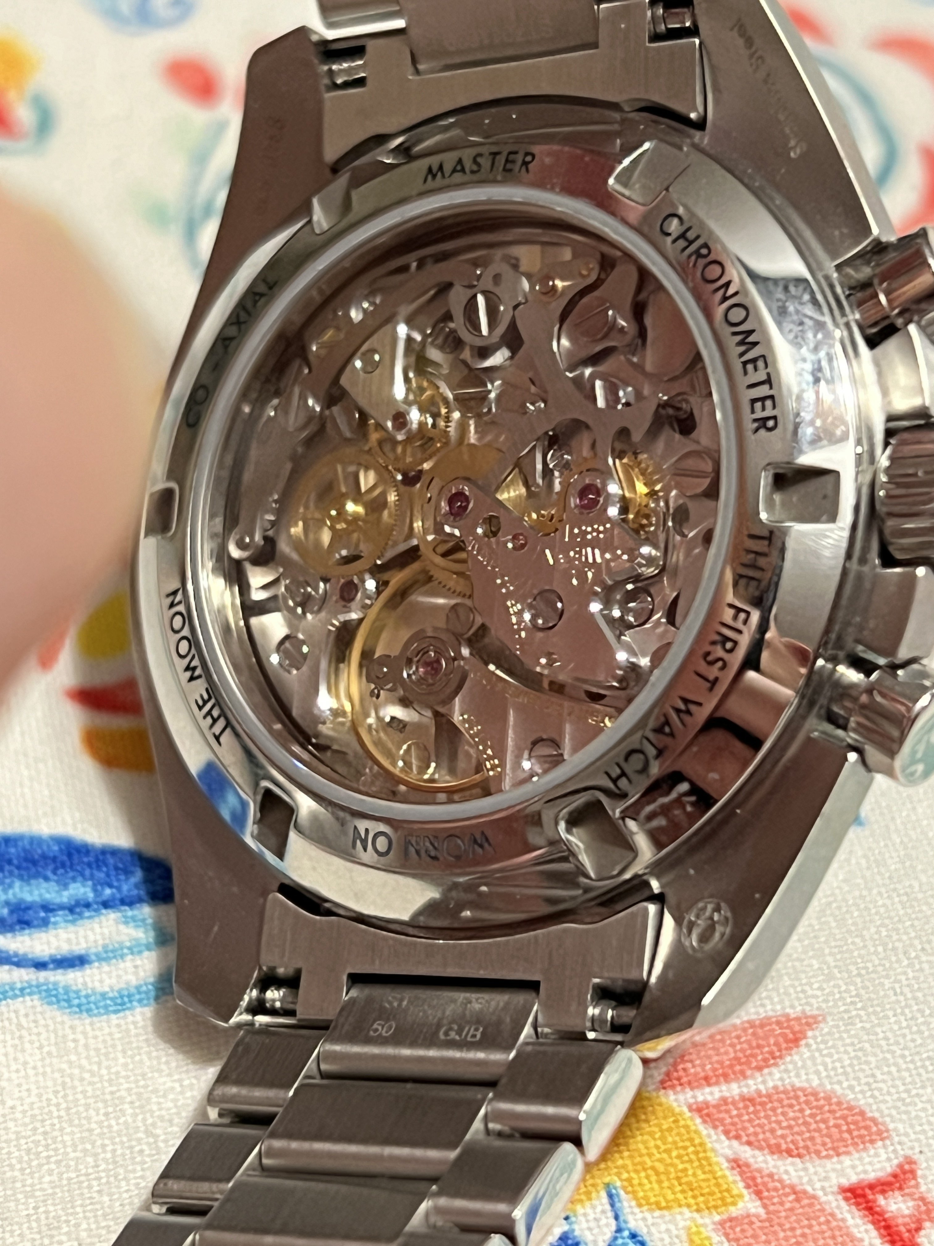

Bought the bracelet used, fitted with the provided springbars (which likely are 1.6 MM) without doing any modifications. May add later Forstner end links as people say provide the best fit.

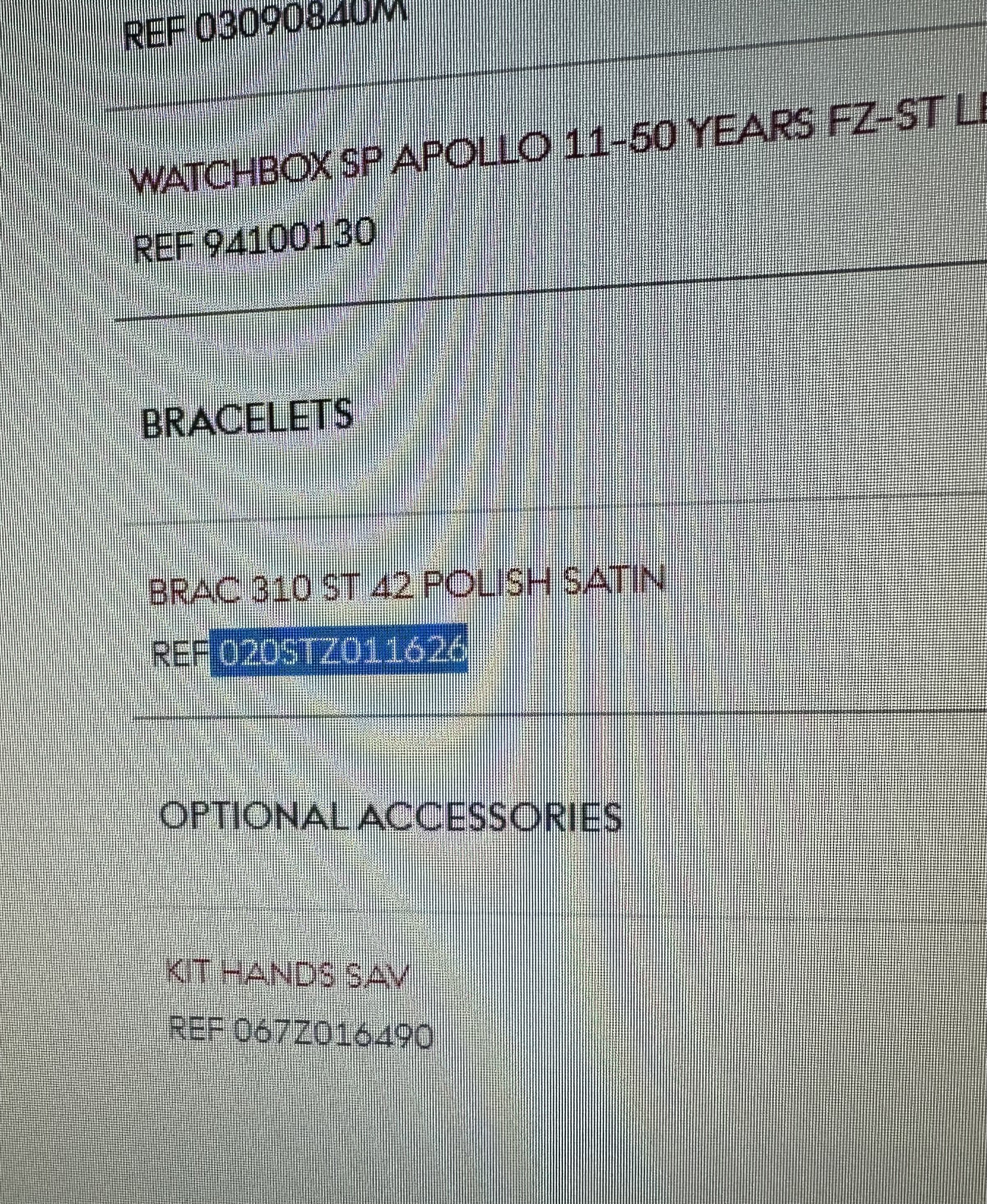

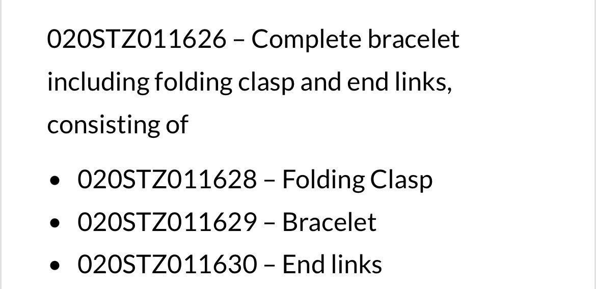

I was at the omega service center today and it appears the part number for the bracelet is this…
3,385
6,572
Yes that is correct

020STZ011628
Yes that is correct

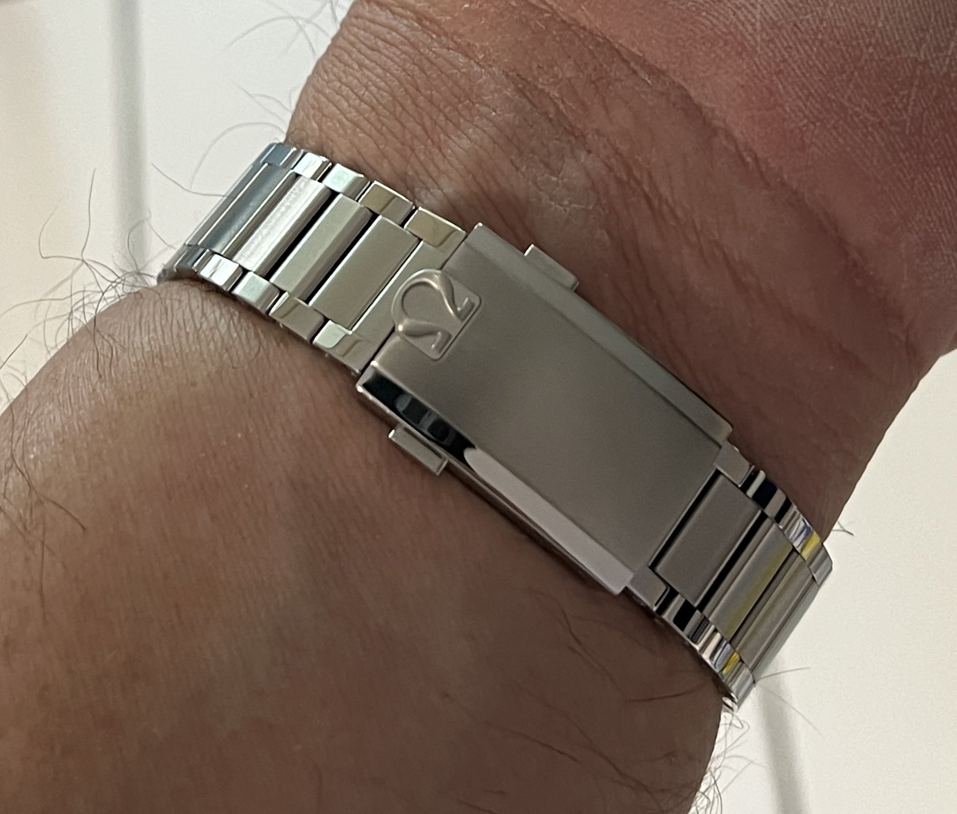

So the Speedmaster ‘57 bracelet fits perfectly. No third party endlinks required.
