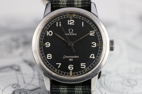

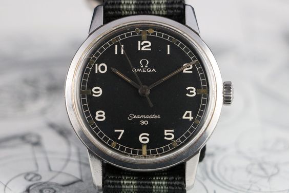

Let's say I want to pick up a Seamaster 125.003. (Pic from omegaenthusiastltd.com .) Looking at the Case Bracelet Endlink List pdf, I see no endlinks/bracelet listed. Would I be out of luck in trying to pair this case with a curved endlink bracelet?

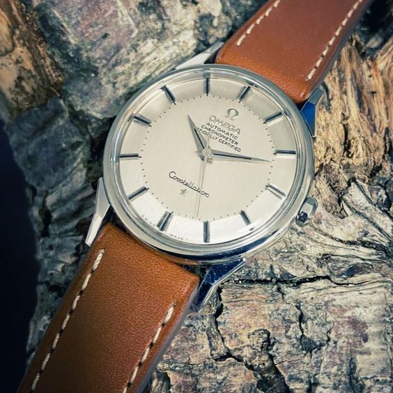

Let's say I want to pick up a Constellation 14900. (I understand this model is a minefield. Pic from watchesoflancashire.com .) Case model 14900 isn't in the same format as those in the Case Bracelet Endlink List pdf, is this too old to find a corresponding bracelet?
Let's say I want to pick up a Seamaster 135.007. (Pic from stetzcowatches.com .) Looking at the Case Bracelet Endlink List pdf, I see 135.0070 corresponding to bracelet and endlinks 1168/605. Am I looking at this correctly, does 135.0070 = 135.007?

- Let's say I want to pick up a Seamaster 125.003. (Pic from omegaenthusiastltd.com .) Looking at the Case Bracelet Endlink List pdf, I see no endlinks/bracelet listed. Would I be out of luck in trying to pair this case with a curved endlink bracelet?
No; they did come on bracelets, but you have to work out which one fits. I have quite a long list of bracelet/endlink combinations, so when you find the watch you like, feel free to ask, almost all of them will fit on some sort of bracelet/endlink combination, if it was made in the 50s or later.
- Let's say I want to pick up a Constellation 14900. (I understand this model is a minefield. Pic from watchesoflancashire.com .) Case model 14900 isn't in the same format as those in the Case Bracelet Endlink List pdf, is this too old to find a corresponding bracelet?
No, if the case is the same, it will fit.

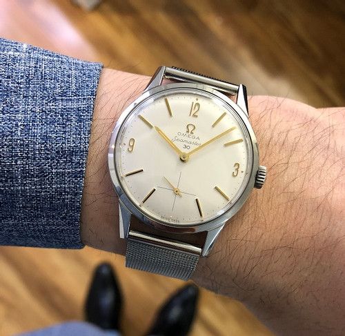

One interesting option for you to consider is getting an Omega mesh band. Most of the ones that come up seem like they were only for the Japanese market, but they're pretty standard, versatile, and comfortable.

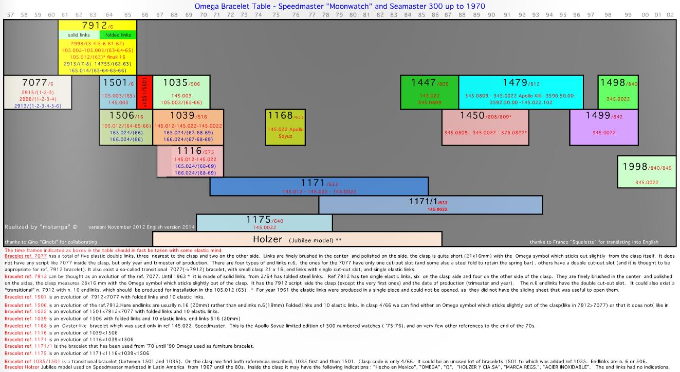

Let me also chime in that with such a large wrist, getting the right bracelets in lengths that will fit will require a lot of luck and perseverance -- perhaps years' worth. Extra links for vintage bracelets can be unobtainium. In my experience, all the vintage Omega bracelets I've encountered should have had at least two removable links on both sides of the clasp so scrutinize pictures carefully.
609
789
Let me also chime in ...//... In my experience, all the vintage Omega bracelets I've encountered should have had at least two removable links on both sides of the clasp so scrutinize pictures carefully.
In fact 1505, 1039, 1035, 7912 should have 4+6 stretch links, the 7077 should have 2+3 double stretch links.
