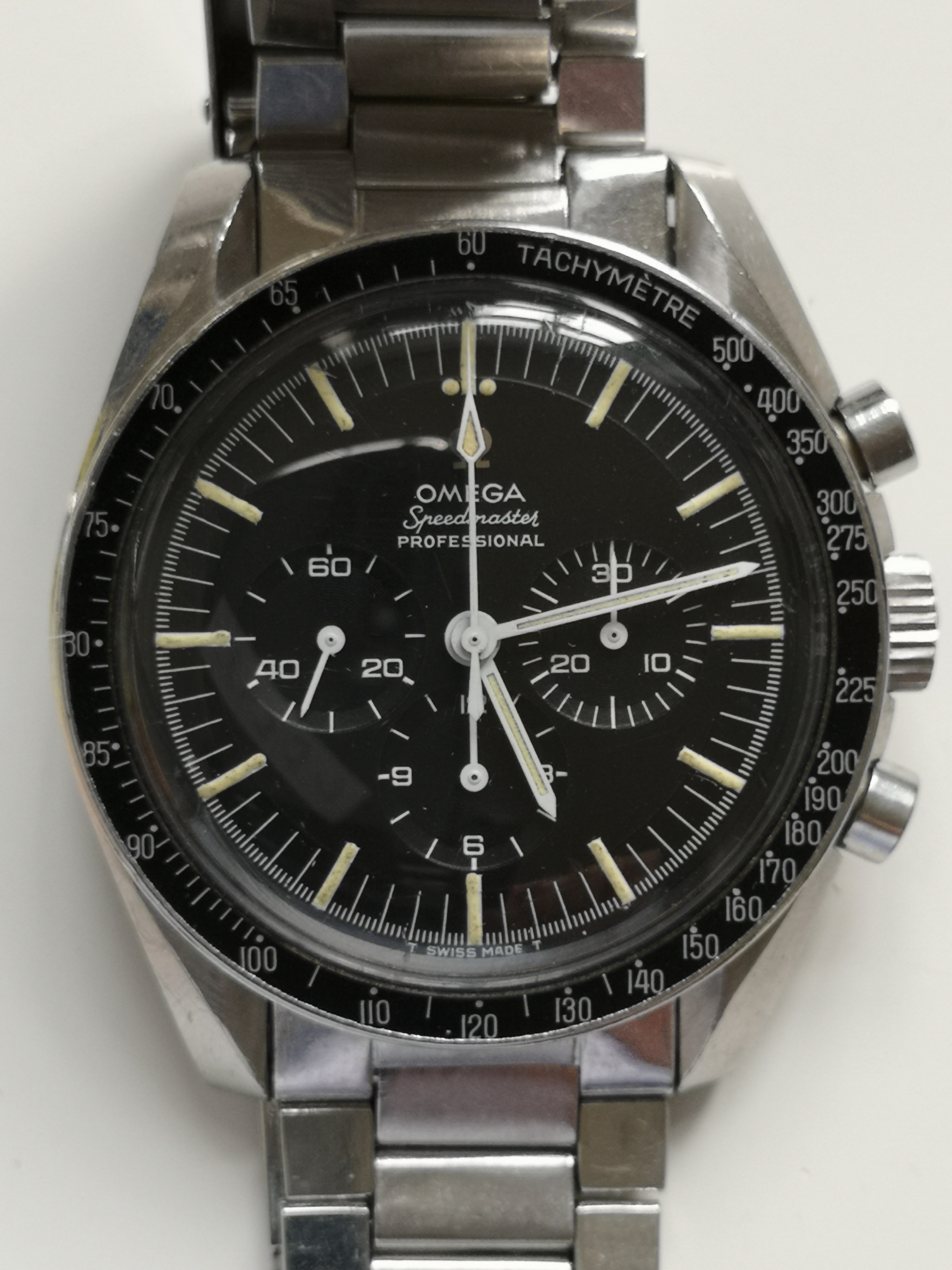

Unless the 145 was NOS, that caseback came much later. I'm still dumbfounded of the poor quality photos sellers provide of hi value hi ticket watches such as the 105 reference. In today's world of hi res, hi tech cameras and camera phones, I view poor pics of very expensive watches as suspicious. My opinion.

The chrono should reach the end of the minute track as far as I know. It doesn't
As far as the crown: It should have a "flat foot" crown, with IIRC 24 teeth. Below an example.
The "teeth" on the example crown are much more narrow and fitting for a 32 teeth replacement crown.
For the relume and the polishing I cant comment, and gladly would learn how that can be distinguished from the photo @Monobike posted.
At least it had the correct "fat neck" pusher tubes with probably the correct "wide-short" pushers.
You are wrong and need to review more. the 105.012 has an overlapping 32 finer teeth non-flat foot(for the later 105.cb66) and flat foot crowns for the ealier 105.012. the cb cown is more diffused not extending beyond the length of the fat neck pusher.
i bought my cb66 in 2008 after or about the time of the first omegamania (note: no internet information on cb was available at that time except in 2015, check the google), as a second owner and all parts are original to the model including the bracelet and links. the cb has a different case design, even more larger than any other speedmasters in its era.the example has the correct fatneck pusher and 32 teeth crown.

how did you know the cb has a wrong crown and non matching chrono hands. much better if you have a cb and show it here.😁

yours have wrong hands (short) and damaged facets losing the sharpness. the hands are too white,
the patina or at least the color must match the lume of the indices like the cb of the OP.

I did. MOONWATCH ONLY 3rd edition. Page 308. If you have some supersecret info or source disproving that please provide it. I stand by my statement regarding the crown until that.
Why the 145 caseback should have come later? Just because it looks super sharp or...?
And agree on the poor pictures, as if some sellers do not give a s**t to what they sell...
