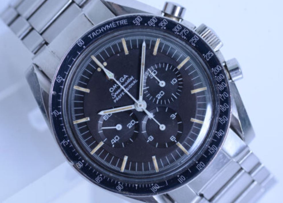

One is a 105.012-66 CB located in Germany, everything looks OK, case has visible CB edges with some dings here and there, nice dial/hands, fair/nice DON bezel, 24m 321 caliber but no bracelet.

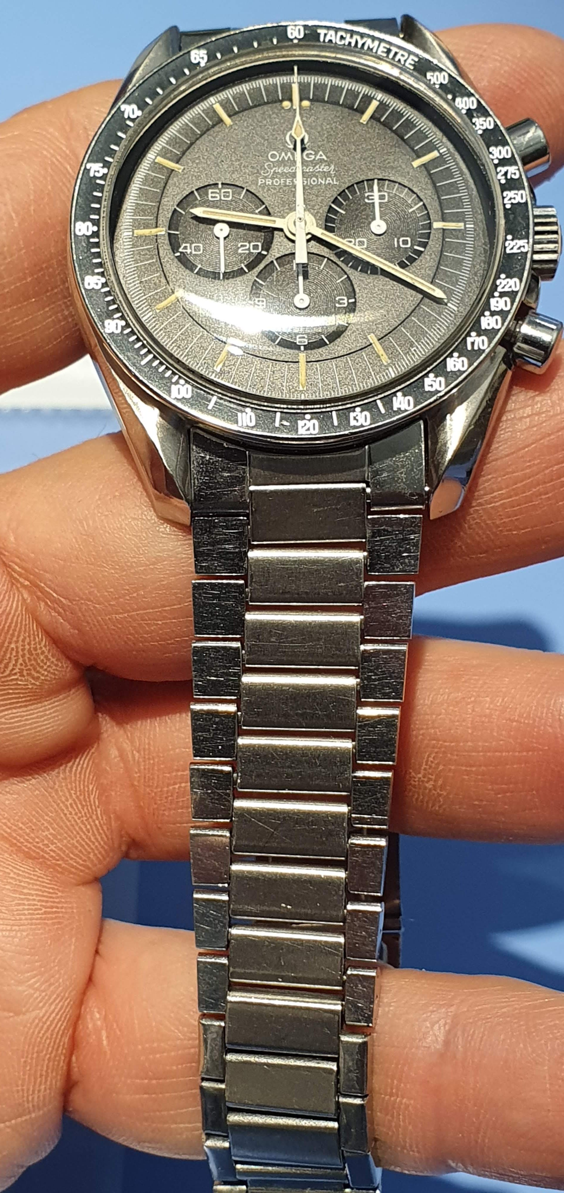

The second one is a 145.022-69 located few blocks from my office (I saw it this week) which looks like new. It is a Q4-70 one, so with Seahorse case back, perfect case and dial, perfect 1039 and what especially attracted me, a 220 bezel. Everything matches here, confirmed by EoA and got serviced by Omega in March 21. Only the 3 sub-dials hands have been replaced but the seller has them next to the watch (to be fitted back IMO).

Here is the 105 :
Here is the 145 :

The back of the lugs on the 145.022 show a lot of wear/polishing. Do you have photos from the side?

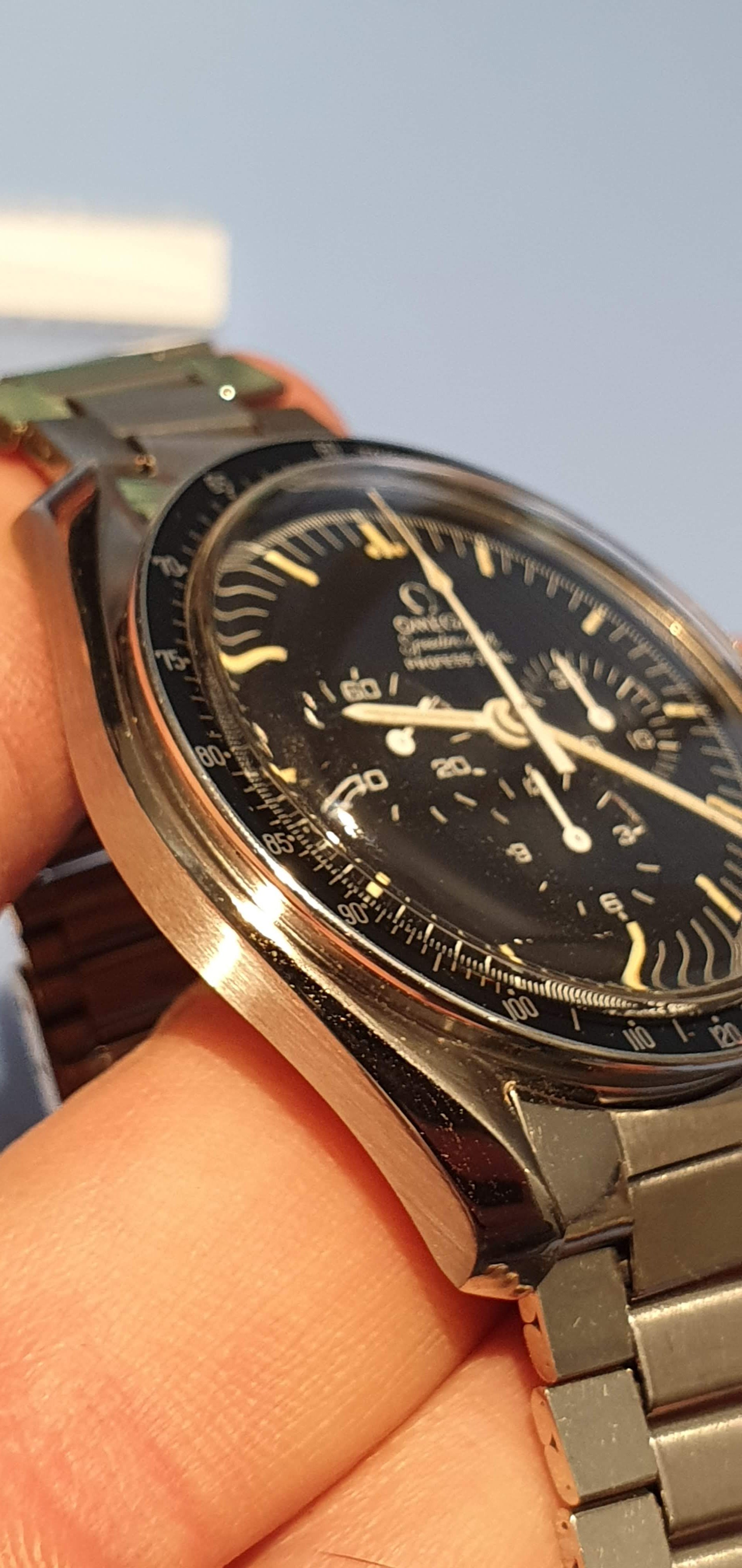

Here it is :
NB: What appears to be some strong impacts on the lower left lug is only light reflexion.

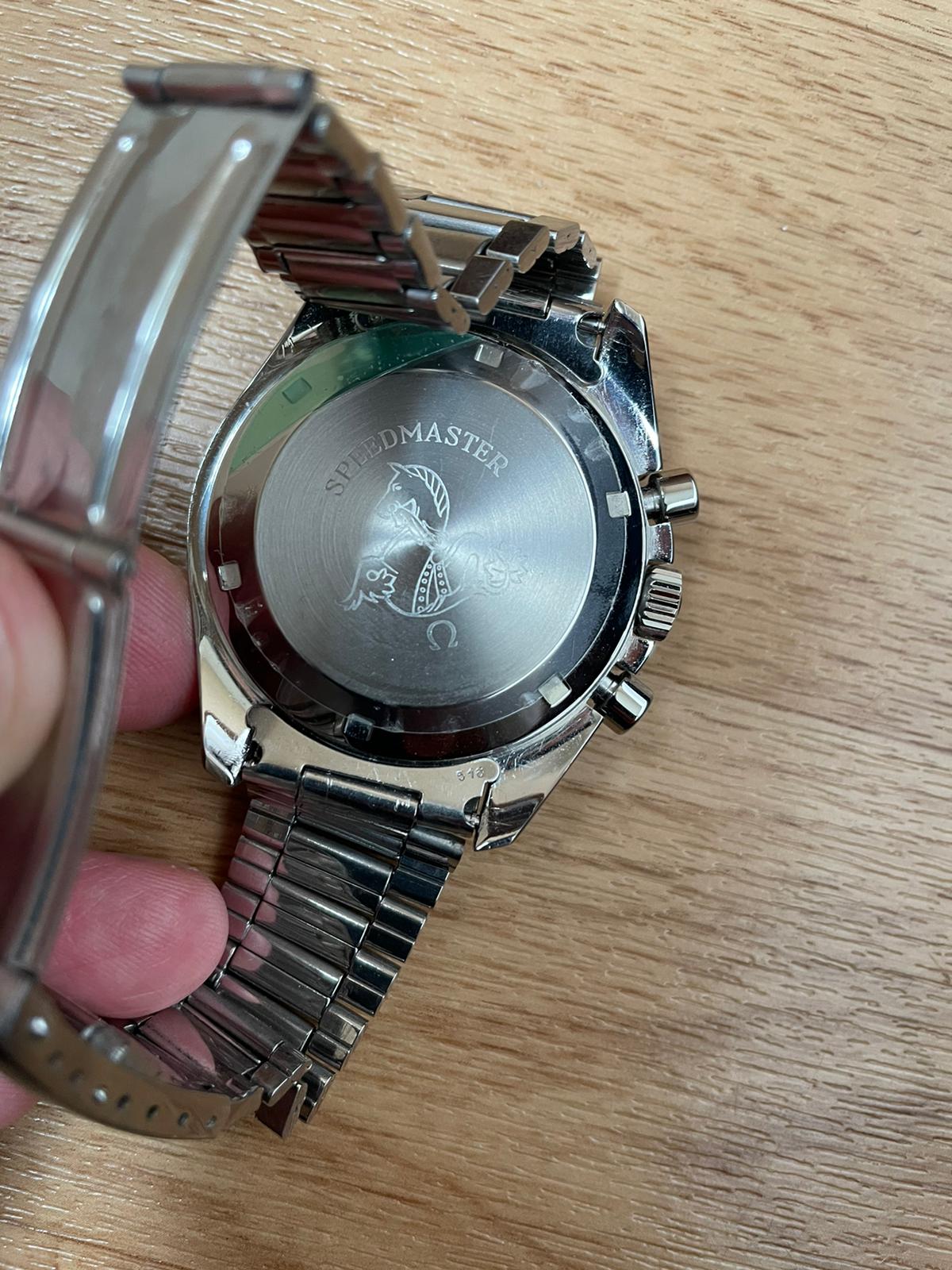

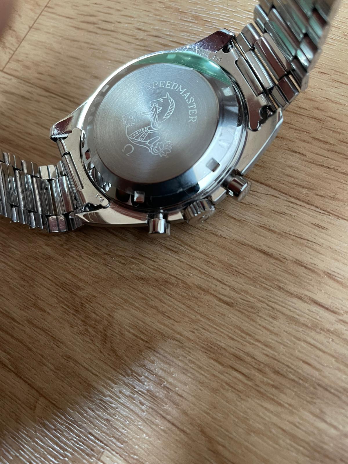

The photo is hard to see, but my sense is that the case has been polished and refinished. I'm also a bit skeptical about the seemingly unworn condition of the case-back, perhaps it was replaced at service. A 220 bezel adds little value to me, but at the very least you should make sure that the serial is correct for a 220 bezel. Is it between 30.6M and 31M?

I also thought it was a service case, but looking with a magnifier, I noticed few polished dings. The band is also very tight and last spring links are also firm, as if this watch sat in a safe for quite a while.
I checked this 220 bezel history, finding a dedicated thread here and the watch seem to match. EoA mentions 30.59m + October 70. 2 month old Omega service also confirms serial number.

No, I was not suggesting the case was a service case, you can clearly see the polishing at the edges, and the backs of the lugs have damage. I was talking about the case-back.
That serial is in the right range for an error bezel.

Sorry, wanted to write "I even thought..." not "also thought'. 😉
And agree on the fact that a guy did not remove the spring bars properly, leaving some scratches. 🙁

Once again, one of the most important pieces of information is missing. In this case two of the most important.
Does anyone else think the 516 end links look suspicious?
