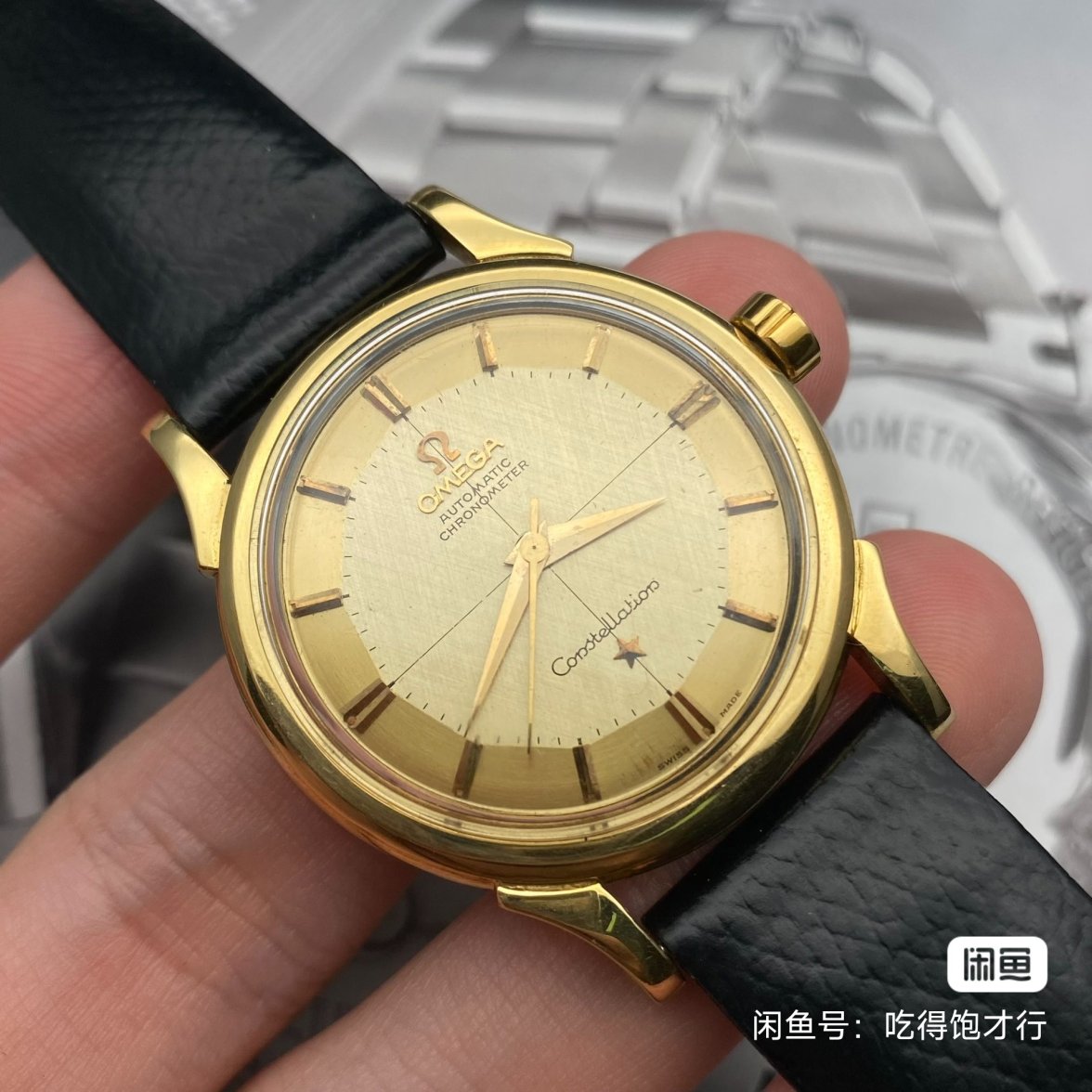

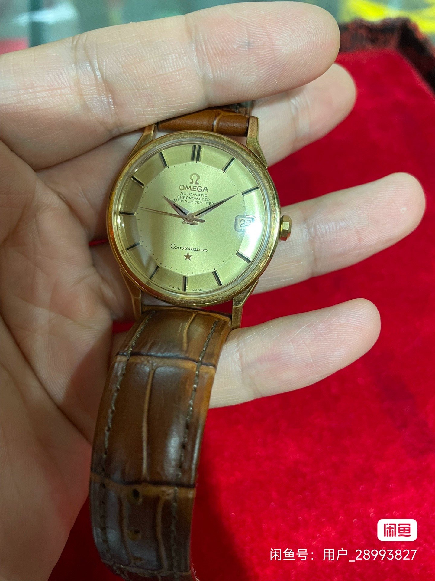

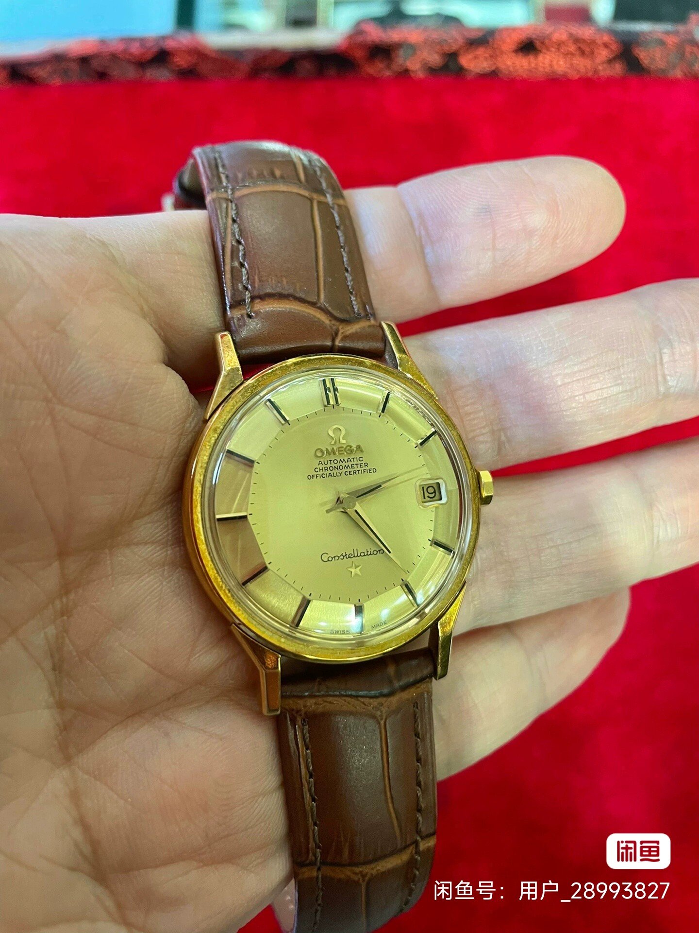

Again, this connie found in China is tempting me.
562
2,735
If correct, the dial is very uncommon.
I have never seen one before with a black half waffle pie pan dial with gold surrounds.
Omega didn’t produce this contrasting dial arrangement again for about another decade (168.025)
The fonts look good, so possibly a special for the eastern market?

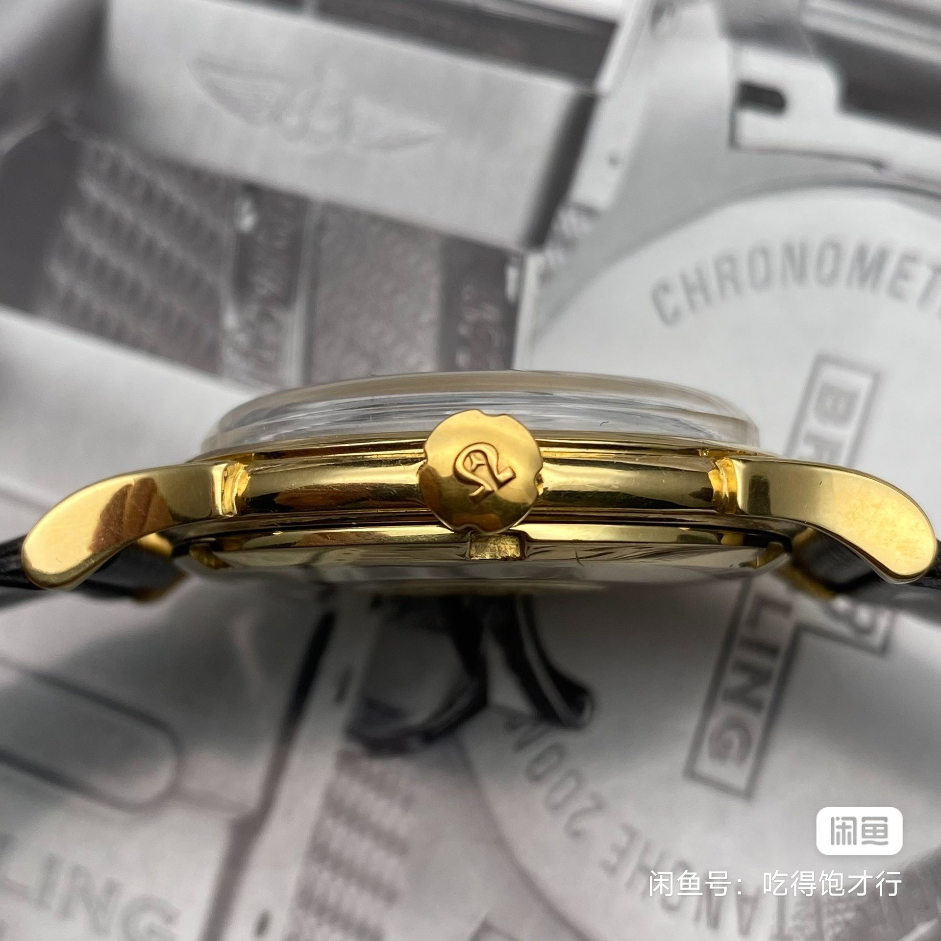

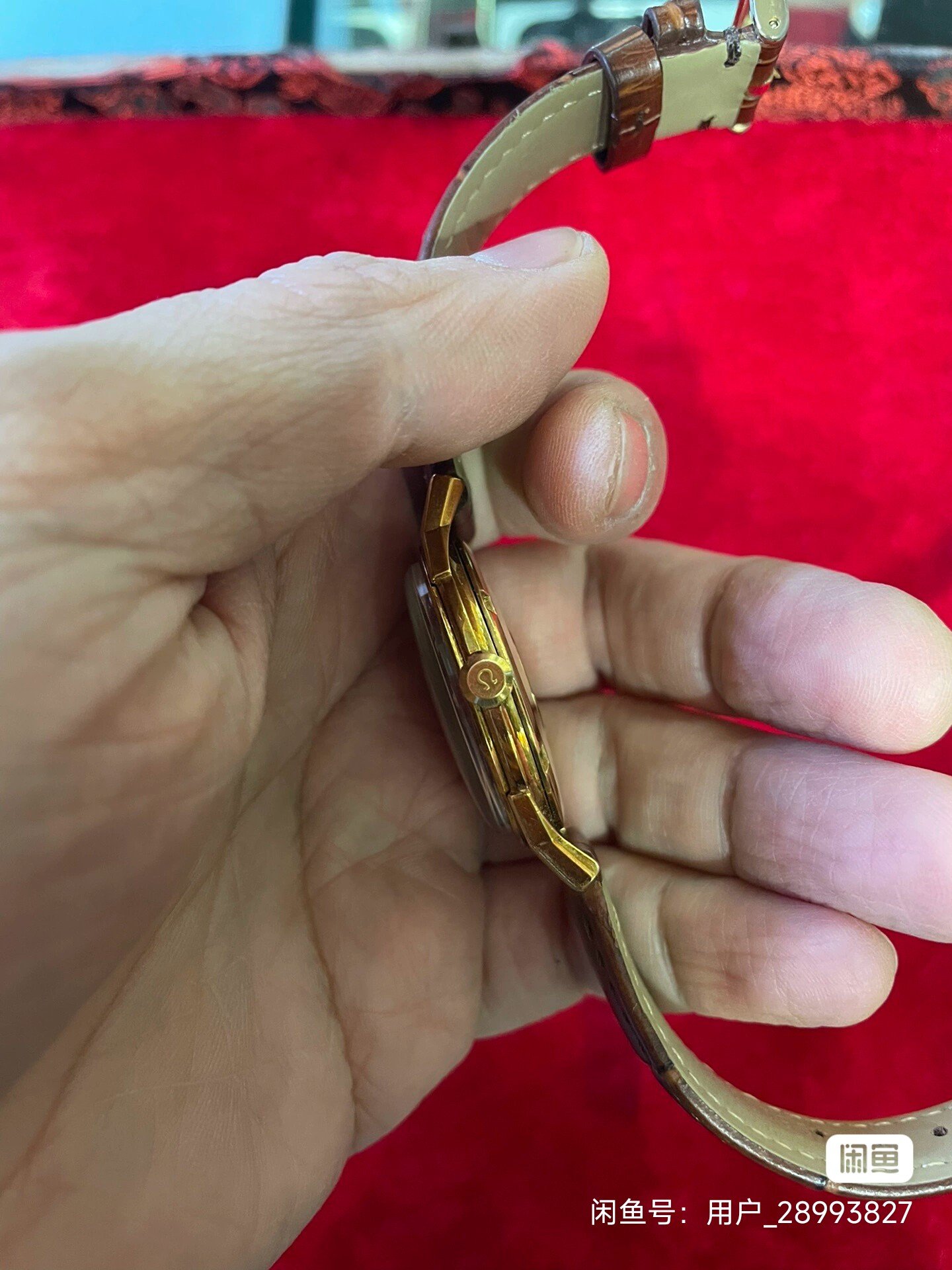

The case is really quite soft and the bottom left lug looks as though it might be bent.
It’s certainly unusual and a talking point but not at $3,500 IMHO.
yes, the case looks really soft. I'm looking for advice whether this dial is original or not. I have done some research and never seen a black half waffle with gold surrounding either. If it is original I will try to negotiate the price.

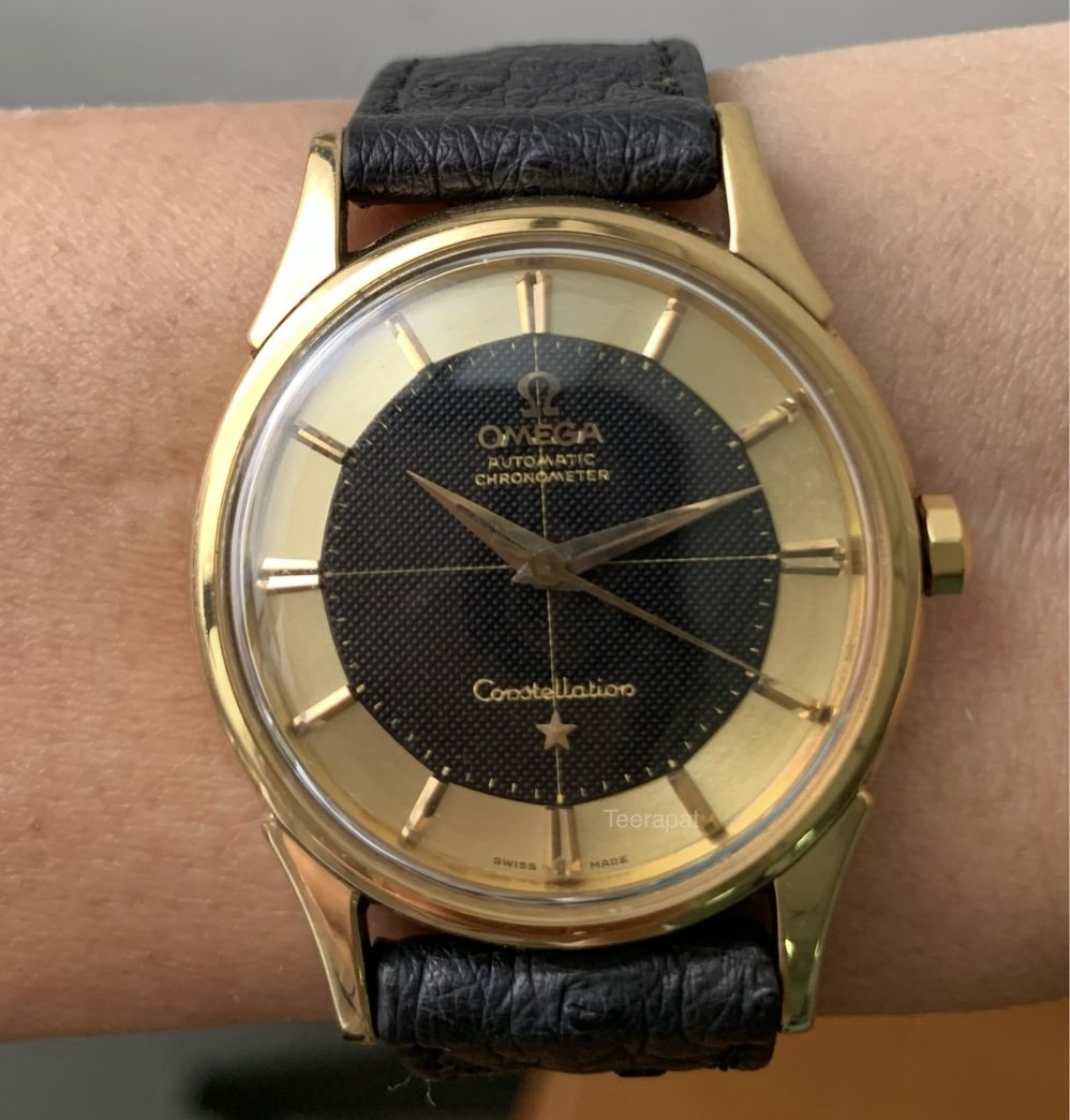

ok, @cqing
having looked at @qazwsx1 's version of the same dial, it would appear that your example is not the only one (and @qazwsx1 also says he has seen another couple of examples too)
This makes me much happier that it wasn't a redialler's fantasy dial.
My feeling is that it was a special for the eastern market as I don't believe there have been any like this posted on OF before now.
The script on both examples are remarkably similar, with heavily serifed fonts and quite thick lettering.
hope that helps.

ok, @cqing
hope that helps.
thank you @Peemacgee I offered 2500 USD for the watch.
The case almost looks sand-blasted, TBH.
lol, I agree, so I only offered 2.5k.

What makes you think that?
Hmm, just a feeling. But today I feel like it is original. I don't see strong serif in the word 'constellation'...
562
2,735

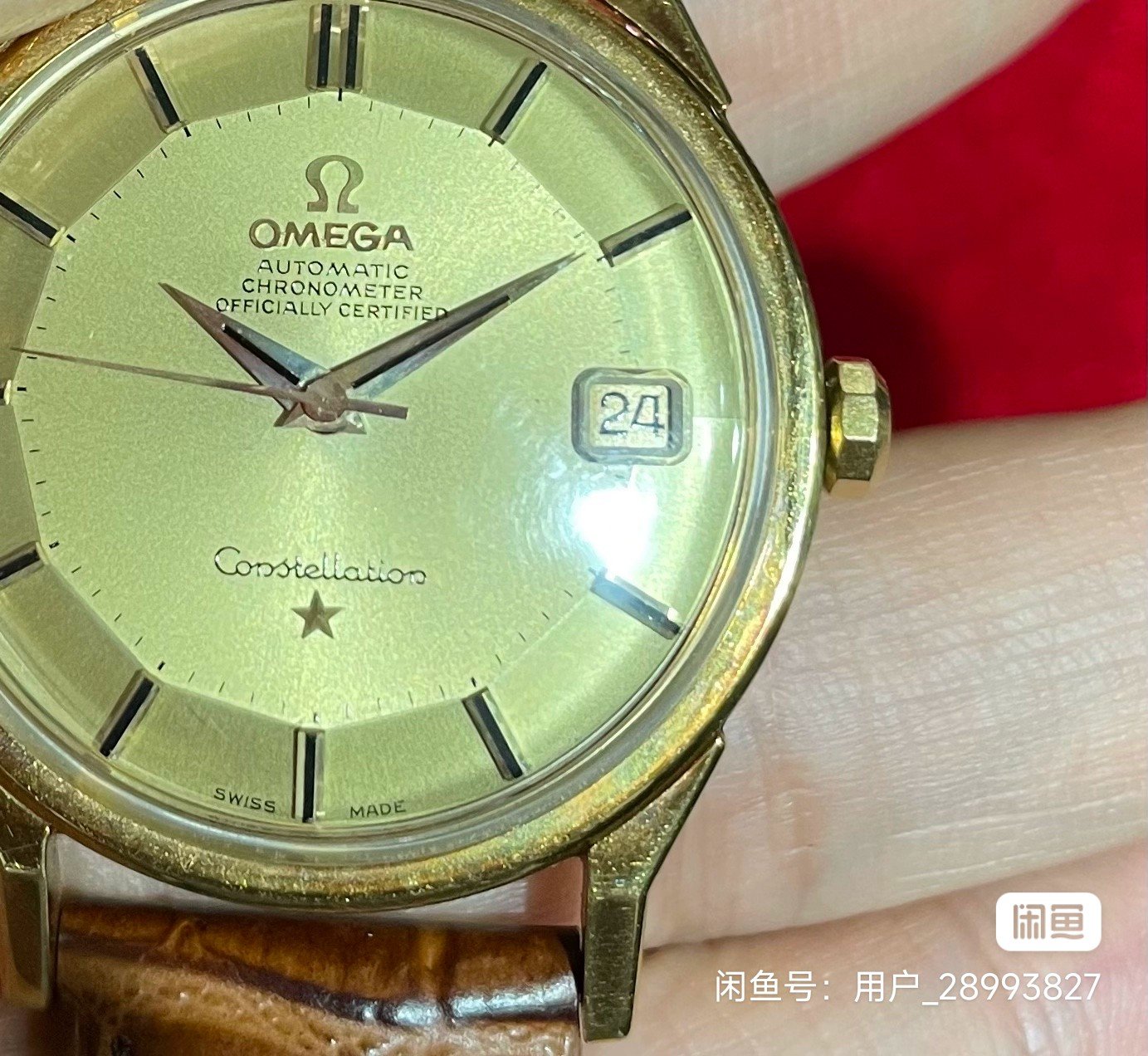

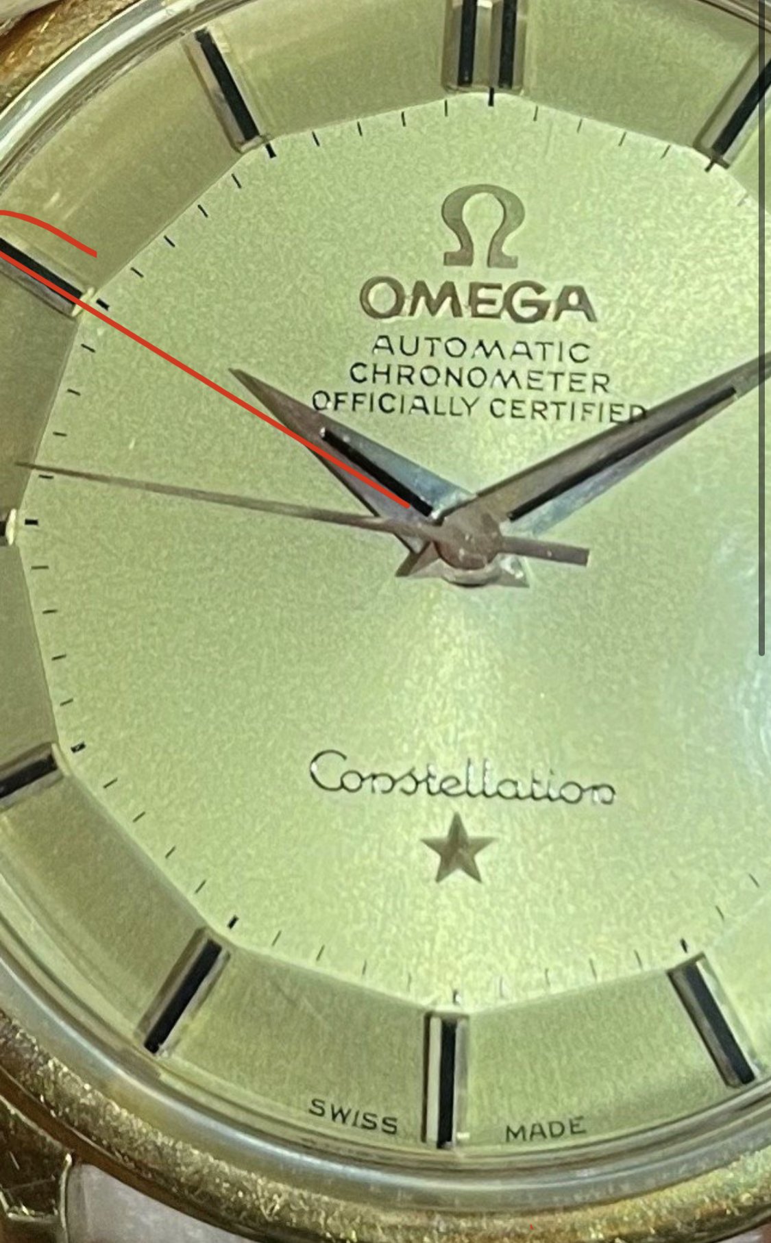

Aren‘t the dashes misaligned?
Yes, I also think the dashes are misaligned, but would this be just normal? The listed price is only $2800.

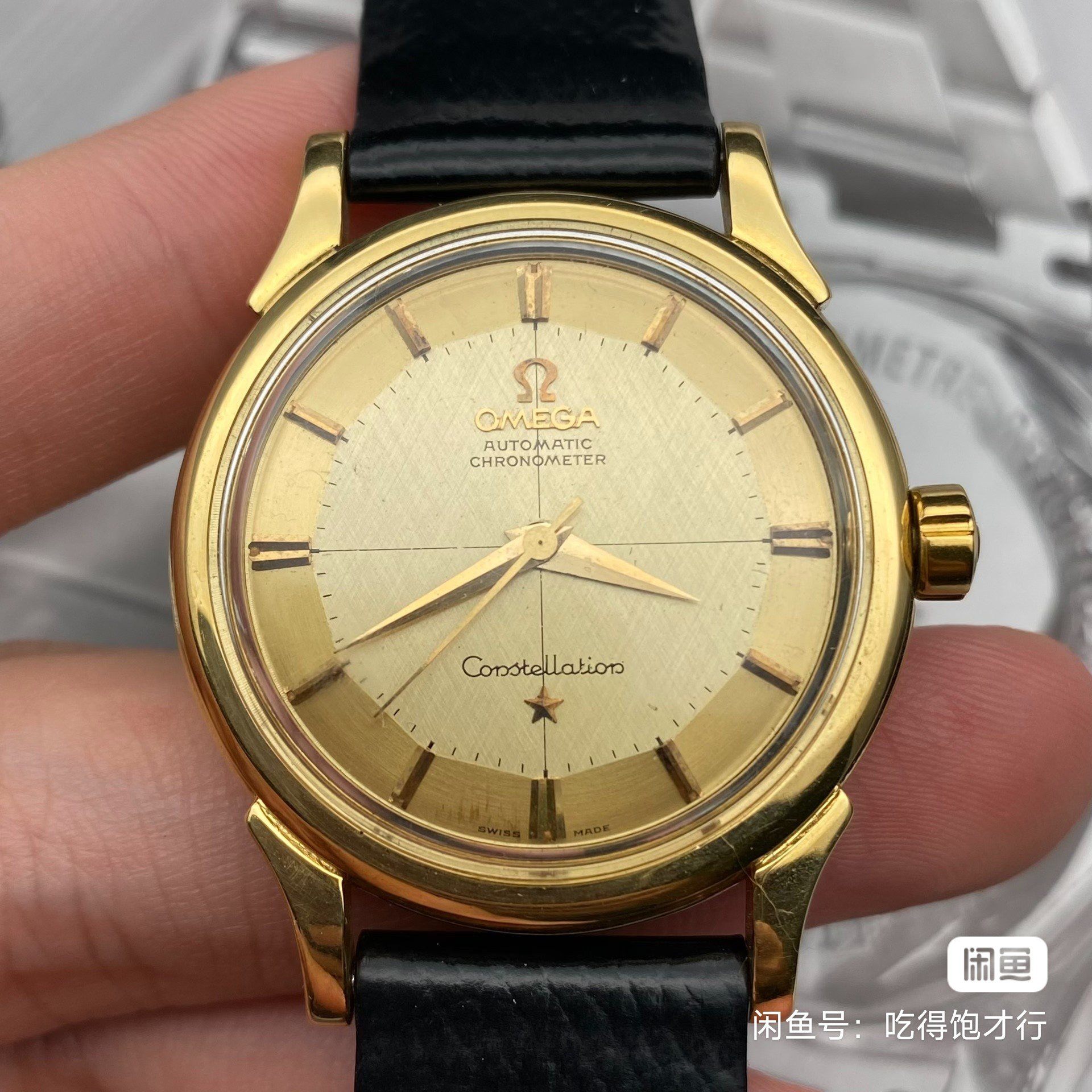

Look at what I found, a half linen dial de luxe 14381. Where is the crown originally from?
