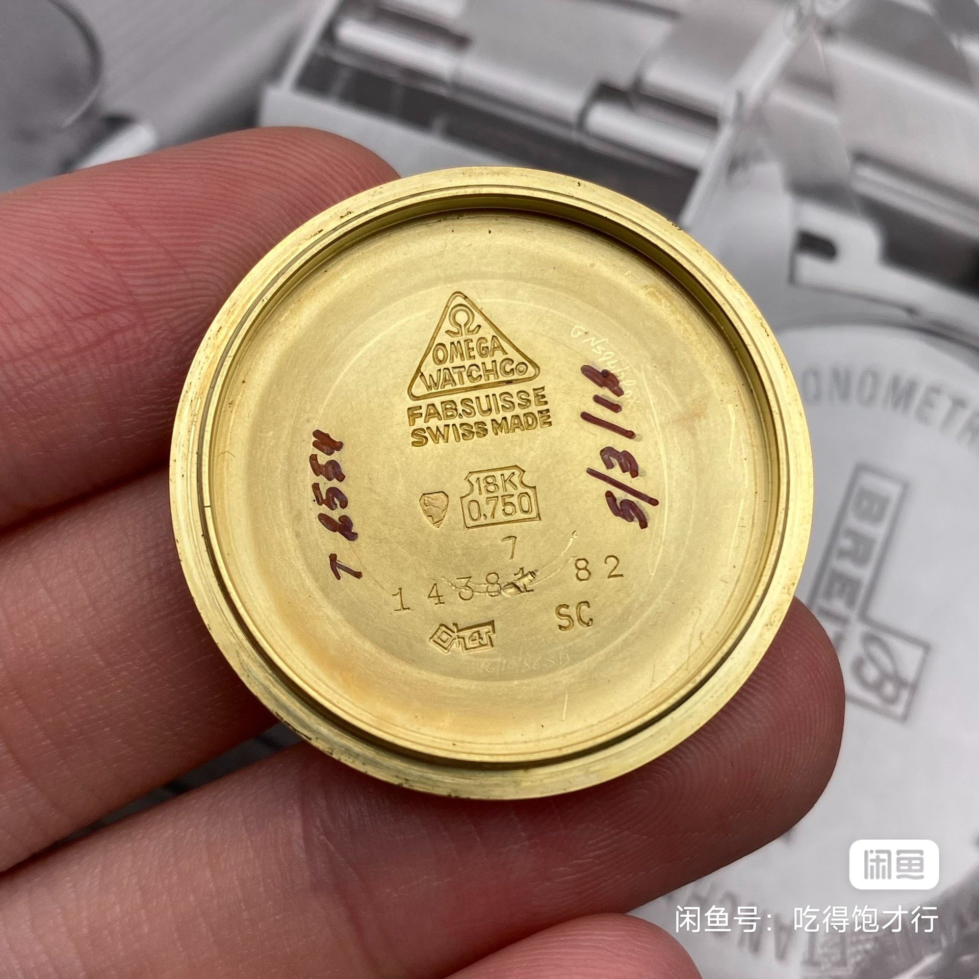

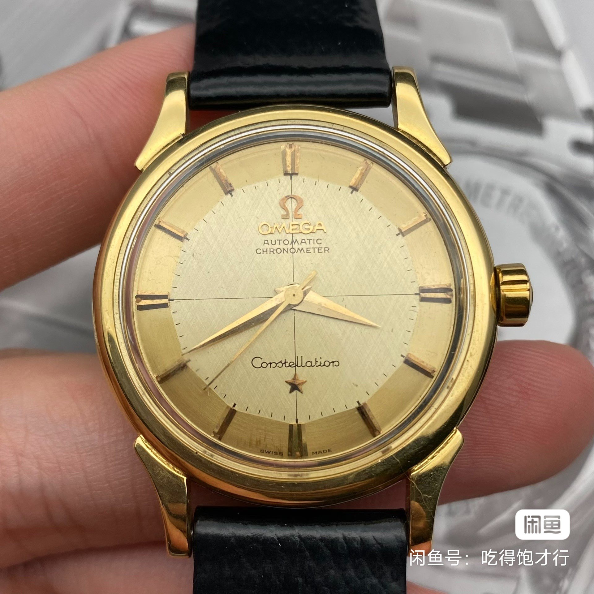

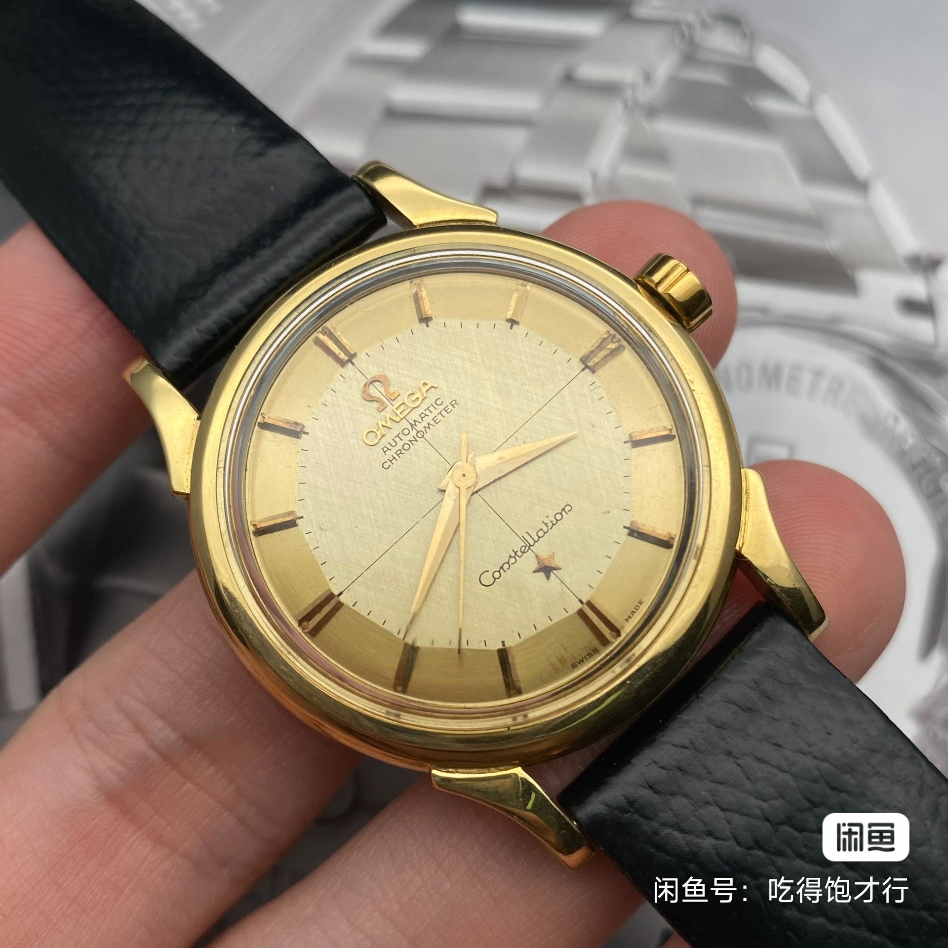

Look at what I found, a half linen dial de luxe 14381. Where is the crown originally from?
Very nice

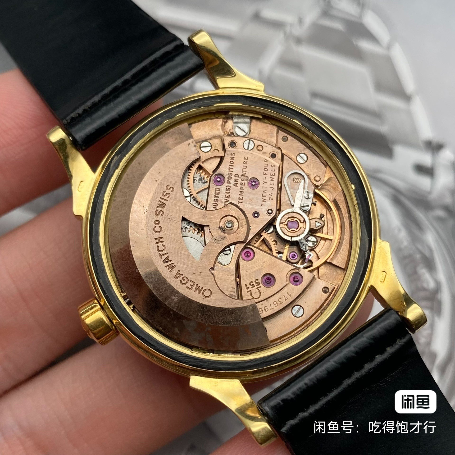

do you have pics of the movt?
inquiring minds want to know if this too was destined for the US market.

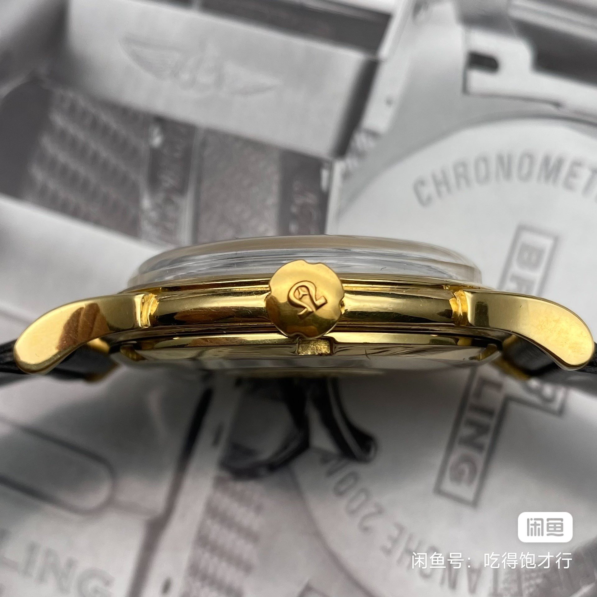

The crown is a Seamaster crown - but some have opined it could be original because has appeared on at least one contemporaneous advert.
(in this case its the wrong colour)
edit - once again, you would have to see the back of the dial to be sure it is a solid gold deluxe dial
1,120
1,792

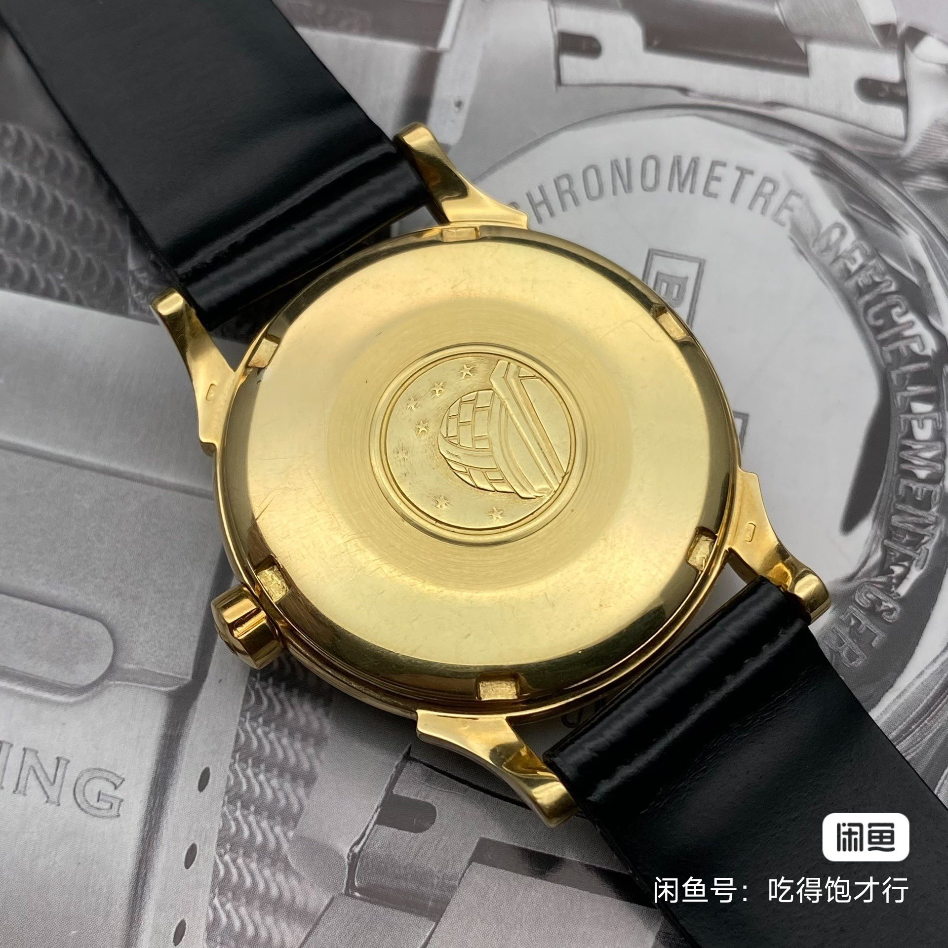

It’s missing the large onyx markers that would be associated with a de luxe dial, plus the case back reference would be 14381/2
6,835
10,505
It has the 14381 82 dual reference caseback but I agree that a European deluxe dial would likely have fat flat onyx inserts.
However, somewhere in the back of my mind I think there are later gold linen dial c cases plus this is likely a US or eastern market Connie so may not follow the same norms.
2,816
6,951
I’m not sure about this one. First, was there really overlap between when this was made and when other linen dial Omegas were made (60s)? Need serial to confirm.
Second, those inside caseback engravings seem rather crude.. I’d like to see the outside of the caseback.
Third, at least the hands have been replaced given the dial has lume plots.
6,835
10,505

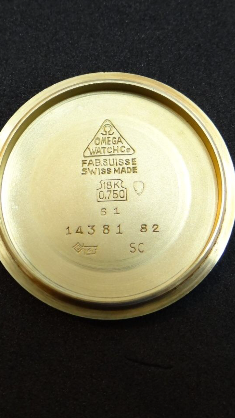

Not sure when the first linen dial was produced - definitely right to bring that up.
The caseback engravings on these references are really quite crude ( I was just having the same conversation with another member. )
Here’s mine.
1,024
4,126

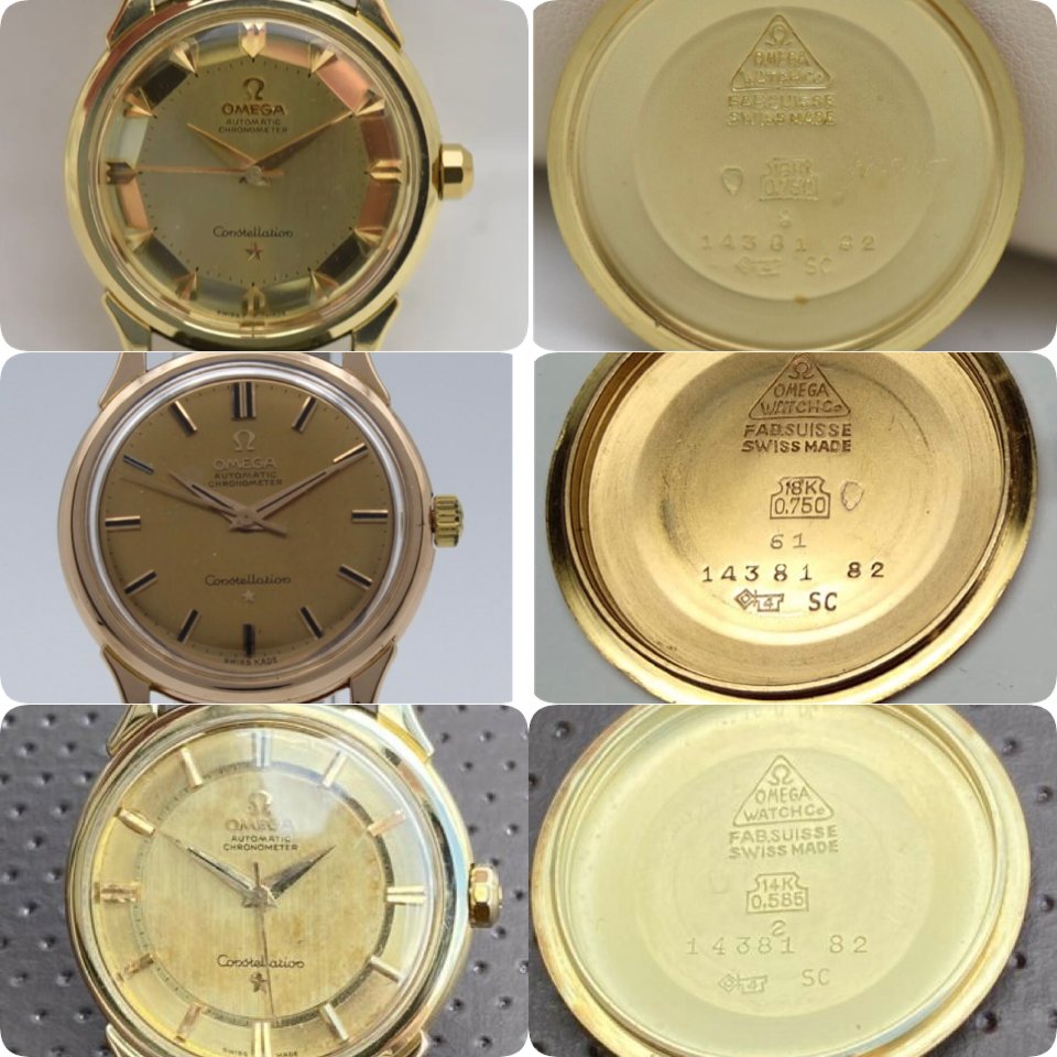

The example of 14/18k model that I found use 14381 82 SC but difference in the number above that reference.
I am not sure what’s the meaning of these numbers (2/8/61 according to my example)

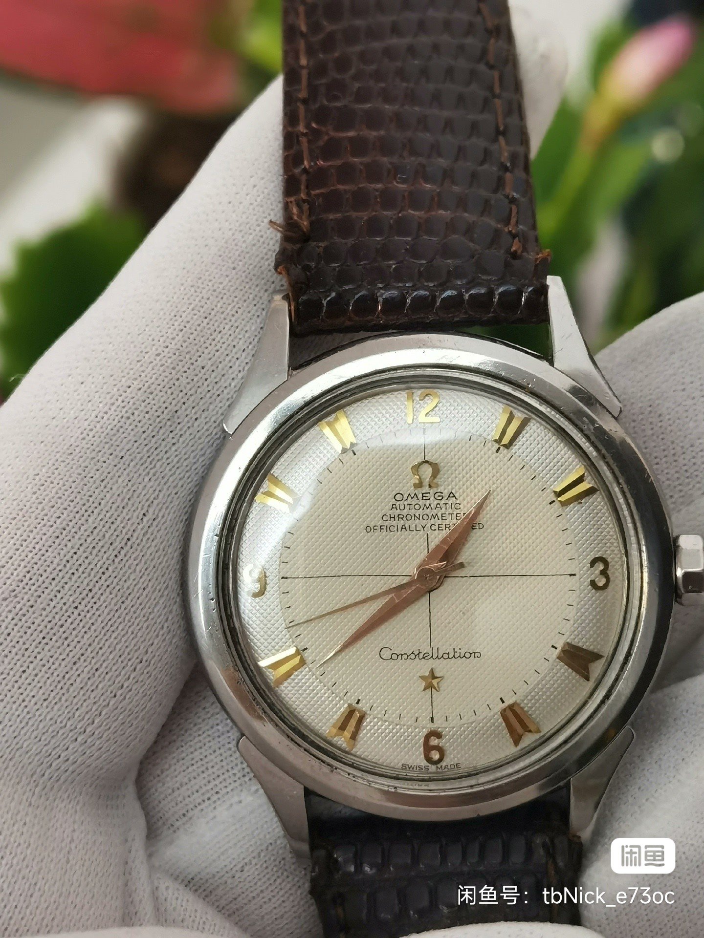

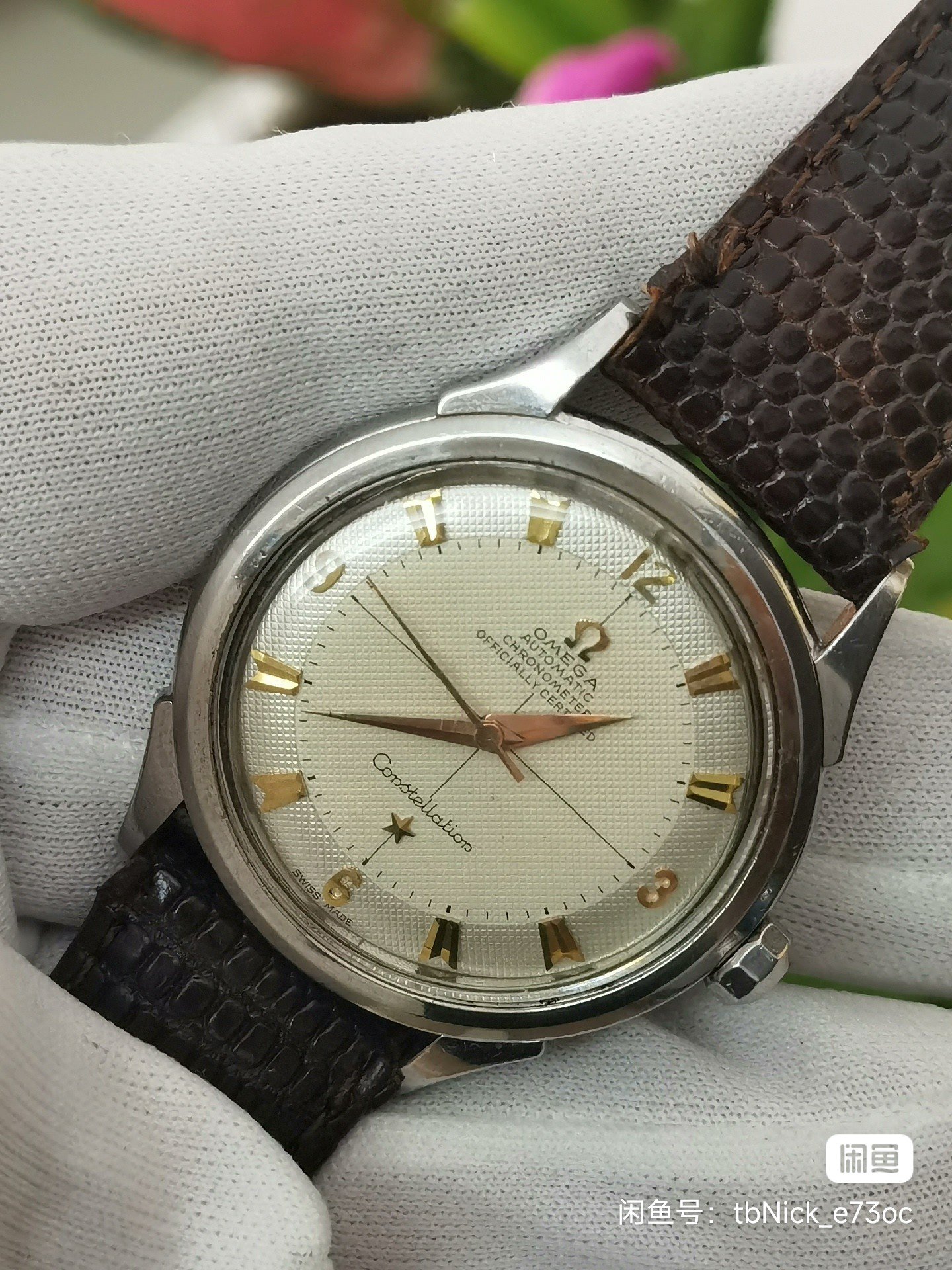

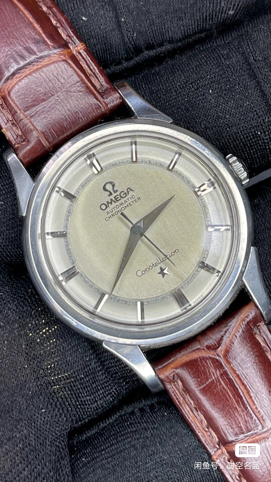

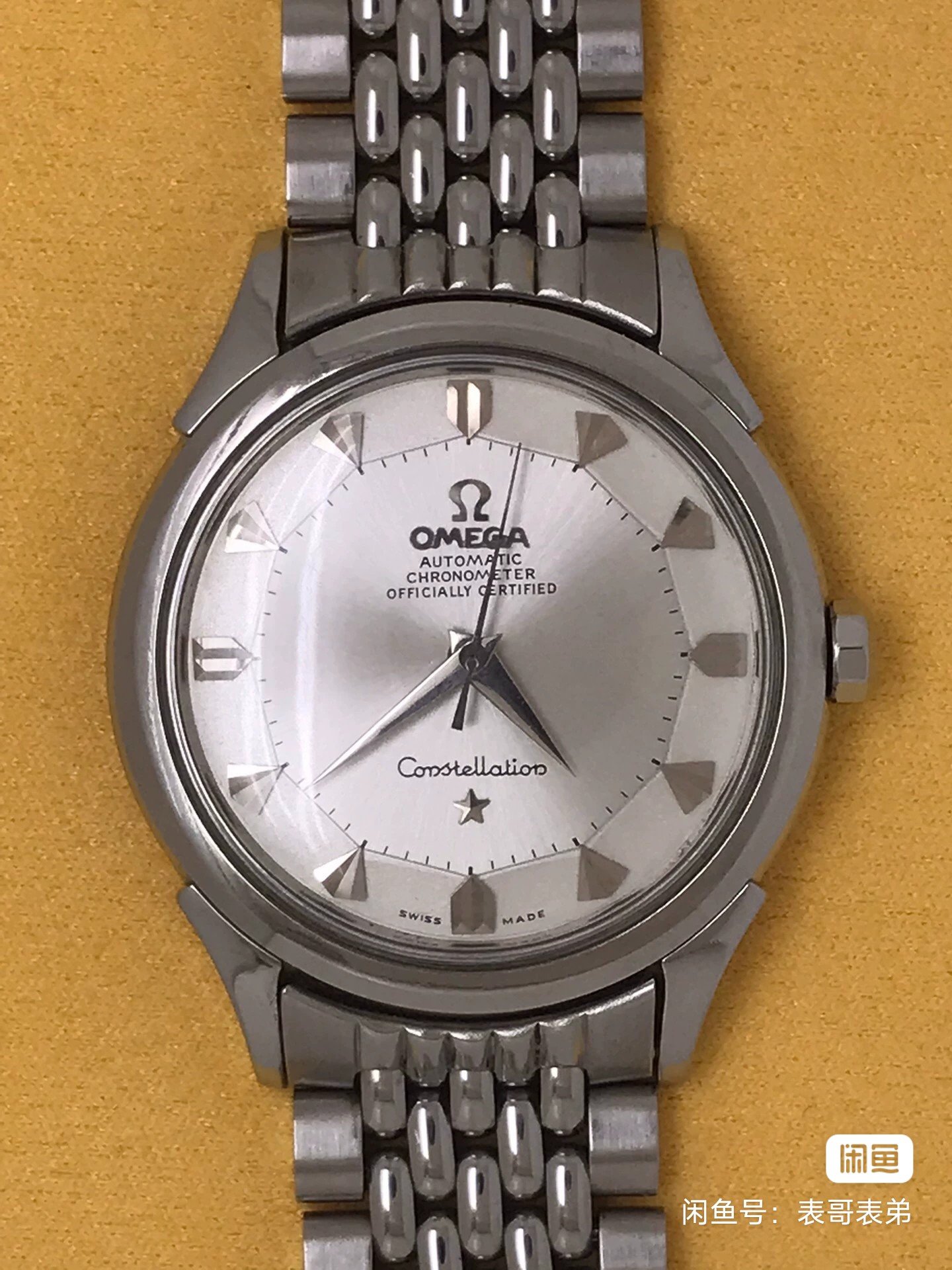

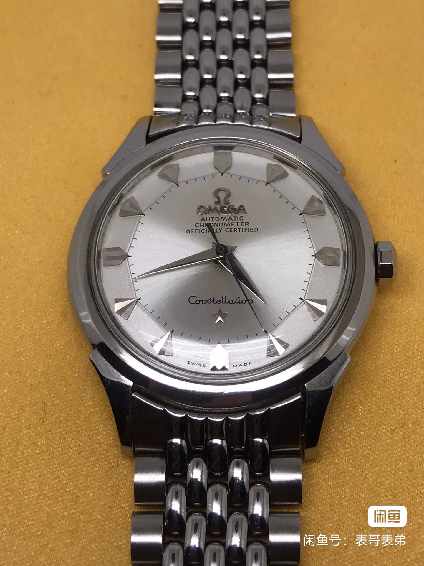

Need your opinion on these 2 dials. The horizontal cross line of the first honeycomb connie is not straight. The second one also not looking good to me...
2,270
15,731
No good, either of them
6,835
10,505
Both redials.
Constellation crosshairs ALWAYS go through the text.
The font is wrong on the second.
6,685
11,654

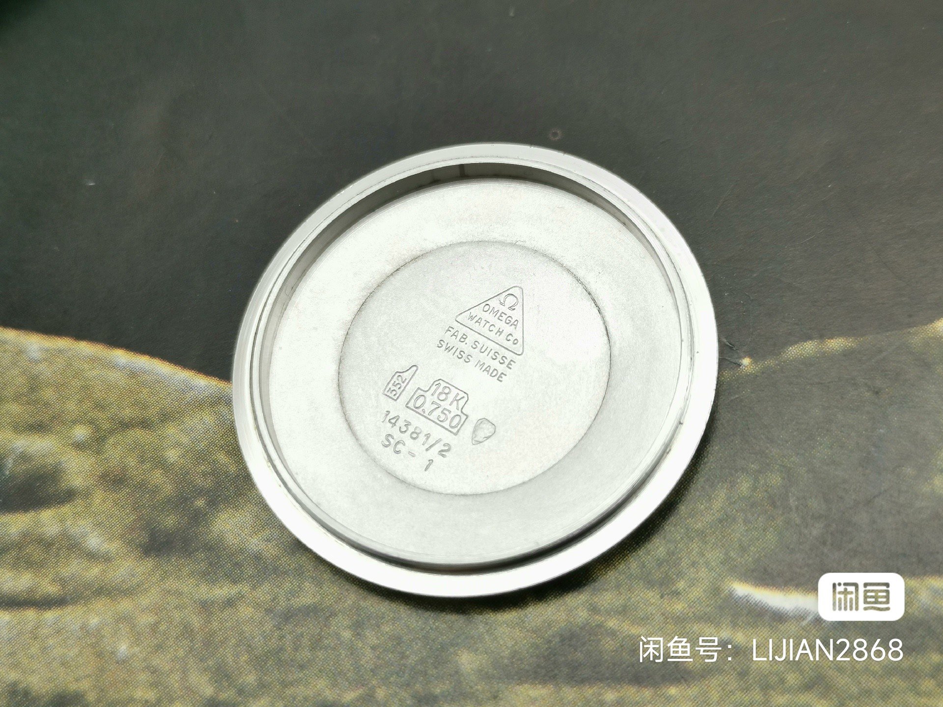

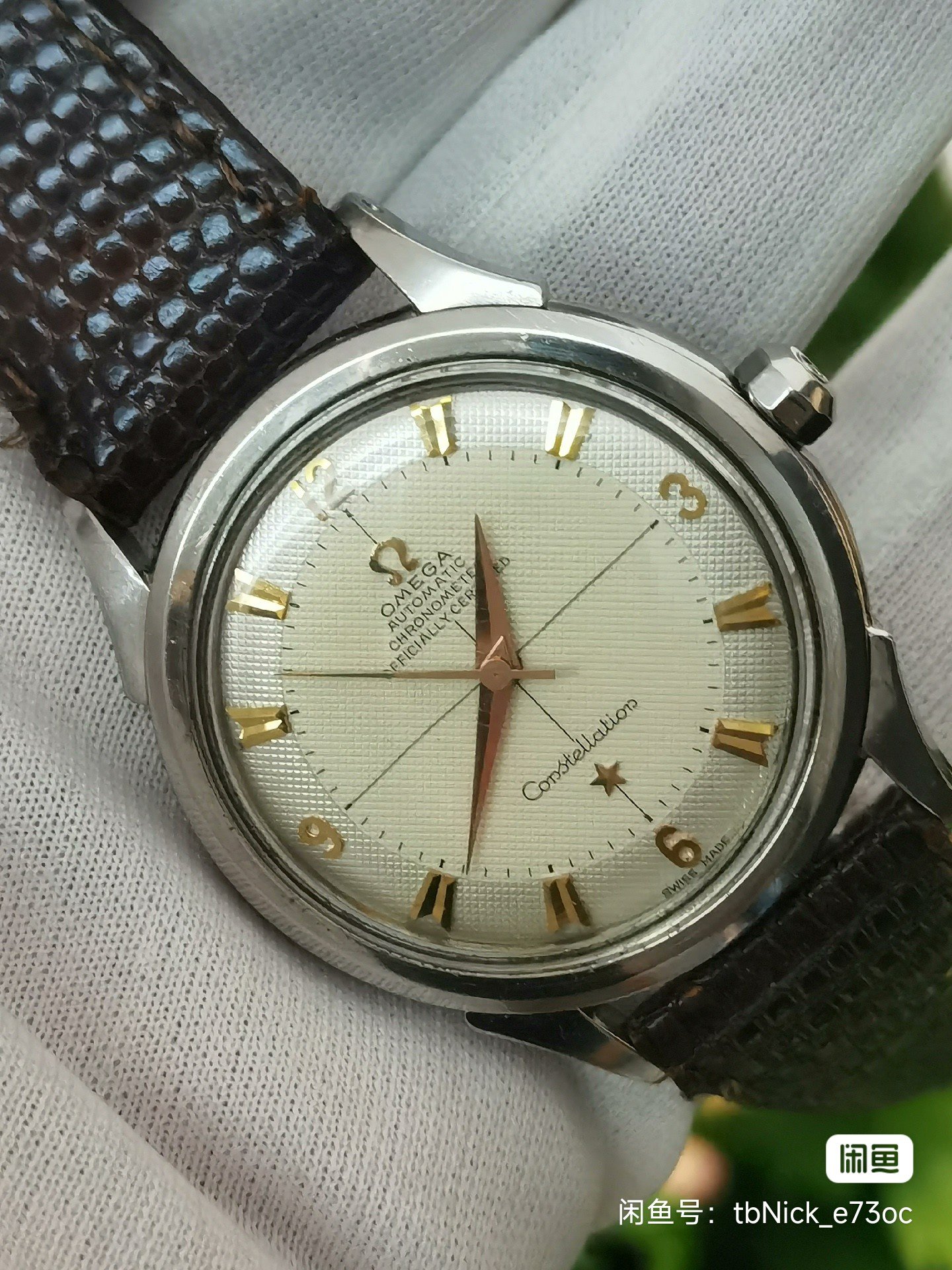

bought this one for $770.
What a steal. Congrats. Railtrack connies with good dials are hard to come by and this one is even a rarer non-lume variant. I also like the original thin scallop crown that is often replaced. Some will say the case is soft. I wouldn’t care a second given the price and this dial. Very well done.
