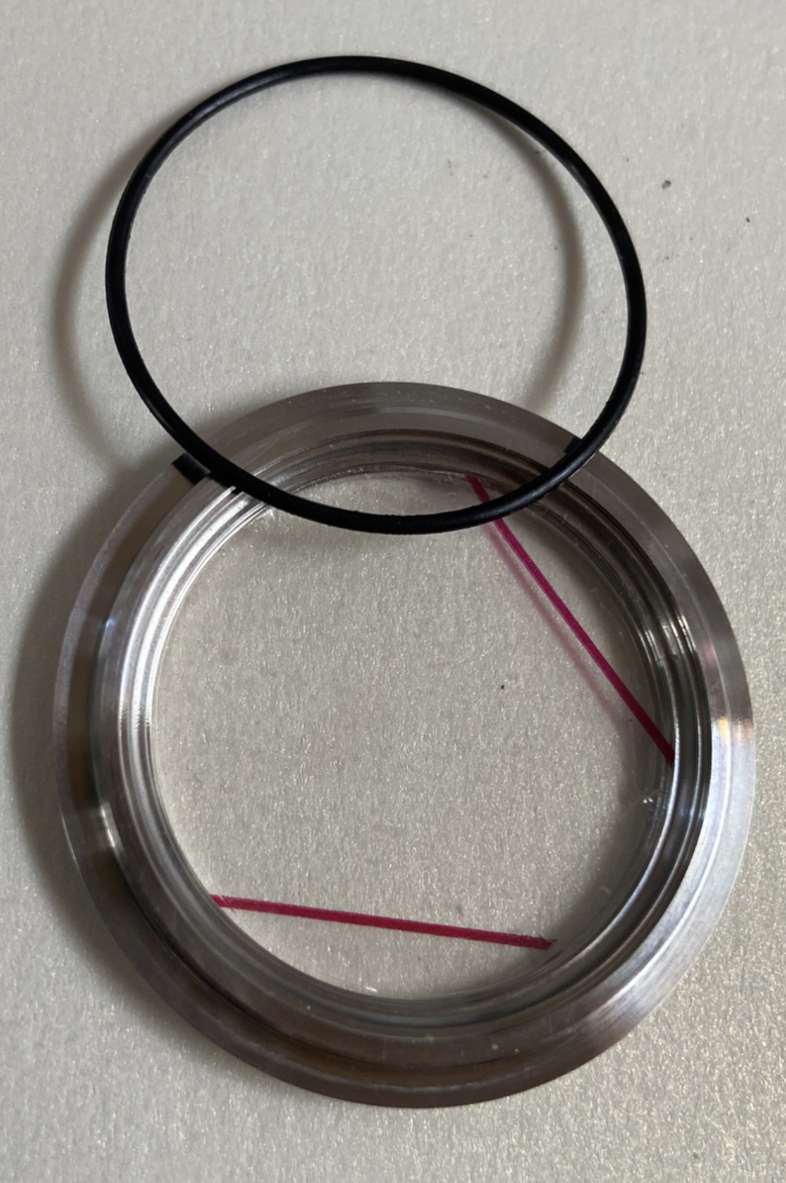

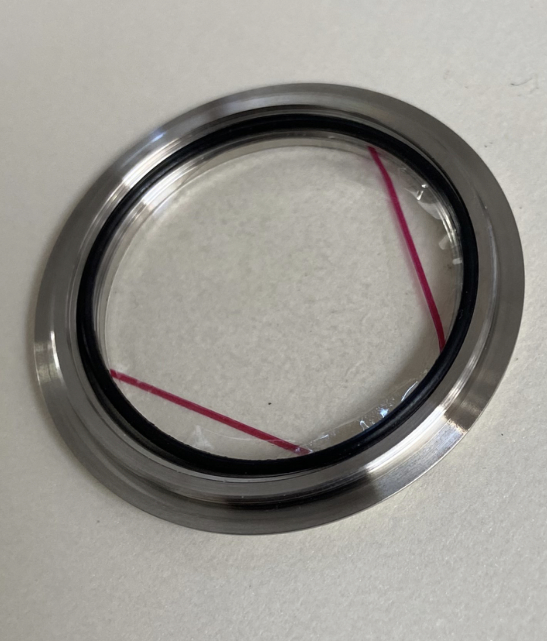

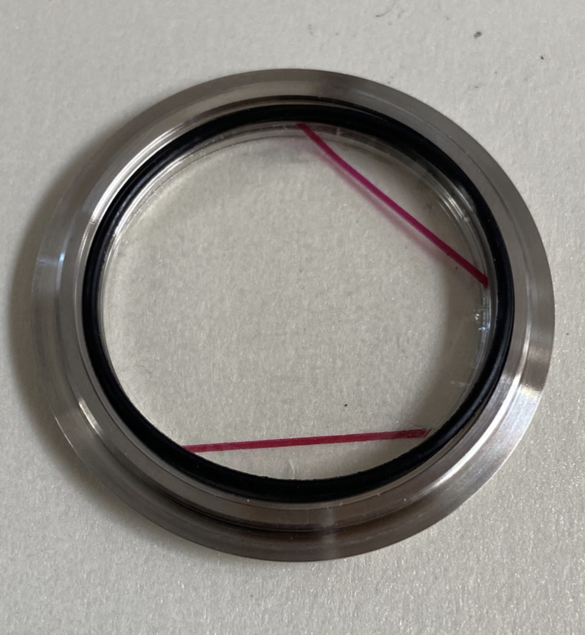

Thanks, good to know. Should the inner o ring sit in a channel within the case back to keep it in a round shape? Or it's just loosely laid in there and you hope for the best when screwing the caseback down? The reason I ask is I noticed the attached photo from another forum member (@mutanthands) where the gasket doesn't appear to have made proper contact. However, it might just be my eyes and what I think I'm seeing in the photo (circled red) isn't actually the gasket.
It’s not so much a channel (like the actual Case o ring) but more like an area for the o ring to sit against.
These images belong to @140dave and can be found at his recent listing
https://omegaforums.net/threads/speedmaster-sapphire-exhibition-caseback-aftermarket.157807/
There is no grease on the o ring and it does sit flush against the movement. The o ring will last as long as you don’t repeatedly remove the case back.

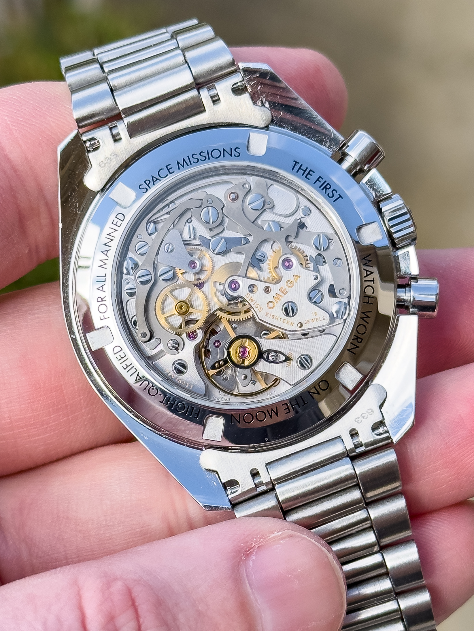

Just sharing this one once more because I like it. Metal brake upgrade to further compliment the sapphire case back,

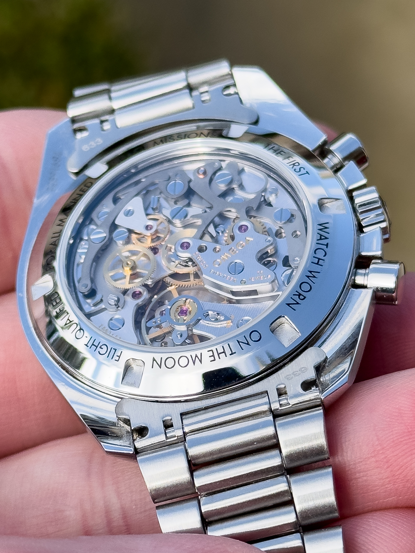

Thank you to those who posted pics. I have now installed one on mine.
Looks good. Pleased with the result?
5
Yes, I haven't detected any negatives so far. The watch wears thinner, as others have pointed out, and I like the fact that most of the engraving is there except for "by NASA"

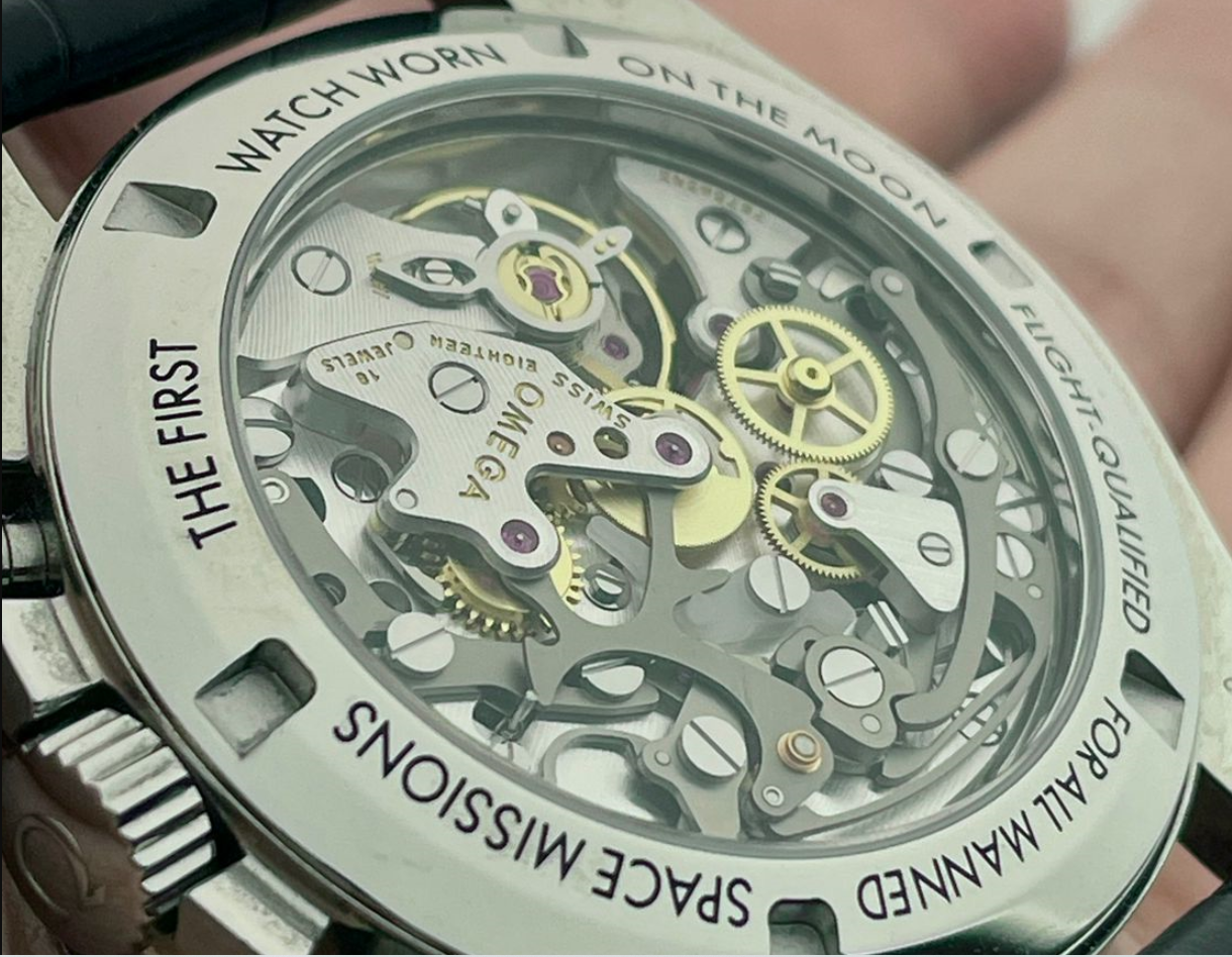

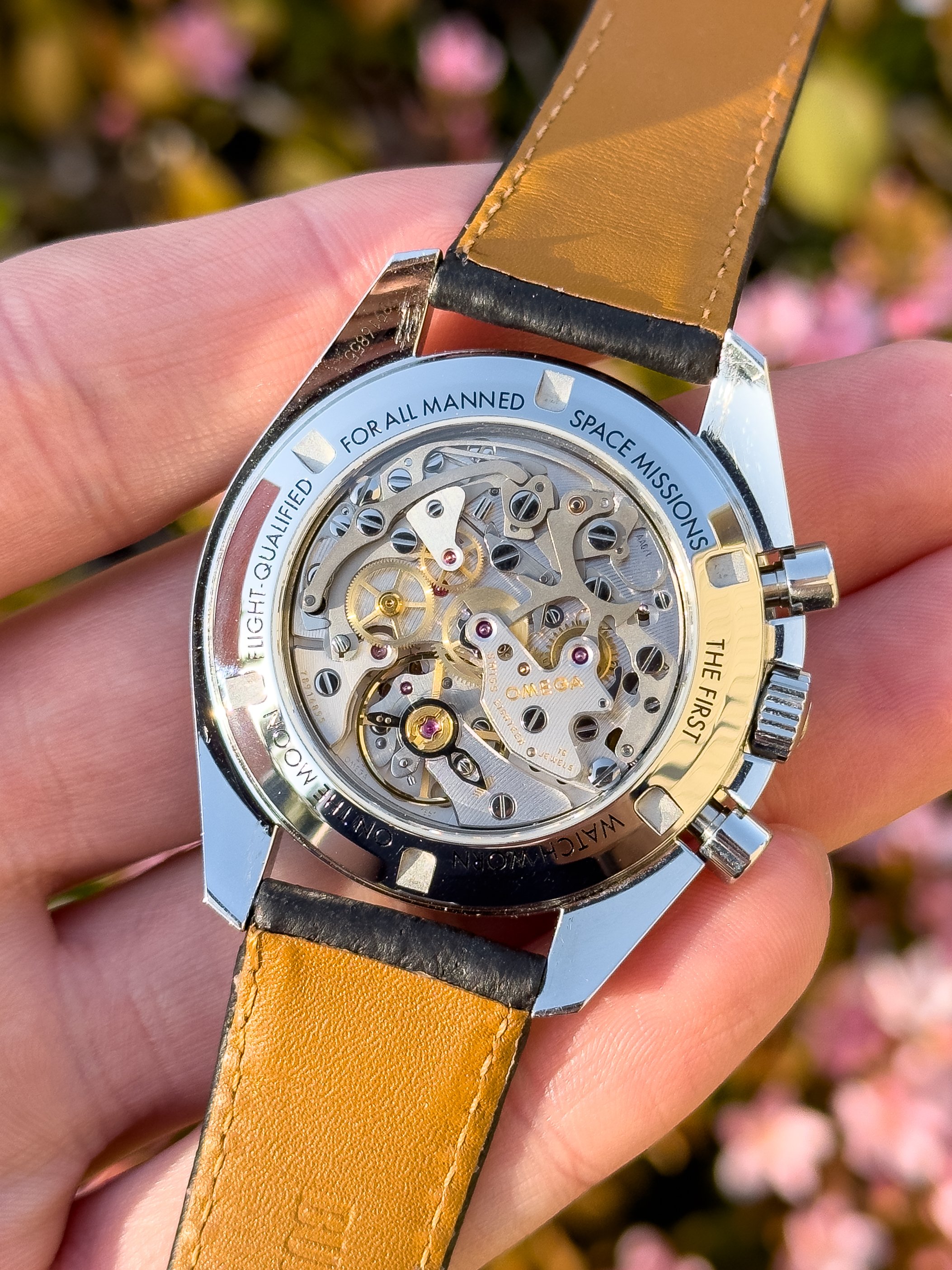

I got an update that spiralwinder casebacks are now in stock and noticed they have an engraved option. I’d love to get an OEM exhibition back, but as those are quite pricey and harder to find, I was happy to try out spiral’s option. It just arrived and it’s quite nice. No idea how well the enamel will hold up, but for the price and quality, this definitely scratches the OEM itch. 👍

Hey, yes I have modified the movement so that I have the metal brake. No benefit other than for looks 😀
And yes, I can confirm that this caseback is very thin and wears as such.
