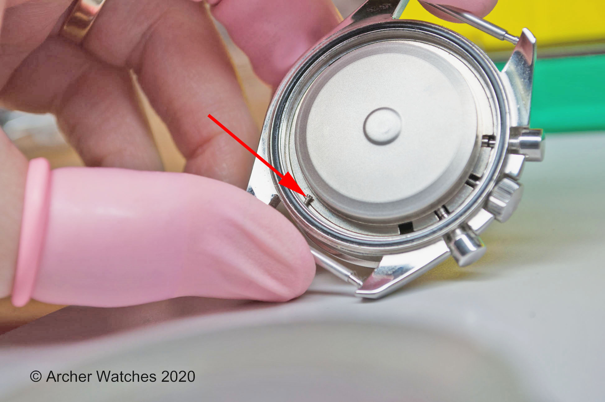

There are different ways of addressing this issue of broken dial feet. The "gold standard" sort of repair is to solder new dial feet on, and to that end I have a dial foot soldering machine that uses electricity to generate the heat to melt the solder. To be honest I've never been able to get what I consider to be a satisfactory result with this machine, despite hours of testing and tweaking - trying different solder, different flux, etc..
I have a friend who is a goldsmith, and I took a test dial over to him a while back to have him try laser welding some dial feet on a dial. The heat required was too great for it to be done on a painted dial - it would most certainly have damaged the dial on the front side. He solders things all the time, so he had a go using his small torch - the solder joint was great, but again it would have damaged the front of the dial due to the heat required.
I have spoken to many other watchmakers who also struggle with finding an acceptable solution that won't put the dial finish at risk...
As much as dial dots are pretty much a hack repair, the good thing about them is that they do no damage, and don't create a situation where the dial can't be fixed down the road if a good solution presents itself.

As I mentioned before, the post / foot was held in place very securely by the dial screw when I opened it up. Maybe the added tension caused the foot to break, because there was no play when the watch would turn / rotate while being handled. Maybe this put additional stress on where the foot is attached to the dial?
If you are suggesting this was somehow overtightened, and that lead to this problem, that's not really the case.
Dial screws need to be fastened very securely, or you end up opening watches and finding them laying in the case, like this:
Putting them in place "very securely" is what is normal.
Cheers, Al
Cheers, Al
