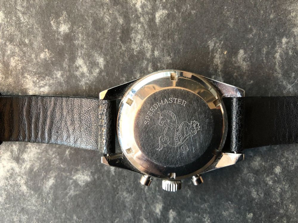

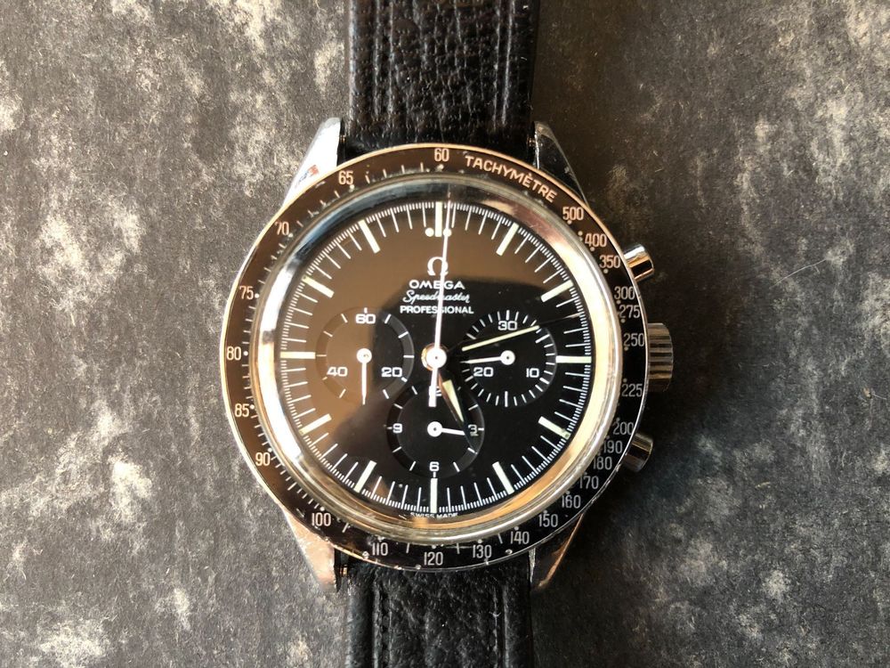

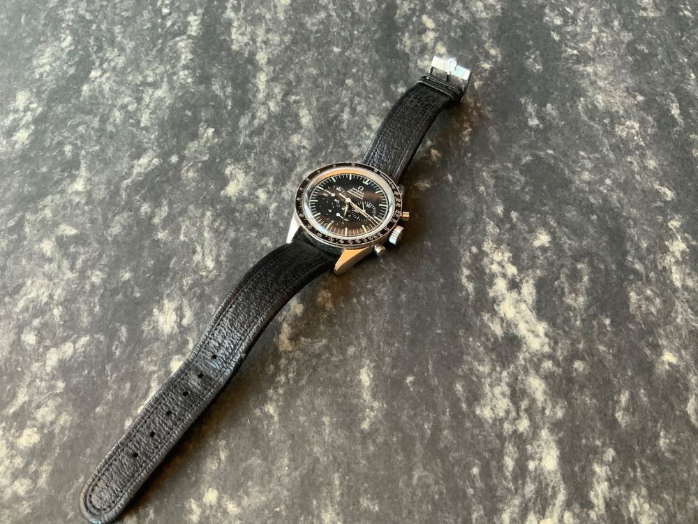

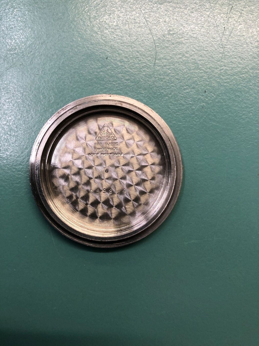

Hi Guys

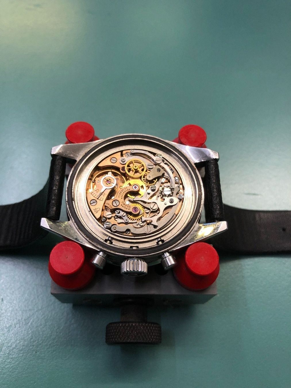

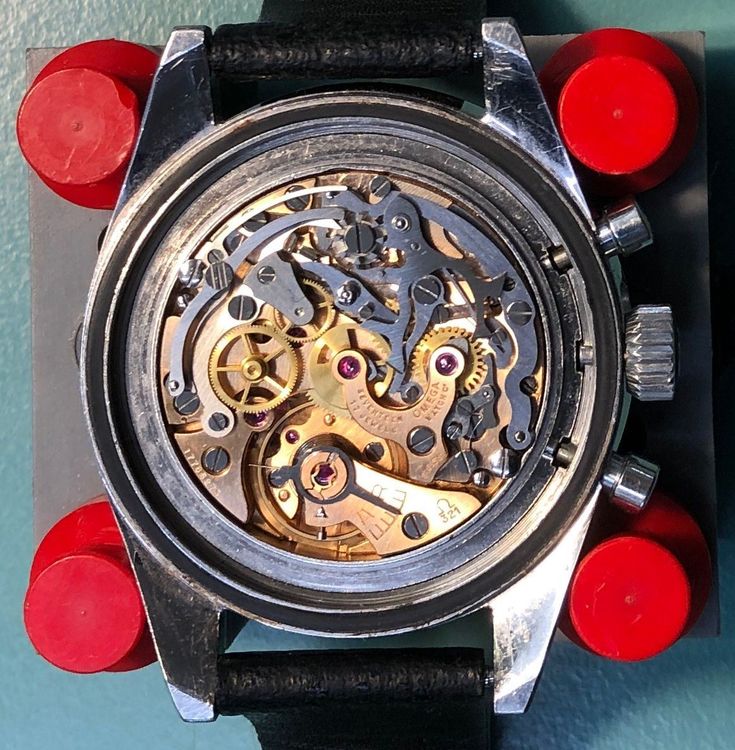

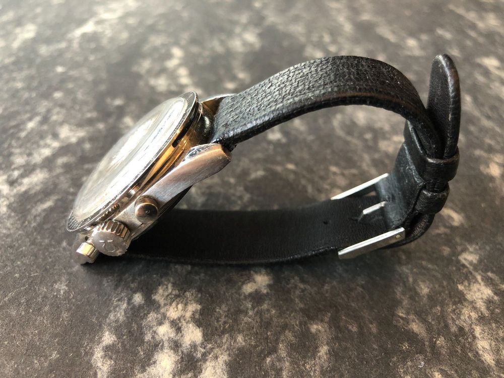

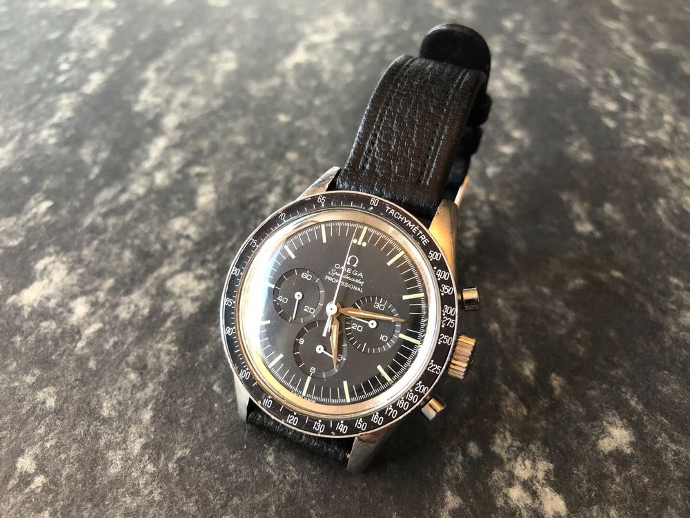

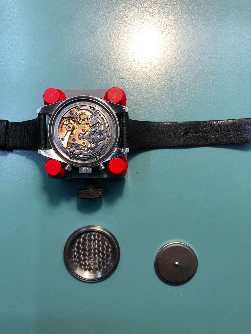

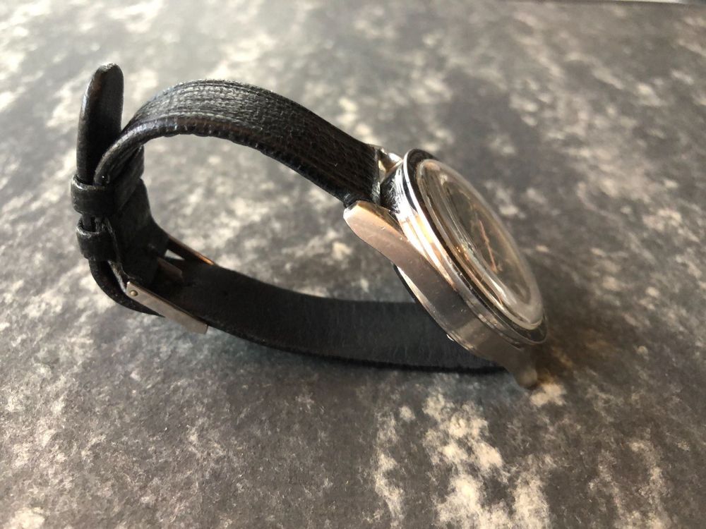

I have a CK2998-4 on my Radar. Below you can find some Pictures.
In general the watch looks legit in my opinion. Caliber 321 and serial shows the watch was produced in 1960. The hands and dial seem to be replacement parts (as I’m not able to see any patina). Do you have any idea from where these replacement parts are (can’t be from FOIS as the subdials are white)? Are this legit replacement parts from Omega?
What about the crown and pushers? Are this original or replacement parts as well?
and please feel free to mention if I’m missing anything 😉.
According to https://speedmaster101.com/price-chart-2/ the value of a CK2998 should be at 8000 for poor and 14000 for working. What do you think would be a fair price for this watch in this condition?
Thanks a lot in advance for the Inputs and advice.

Hey there!
I would definately pass on this one. There is almost nothing left that originally belonged to a 2998-4.
Wrong dial (even with patina it would be wrong, should be a dial with applied omega logo), wrong subhands, right alpha hands, but to new in comparison to the rest. And last but not least its polished to hell. 👎
E: Crown and pushers are looking legit. Cover too. Serialnumber is in range of a 2998-4 (early production range).

Hey there!
Wrong dial (even with patina it would be wrong, should be a ), wrong subhands, right alpha hands, but to new in comparison to the rest. And last but not least its polished to hell. 👎
Thanks for that. Really helpful!
