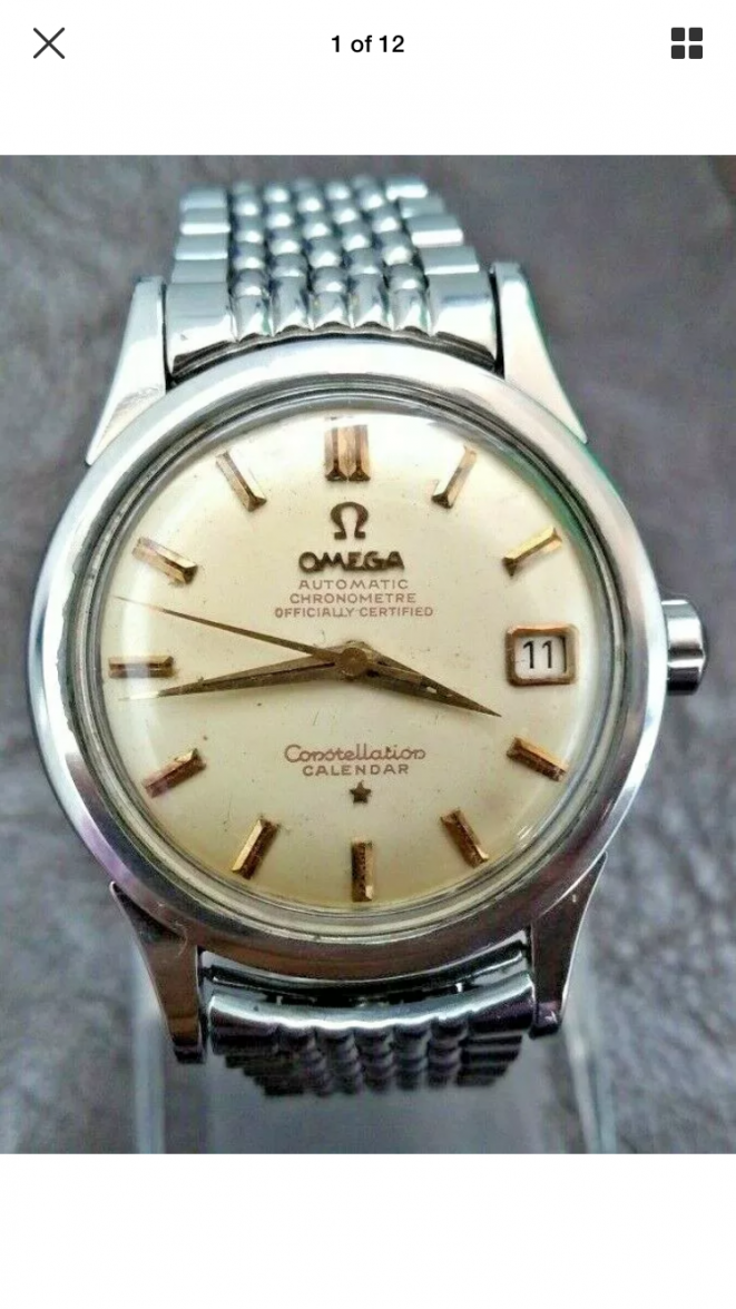

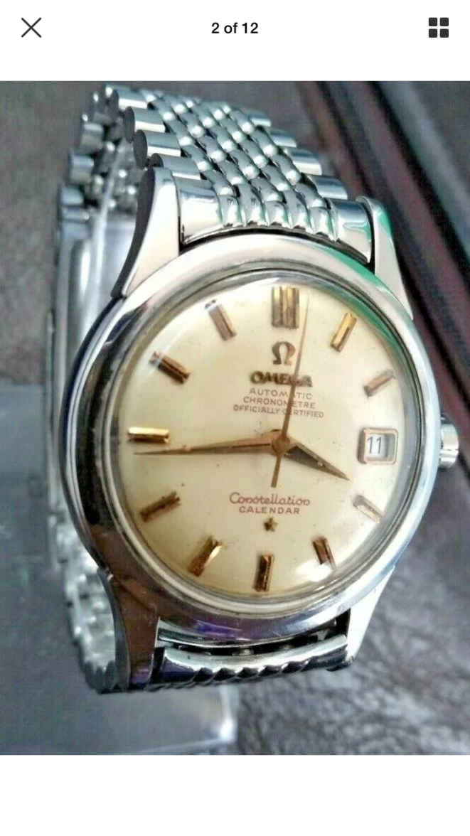

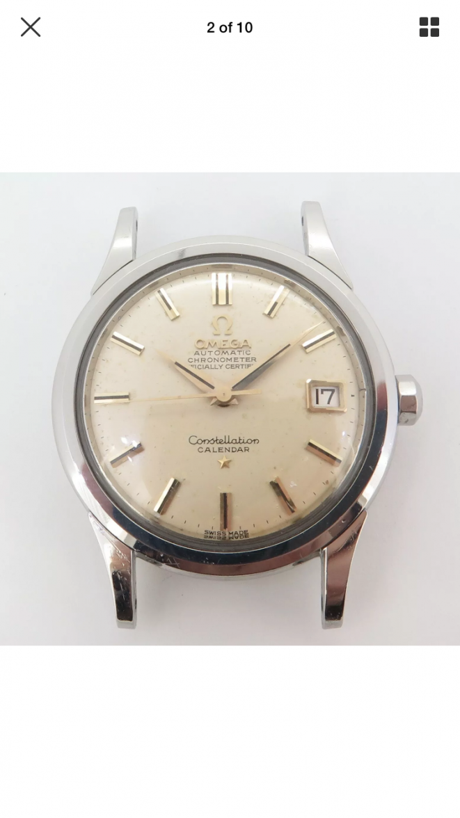

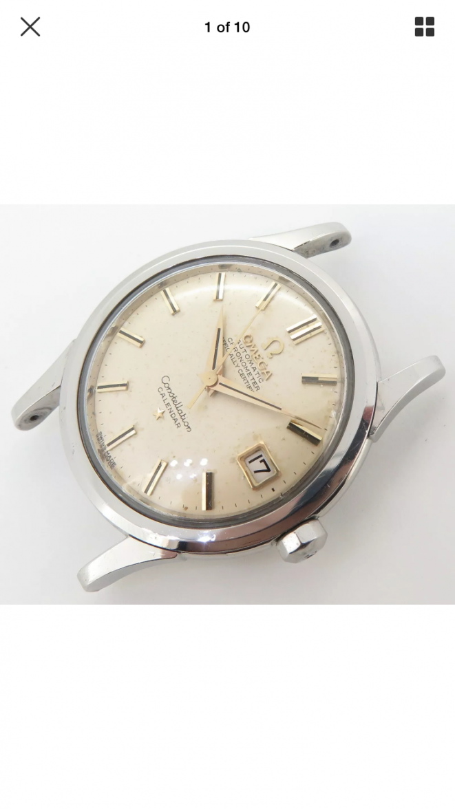

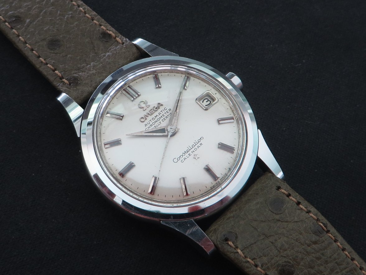

Trying to get some education. Here are two connies , curious what others think . Original? Good condition? Issues?

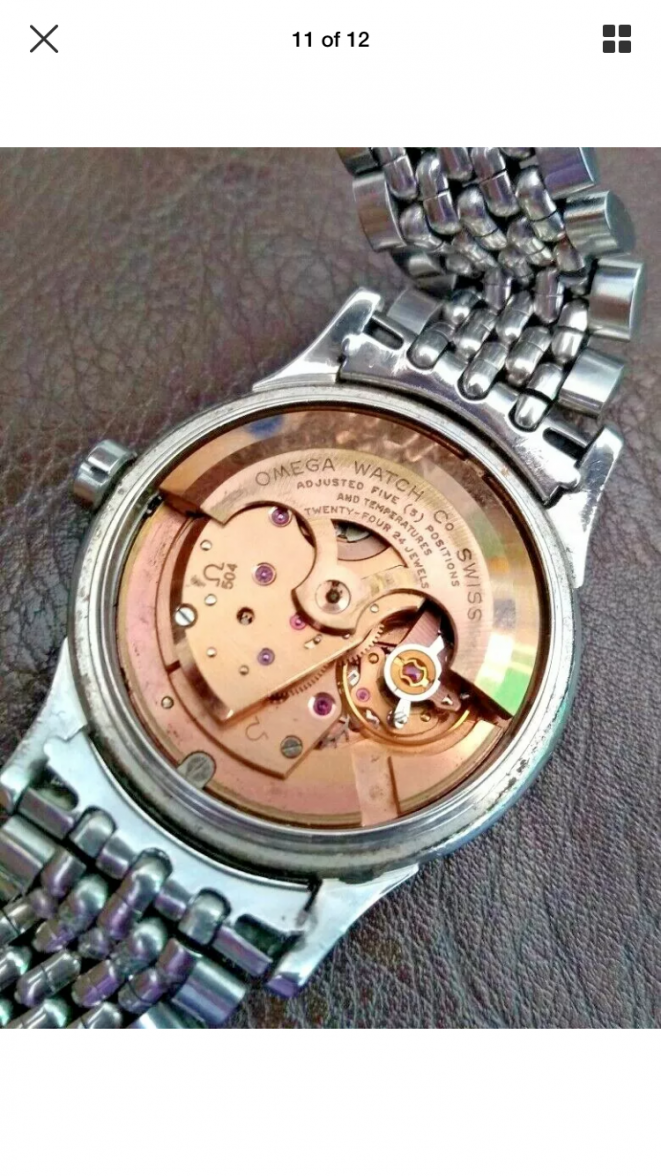

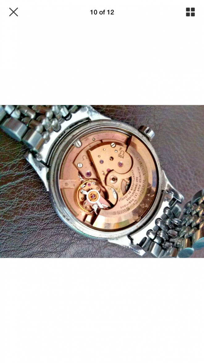

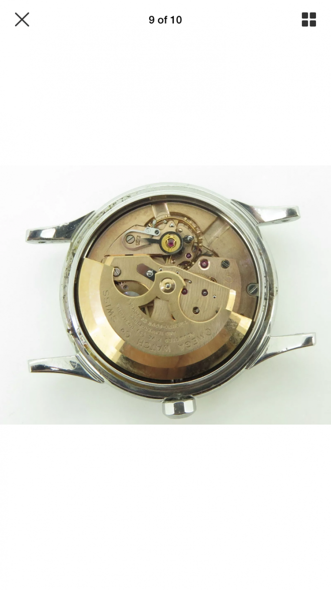

Thanks for your suggestion on referencing by case back . I over looked that . Case back on top watch is 2943 1sc . Bottom watch 2943 7sc . I did a quick search on this site and both watches seem to be like examples shown here . It's hard for me to judge by photos but top watch isn't as clean . The hands show more patina and it appears that the onyx inserts (?) may not
Be there. . The second watch seems to be in much better condition. I noticed the chamfered on the lugs were crisp . Both appear to have the 504 movement. I have no idea about what to look for in the movement but Mu gut says the top watches movement is better . Ok , let me have it

Not bad - B+ for effort 😉
The indices on #1 do have inserts but they are lume - most likely radium, hence they and the hands’ inserts are very dark.
Have you noticed something missing around the edge of the dial?
The missing SWISS MADE was the first clue that something was awry.
The watch has obviously seen moisture intrusion, so the dial has been cleaned.

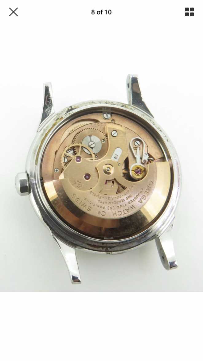

The rotor looks to be dragging on the movement.
The second watch (including the movt) looks to be an altogether better proposition.
BTW it helps to include images of the case back (inside and out) to give a full assessment of a watch.
Hope that helps.

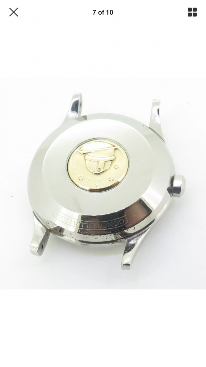

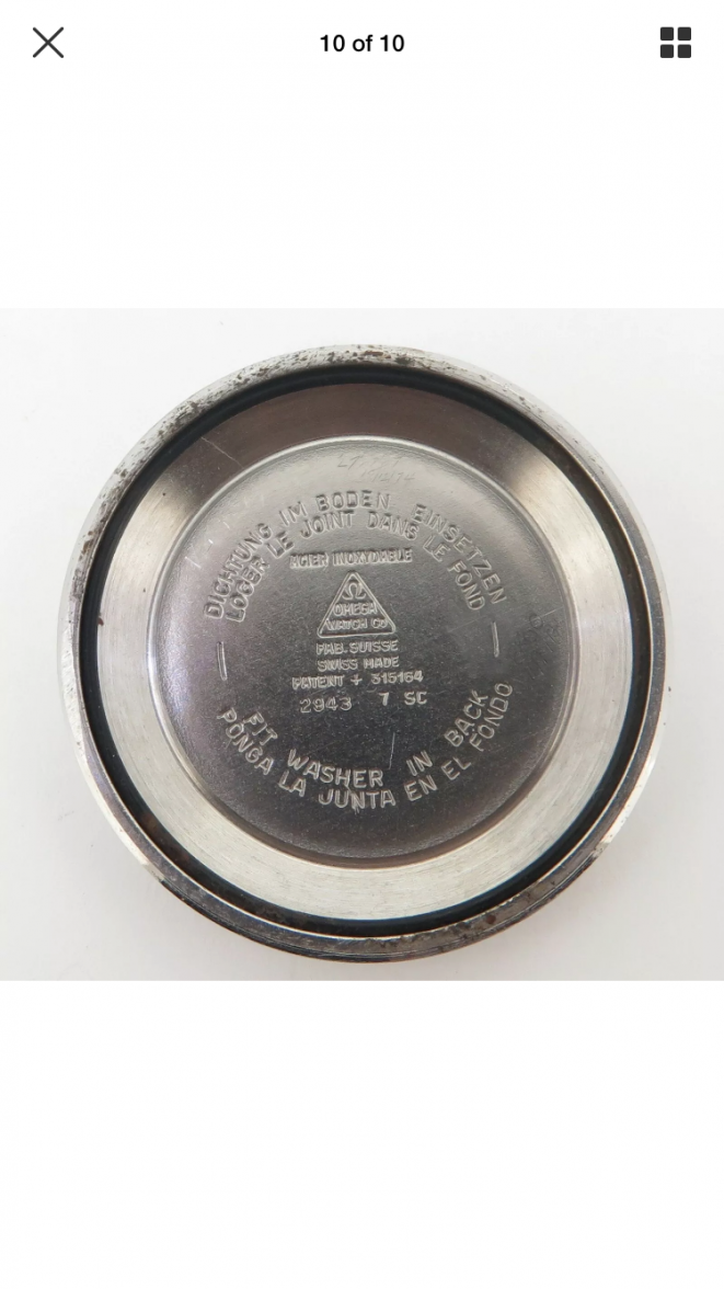

Couple photos of case back on second watch . I've noticed brick work on some case backs . Is that just on gold variations?
