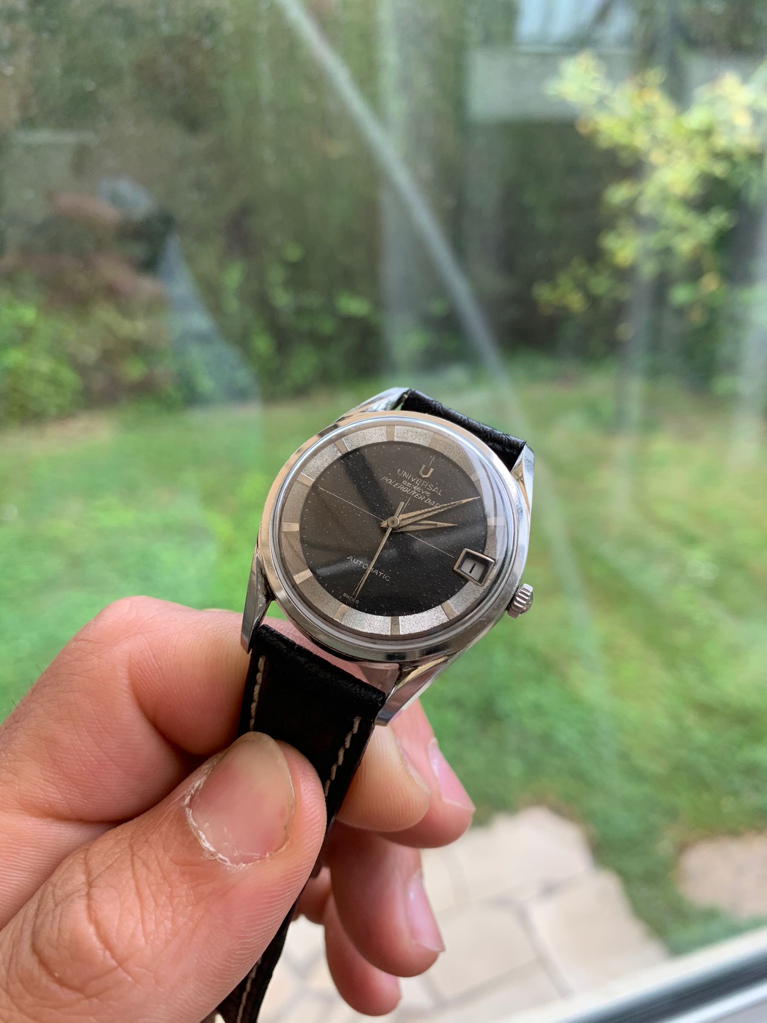

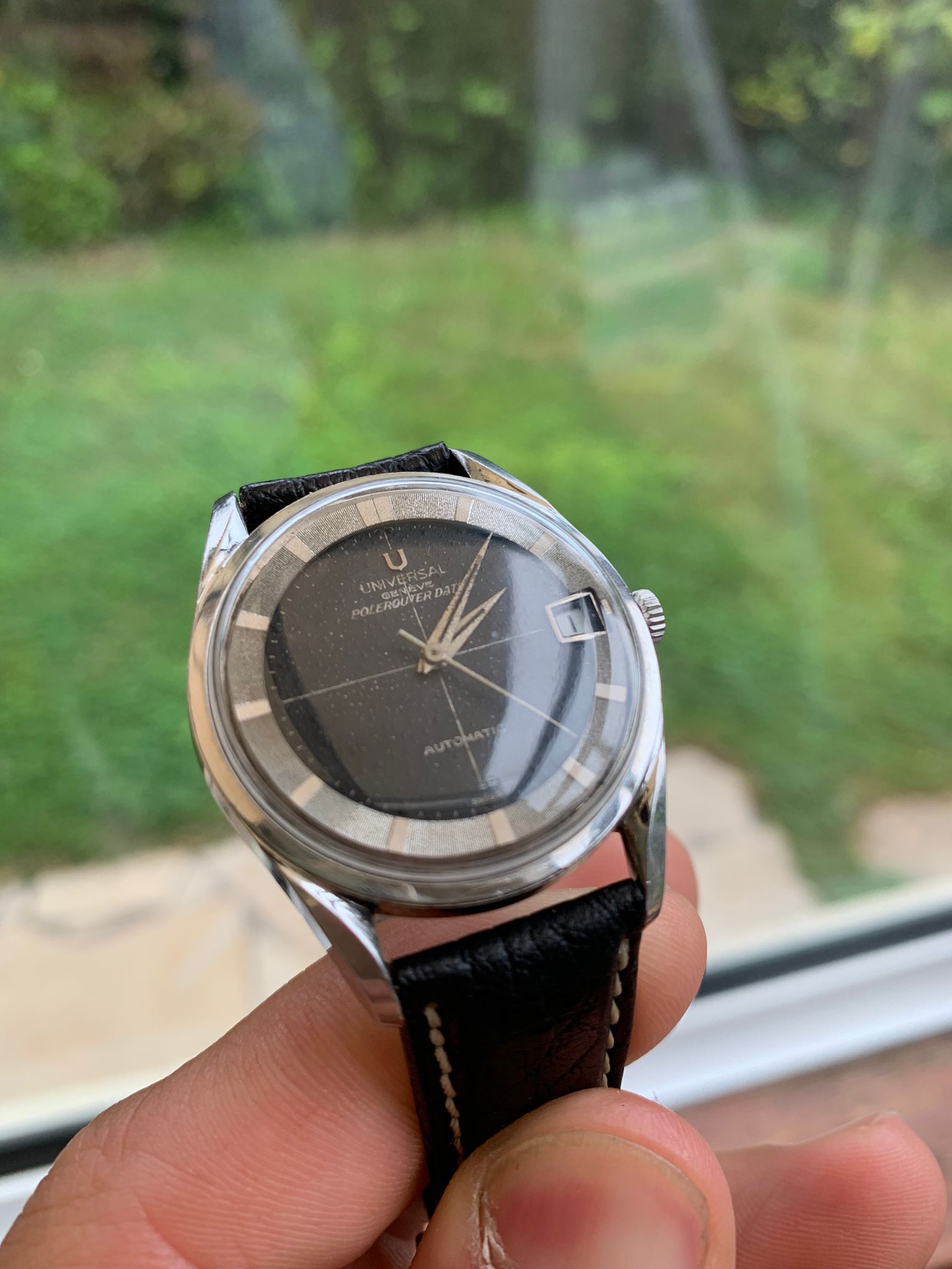

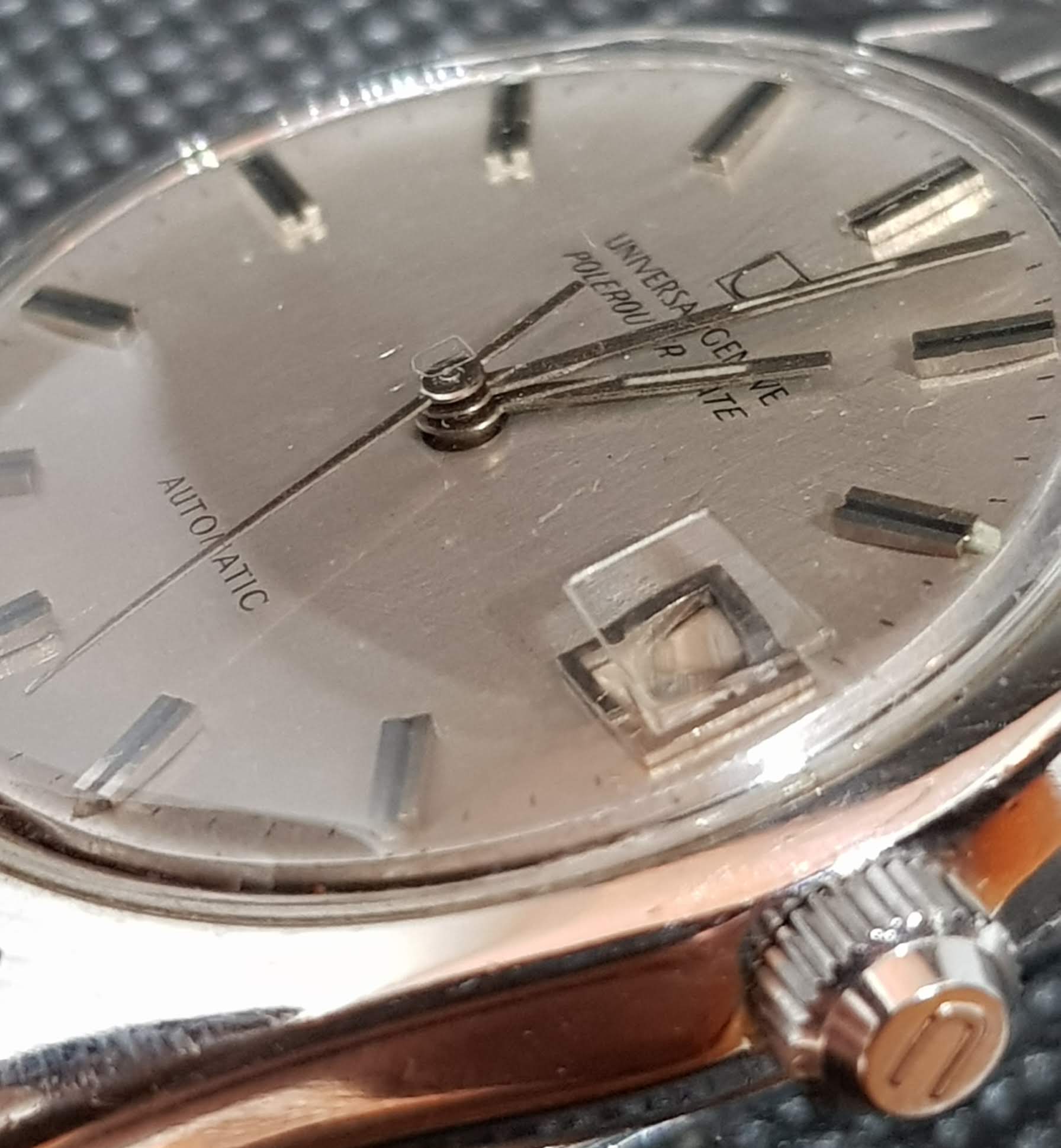

1. The Dial
I presume it has not been redialed / covered up. Nonetheless the black lume dots look odd to me?
-> As per this reference table, the dial text should be "Automatic Microrotor" for the Polerouter Date with 215-2 movement. Can this here be correct?

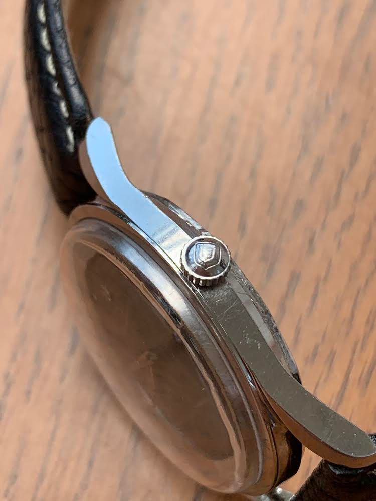

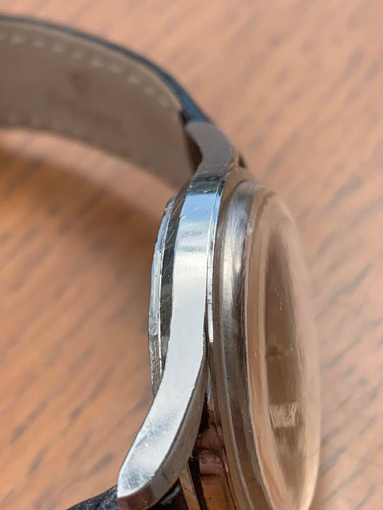

2. The Crystal
The Crystal looks very mint to me. I can somehow not believe that this is the one from 1959? WDYT? Would this be a big problem?

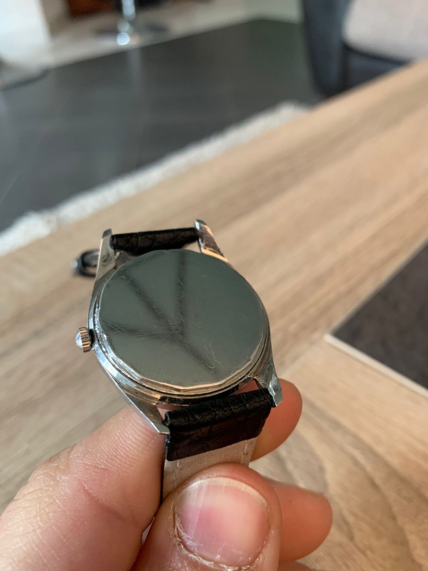

I have seen that iconic Polerouter engraving on the caseback can vanish slightly over time...nonetheless it somehow remains visible. In this case I wonder whether it has ever been there? Is this an original caseback?
->So far I haven't received any timegrapher info or any information on the movement and it's remaining "performance". All I got is the picture attached which to me shows a rather dirty movement. Does this speak for or against anything?

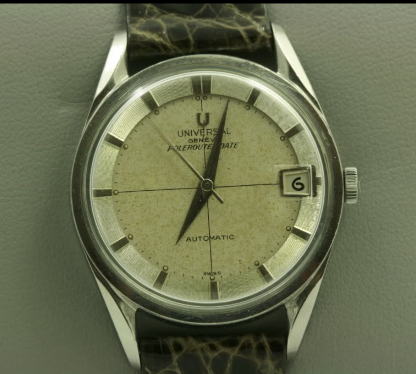

Not all micro rotor Polerouters say so on the dial:
One of my few sold watches. However, I do not think the one you are considering is worth over $2,000 even with VAT.
But what do I know?

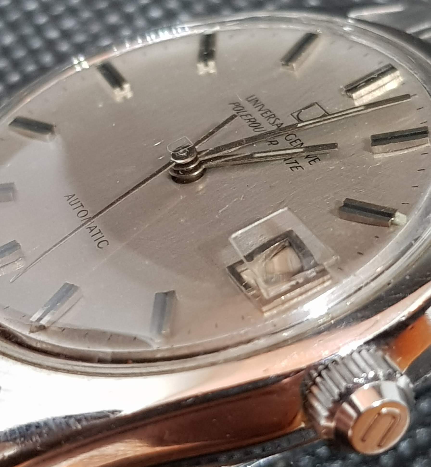

I believe the crystal/plexy should have the "U" stamp in the middle and the trapezoidal glass on the date. Like mine below.
The dial is in pretty bad shape. Not sure why the lumens turned black.
The movement is super dirty. Definitely needs a service.
To be honest, I would let it go but if you wants the watch, I would pay below 1.000 usd for that watch.

I think you are right. With a Cal 215-2, I think it is more likely that the dial would say "Automatic Microtor".
Are the reference and serial numbers present? It looks like a 204610 case with the thin bezel. The serial number might help as it would indicate whether it's early or late in the production of the reference e.g. a serial late in the range would suggest a Cal 218-2 is more likely.
Without those numbers, you are guessing and that would be enough for me to walk away.

The caseback originally had the polerouter logo on it, as well as the reference and serial numbers around the outside edge.
Black lume dots seem to be common in tropical regions, e.g. Indonesia.
The colour matches on the hands and dial so thats a good sign theyve been together for at least a long time.
The plexi is not original, it would have originally had a round or trapezoidal date loupe on this depending on serial, and would have the U shield logo etched in the centre.
Id be most concerned about the acid pitting inside the case (quite a lot around the caseback thread... the sealing ability may not be so great...).

Ah, that's an unusual reference - it's the only 204503 with a 34mm case and 18mm lug width, which is what makes it look like a 204610.
If I had to guess, the Cal 215-2 is original but the dial is later.

The combination of missing "Microtor" text and 215-2 is unusual, but that doesn't automatically mean it is not correct.
