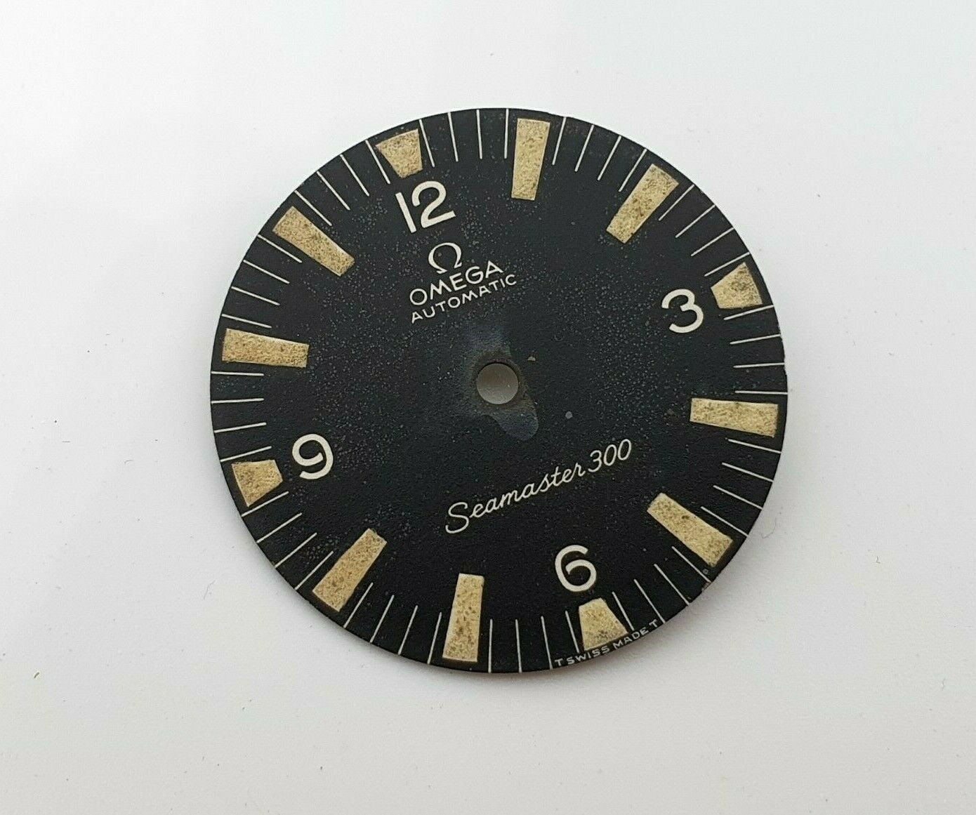

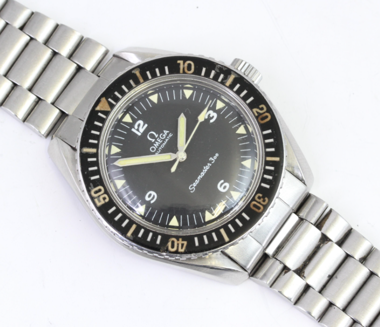

A friend of a friend (yeah, I know!) inherited a 1960s SM300 (also: I know, I know!) However the dial on it is a later service replacement. He wants it all original. Does this look good to you? It's £2k -- presumably toppy otherwise it would have sold by now. Without straying into WTB territory does anyone here have one or know a source?

i have no idea of the recent dial values but I bet the dial will look much better once in the watch and under the crystal. It looks the part of aged original. 👍

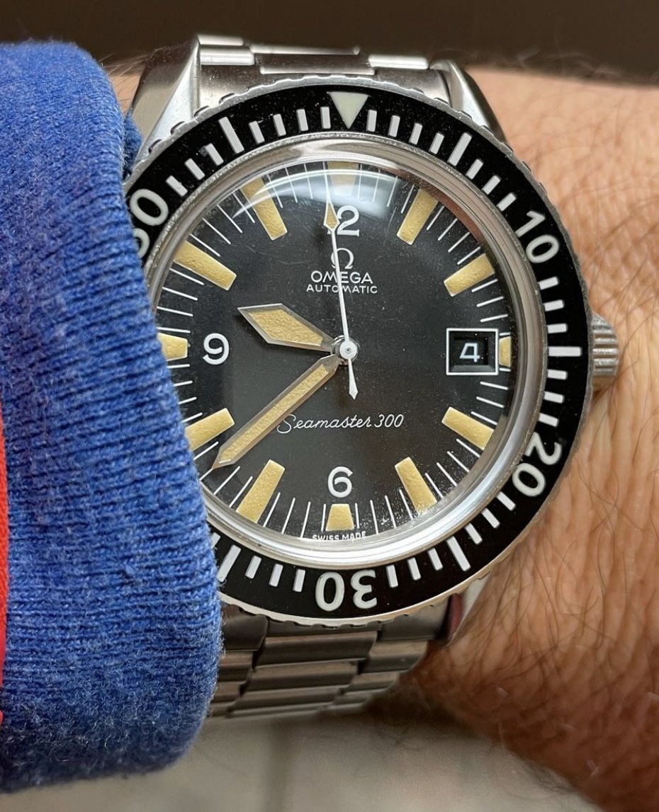

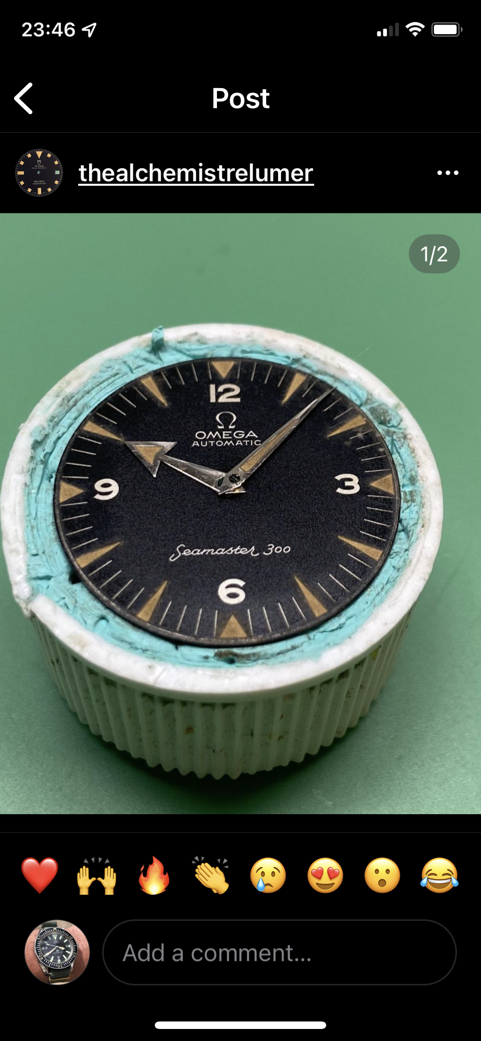

Looks good, but that price is pretty steep. Some will consider this blasphemy, but if you're going for a more vintage look, have you considered getting the service dial relumed? It would probably be much cheaper and probably still give you the look you want. Not my photo, but here is an example:

The eBay dial you show is correct but a bit tired, certainly expensive.
I would also consider speaking to James Hyman for a vintage relume on the service dial, his work is second to none, he has lots of experience of ageing vintage style lume.
He’ll remove, relume and refit the dial for a few hundred £.
And match the hands if required.

Hello, I confirm that is original. It's a rare dial, especially hard to find in good conditions. The one you posted is expensive. Unfortunately I don't have one in my stock 🙁

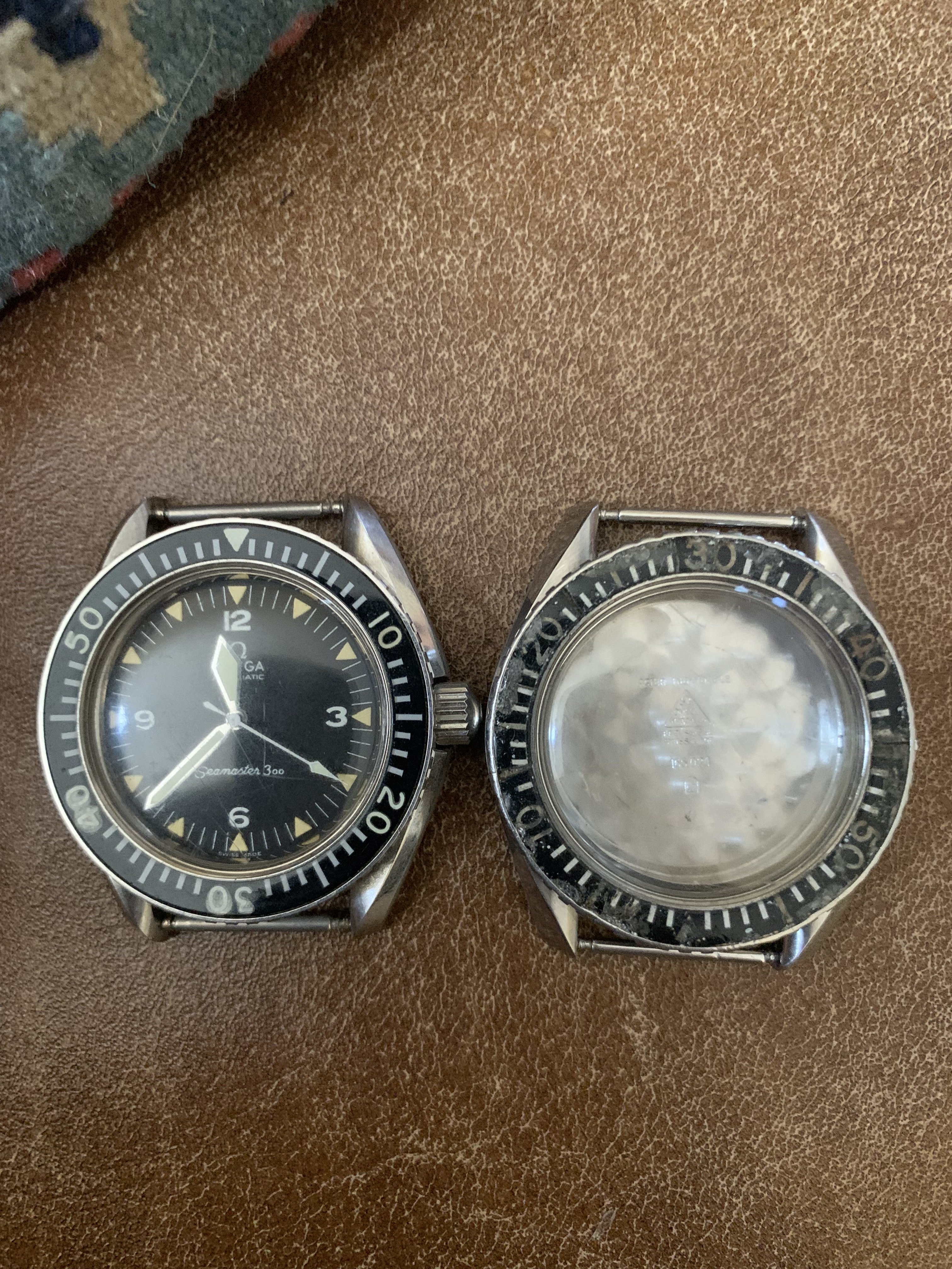

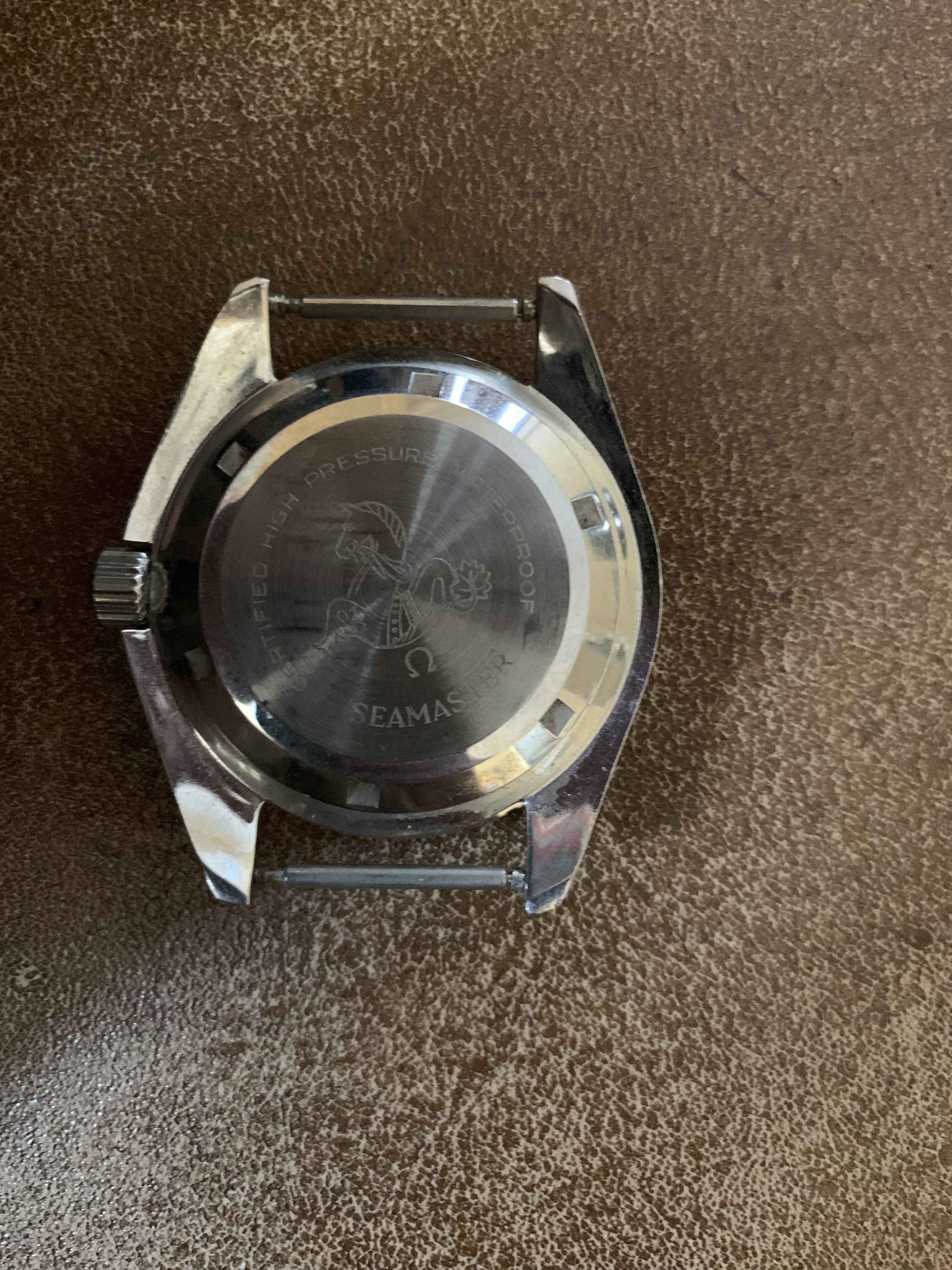

Thanks all. It's a 165.024 (cal. 552 no date) and he wants a tritium dial for it.

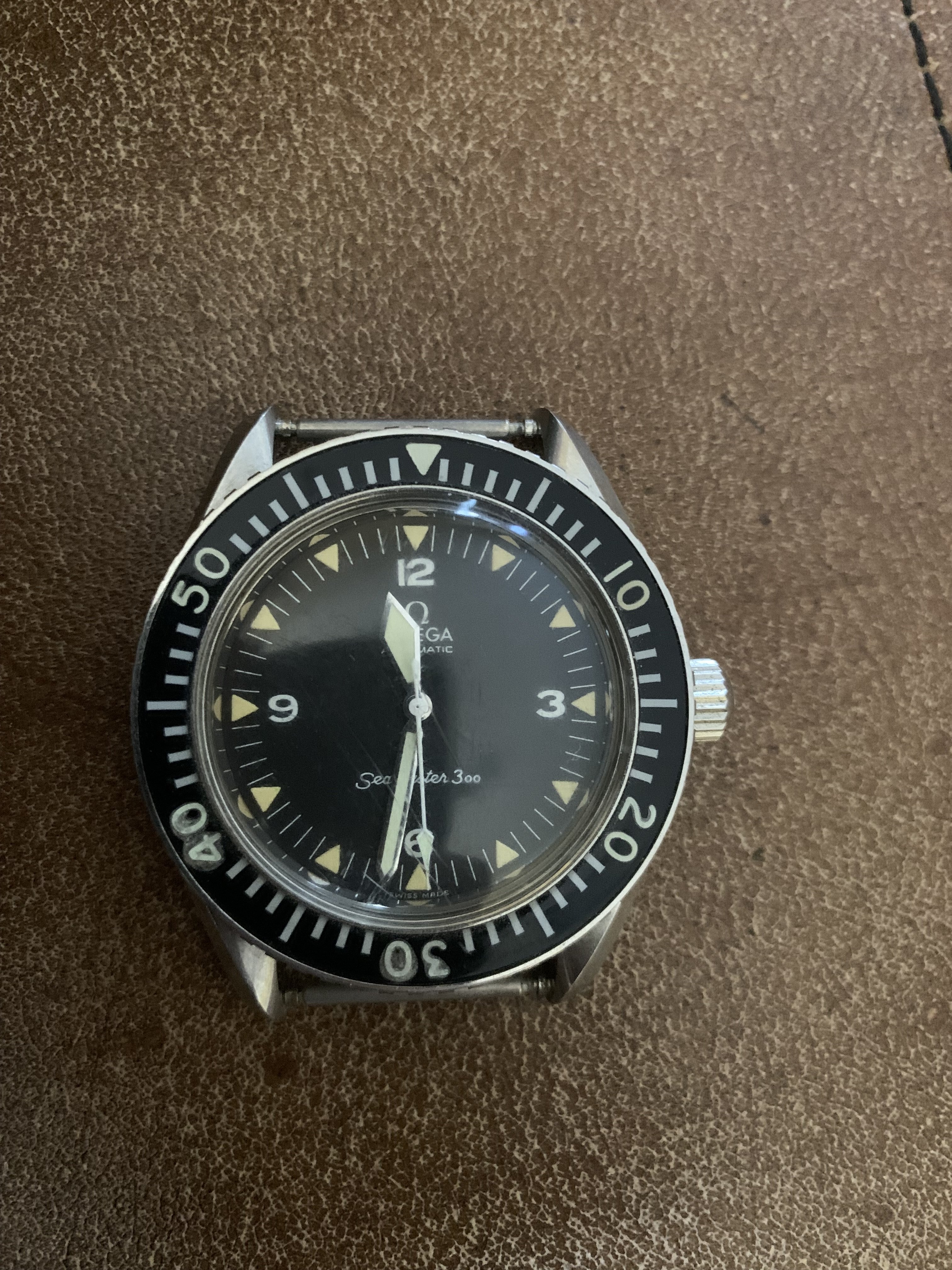

It's a bit of an odd one: his late father's watch, sent away for a service (or possibly services, plural) by Omega. It came back with a nasty replacement dial (but not the original one, or else it's been lost) and a new case (with the original one returned).
So this is what he has:
384
593

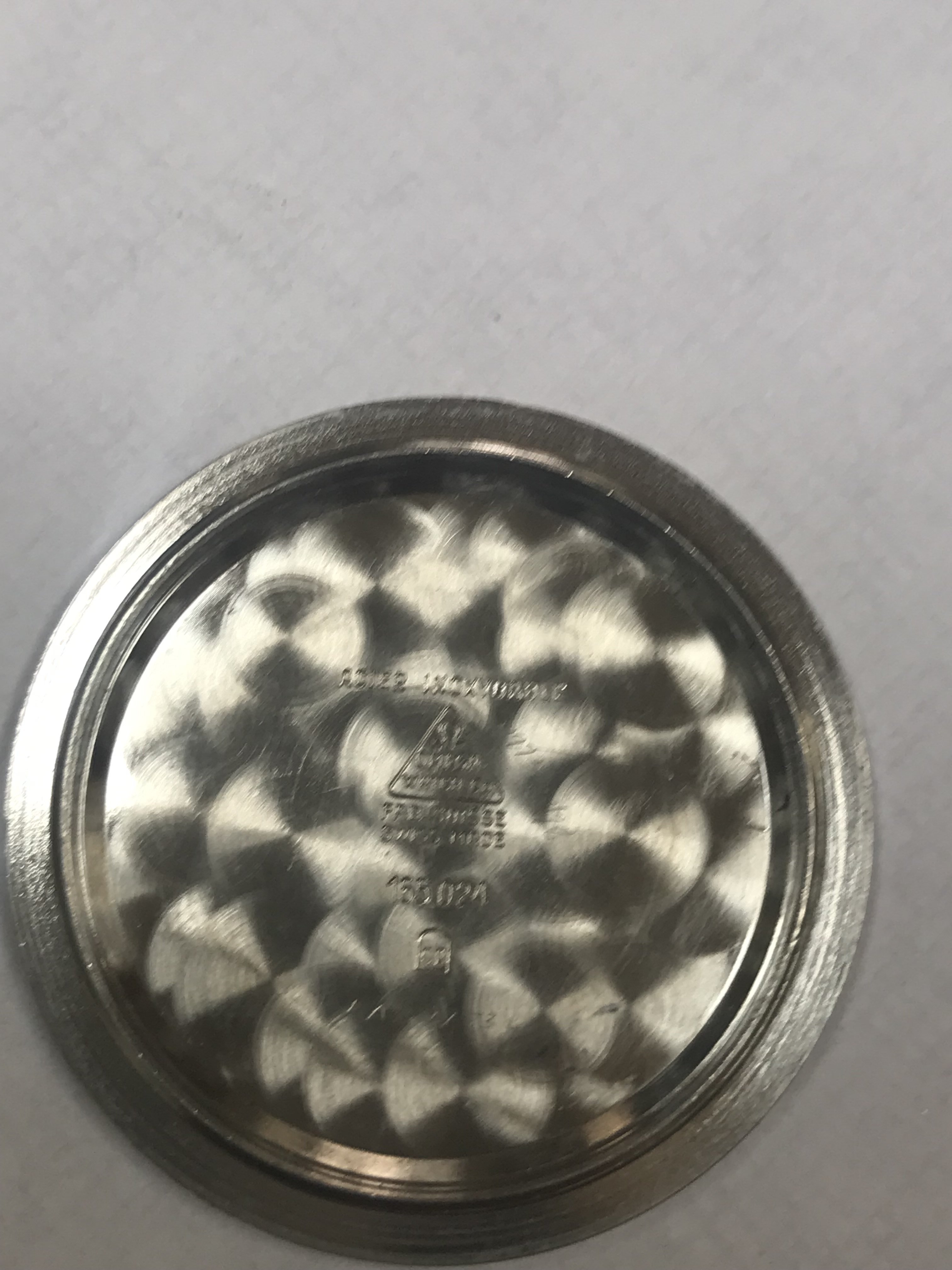

Am I right in thinking that the case it is now (an Omega replacement one) has a screw-down crown, whereas the earlier one with the "bakelite" (?) bezel is a Naiad?
My thinking is that he use the spare case and make up a second bitsa / franken watch, watchco style. Get a cal 552, use that horrible service replacement dial (get it relumed as others have suggested) et voila! A put-together SM300. What do you lot think?

Haven’t we seen this style odd-ball service dial before? I assume there was a period of time when the “correct” dials weren’t available and this is what Omega had made up. Will these ever be seen as historically relevant in the future? They are a part of the history of these watches.

Oh dear, it all looks dodgy to my eyes.
I’d not be in a hurry to spend any $$ on that.
edit. Too hasty, sorry but i HATE the new dial , not sure where id go with it now.
That dial looks terrible or fake to me, I’d not bother getting it relumed personally.
further edit . I think it’ll be a lot of trouble to make anything good out of what is there, how serious is he?

Just to show what James can do. This is a 2915 sandwich/notch dial and hand relume.
