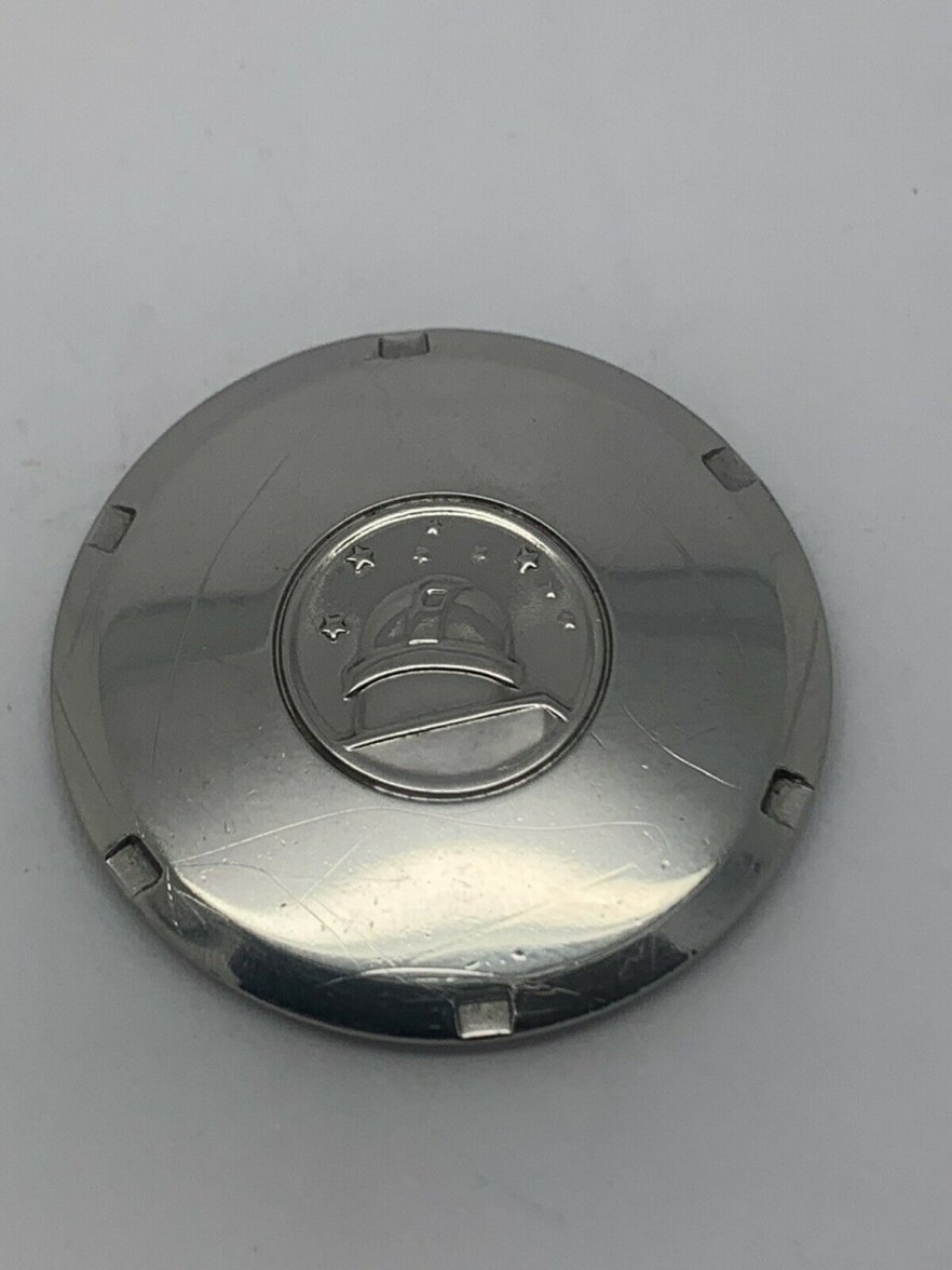

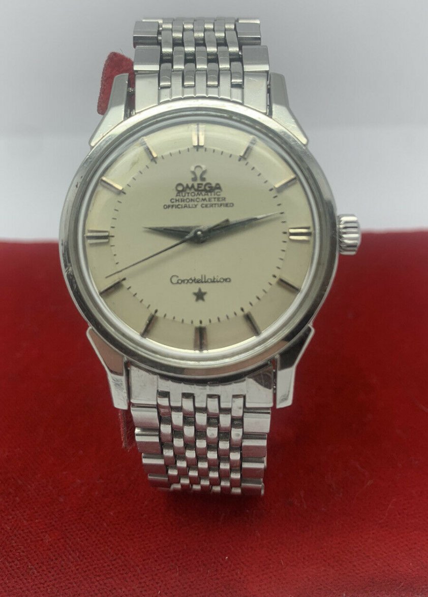

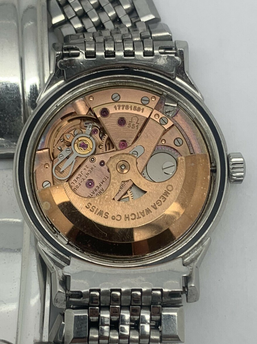

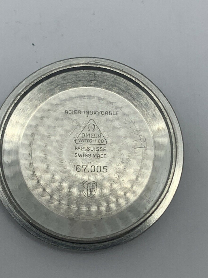

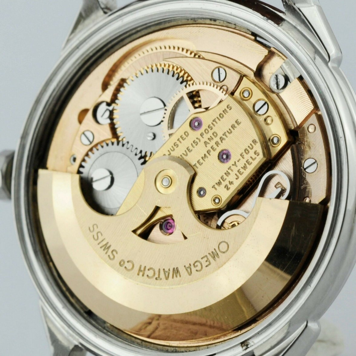

Looking for feedback on this piepan. It's currently listed at 899.00 USD.
Looks to my (still learning) eye that it's a redial and a little over polished (though not that bad). Movement not tip top.

Yea looks like she's been thru a lot. The mismatched head links and sparkling polish job usually points to a hustler fluffing stuff up to sell.

Yeah that movement looks not so good, unfortunately. And despite the polishing there are some DEEP scratches on it.

Interesting that a watch from (at the earliest) 1963, should have a movt from around 1960.
(And yes it’s a pretty poor redial too)

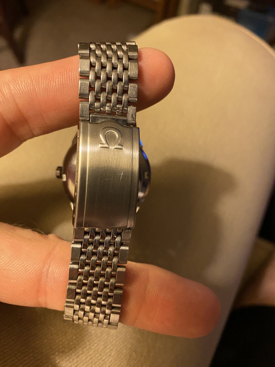

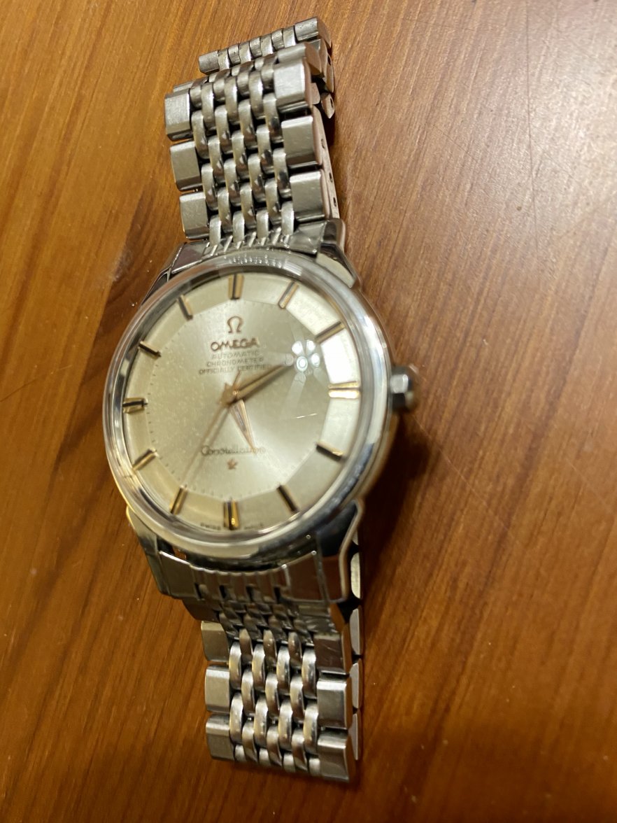

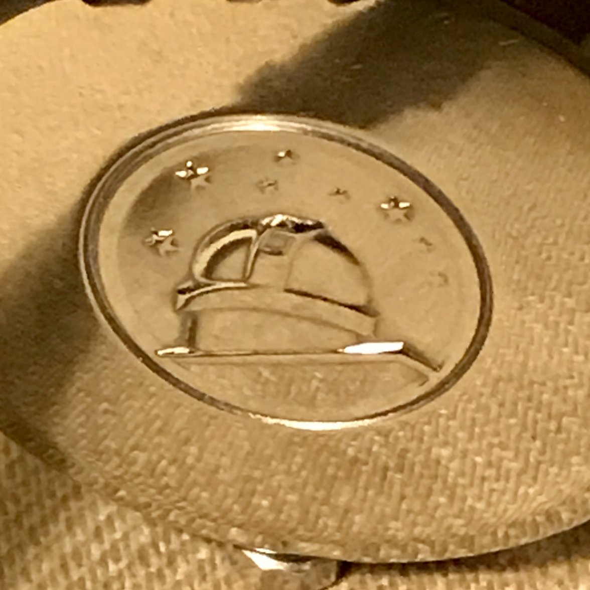

Definitely a redial and a so so case and movement. Good fairly priced examples of the 167.005 are not easy to find. Here’s mine.
