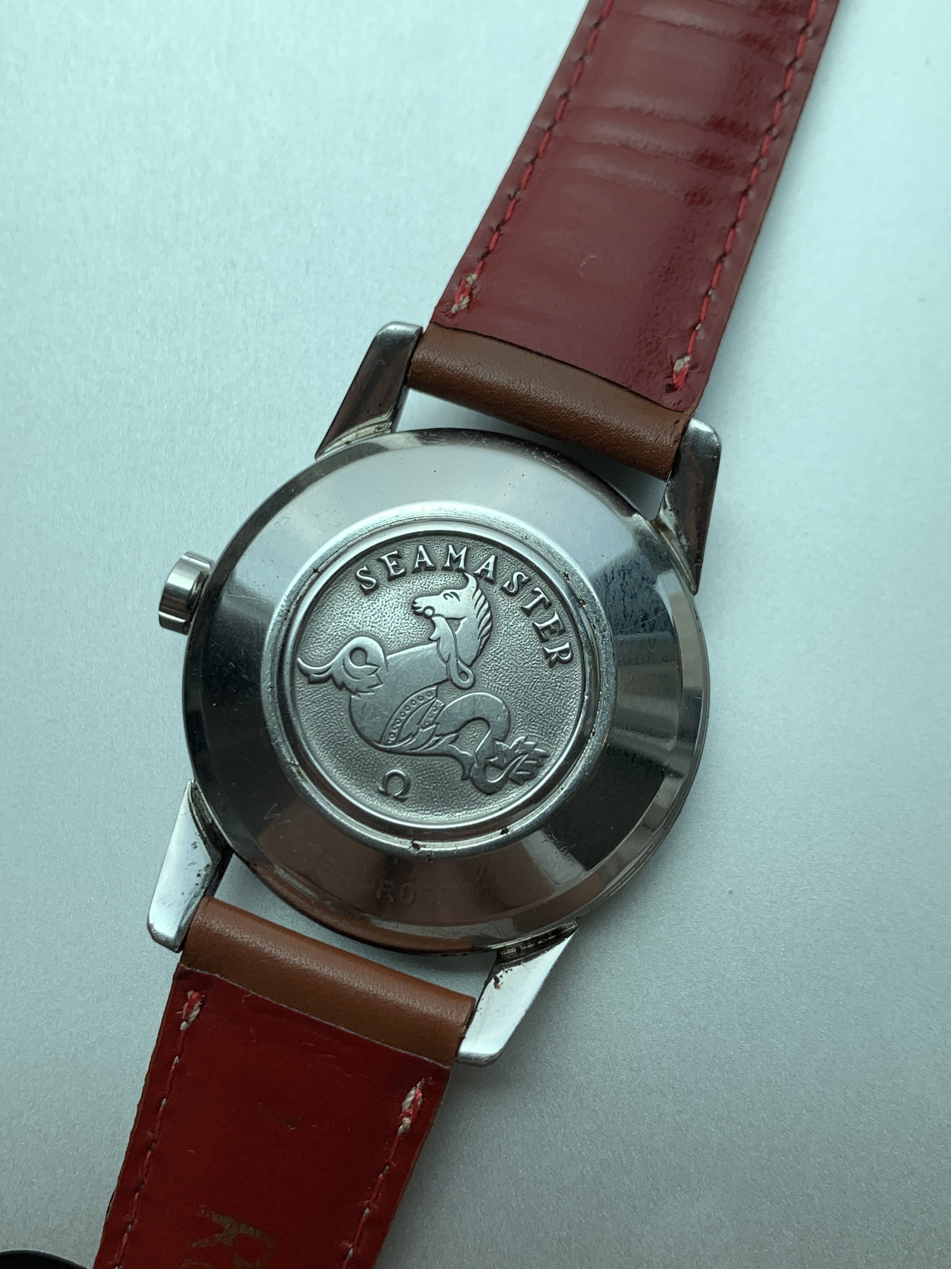

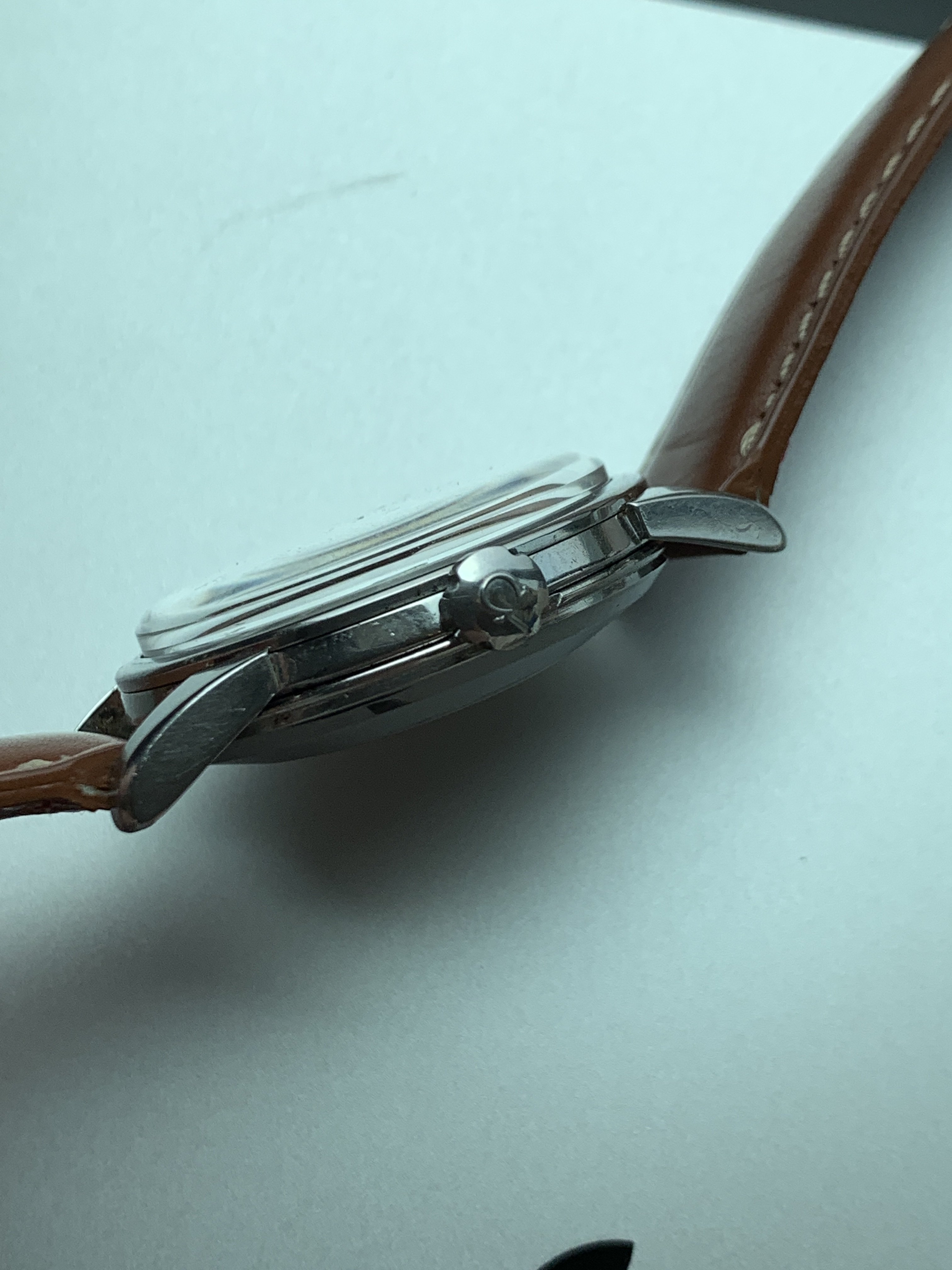

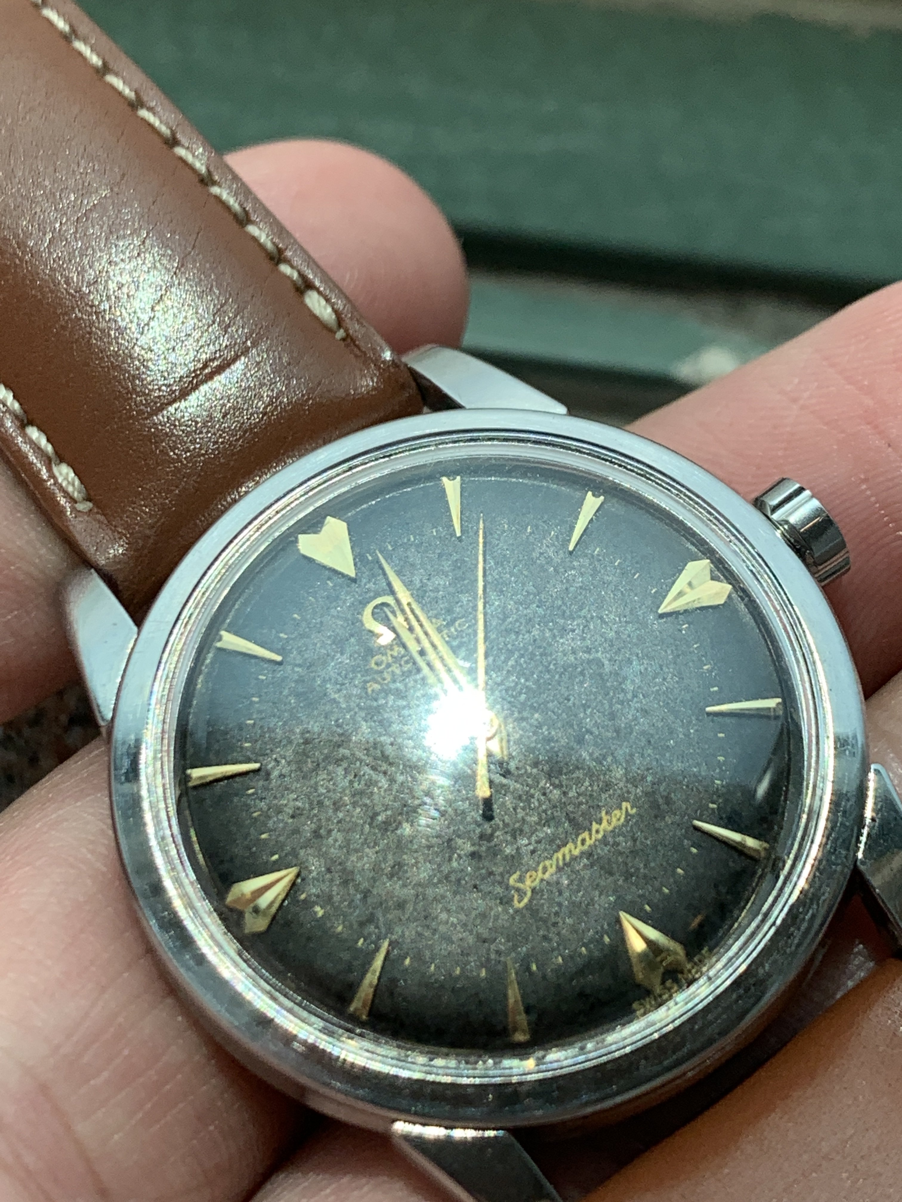

Just bought a vintage stainless steel seamaster ref2849. However, the crystal plexi is not original and not in best fit. Does anyone know what specific parts I have to look for? Eg. Parts no? ( currently looking up in ebay but have no glue which size would fit)

Omega Part Number PZ5000 for crystal with silver tension ring.
Omega Part Number PX5000 for crystal with gold tension ring.
