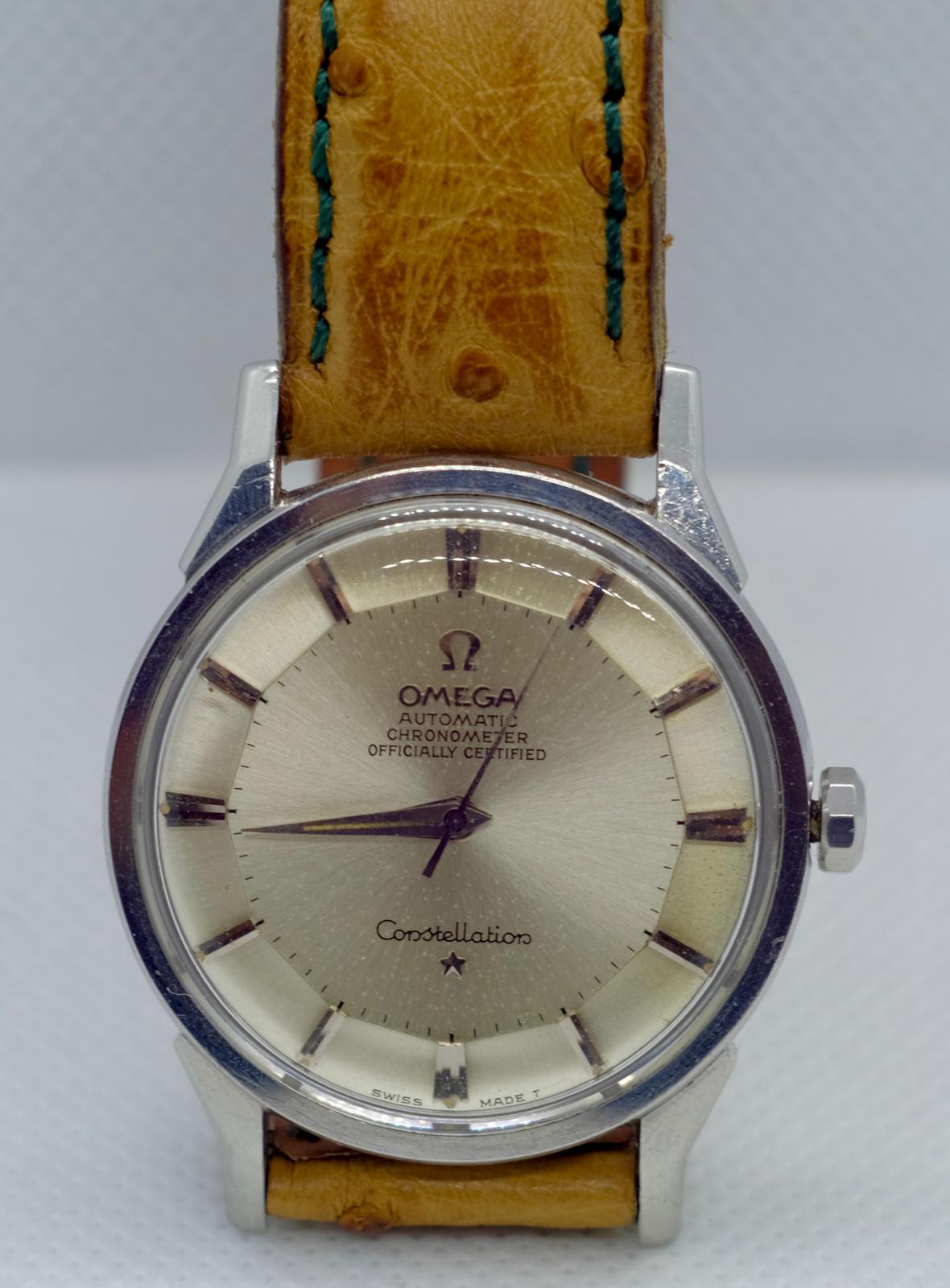

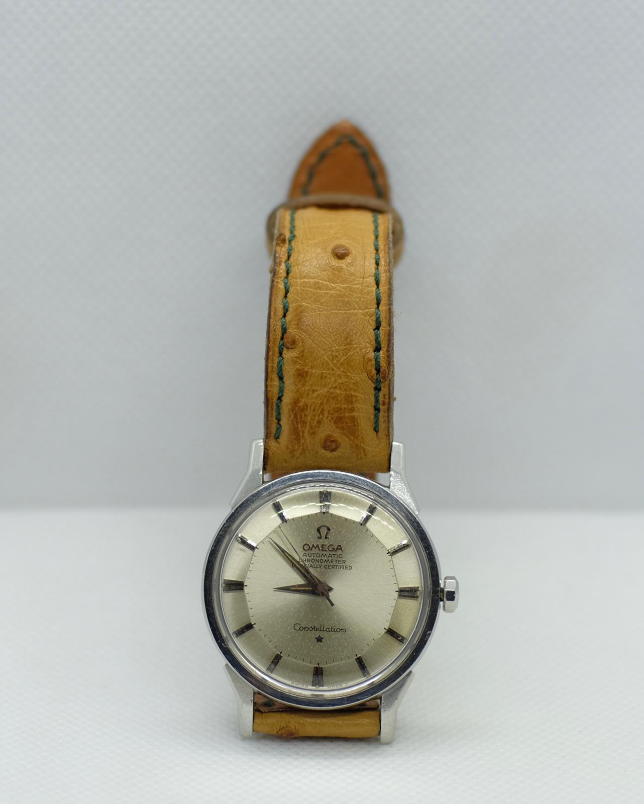

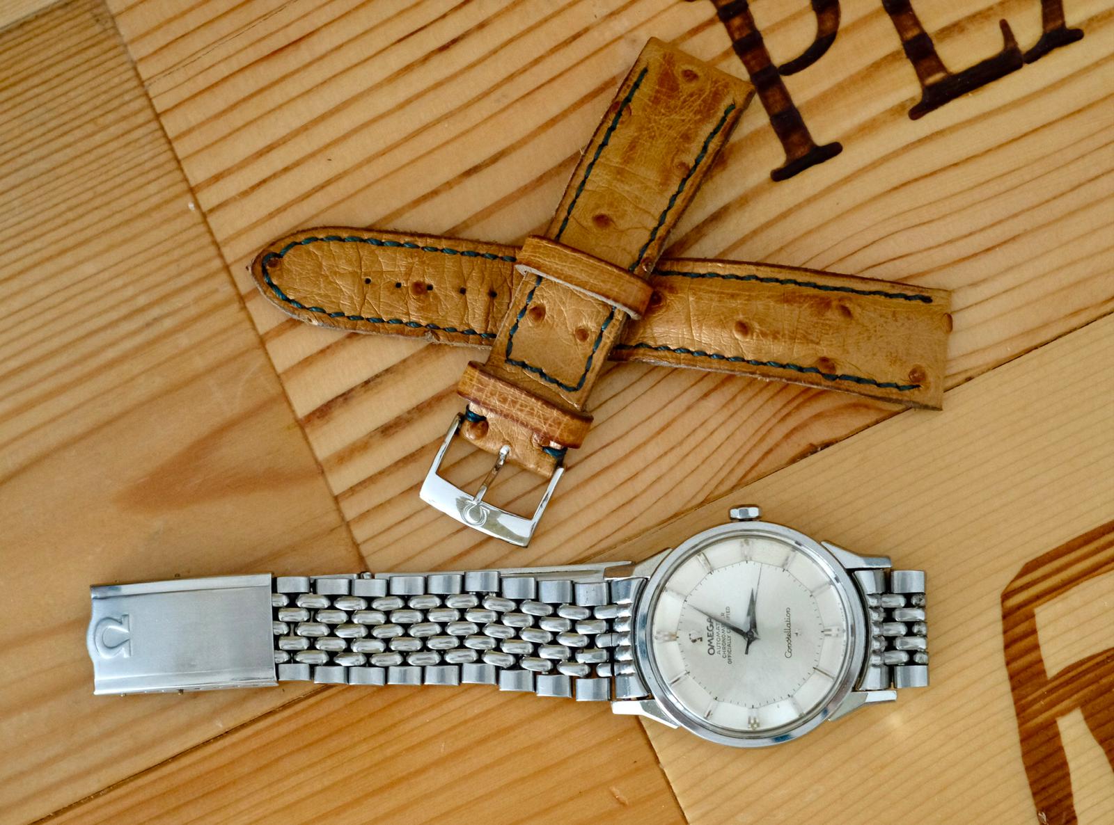

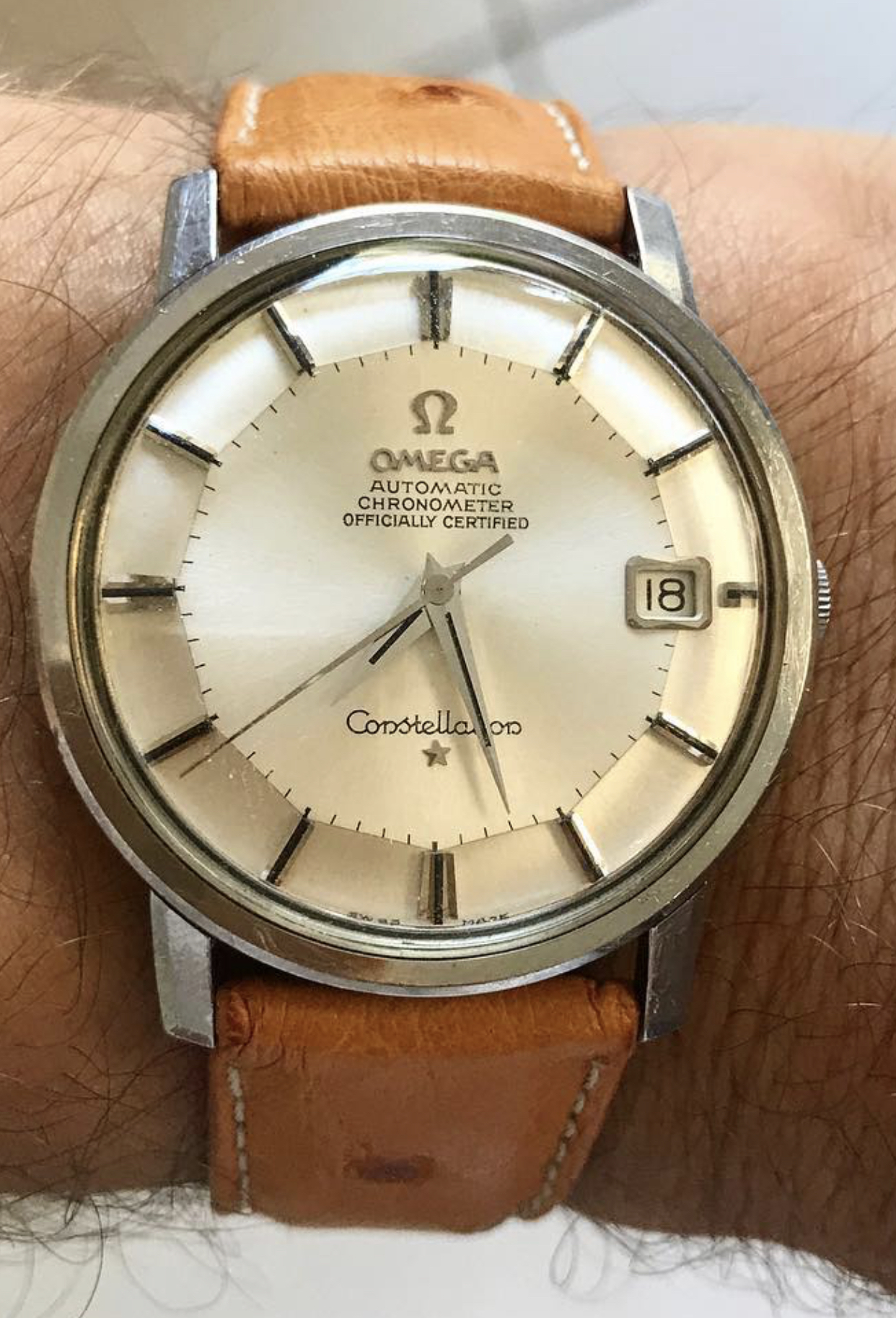

Hi everyone, I would like to know your opinion on this watch, from a private seller. He said all original and serviced last year, keeps time as it should. ask 1400 euro. many thanks regards.
8,877
62,873

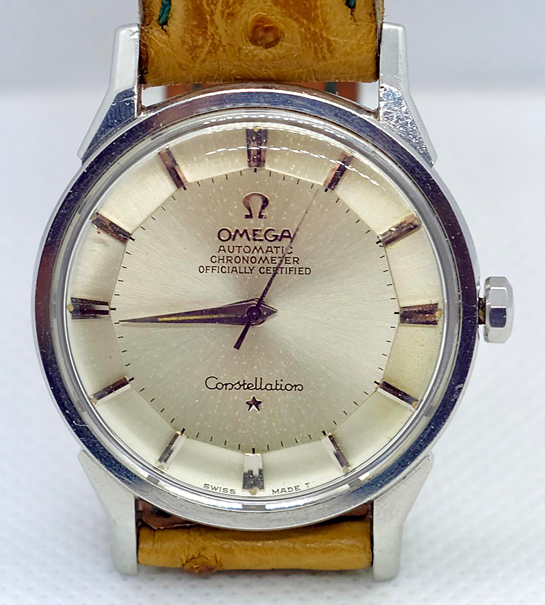

We can help you better with high rez, non-blurry, up-close, well lit/non-shadowed pictures
3,790
6,452

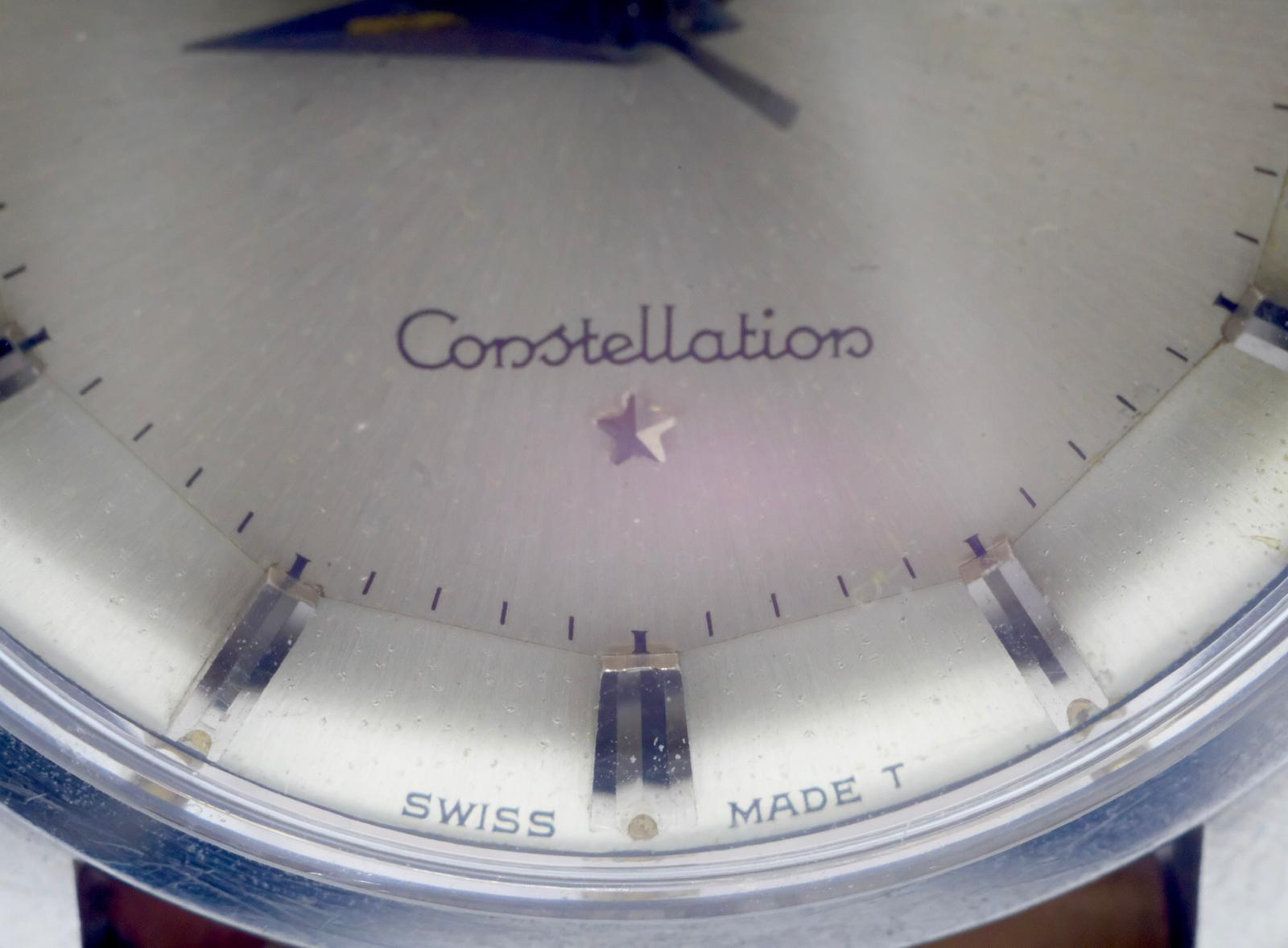

Normally you can see some Swiss Made in the south end. Here I don't see anything, maybe wrong tension ring or something?

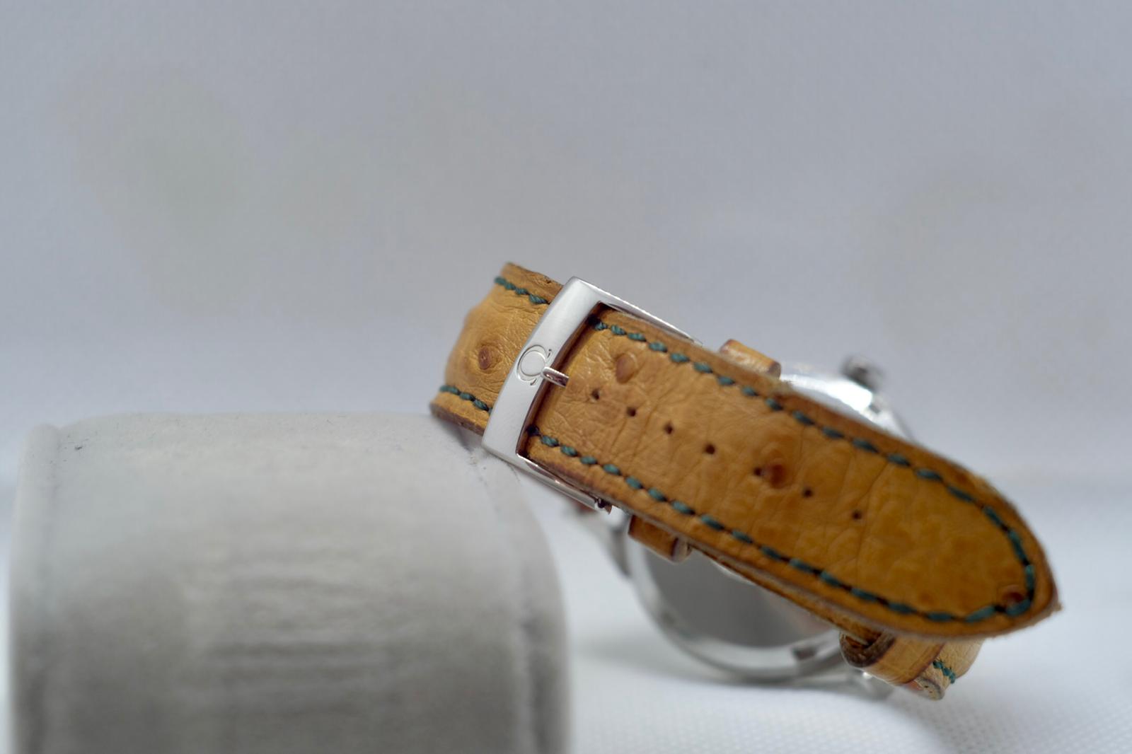

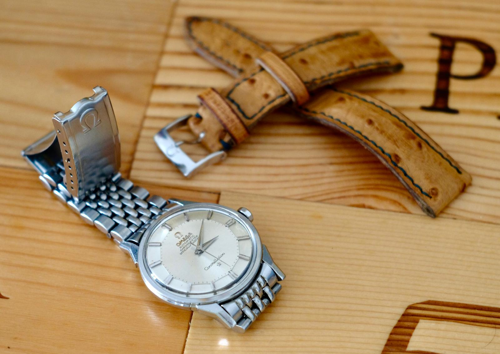

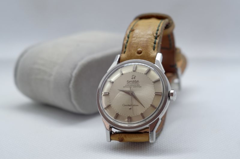

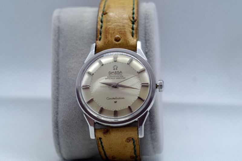

Hi all. I got some new photos from the seller. Any comment will be greatly appreciated. I M a newby and this would be my first vintage., so I m trying no the get burned. Many thanks regards.
4,593
10,813
It's a stunner. Love the even patina on the dial and for me it looks best on the bracelet. As long as you can verify it's been serviced I think you have a winner 👍

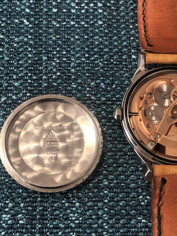

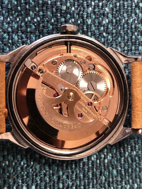

It seems nice enough, but if you look closely in the over-exposed photos of the movement and caseback you can see the rotor has rubbed. If that has not been fixed you should get a service ASAP.

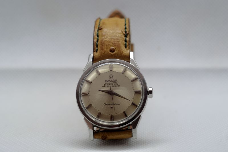

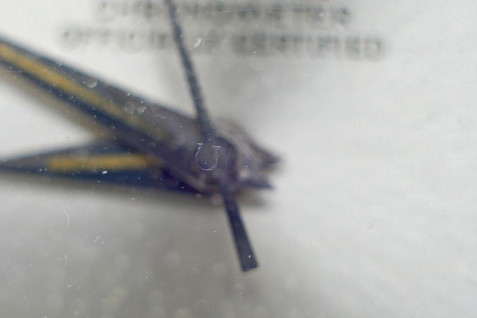

In my opinion there are better dials out there for that price. Look at the lacquer, especially at the indexes, some deterioration has begun. A service without docs is almost worthless. Proof must be presented an I expect an almost flawless dial for that price. Case looks good though.

I would not pay that much for that watch.
That is the price for a mint ss Connie.
The dial has spots (not nice patina in my books, nice patina is a nice yellow shade of the background) and the case appears to be unpolished but its quite battered.
Pass based on the prices asked.
Also, as others said, no service papers means no service. I can see what appears to be a new gasket but the caseback has remains of the old gasket. If it was serviced properly I would expect my watchmaker to clean that up.....
Enhanced picture
In Europe, I haven’t seen such a example for cheaper since a while. I’m not saying it’s a bargain, but I would say it’s the average price for such an example.
In my opinion, dial may be better in real life. Cas has seen some polishing, but still ok to me

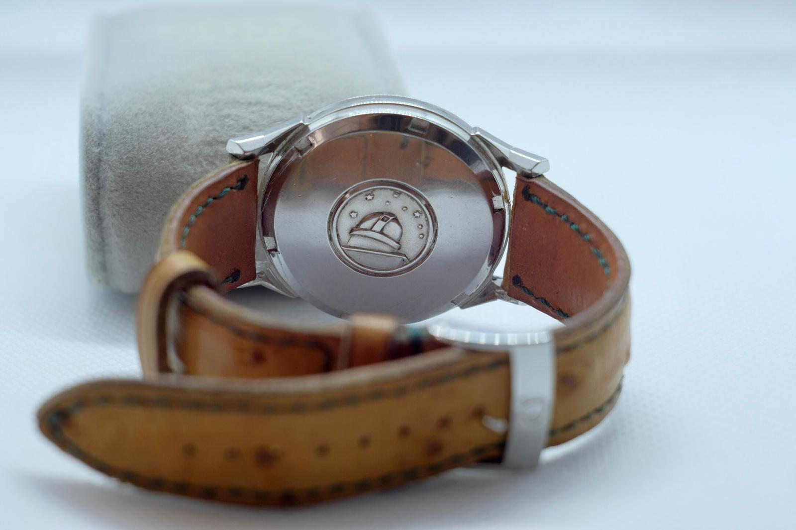

Seems like a fair price. Nice 168.005. Ask for a picture of the box, cause it’s probably the wrong one
