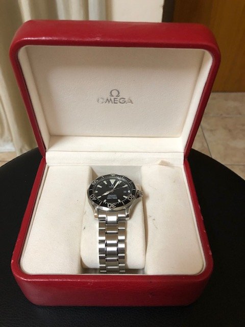

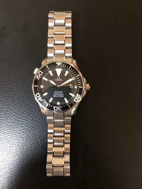

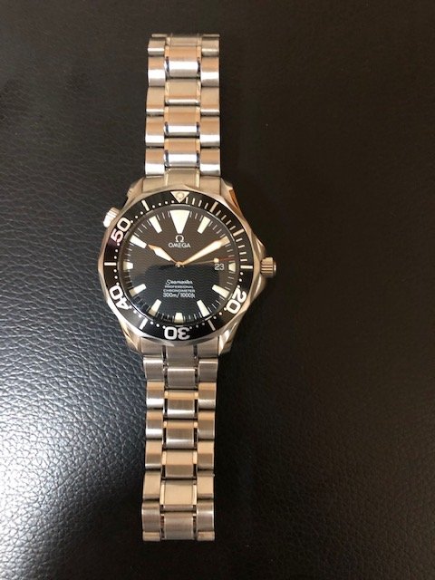

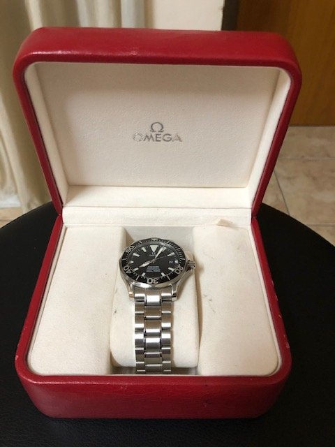

Hi guys,
In my search for the right 2254, I believe I have found one that seems to be in rather pristine conditions.
The seller told me he purchased it in 2003 and didn't use it much but the watch spring is broken so I believe that I can already expect to pay an extra €500+ to send it to Omega Bienne for a repair.
He's selling it for less than €2000 (full set) so I believe (I hope) it might still be a good deal.
Now with him being in another country (still in Europe) I cannot take the watch to an AD to authentify it, so I'm asking your help here to know whether the watch is not a fake.

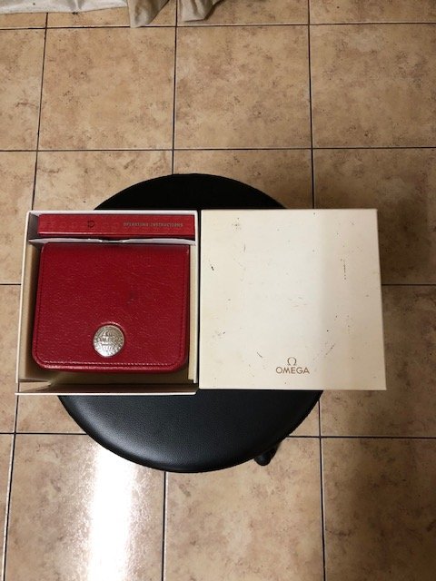

For the record, he sent me the serial number that is on the international warranty card and it matches the number that is on the white box. He was not able to take a picture of the serial number on the lug though, as it's too small.
Shall I have concerns?
Another thing is that the serial number on the card/box starts with 8036, which from what I've read corresponds to serial numbers from 2006, but the warranty card shows that it was indeed purchased in 2003...
Are there other things that I should check with him?
295
387
Looks a clean example to me mate.
I think 2000 Euros is a fair price
(maybe on the higher side) but not spectacular considering you will have to put some money into a service.
I’m not sure about the serial number and the online charts aren’t that accurate, but that’s quite the discrepancy. Did the seller confirm that the serial on the lug matches the warranty card?
If not then that’s an issue because it may be a put together set.

Thank you for your response. Actually I haven't asked the seller to confirm that as I'm affraid he might just make this up, like "yeah sure, both numbers match" when it's actually not the case.
I might be to paranoid about buying a fake or franken, but I really want to clear any doubts.
I'll ask anyway, let's see what he says.

If you have any doubts, just walk away.
It’s not worth it if considering these aren’t that difficult to source (right now anyway). Plenty of good examples come from Japan so definitely have a look around the Japanese auctions.

So far I must say the seller has been reactive and provided me all the pictures and informations I requested from him.
You are right to say they are not that difficult to source but I must say that minty ones usually sell around €2700/2900 on chrono24, which to me, is too expensive.
I took a look on Japanese auctions but I'm not very familiar with this system and I know I'll have to pay extra fees for the customs, shipping and from the auctions I found, there is never that much information about the watch history, servicing etc.

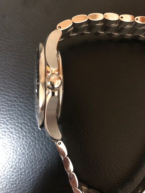

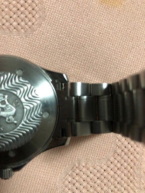

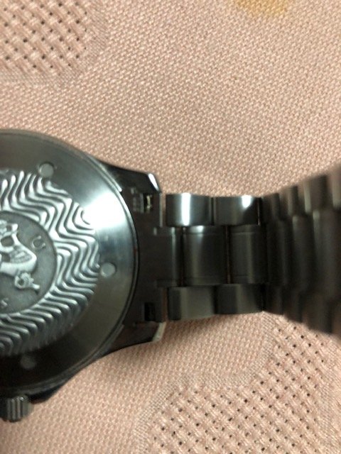

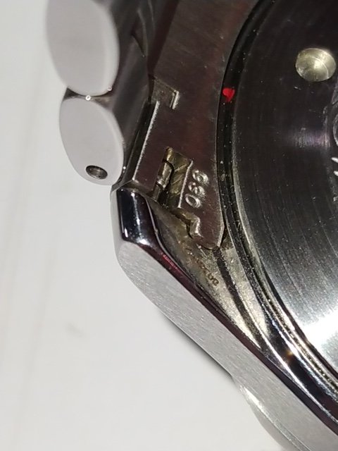

So he just replied and said that the numbers on the lug are way too small for him to be able to read them... I don't know about this watch but on my Speedmaster, under the proper light, it is readable.
He even tried with a magnifying glass...
986
3,013
Push on it, serial number is not huge but for sure it is completely doable to take a decent photo where the serial is readable.
You may need to suggest to seller that 480x640 resolution is far from right when taking the photos of €2k item.
The online charts are not very accurate, I have had a similar SMP with the serial starting at 80*** and Omega confirmed it as the watch produced in year 2000.

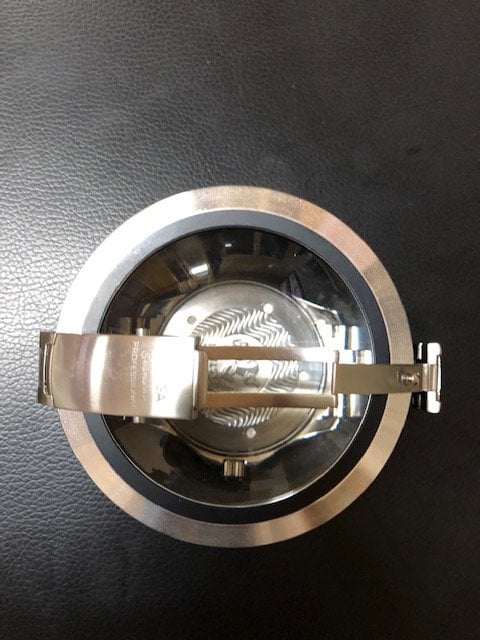

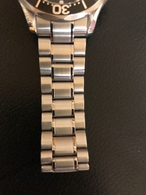

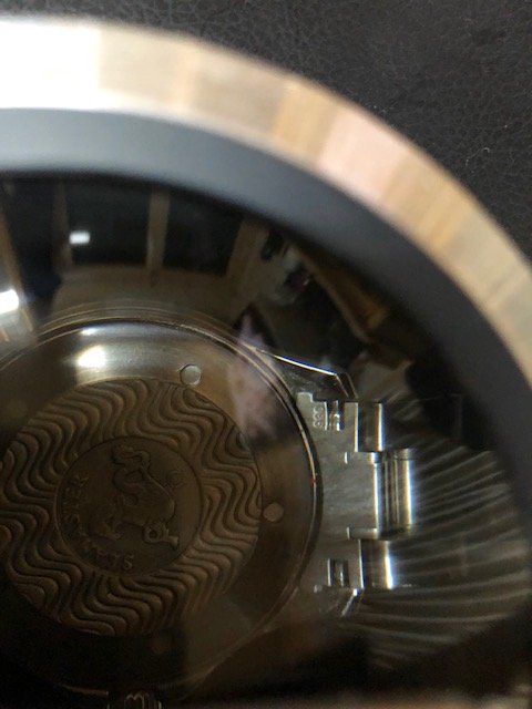

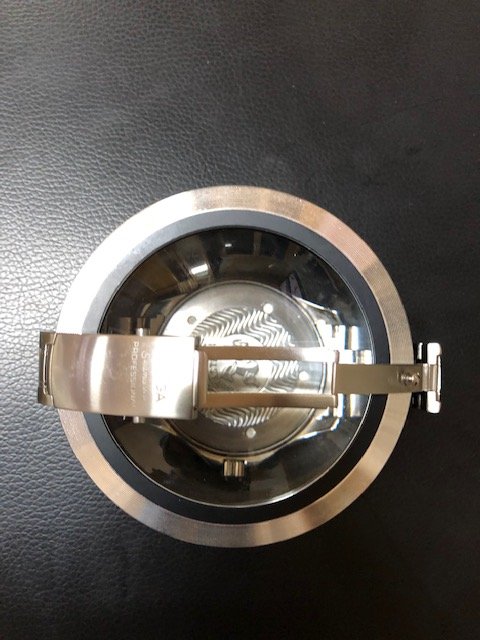

Looks okay from the poor photos. However, how does the seller know the spring is broken? Has it been opened up? Can the seller take it to a local (to him) shop and have it opened - he could then send a movement shot too.

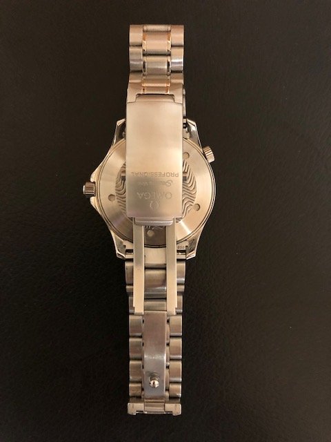

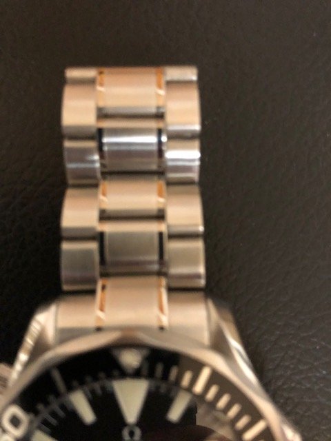

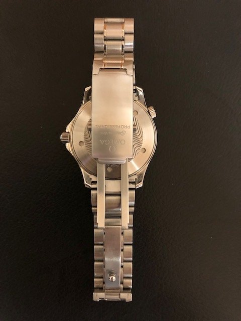

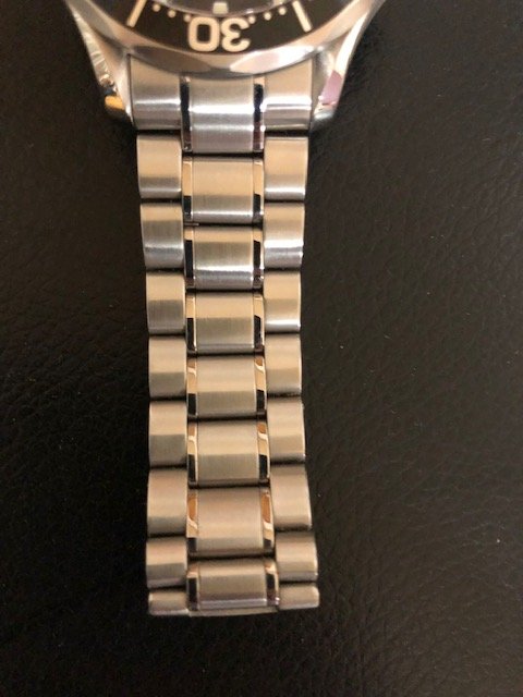

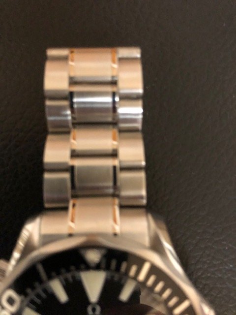

Looking legit to me, red dot is still present, so it supports the theory of being not worn much and after mainspring broke it remained unserviced in a box. Clasp engraving is quite sharp, usually well worn watches nave the clasp or scratched as hell, or scotch-brited so the writing is shallow.
Th the SN photo: tell the seller to wash the watch, and make hi-res photo in a bright light conditions. Then you should be able to zoom it from the photo.

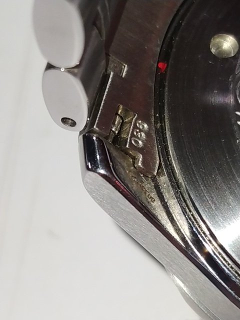

So, I finally received a picture. He seemed to have struggled a bit to take it and explained me how he managed to do it.
I read his explanation until he finally revealed the (THE) number... which is 930.
The bracelet number😡
Not really what I was expecting but I explained him (again) which number I was waiting for, so let's wait and see... I'm more amused than anything at this since I believe he did it in good faith.
Here the picture 😀
33
70

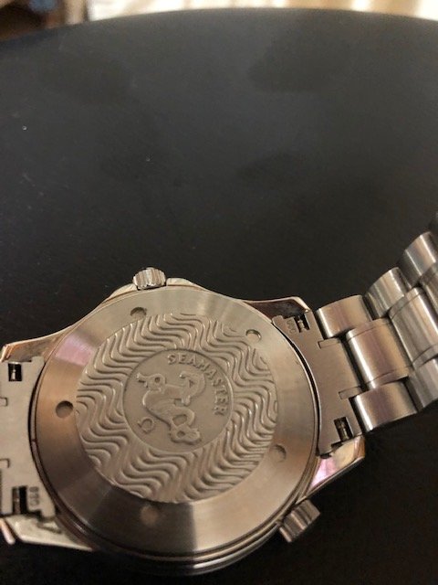

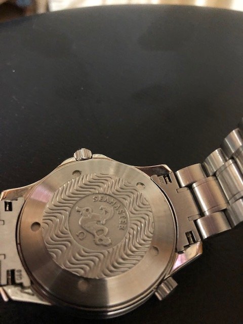

Ok, he managed to take a clean shot of the SN and it matches the number on the warranty card 😀
986
3,013
Here the picture 😀

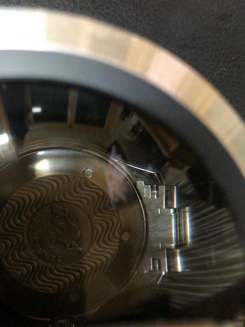

The watch still has a red dot on the case back, which means it hasn't been opened quite some time.
Then, how does the seller know that movement has a faulty spring?
