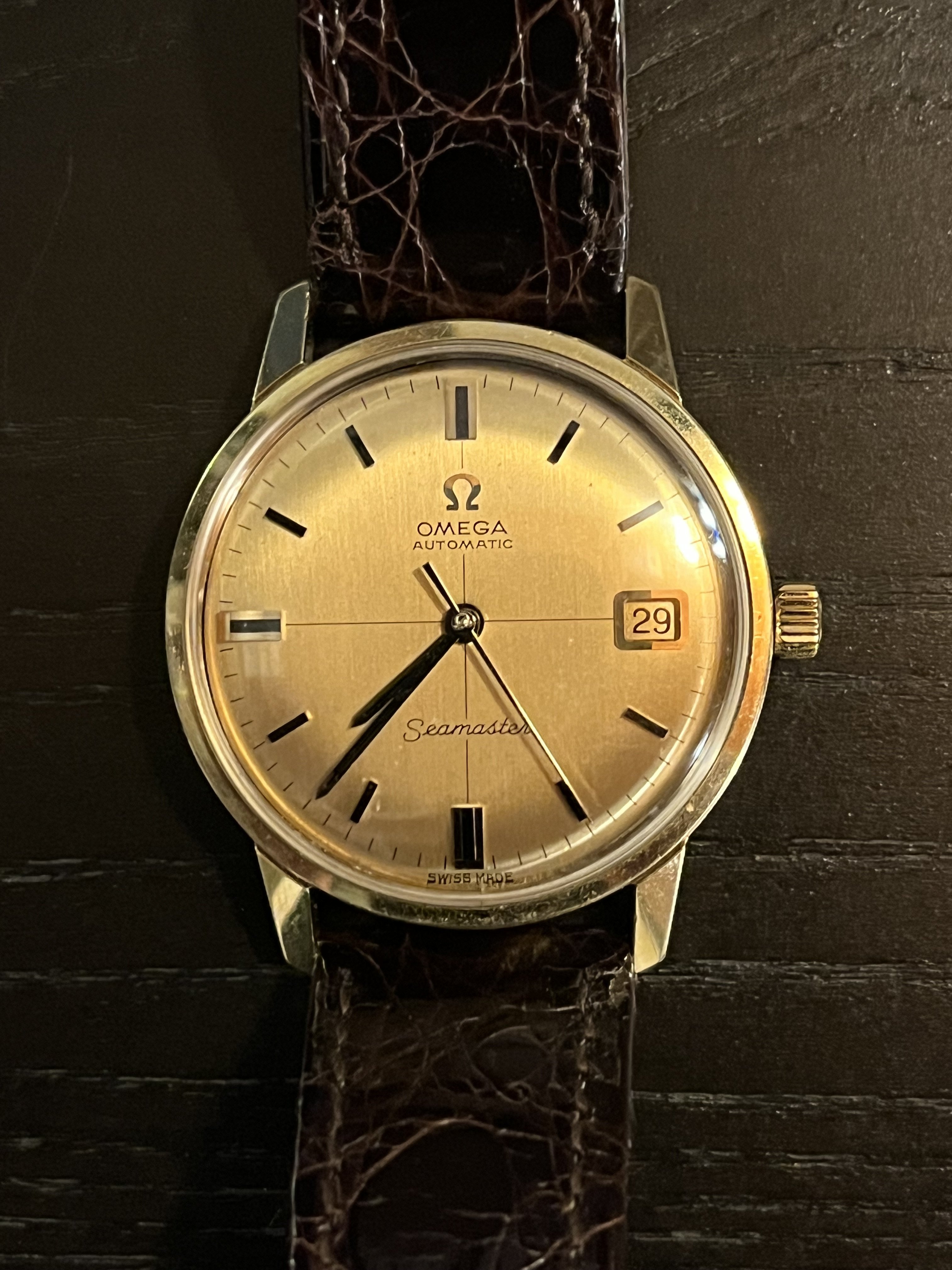

Now that the clocks have gone back the hour, I am now wondering about the correct way to adjust my Seamaster from 1967. Is it safe to move the minute hand anti-clockwise, or do I have to turn clockwise for 23 hours and then adjust the date forward using the pull push mechanism?
I’ve only had the watch a couple of months, so this is a new problem for me.

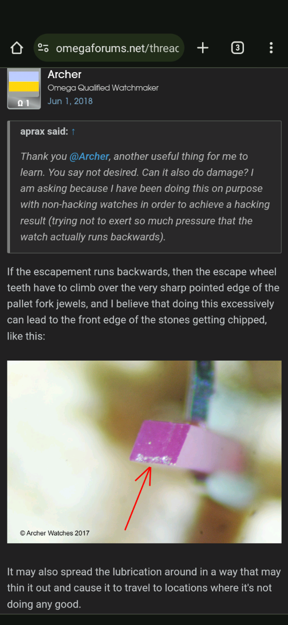

I have often read that one should not turn anti clockwise.
Can you post some links? I know that there is bad information on the internet, but that's just absurd.

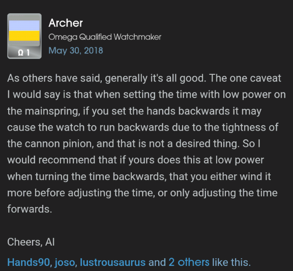

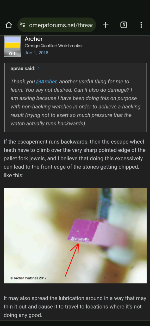

@Archer posted this but that was regarding a 1861;
Yes, I understand it's not great for the escapement to run backwards. But most watches don't do that. And as we all know, the whole premise of a semi-quickset date feature is to advance the date by alternately moving the time backwards and forwards. And if you have a non-quickset date, if you can't set it backwards, if it were a few minutes fast you would have to either let the watch run down, or move forward an entire month.
