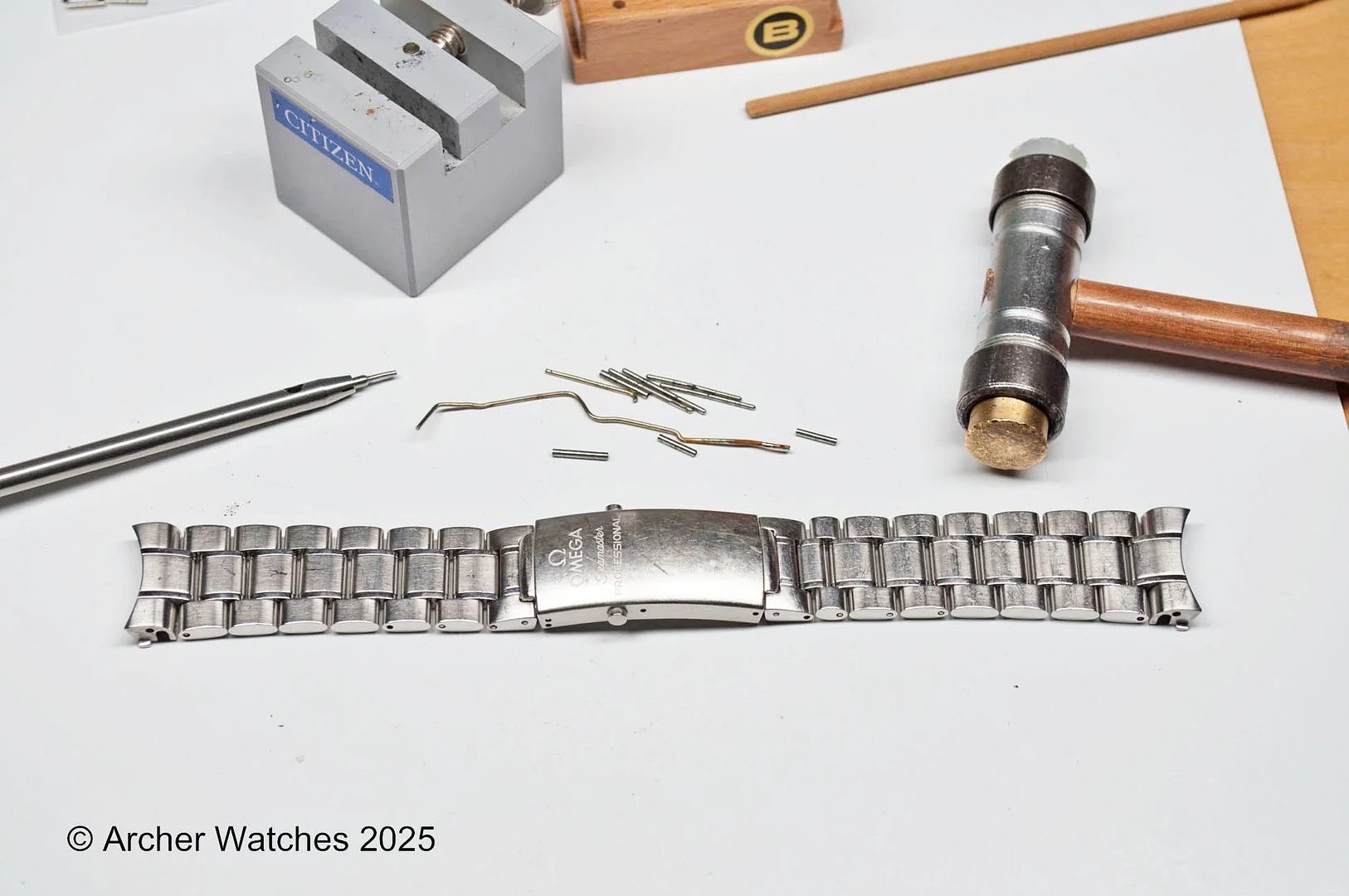

I find those little machines that push the pins out annoying and inefficient, I secure the bracelet in a block and tap the pin out vertically with a pin and hammer, same process when reinstalling the pin. We use whatever we are comfortable with.
Agreed. My comfort level doesn’t know when the resistance on tiny watch parts is appropriate or not. For the modern speedy bracelet that brought me to this thread I was so confused because screws and pins have always been easier for me than pin and collar but the loctite threw me for a loop in this instance.
Yup…

Yup…
The picture reminds me of the very first time I resized a bracelet and didn’t realize I should be doing it on a white surface. You’d think that one is obvious but live and learn.
