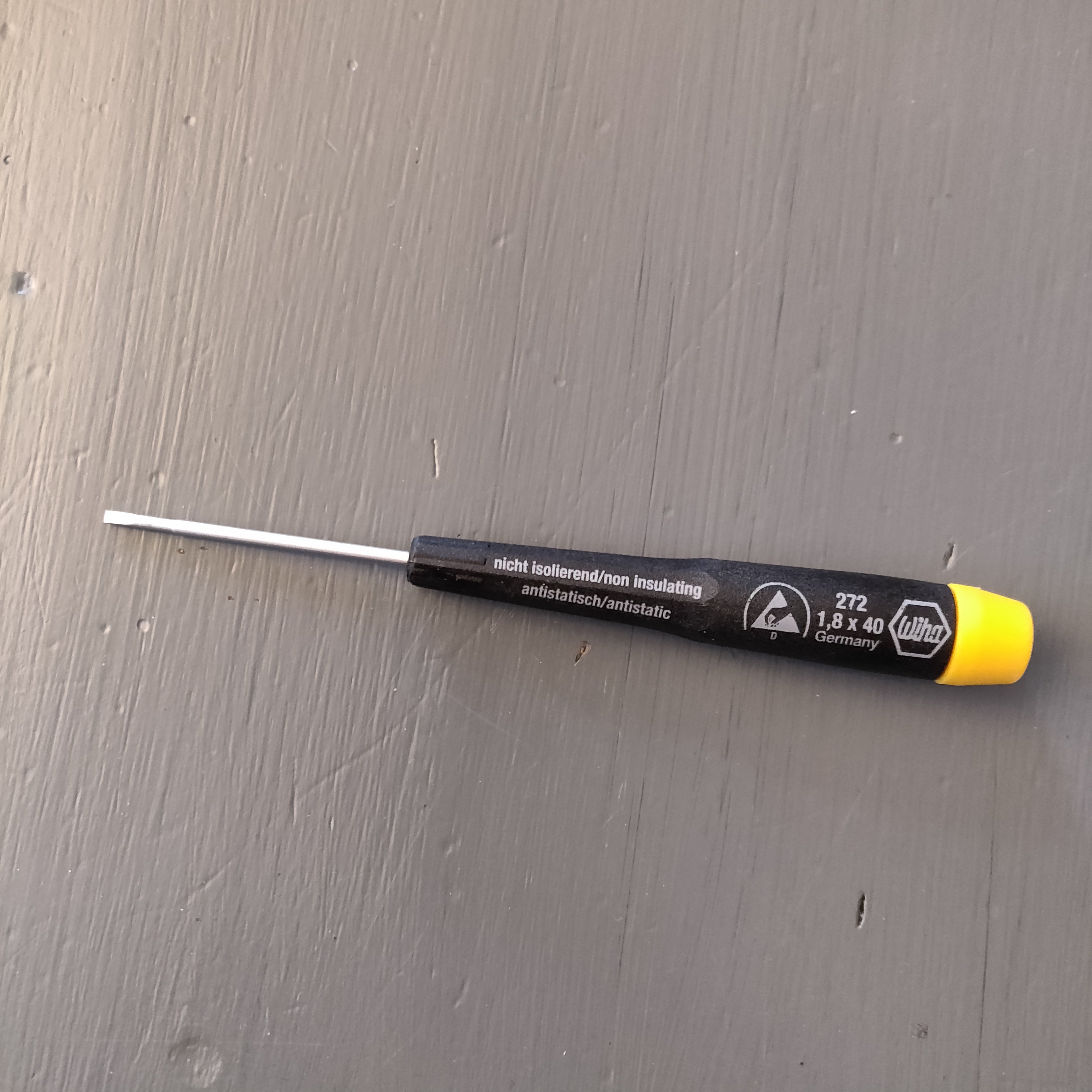

Make sure you have a decent screwdriver as well. It makes all the difference!
This is the one that I am using

1,4 mm good screwdriver, or it will be a mess.
I did it last week and was easy job.

I agree this is the one I used to adjust mine and broke the thread lock fairly easily.

Can't speak for the 3861 bracelet but on my 1861 bracelet, I used heat and boiling water and I f***ed the screws right up by not using the right screw driver. Close enough isn't good enough for omega screws.
I ordered a Wiha 1.8mm screw driver and spare screws then it was a piece of cake. Lesson learnt...I was just being impatient as I didn't have the right screwdriver initially. Right tool for the job makes all the differences.

1,8 mm good screwdriver, or it will be a mess.
Is it 1.8 or 1.6? My set has only 1.6
