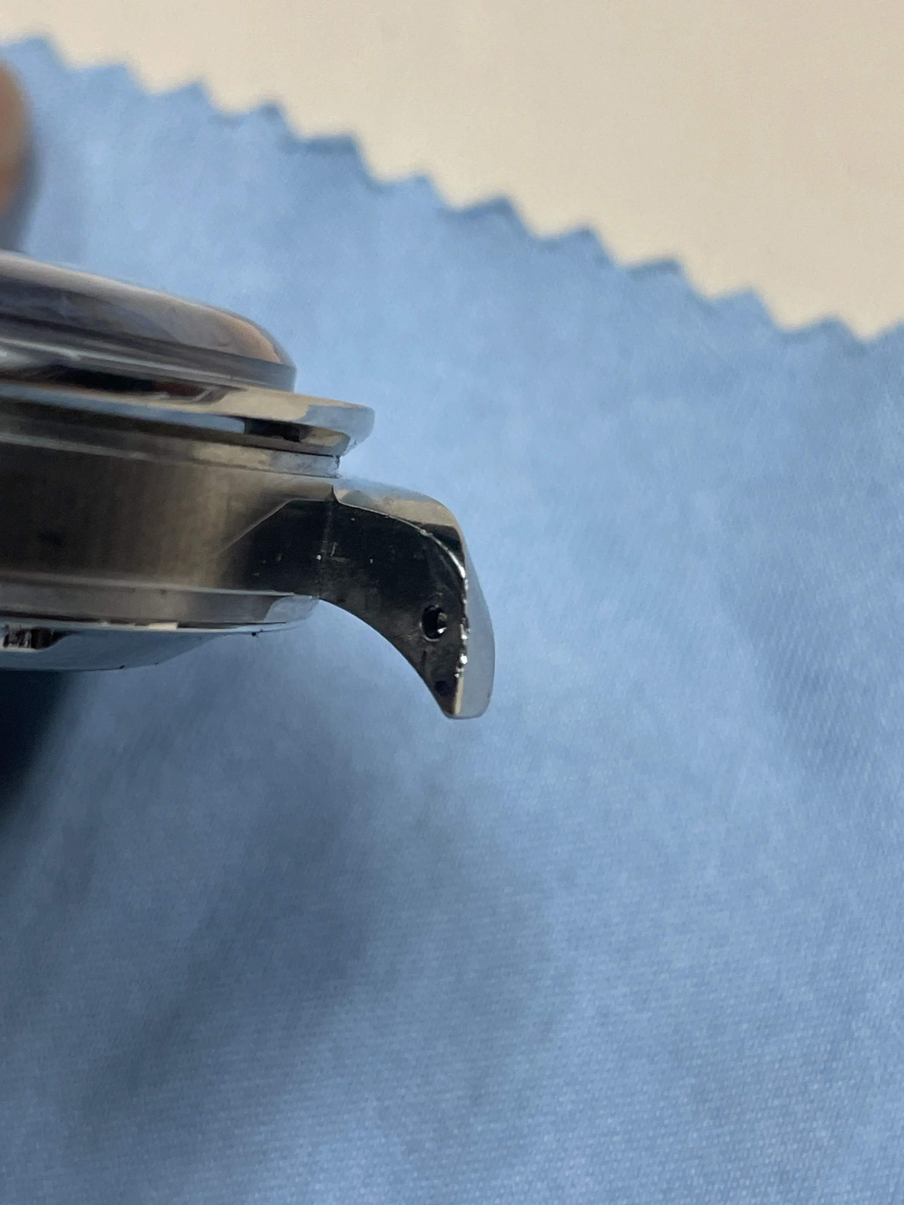

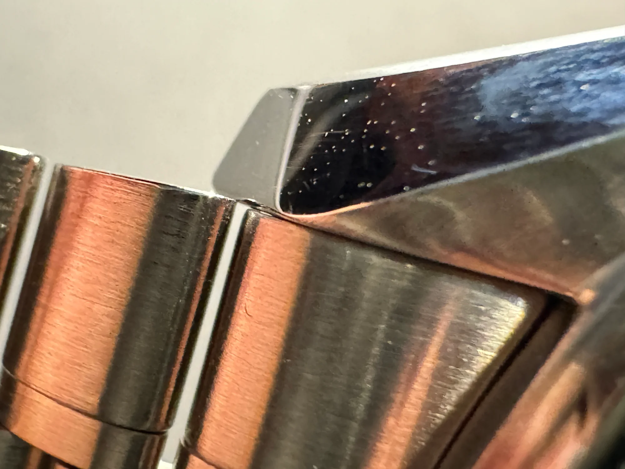

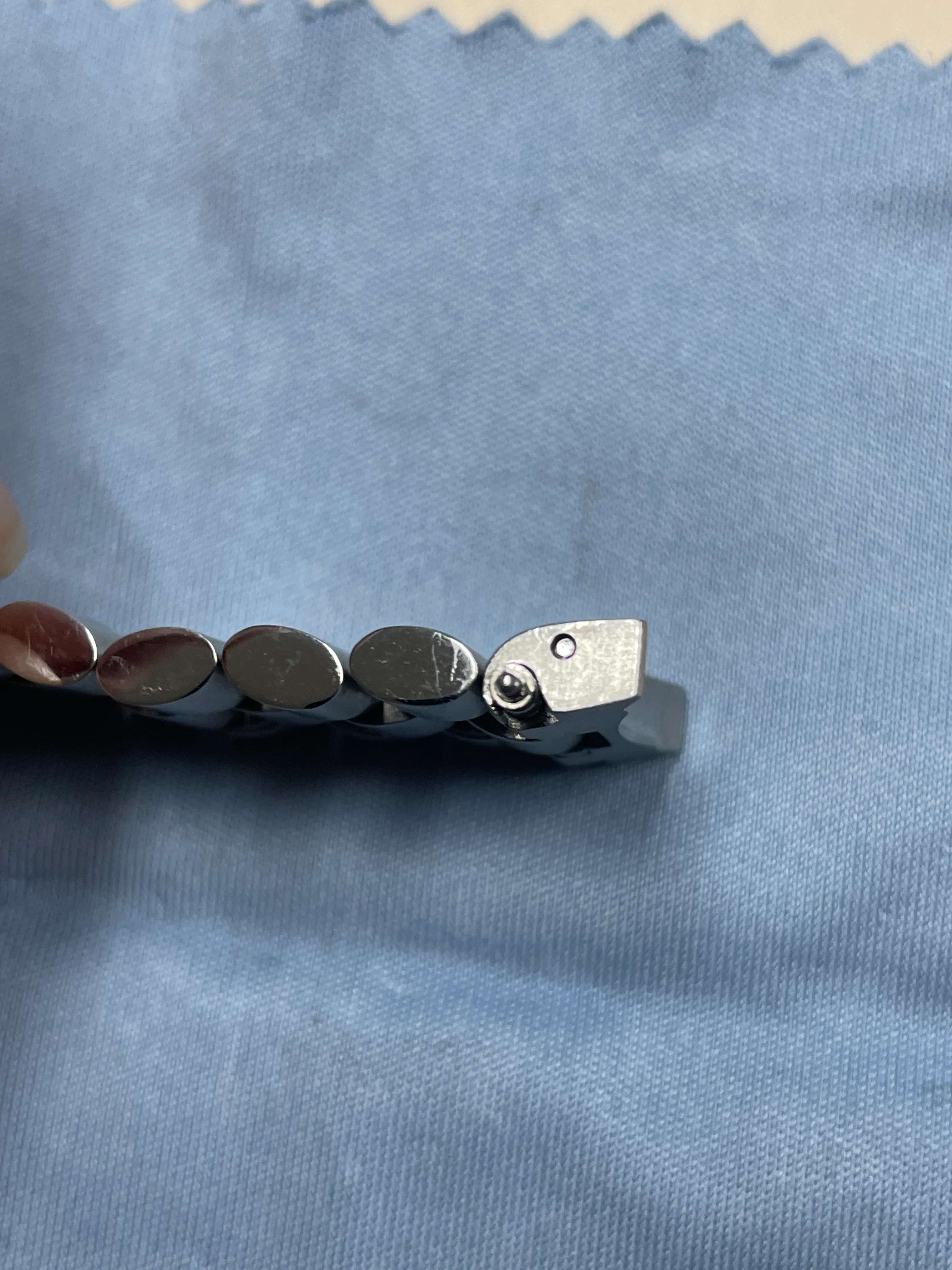

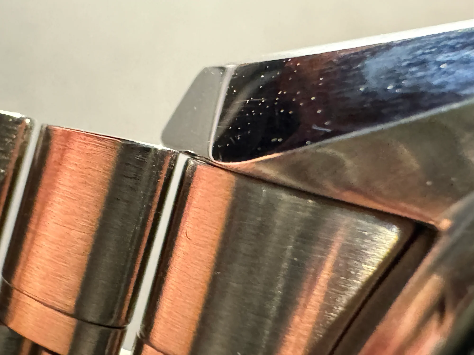

Hi,

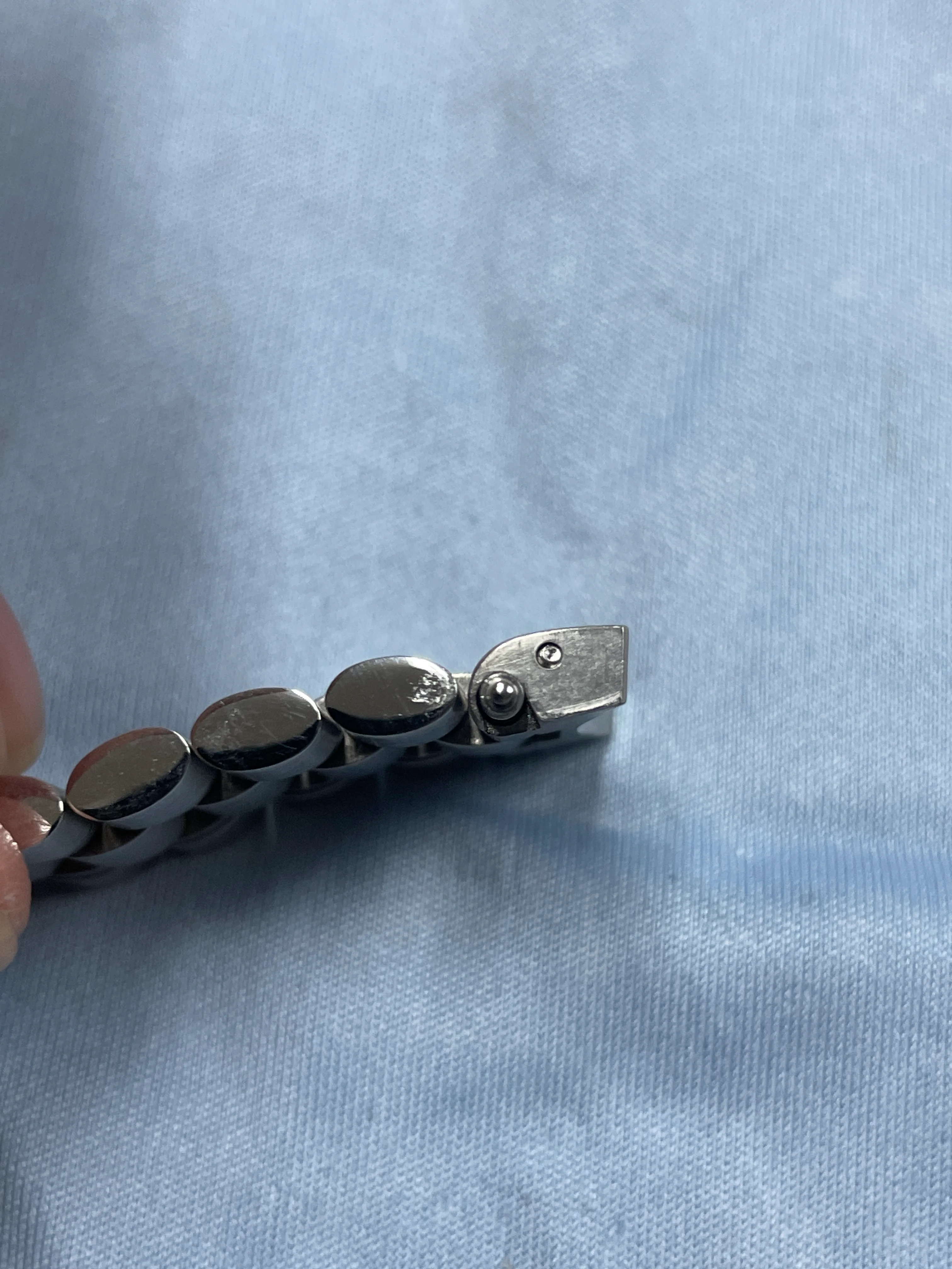

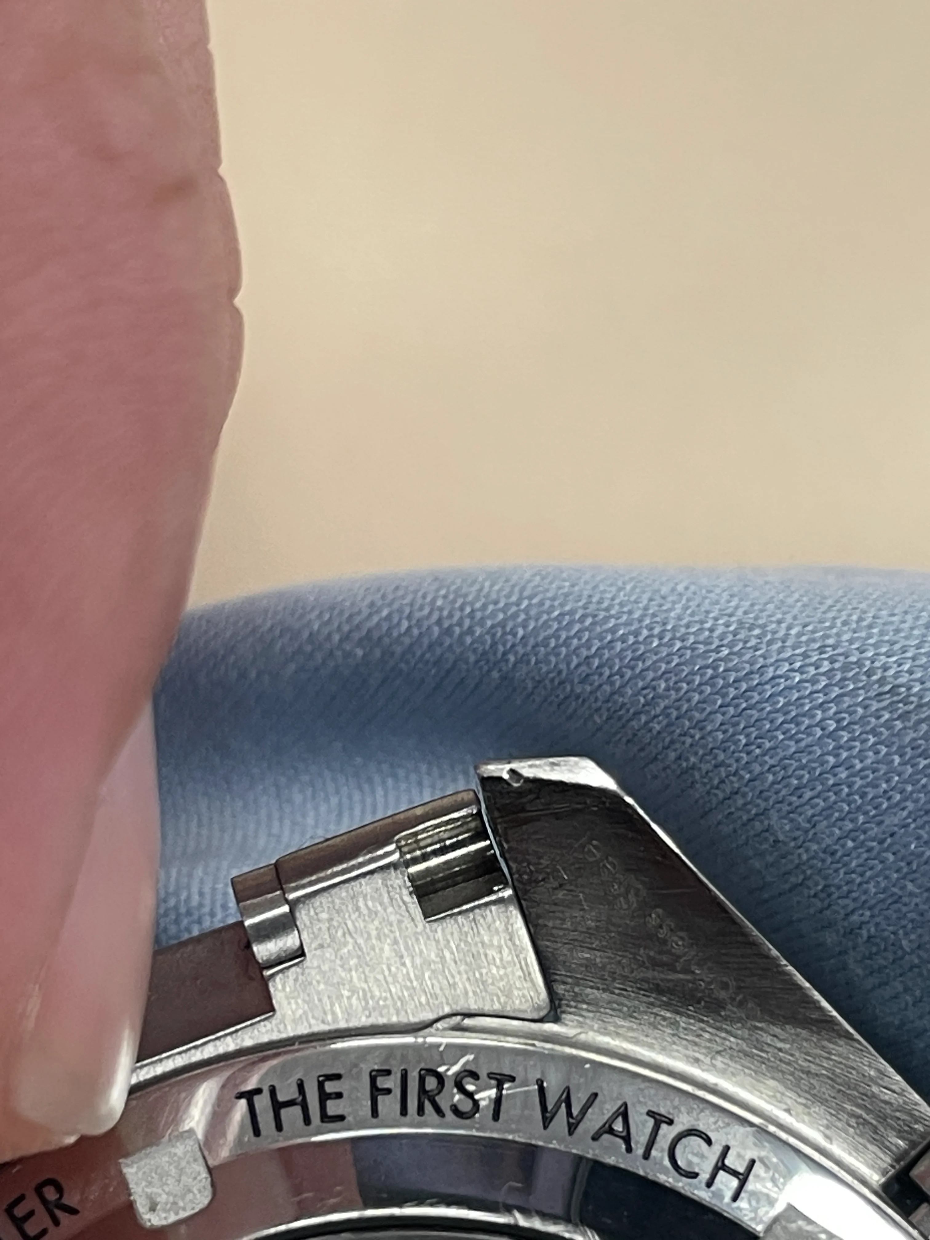

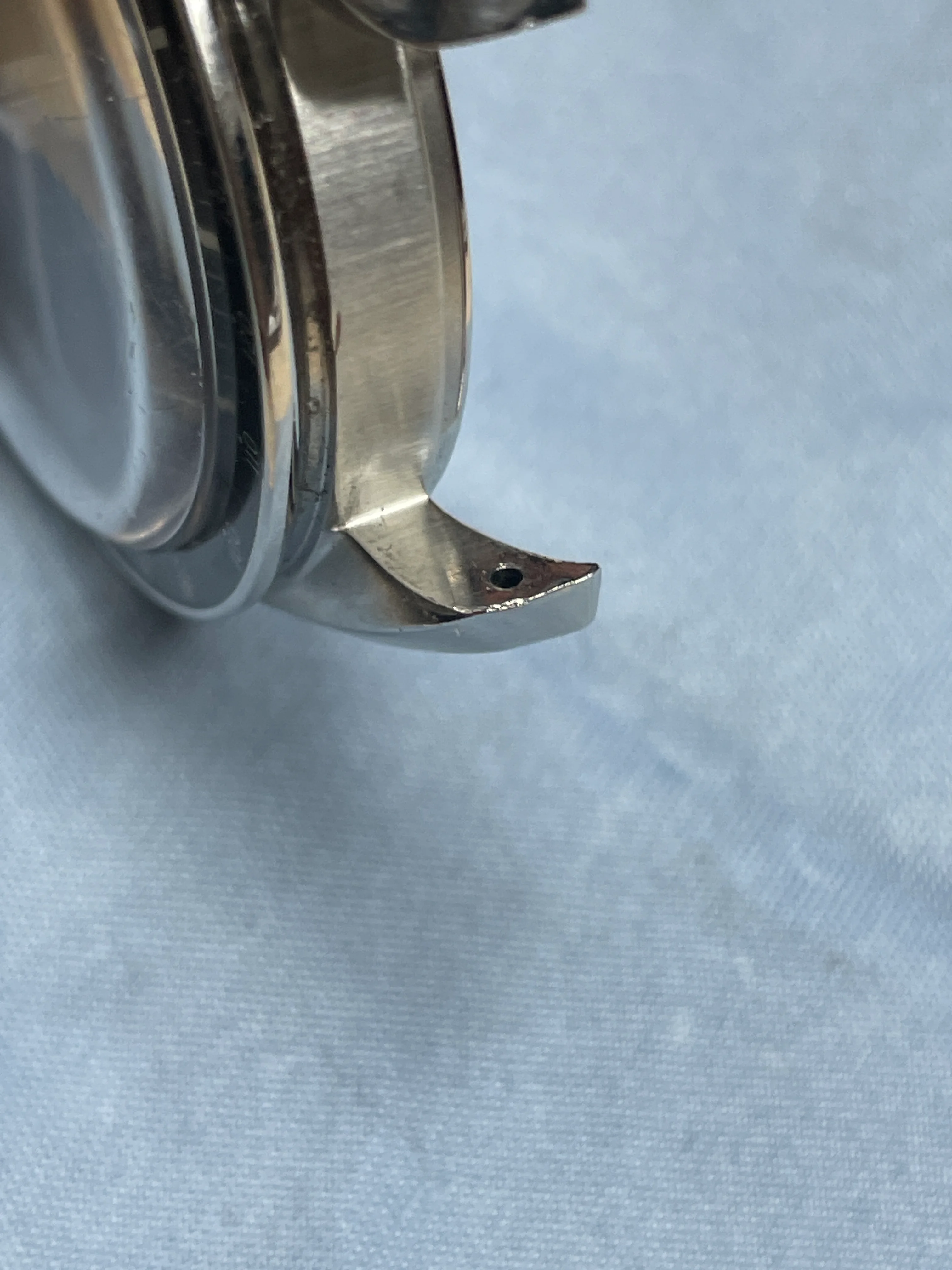

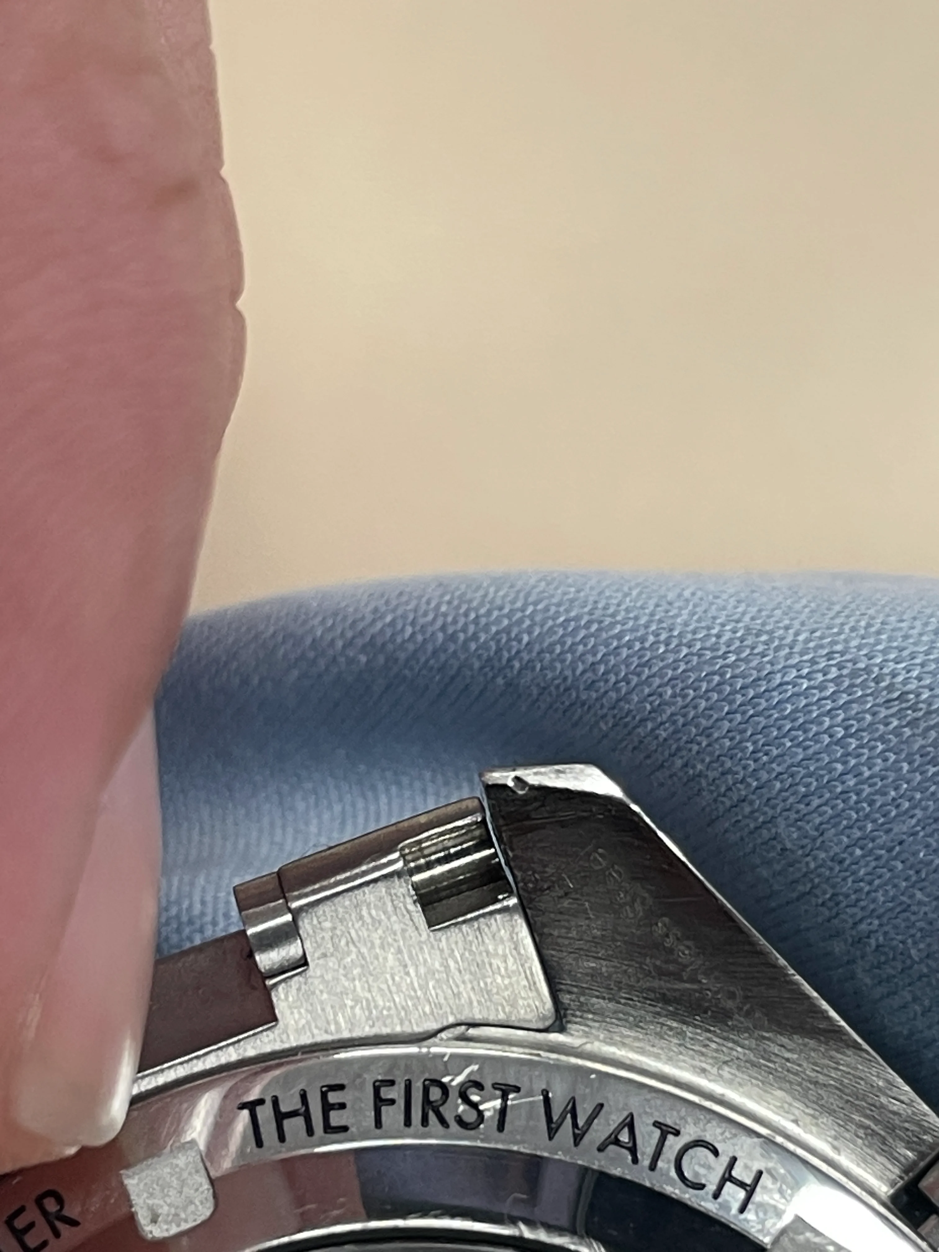

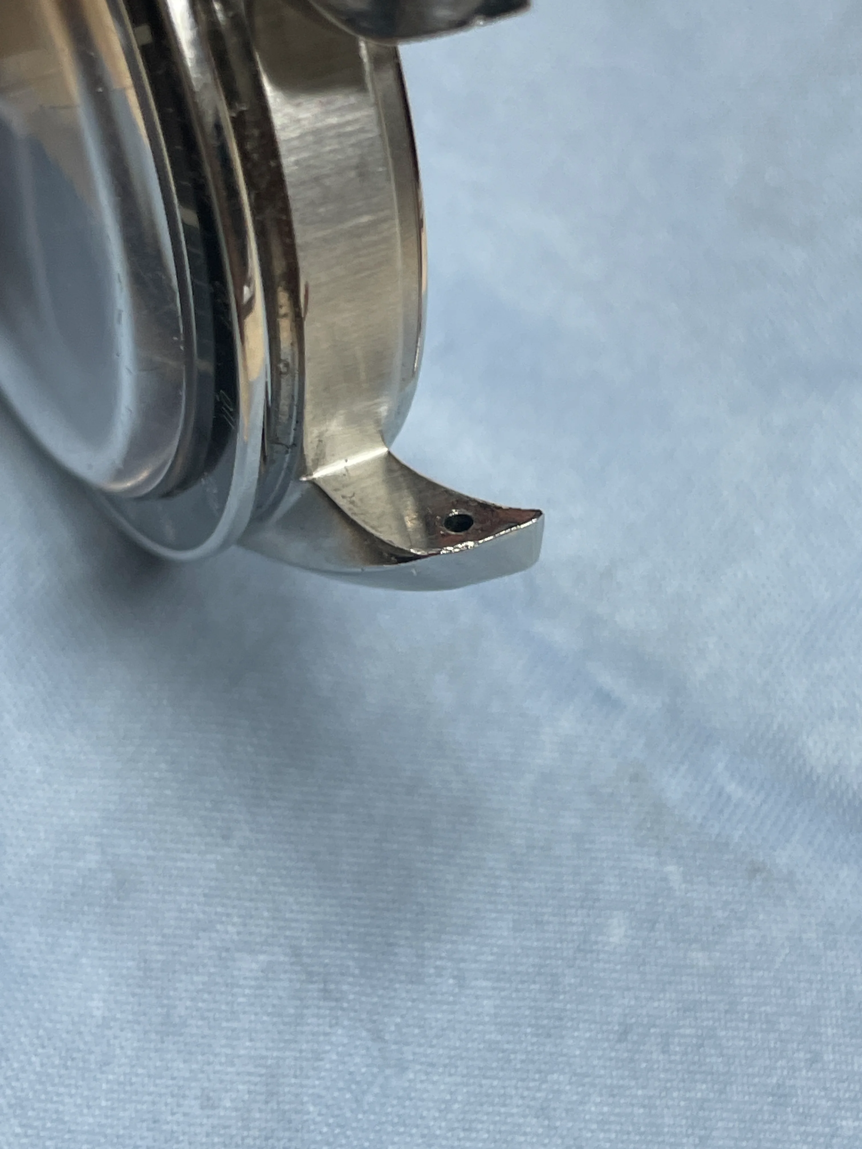

I bought this authentic 3861 bracelet on Ebay and after 1 week noticed the bracelet was catching on the lug and now has caused damage. Has anyone had the same issue and what was the solution? I just removed the bracelet and put the rubber strap back on. Thanks in advance!!
-Steven

What case is that? There is always the possibility that attaching a 3861 bracelet to an older 1861/861 case will cause this kind of problem. Sometimes it works perfectly, other times, not. Are you absolutely positive the bracelet is genuine Omega?

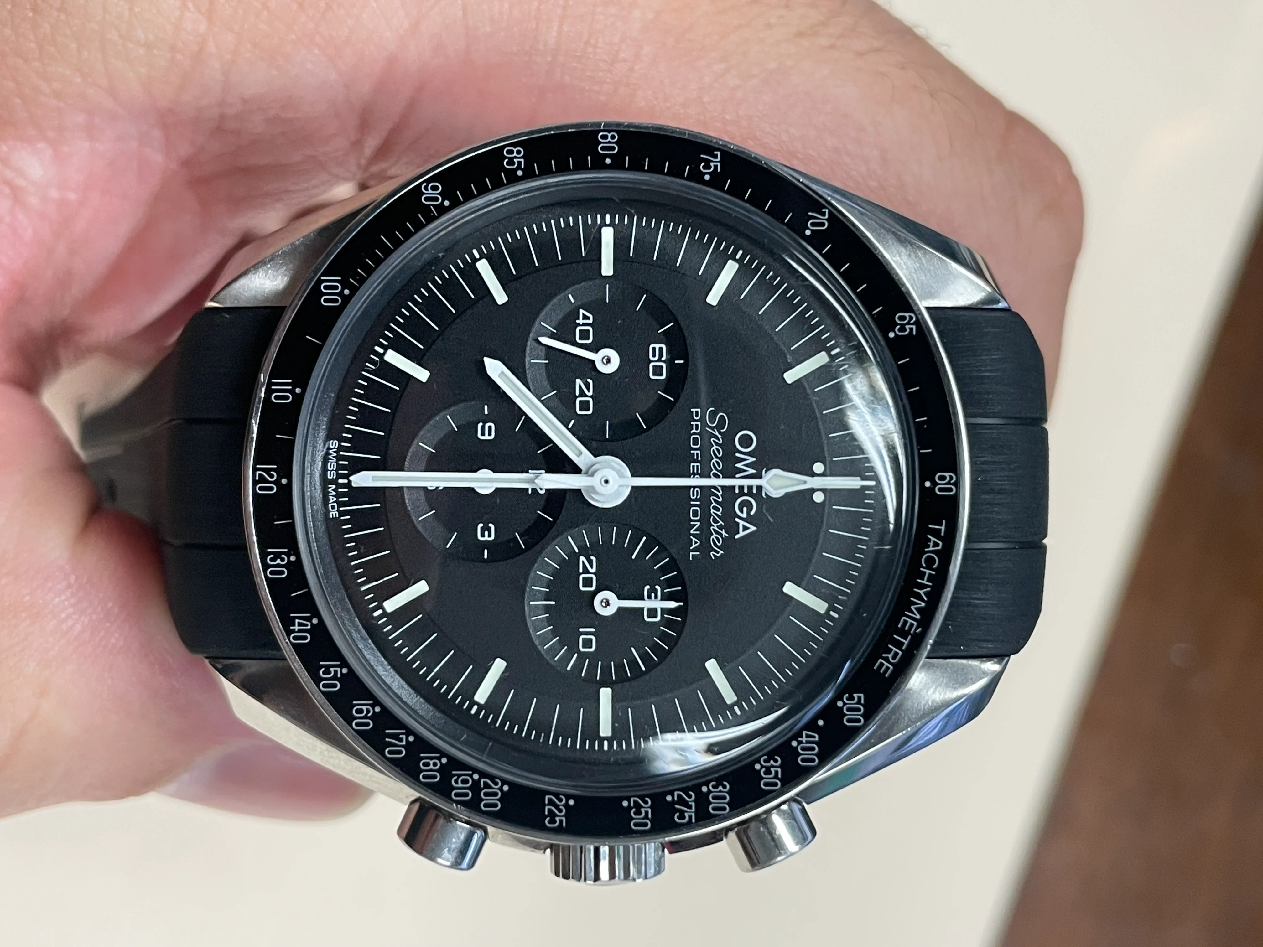

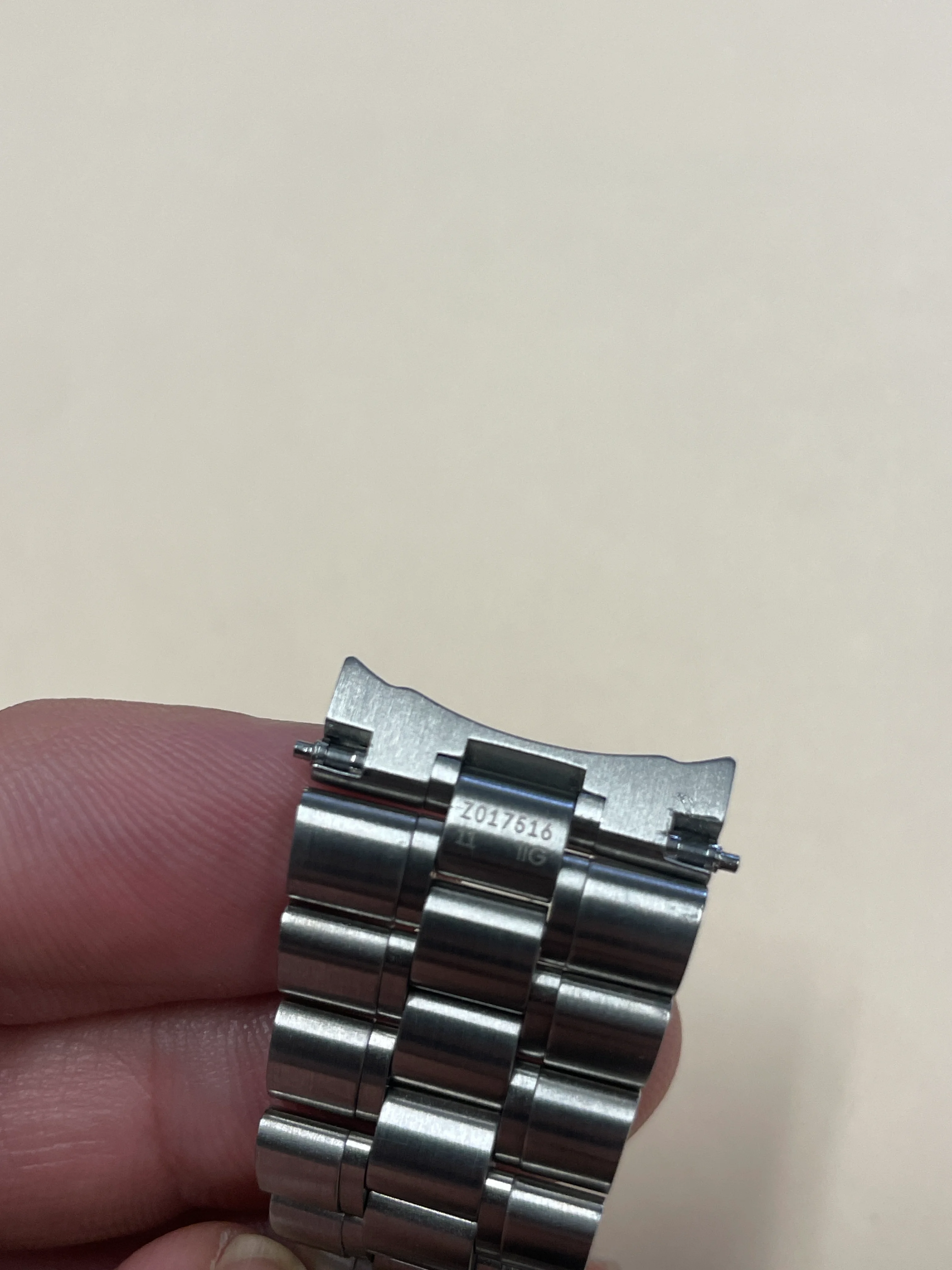

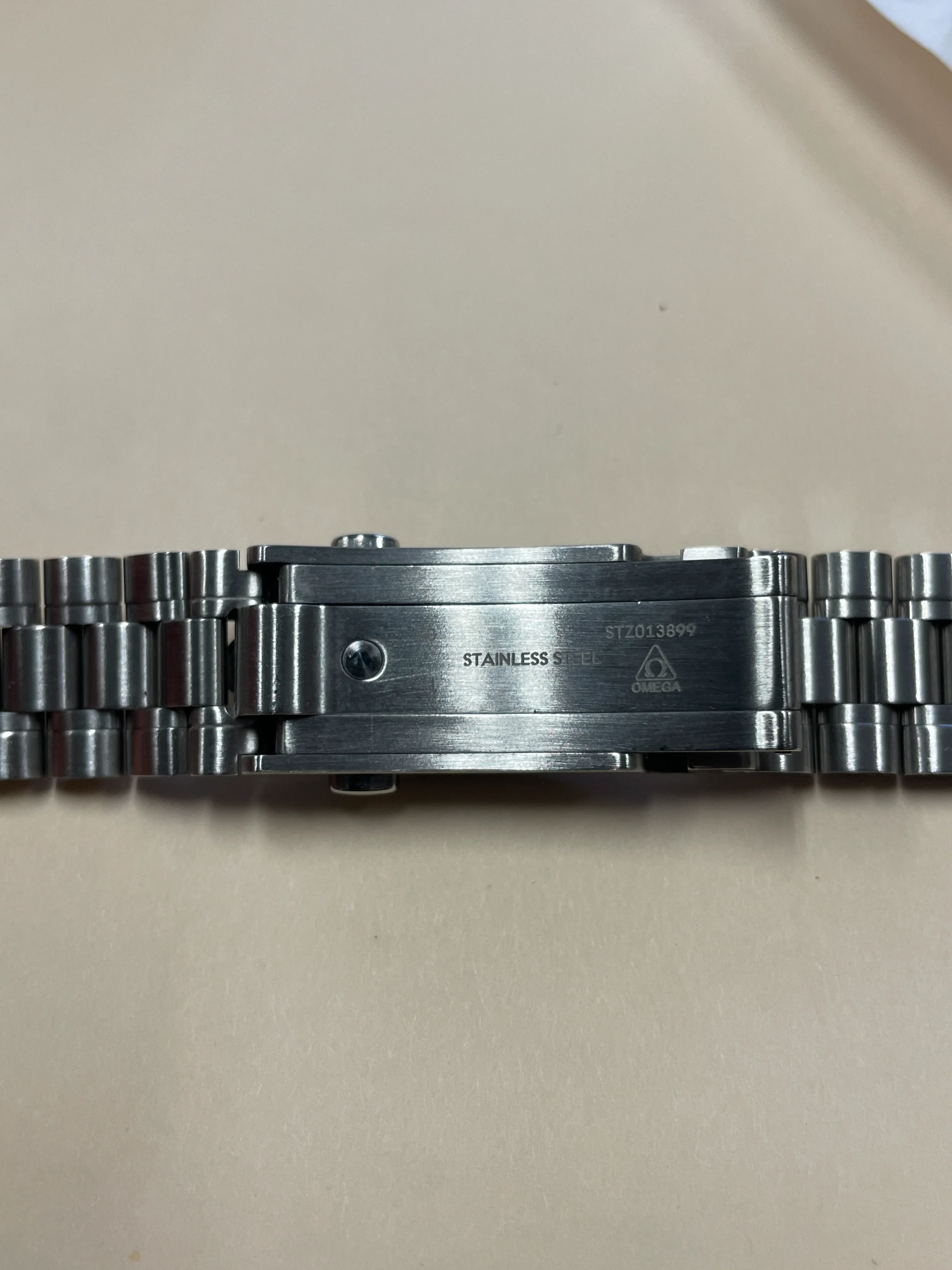

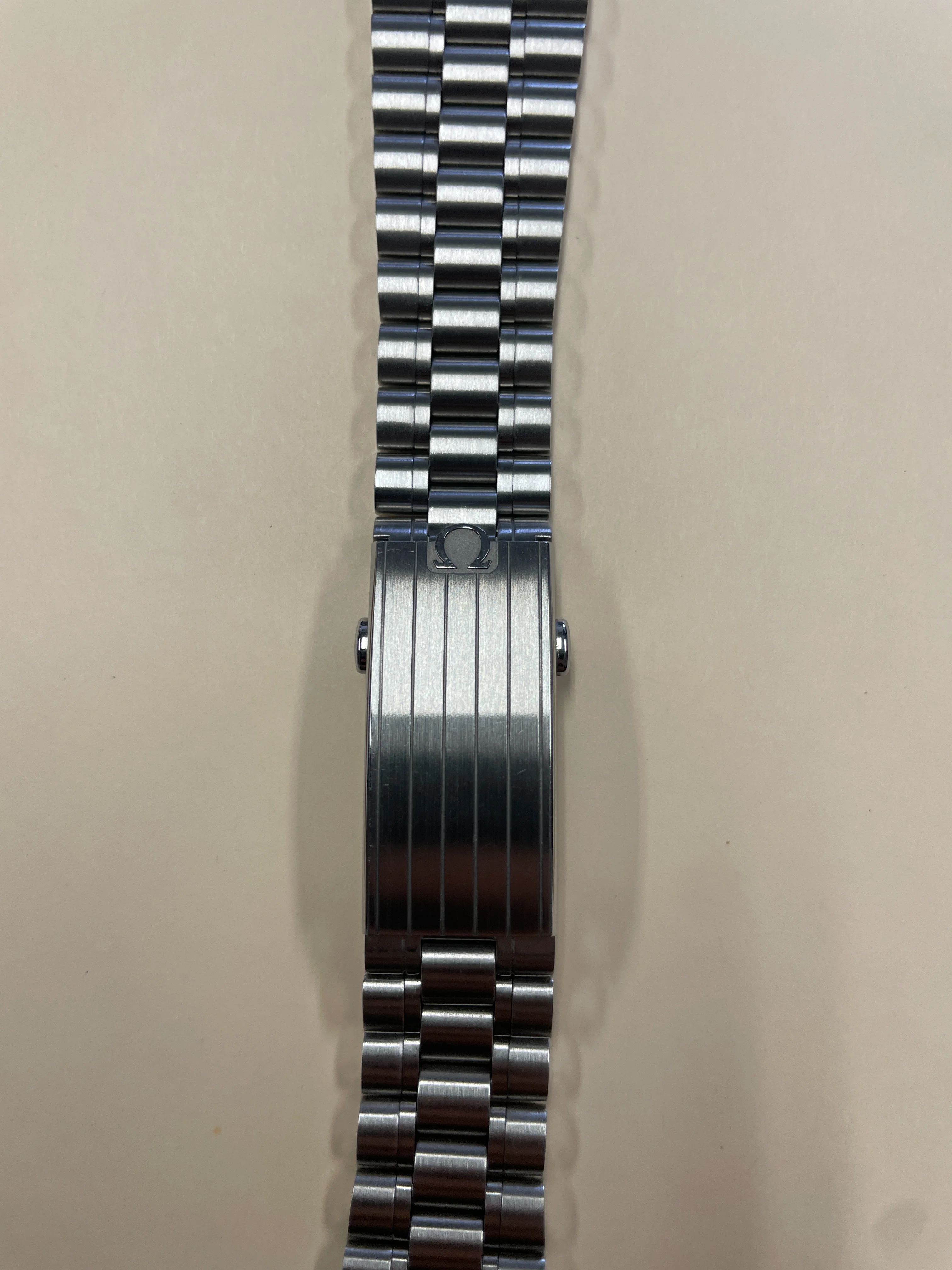

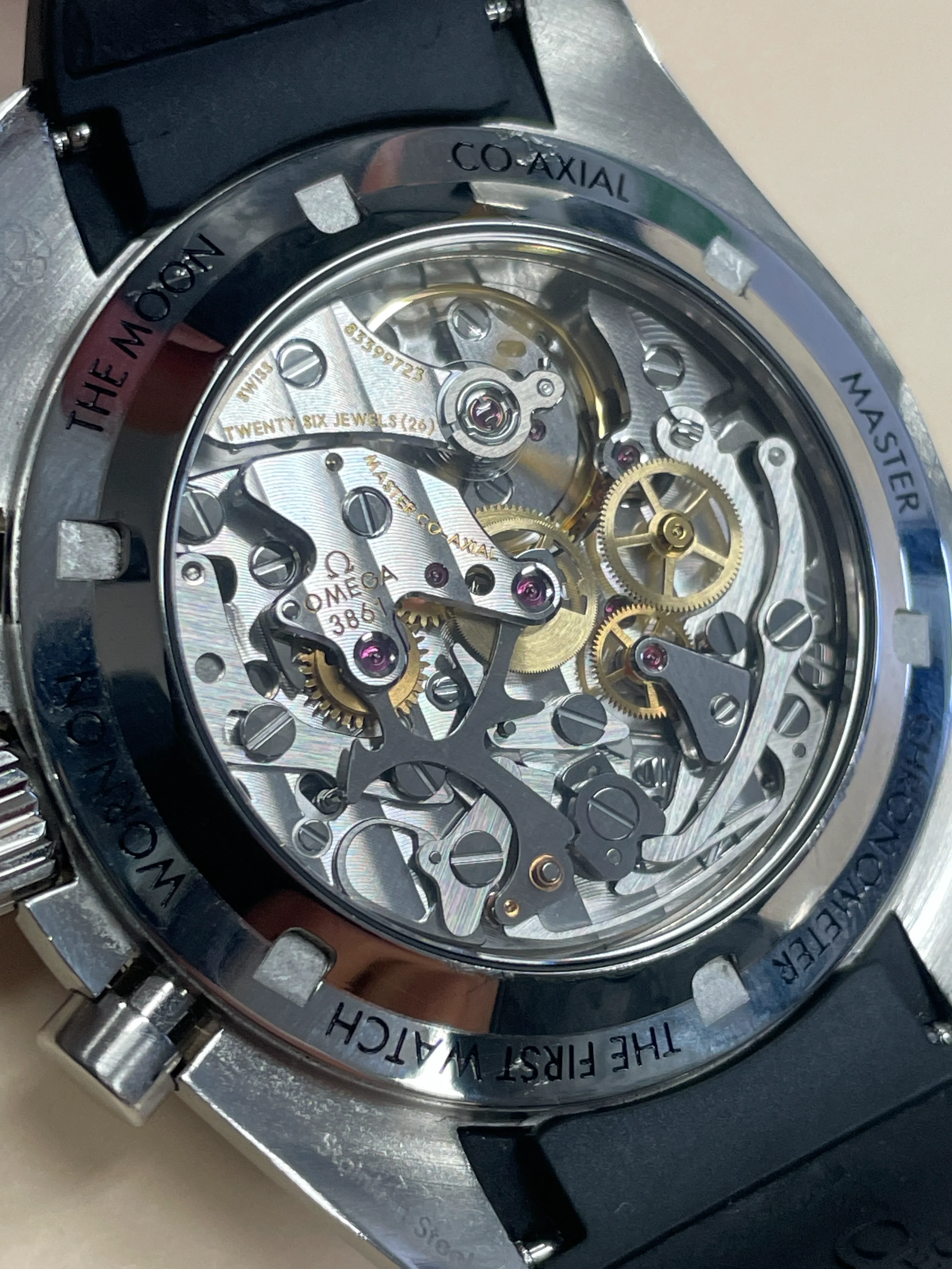

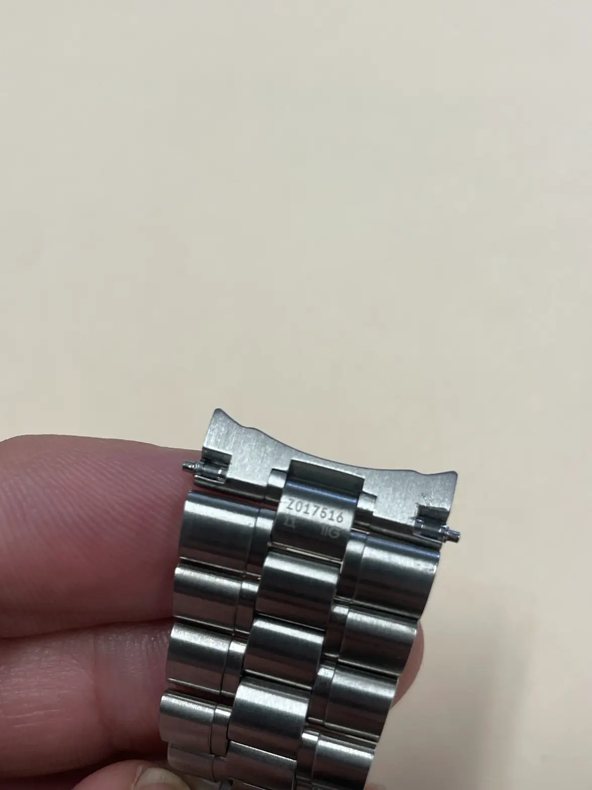

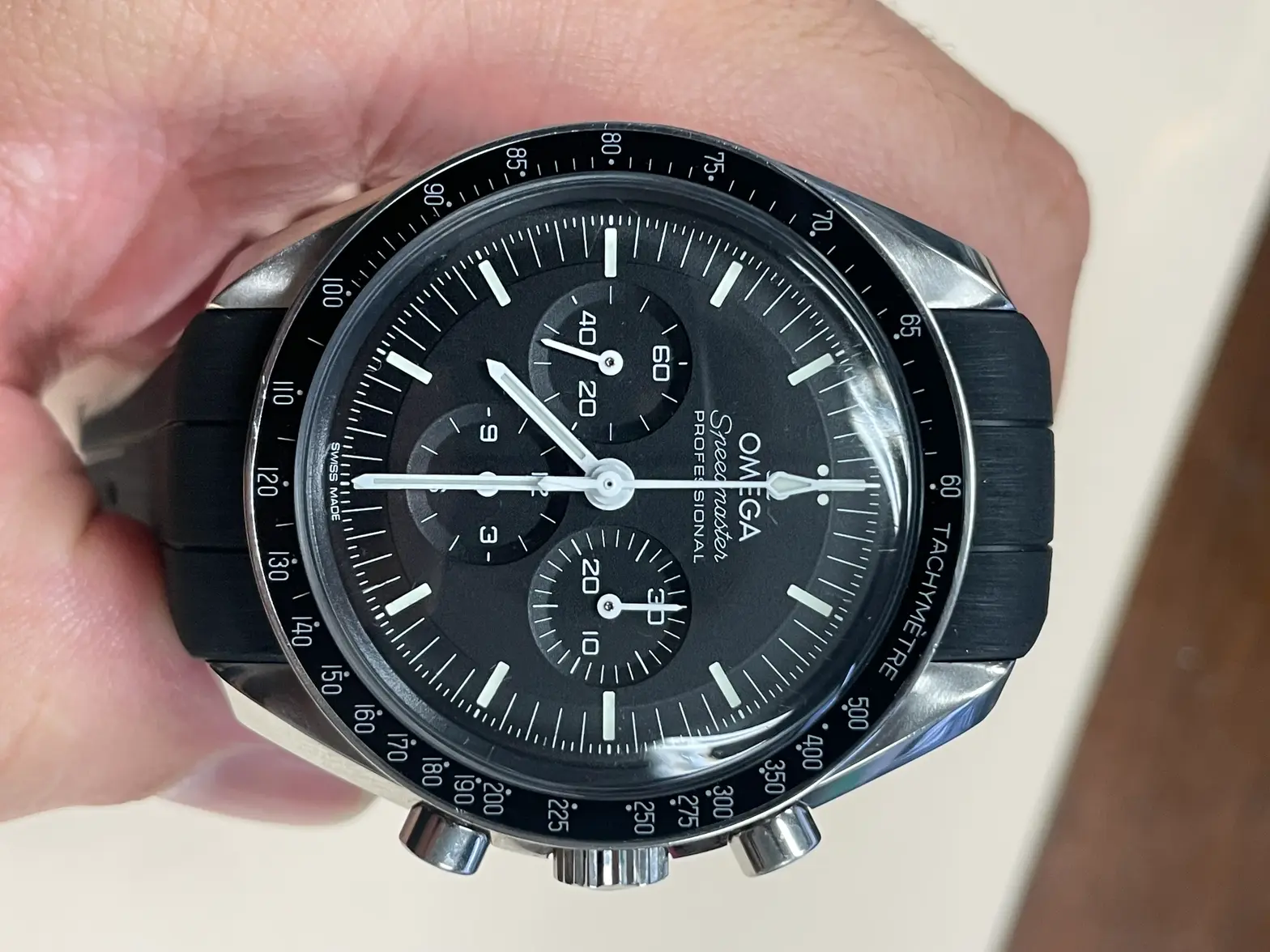

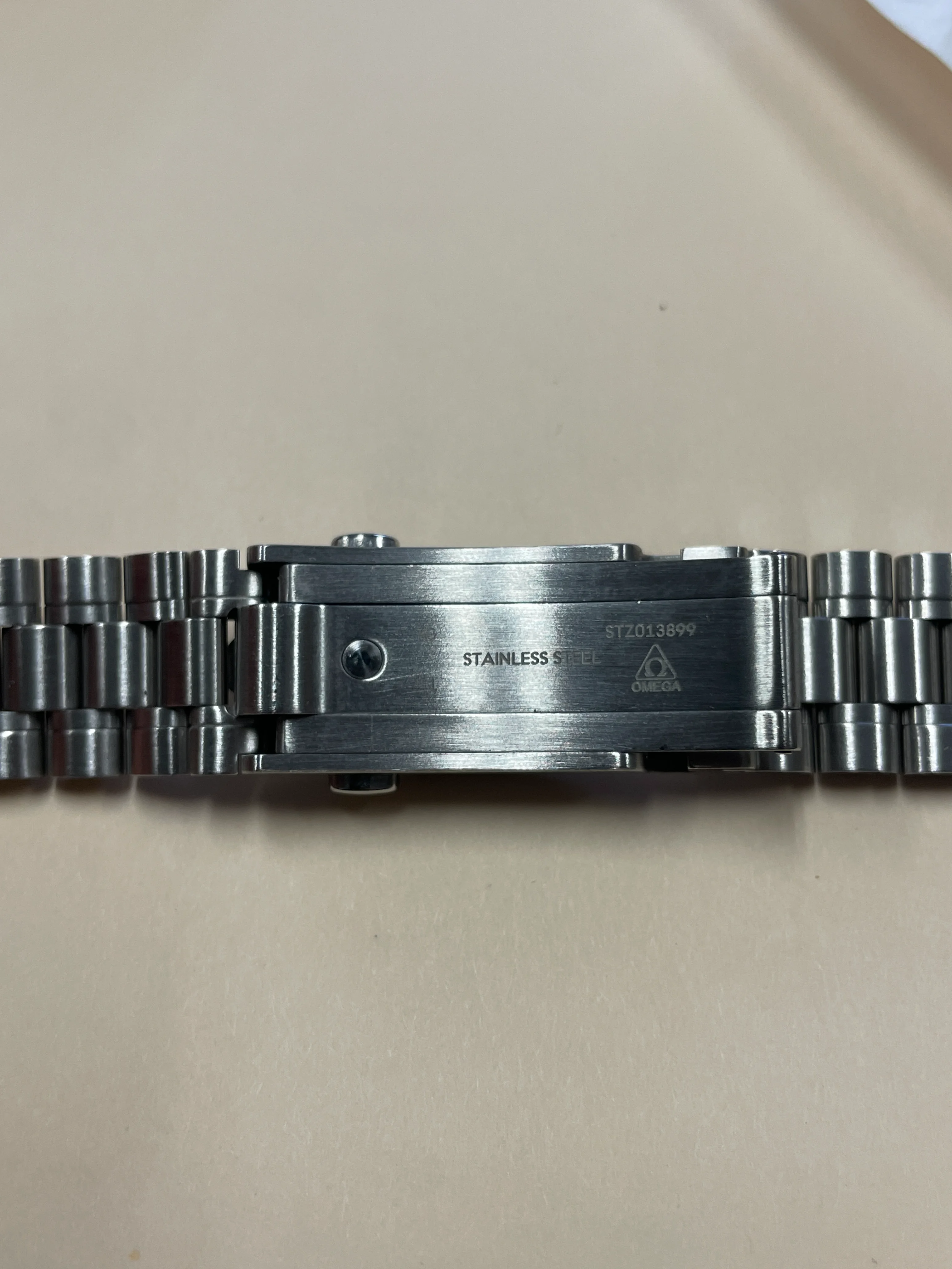

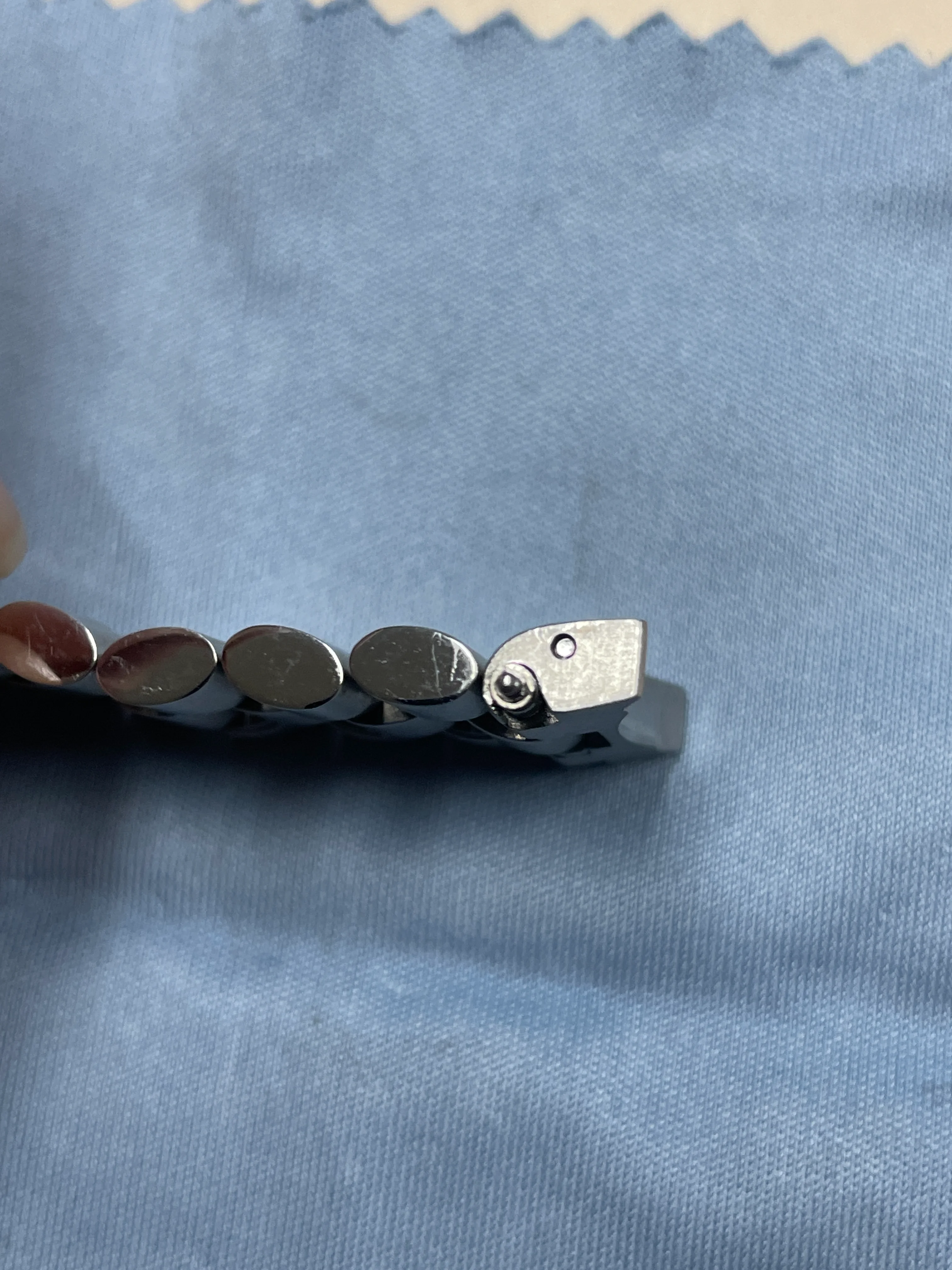

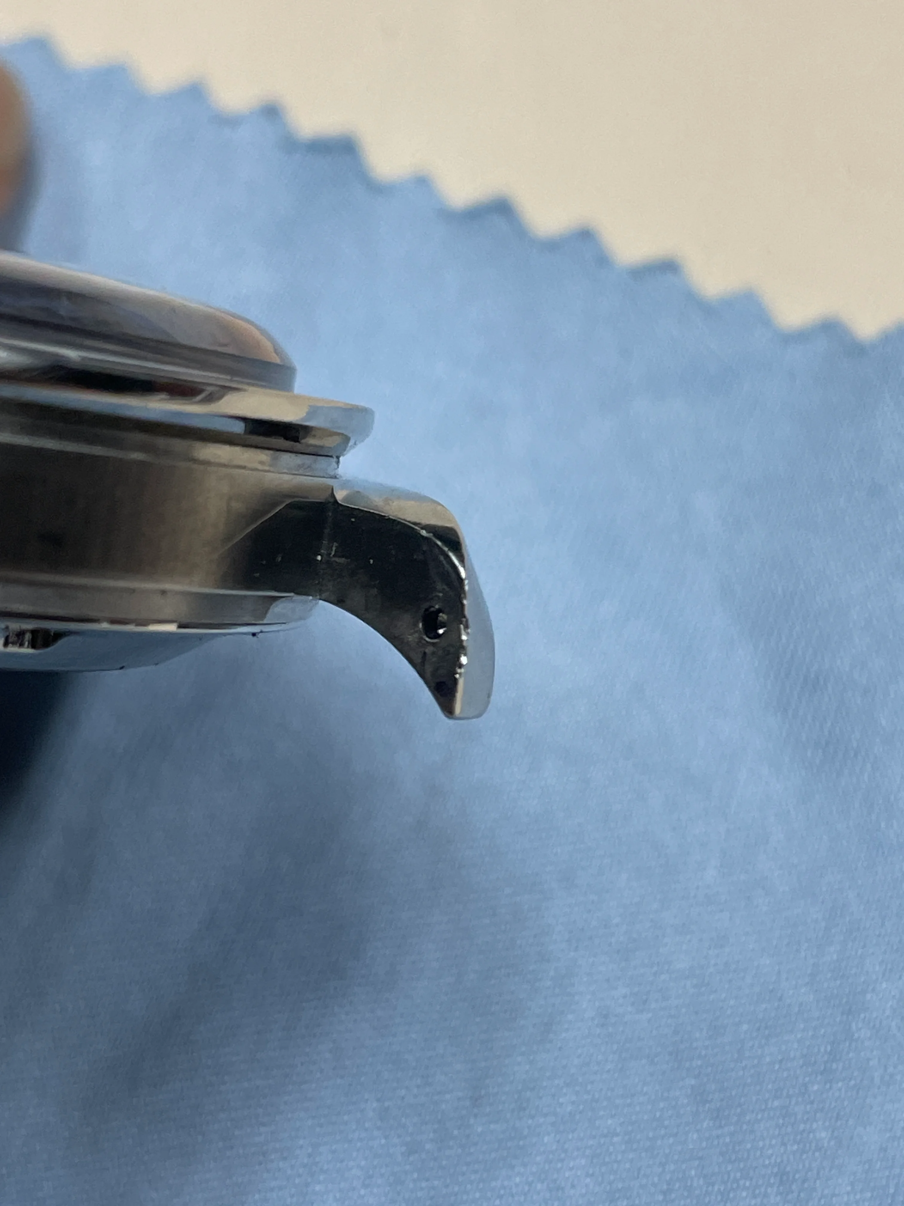

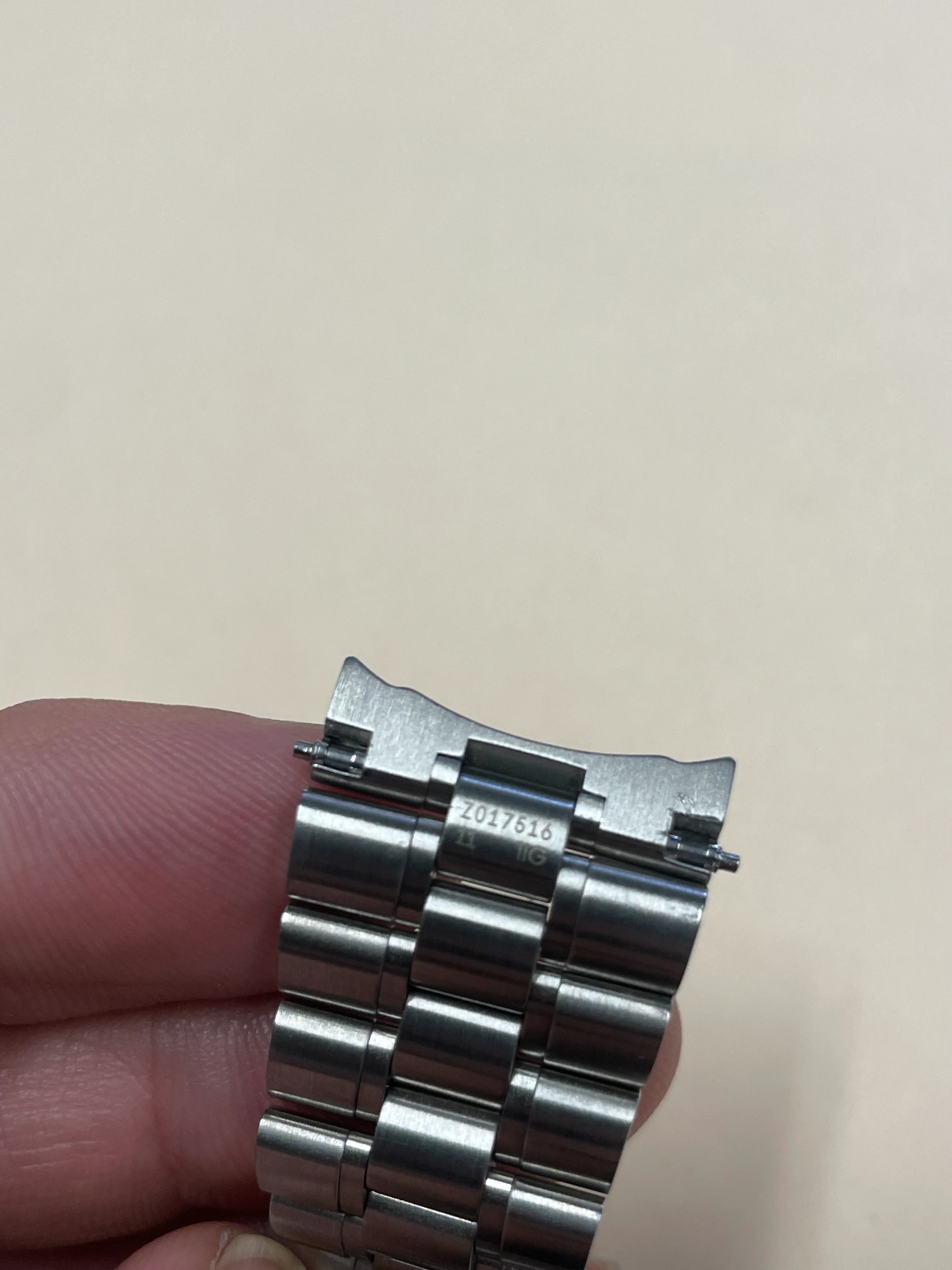

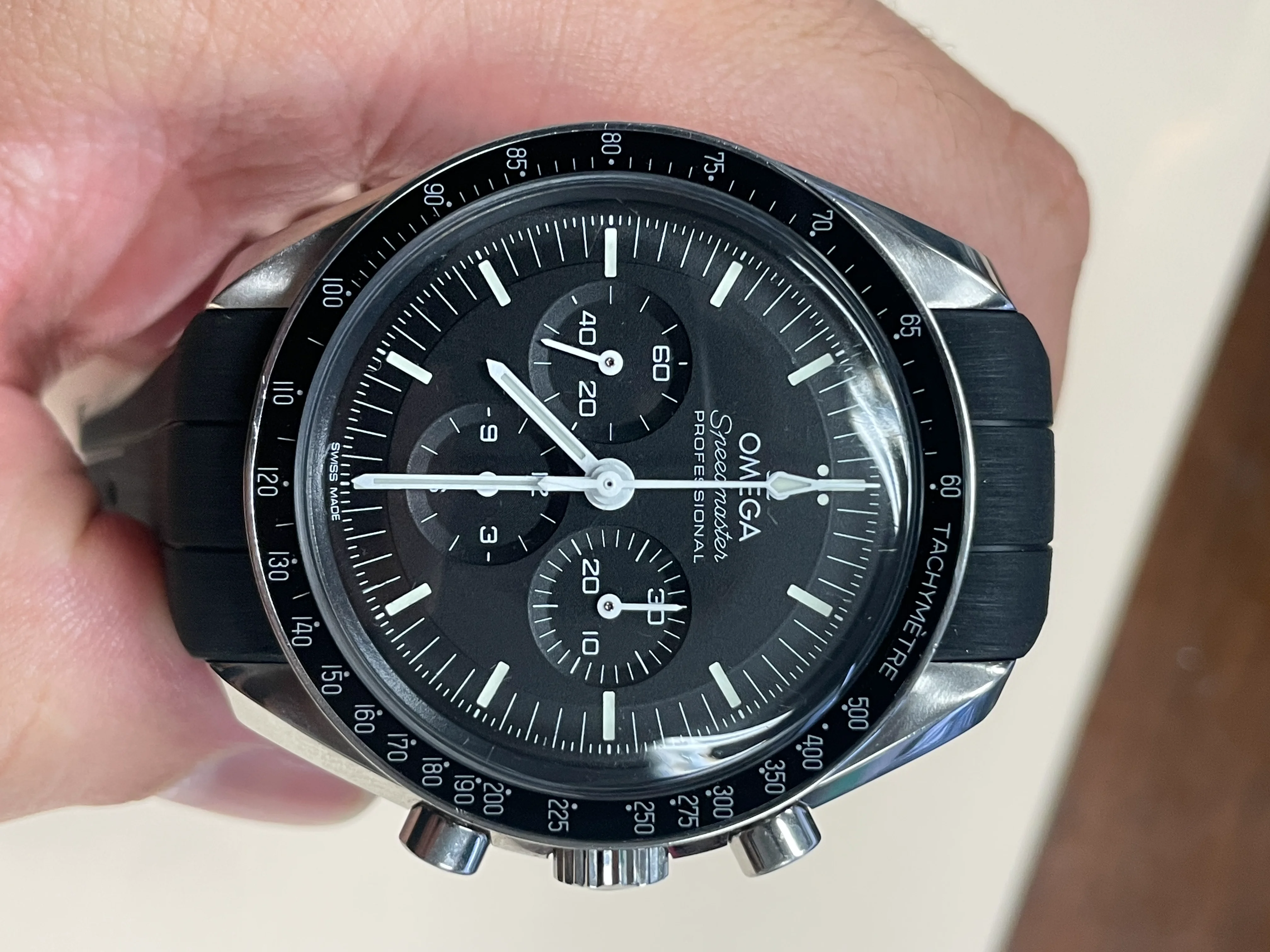

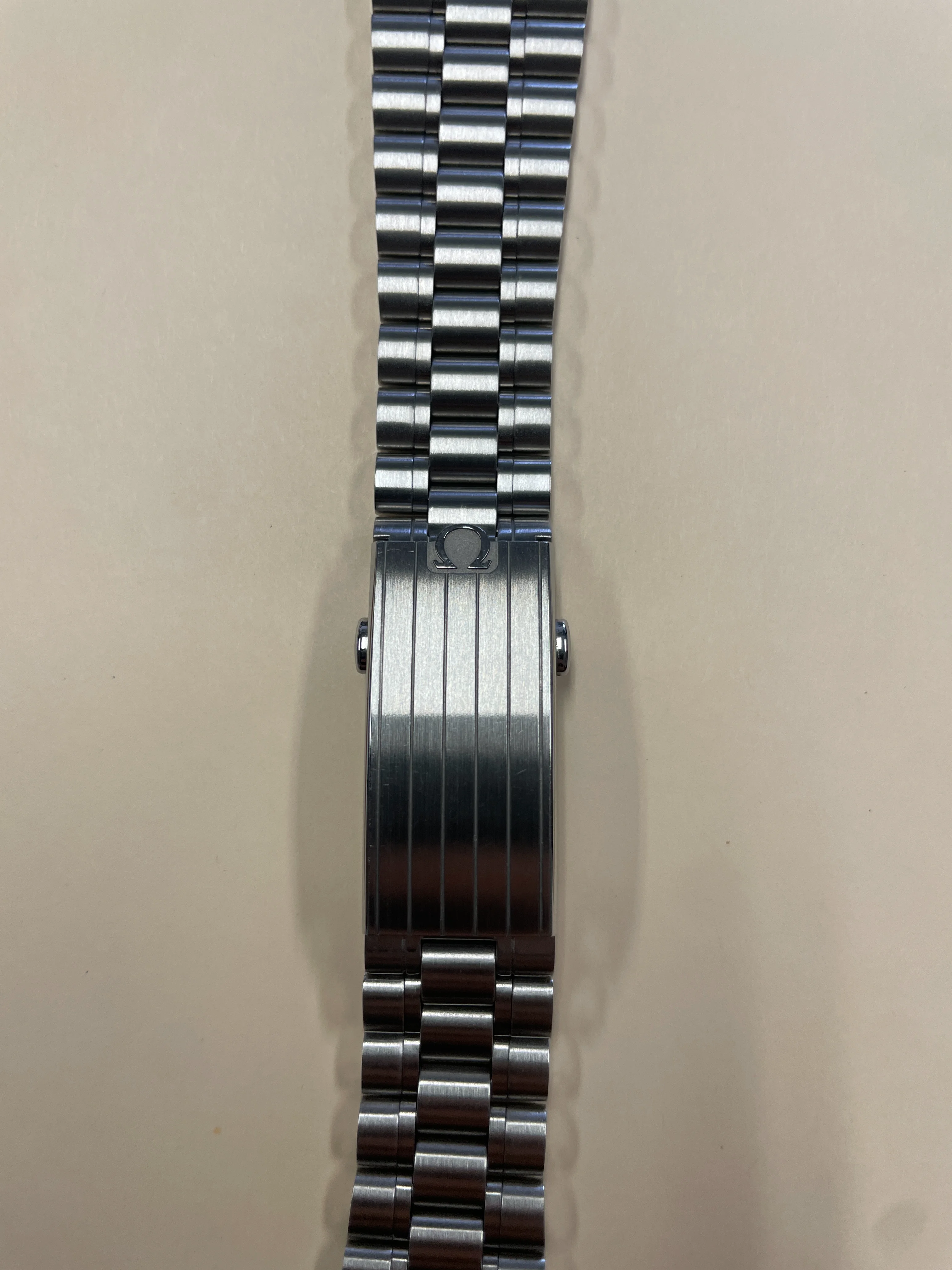

Hi Appreciate your help! It is a hesalite 3861, and I believe the bracelet is genuine. I will have to confirm with a boutique. Here are some photos of both the watch head and bracelet with all items from the purchase. Does the bracelet have a warranty?

That all looks ok and you should get a good fit. Are you using the correct springbar for a bracelet.....068ST2207? You should get a tight fit with no movement of the end links.

You're likely using the wrong spring bars. The spring bars in the image of the bracelet seem original, but the spring bars on your rubber strap are aftermarket. Were you using those on the bracelet?
The bracelet pivots on the spring bar itself. If it's even slightly thinner than the original, it'll be enough to touch the lugs. I'm trying to force mine to touch the lugs, but it won't. The tolerances are super tight and are unforgiving if you use the wrong spring bars.

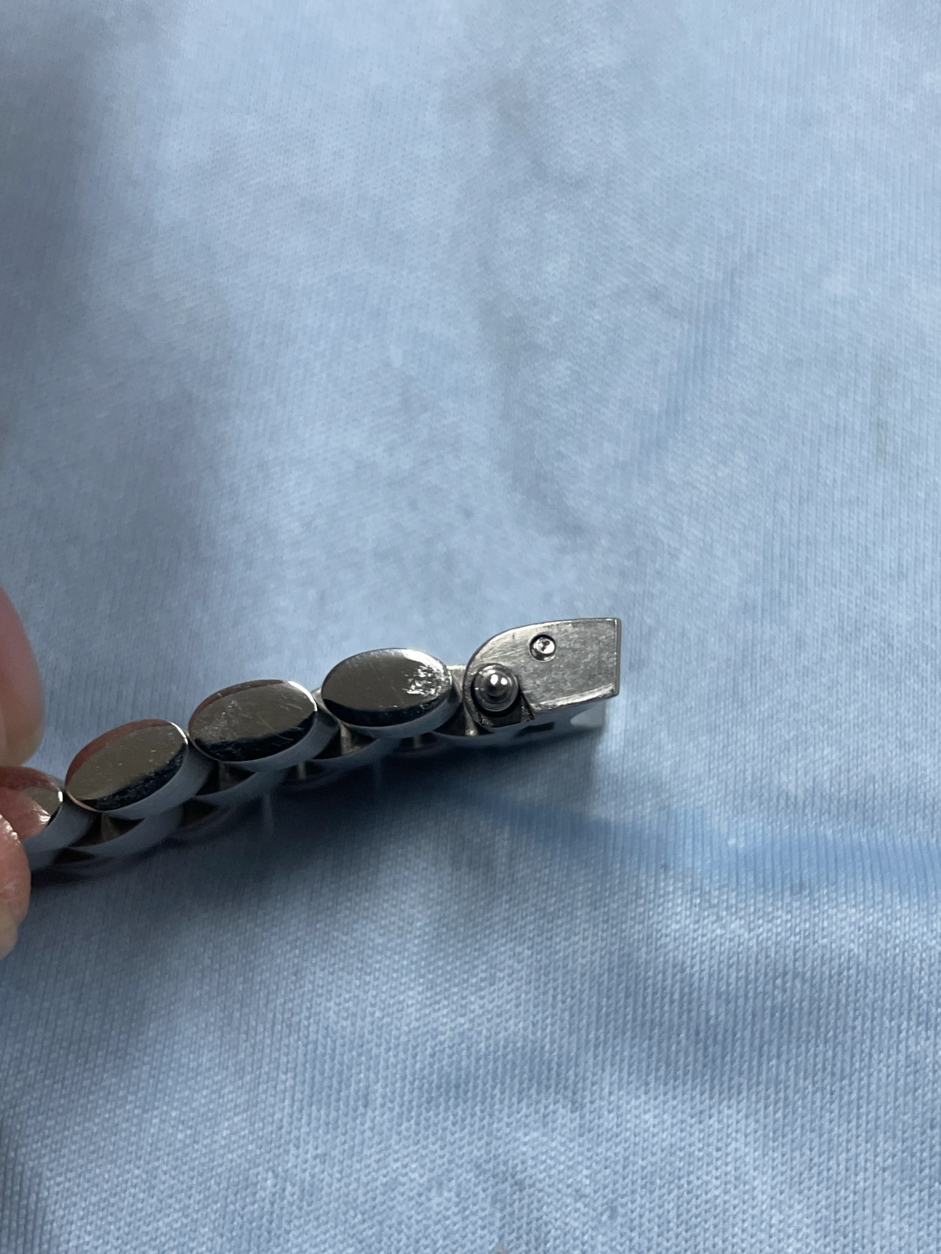

Hi ! Thanks for the help, springs bars are original, just compared them to the original I have with the fabric straps. I did post in the omega FB group and someone mentioned the end links are incorrect. Unlike yours, mine is showing play. I wonder if this is something omega will replace, possibly out of tolerances?

I assume it may be an Omega issue. I will be ordering new end links and hoping that fixes it.

Wow, that may be it as well, just measured springbars from the bracelet at 22.30mm with a digital caliper. Going to the boutique for both end links and springs bars, might as well get both.

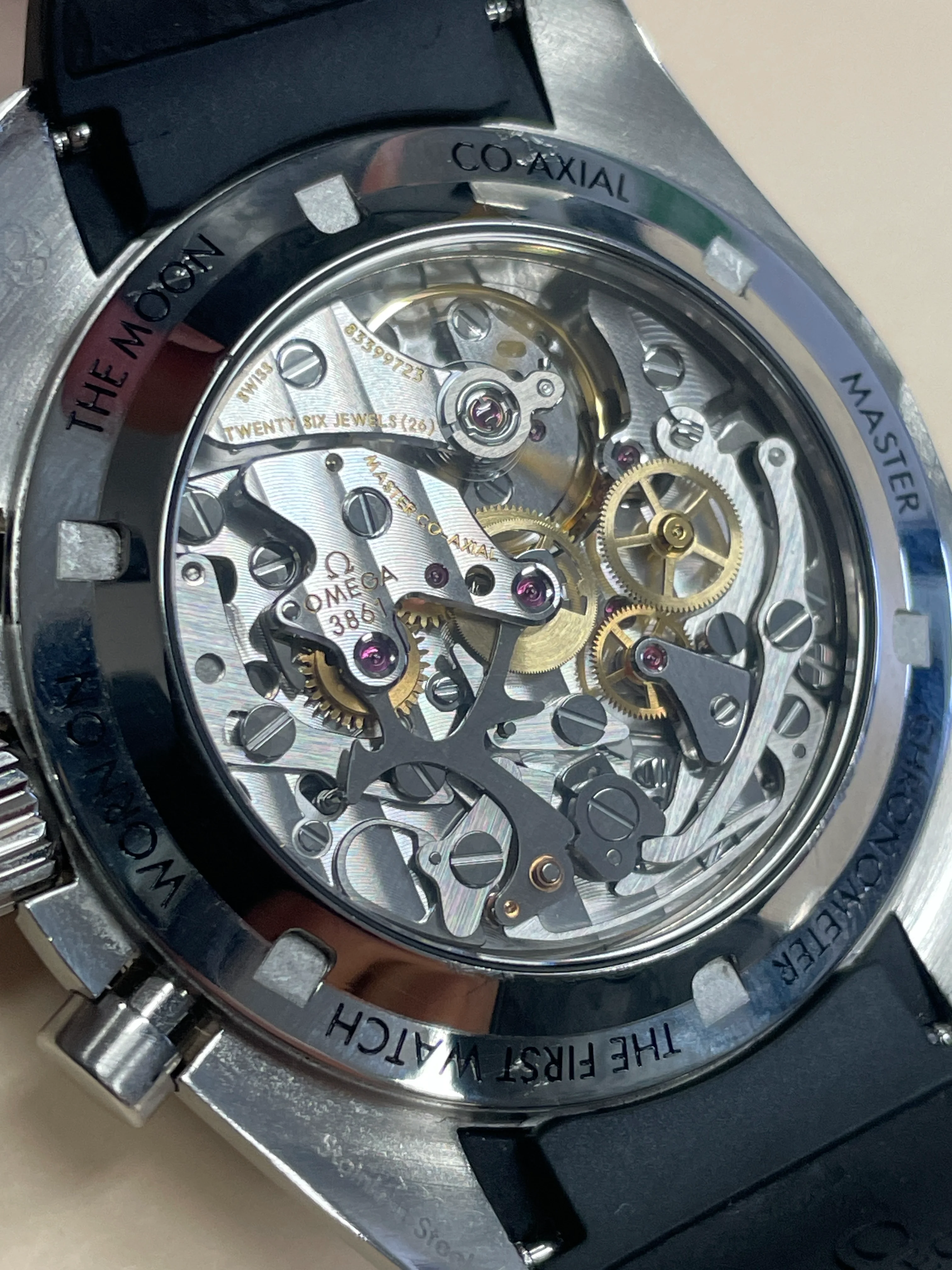

Good everything is solved. By the way the watch is a sapphire version but the bracelet is from hesalite specification, though technically they are the same except cosmetical difference.
