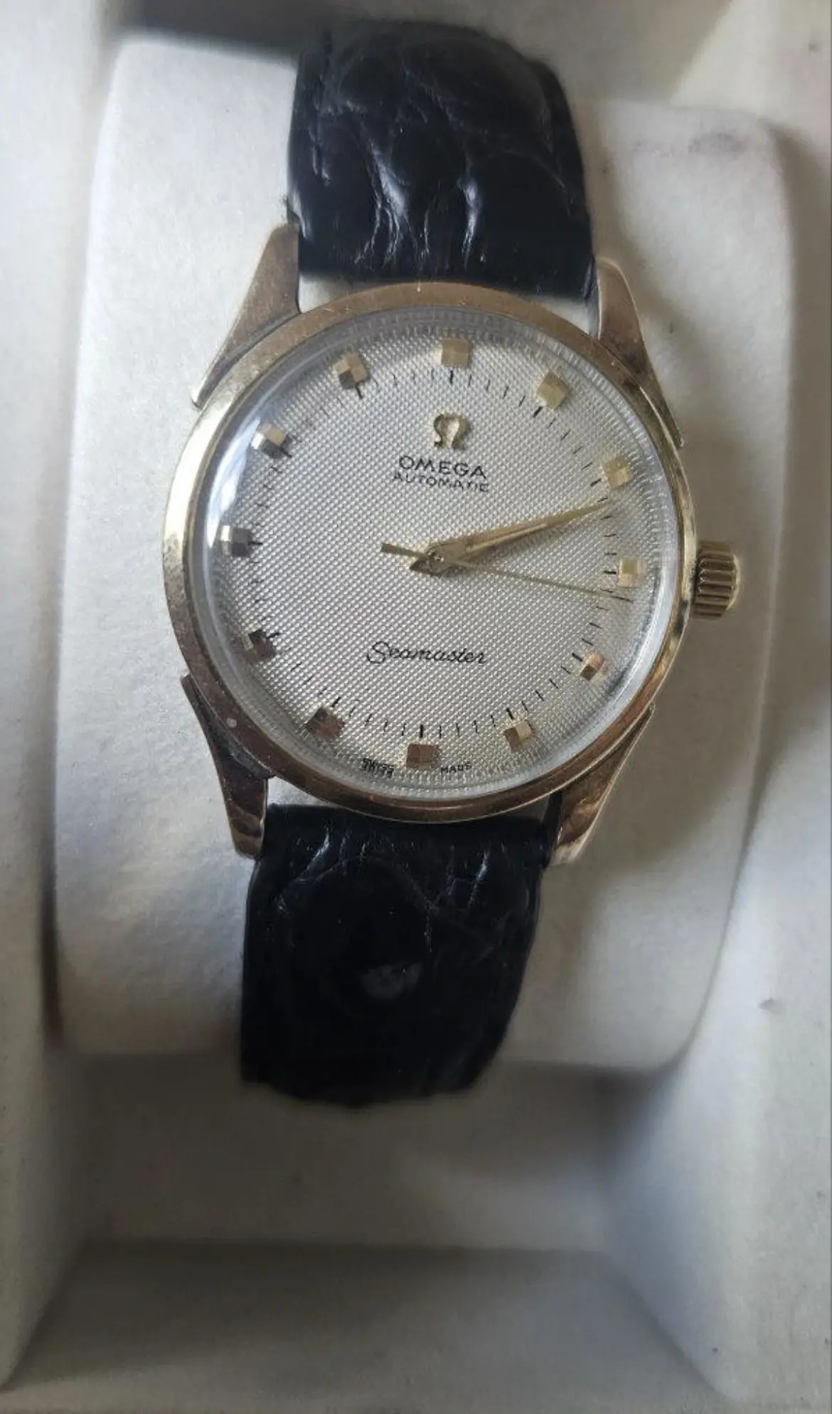

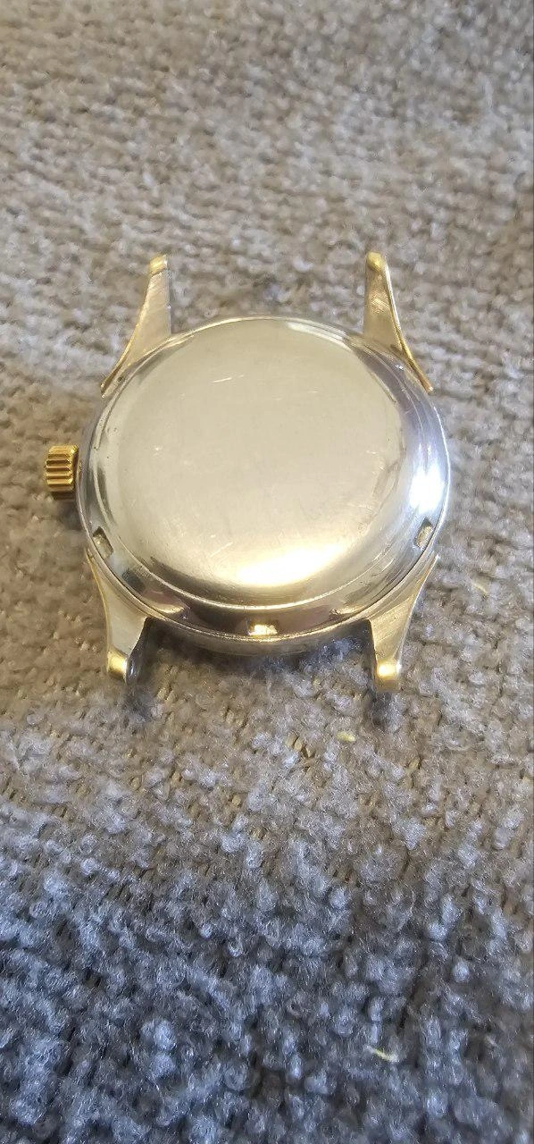

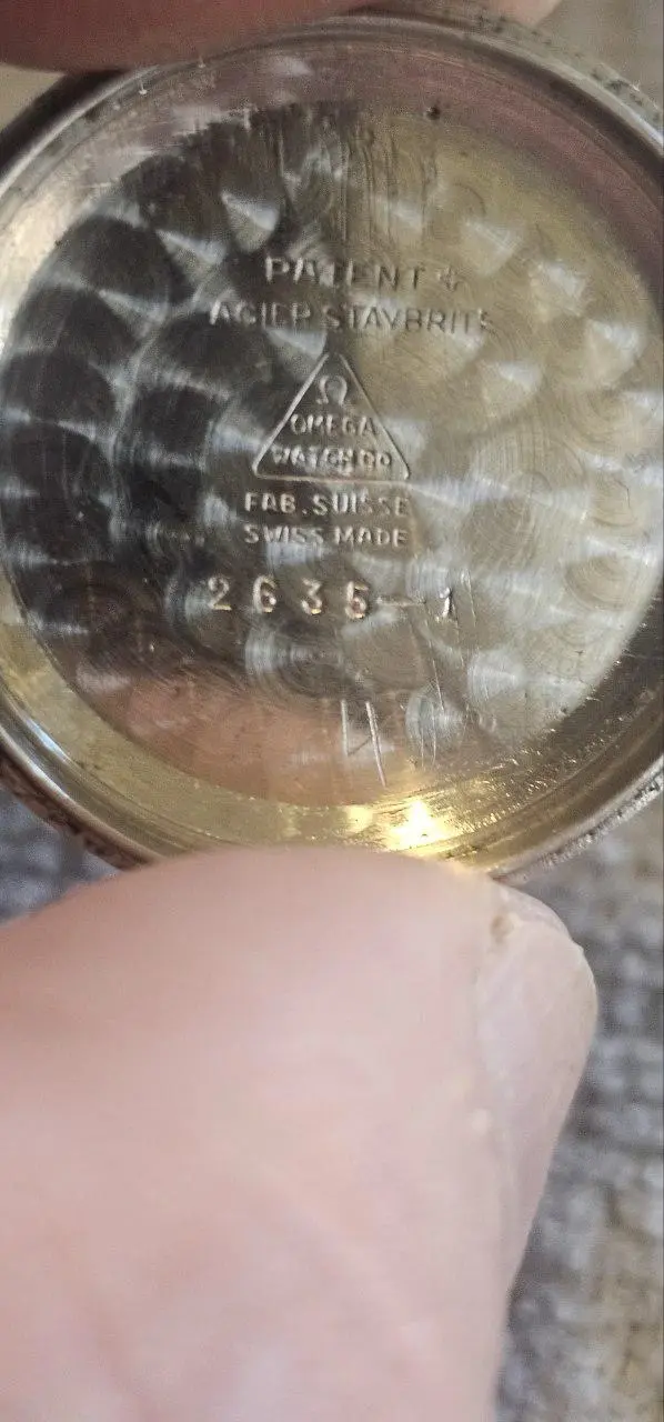

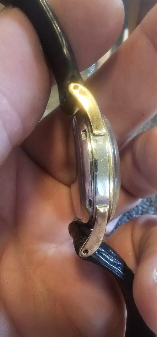

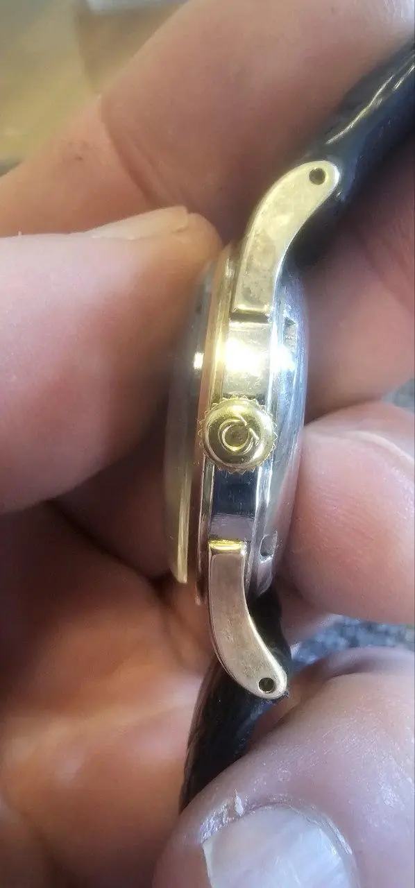

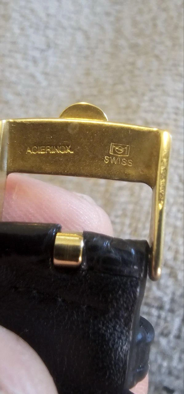

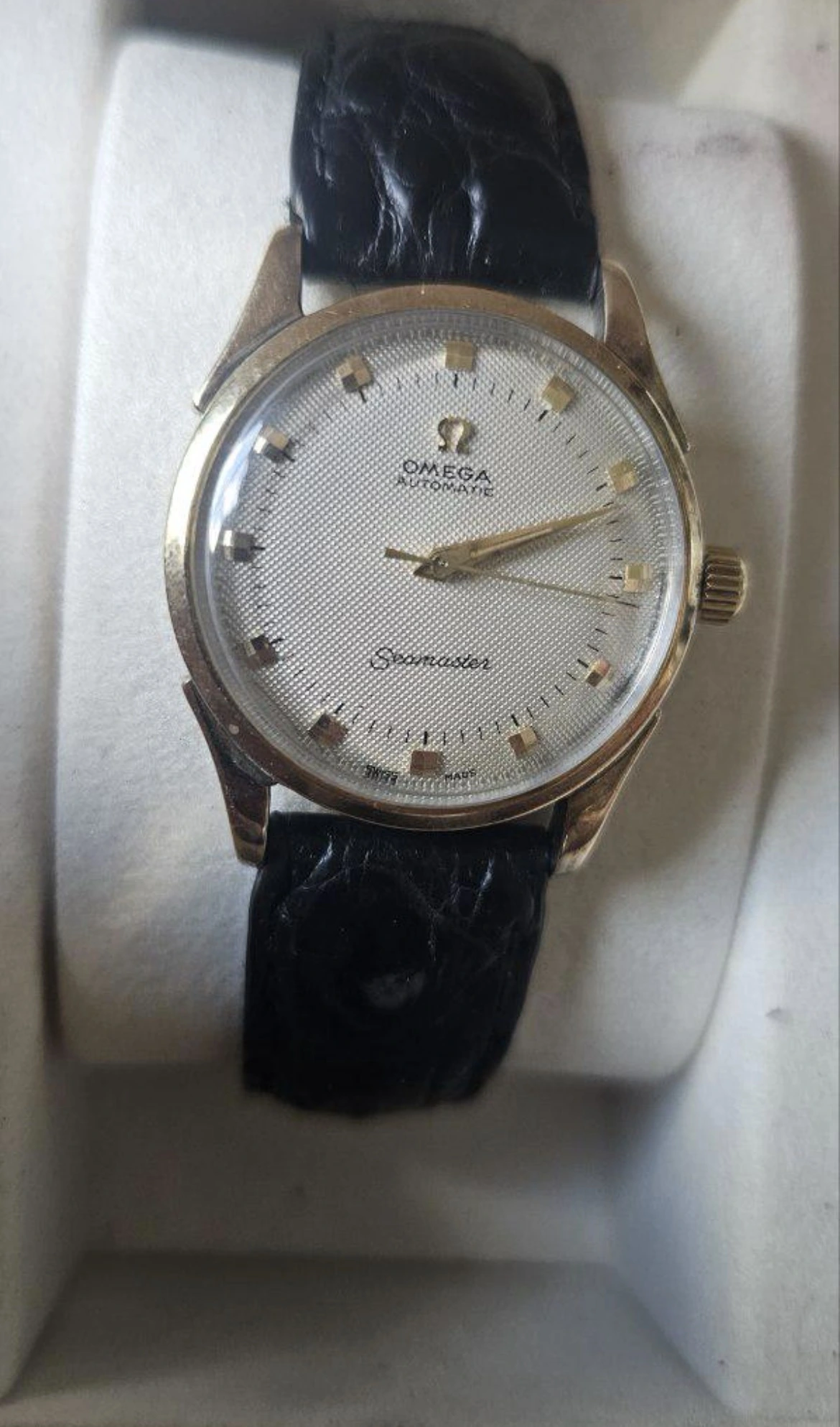

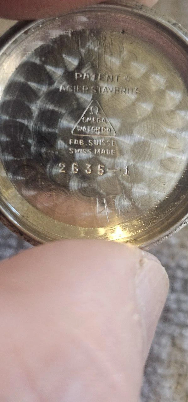

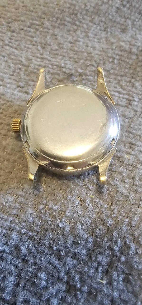

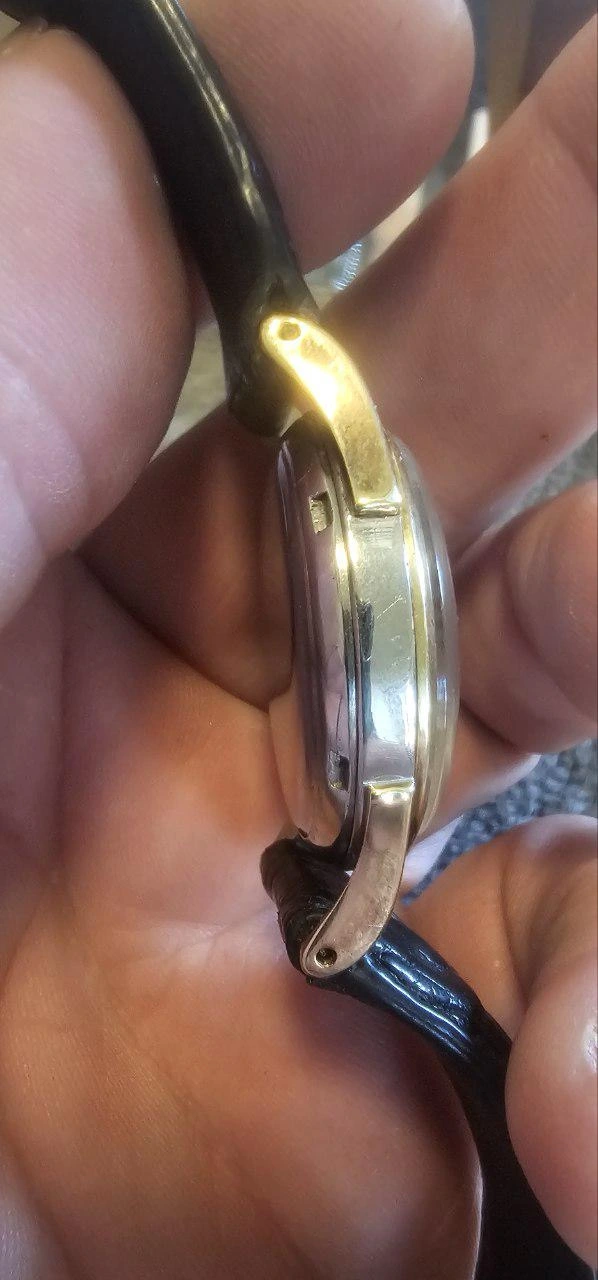

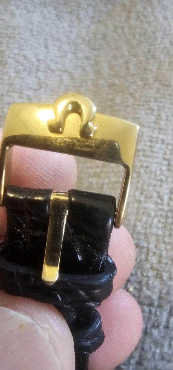

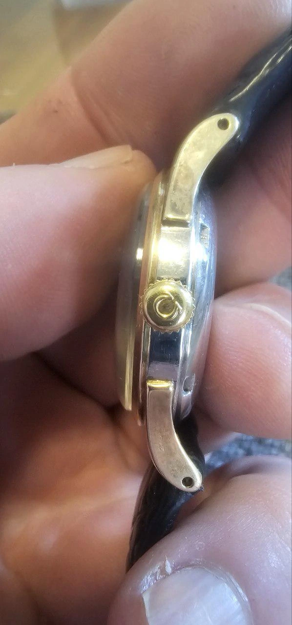

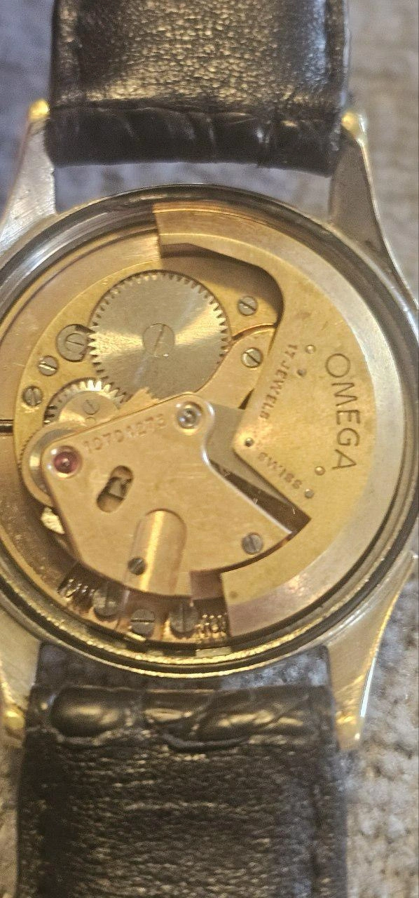

About to buy this watch does everything look right?
16
4
I found this watch from a private seller on watch exchange just want to make sure the watch looks totally 100%.
Just need a second opinion please.
16
4

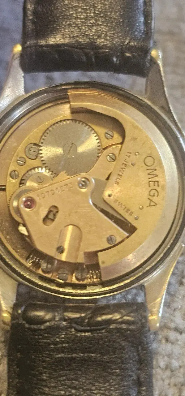

For some reason this watch just doesn’t feel right to me. Maybe i don’t know anything
3,021
6,440

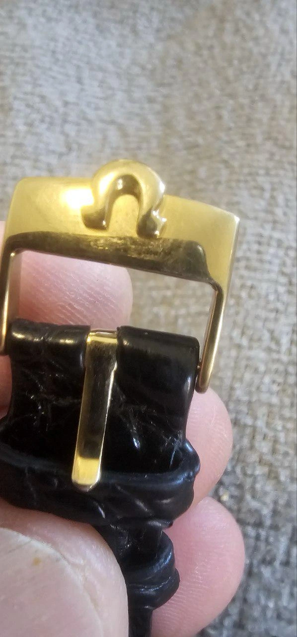

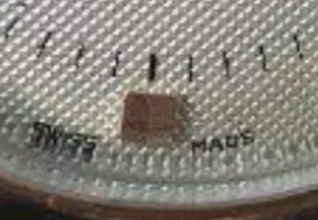

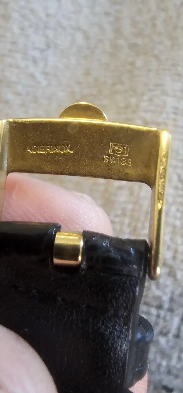

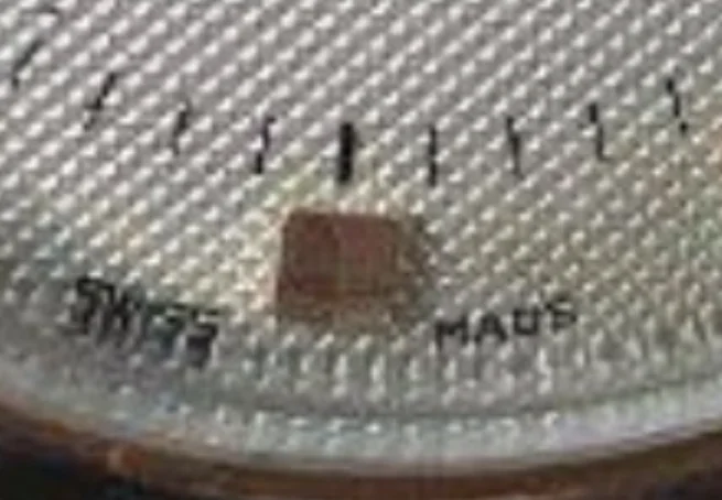

Dial repainted
Crown replaced
And fake buckle as well.
16
4

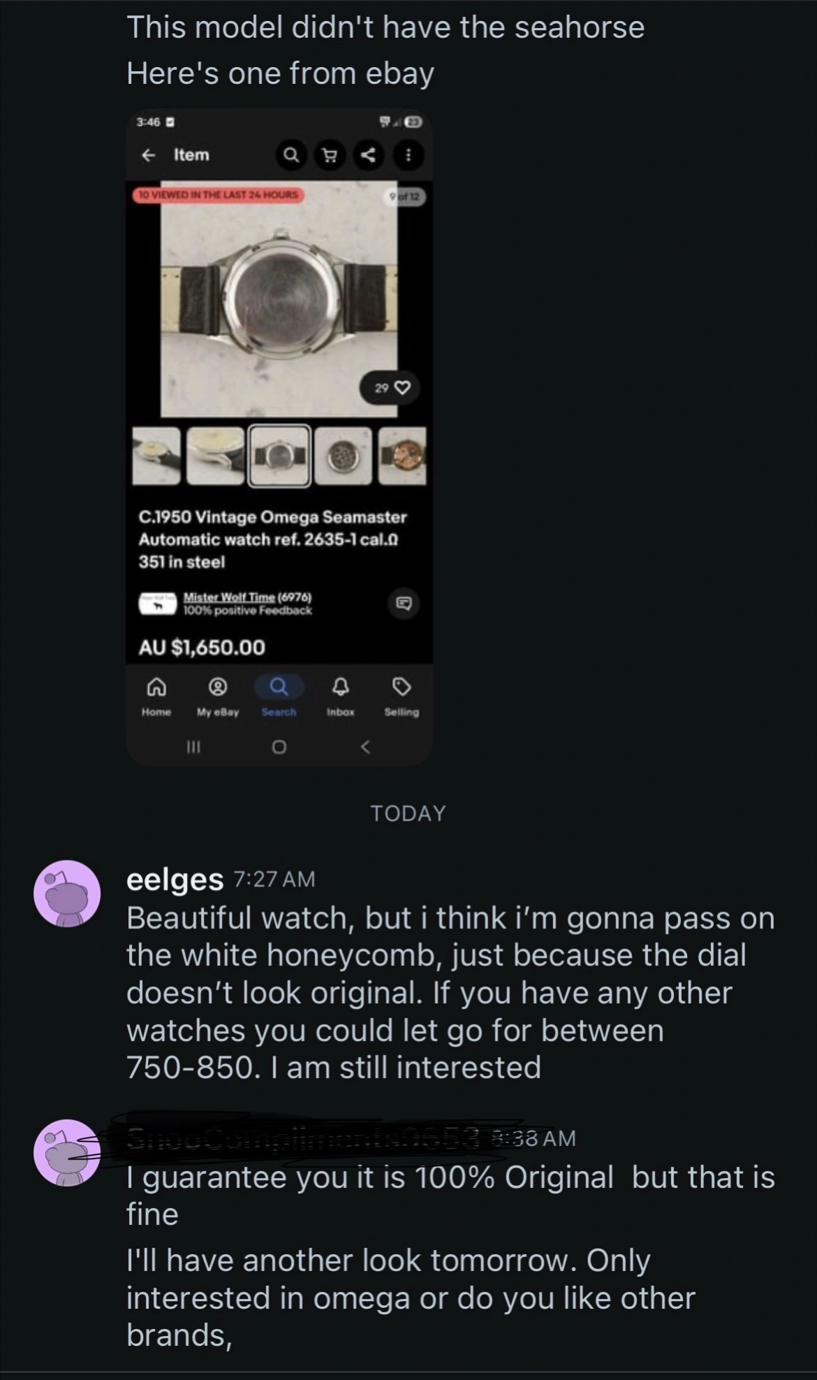

I’m not sure if they know and are just trying to scam, or maybe they are convinced it’s original. I just can’t find a white honeycomb dial that has square gold hour markers. This is from a redditor’s private collection that I met through r/watchexchange. Do you think it’s even worth looking at some more watches they have? or they are all probably messed with? I’m just trying to find a decent 50’s-60’s sea master, no date, and preferably in steel not gold. If anyone has any other places/sellers/locations to look please let me know.
