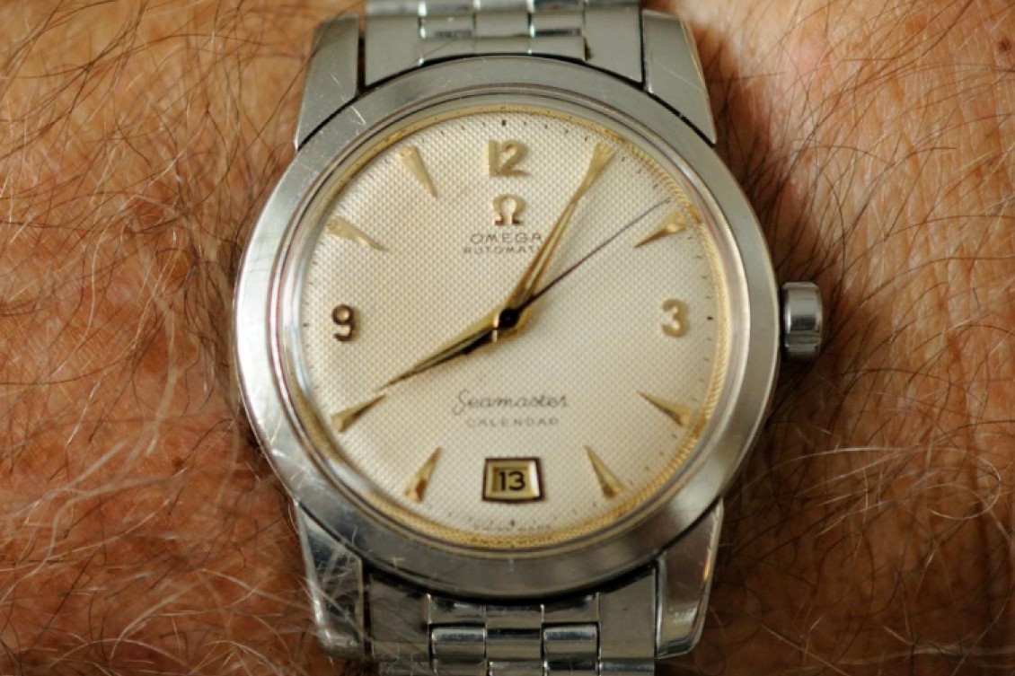

Well, I just got the watch back and I am impressed. I have no idea what Tanner did but it is, in the hand, like WOW! better. It had a nice warm patina, mind you, but it was uneven; smudgy and dull on the 7 to 11 side. There was some existing abrasion that is still there but now far less noticeable. I think she looks great!
Here's a before shot:
Note the smudgy stuff in that 7 to 11 or 12 quadrant. The darker mark between 11 and 12 is abrasion.

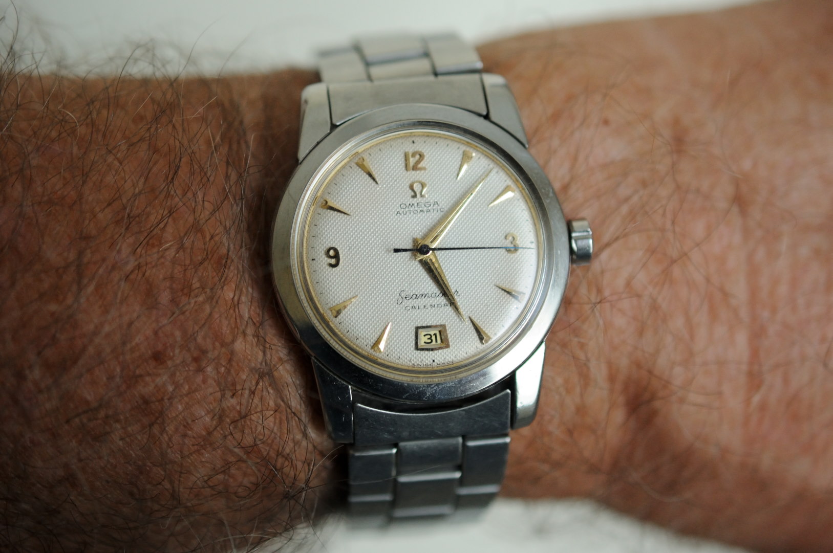

And the after shot:
She looks great after the facial, IMO.

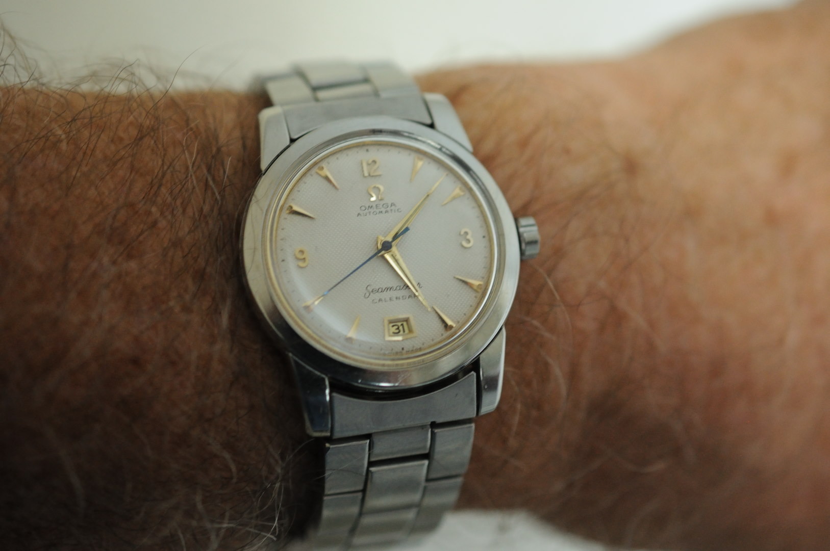

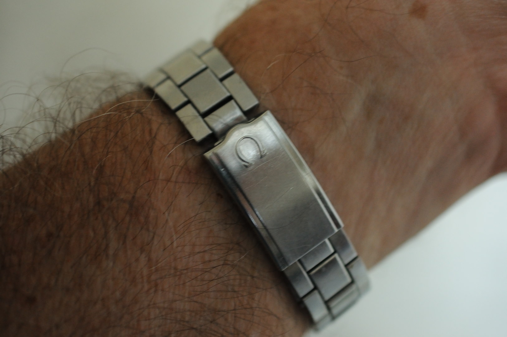

Some wristies; this is a Duchess bracelet, BTW:

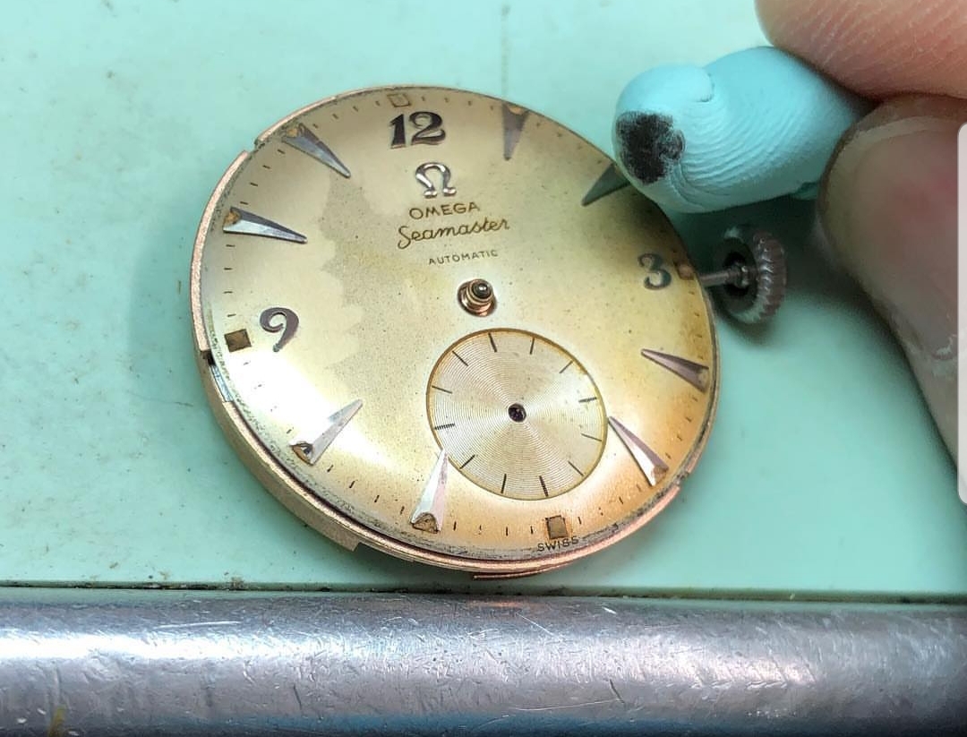

Hey guys,
First of all, I appreciate the shout-out Paul! Thank you! Second, to expand on what Archer is saying:
The only thing i will ever use on a dial to do light cleaning and its mostly just to get the dust off is Rodico Premium from Bergeon. I would never rinse a dial in anything as in most cases it will take the extremely fragile lume off of the dial. Even when i lightly go over the dial with Rodico, i avoid even touching the lume plots. In almost all cases when you try to clean up a dial with anything other than Rodico, it makes it worse. Extreme care needs to be taken even when you are just getting the dust off of a dial because even Rodico can peel up paint that is slightly loose. The only reason i do it is to take dust off which will get into the movement eventually if not addressed.
I hope that makes sense to everyone. In most cases, leave the dial be and NEVER submerge in any sort of liquid.

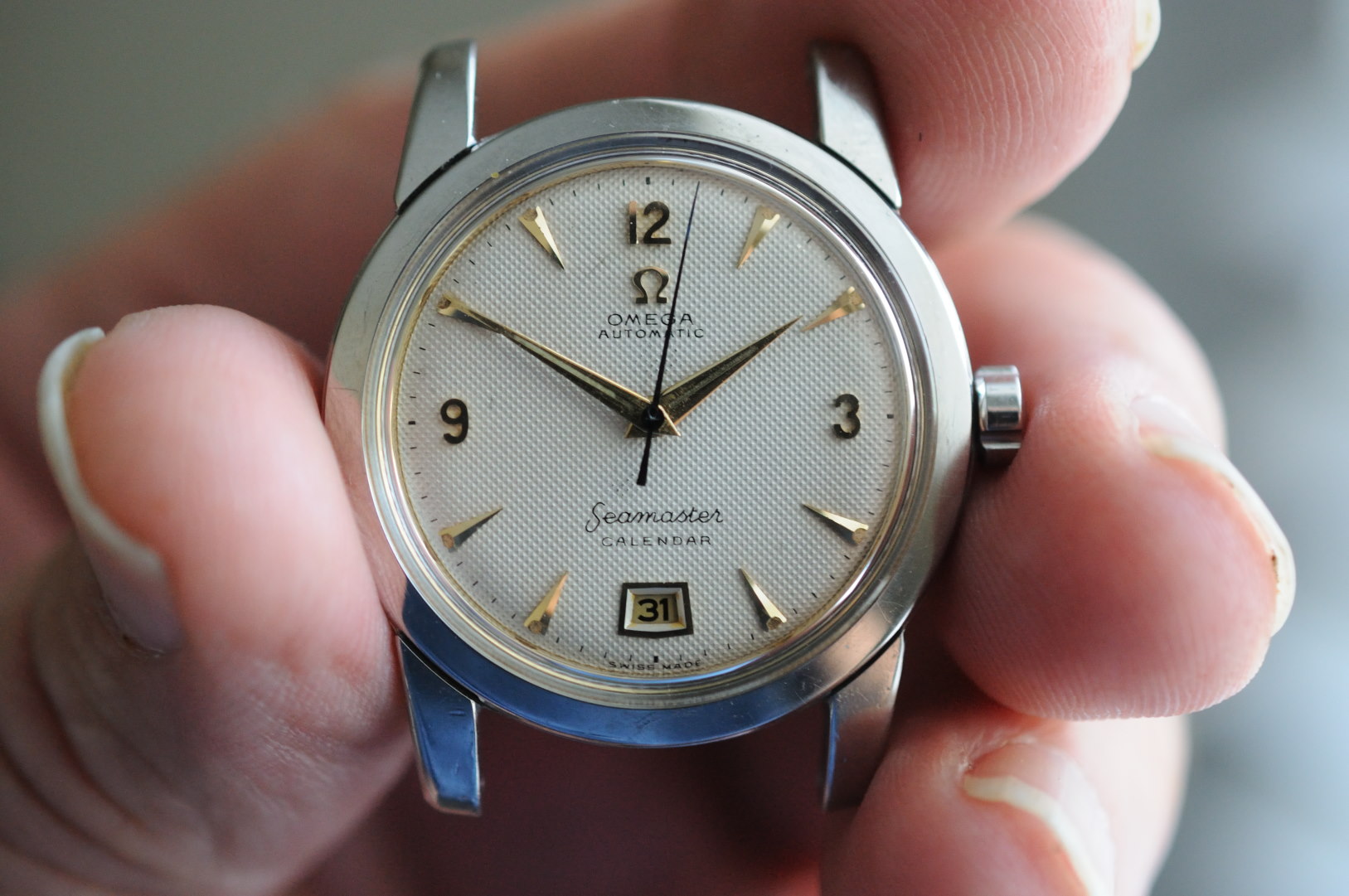

The end result looks quite nice, thanks for sharing. I had a similar experience with my watchmaker. Before service it looked like this:
After service:
