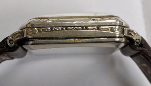

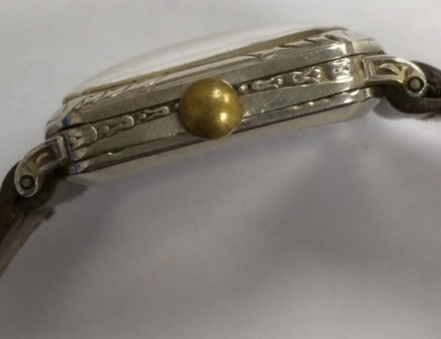

For my education (and hopefully others), I would value your thoughts on this assessment. I have passed on other watches with similar issues, and hope that I am on the right track. For this watch that is at auction, I believe that the gap in the non-crown side (perhaps caused by overzealous opening attempts) is too much of an issue to warrant purchasing it for occasional wearing. My understanding is that such a gap will readily allow dust and moisture into the case. Or, are magical baskets available to overcome such issues? No opportunity here to see it in person.

While it may appear that the case back can be fitted in any direction on these, there is a correct way and I suspect the gap shown is simply because it hasn't been fitted the correct way around.

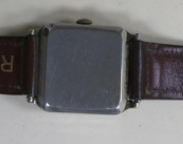

1. I agree that the caseback on these should fit tightly. They were never meant to be waterproof or even “moisture proof”. Ask the seller to rotate the caseback 90 degrees and try again.

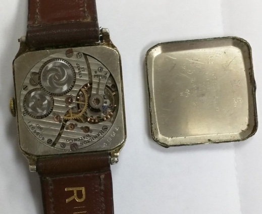

2. You will note that there is a 4-digit number engraved on a corner near the movement. On most Hamilton’s of this era, this should match the last 4-digits of the case serial number. If it does not, you could be looking at a frankenwatch.
3. Go to https://pocketwatchdatabase.com/ to get an approximate production date for the movement. Once you have the year, you can find the original catalog for that year here https://vintagewatchforums.com/viewforum.php?f=21&sid=cc6b5d7cbe4826c2112071f287d922dd

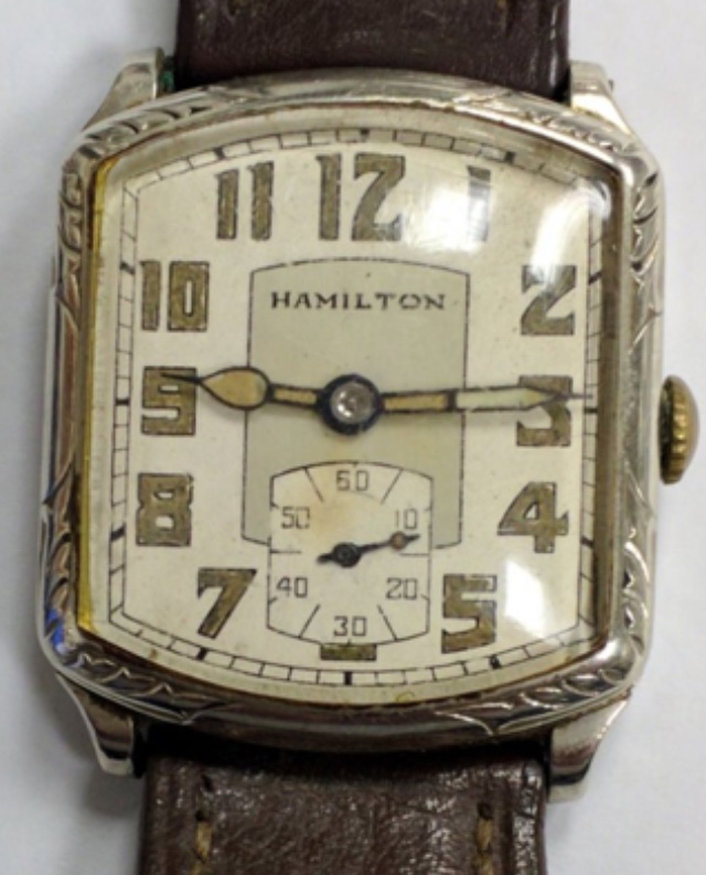

4. I think there is a good chance that you have an original dial with that Tonneau model. If not, dials can be redone on these using original processes (except for radium, for reasons that should be obvious), so having a redialled watch is not frowned upon as much as with say Omega.
5. It looks like the balance jewel is missing on this watch. I don’t think that’s a huge deal either as any watchmaker who knows the Grade 987 movement should be able to find a new one during a service. However, if the seller is asking more than $100 for this watch, given the obvious issues, then maybe you should look elsewhere.

XJR, the case back could indeed be on backwards. That could explain why the edges of the gap do not look mangled, just separated.

Cases such as the one on the subject watch are easily sprung. Partcularly if there is a tight fitting expansion bracelet on the watch, or if the strap is worn tight! The pull on the case at the 6 and the 12 tend to cause the bezel to open up, thereby the bezel no longer holds the case back in place. You mention baskets that will solve the problem. I”’m sure you meant gaskets. And, no, there is no magic bullet to solve a problem like this.

Thx Canuck. Where was auto correct when I needed it?! A basket might be a good idea though, keeping the watch safe and all that 😉 Thanks also for the info about the cases being somewhat easily sprung, that is certainly good to know. I love the look of these older pieces, and aim to have on some day.
I have about a dozen Hamilton’s from this era and have never experienced this problem.
Cases are generally 3 pieces. The bezel and casebacks are separate from the center. If either the bezel or caseback is pried open too many times, they can get loose as the friction fit pieces wear down.
There are a few models that are two piece cases from the mid-1930’s and later.

Take my word for it! After many decades of servicing watches of all types, many vintage and antique, it happens! Not often, but it happens.
