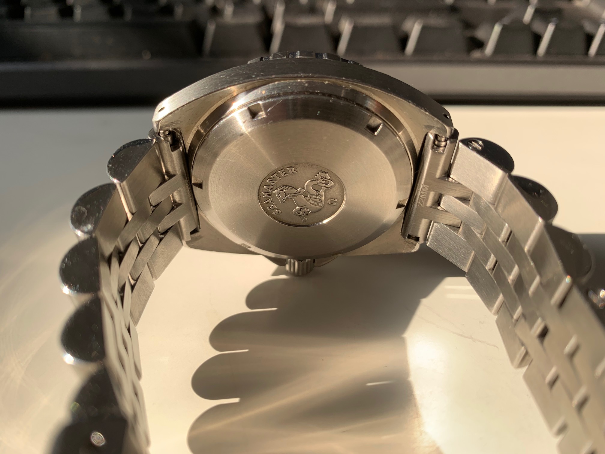

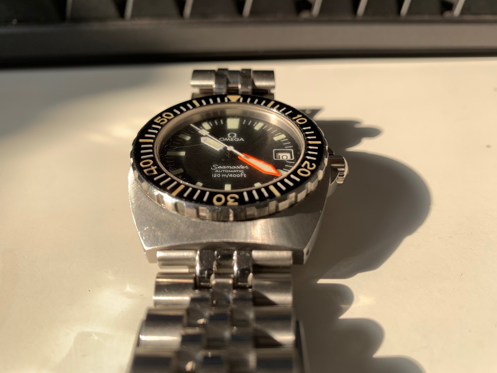

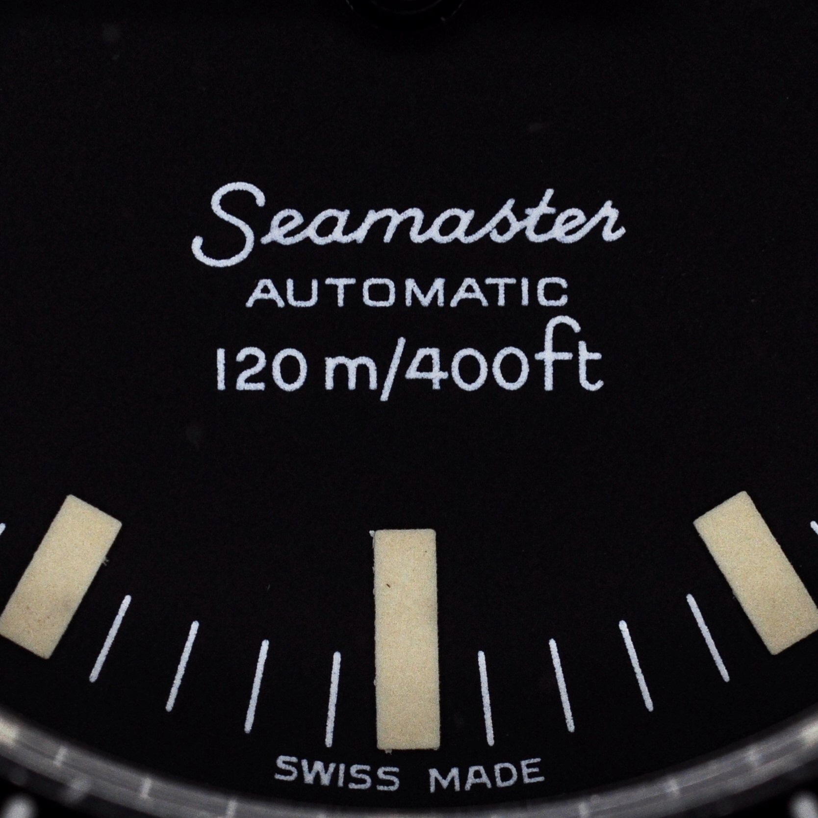

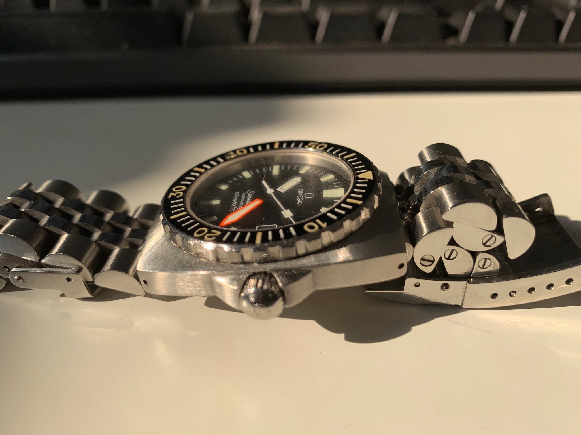

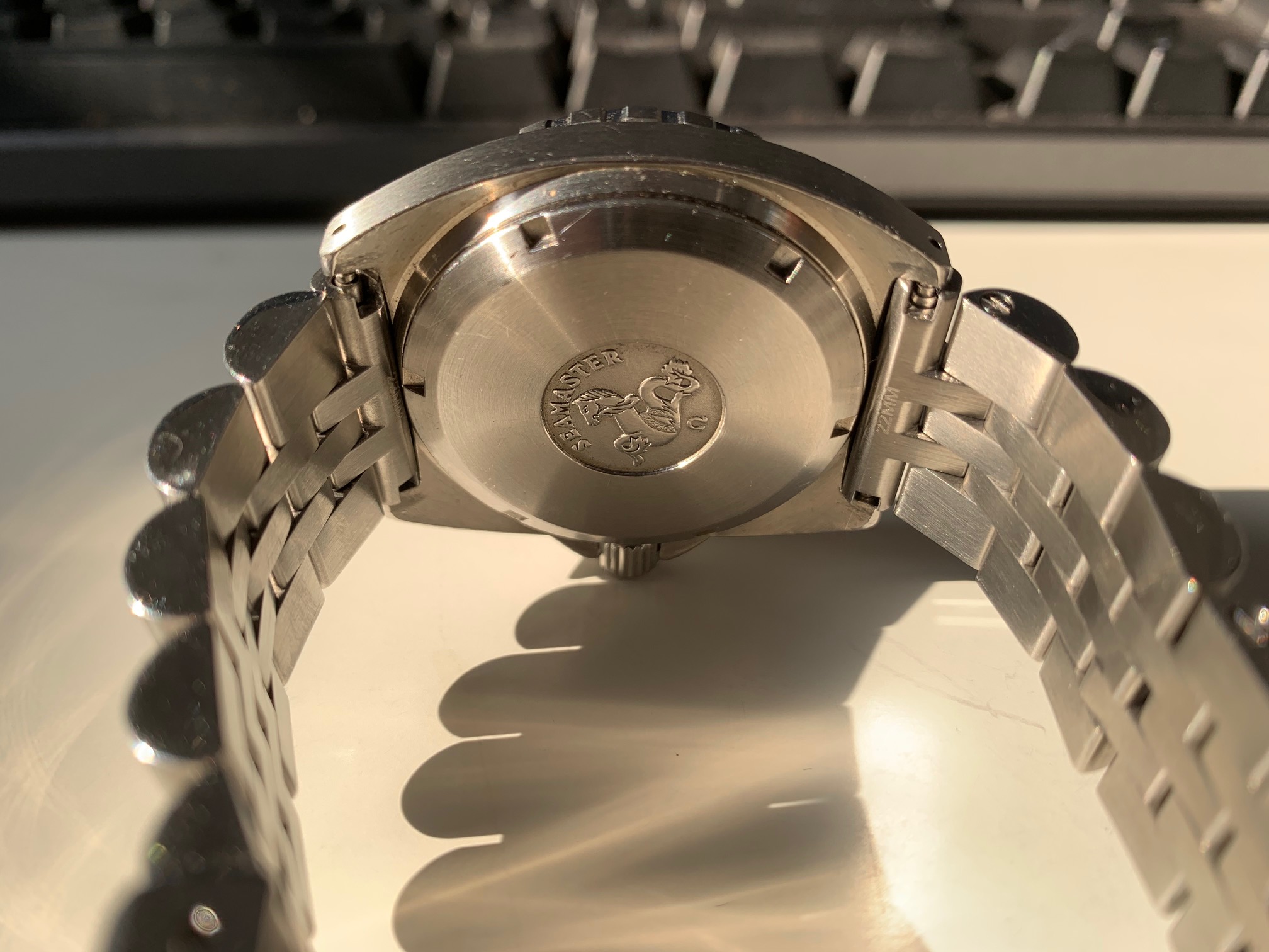

Thanks so much for these thoughtful replies. From the discussion, I can ascertain the following...
1. It is possible for Omega Baby PloProf 166.0250 to have 1973 production year and caliber 1012 movement.
2. I have a service dial, as the top indice is solid.
3. It's underdetermined that I have a Watchco Frankenstein. This may be an original Omega, with the service dial.

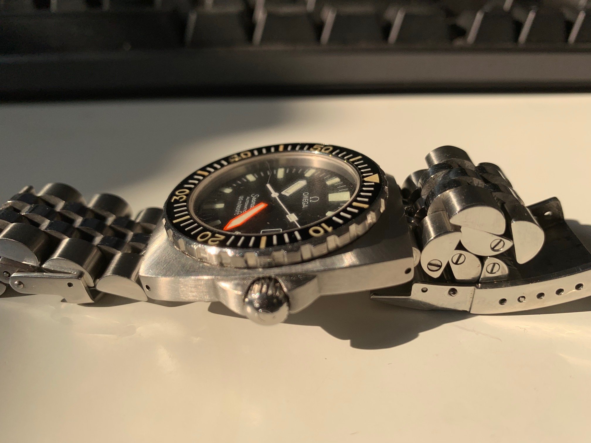

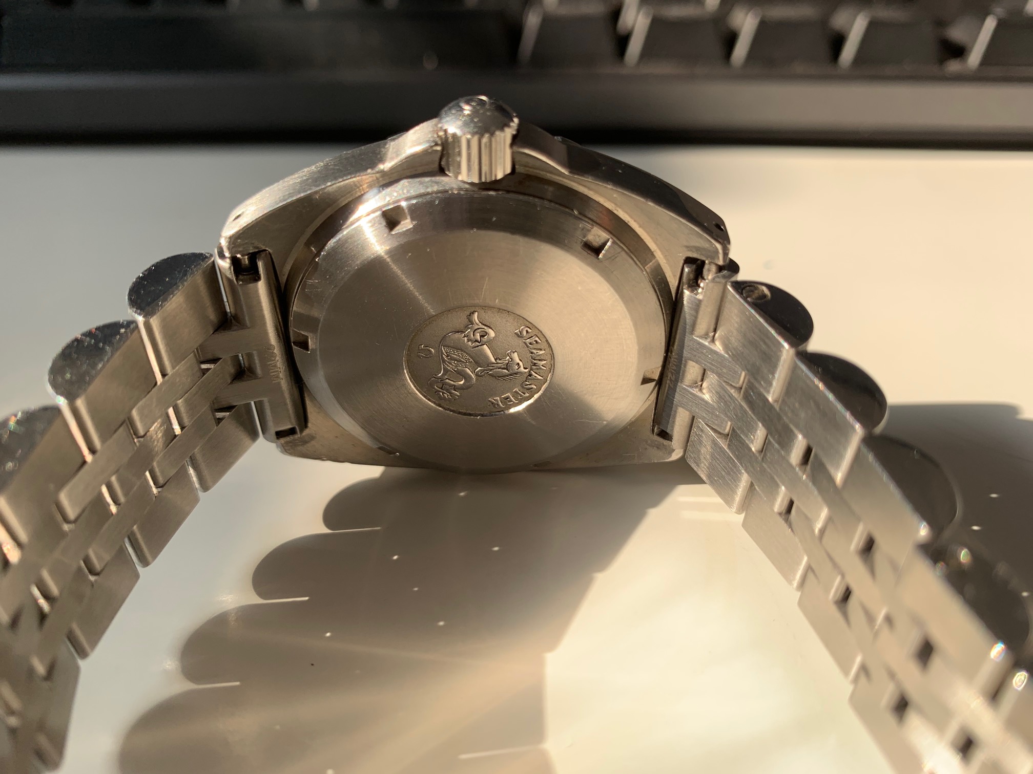

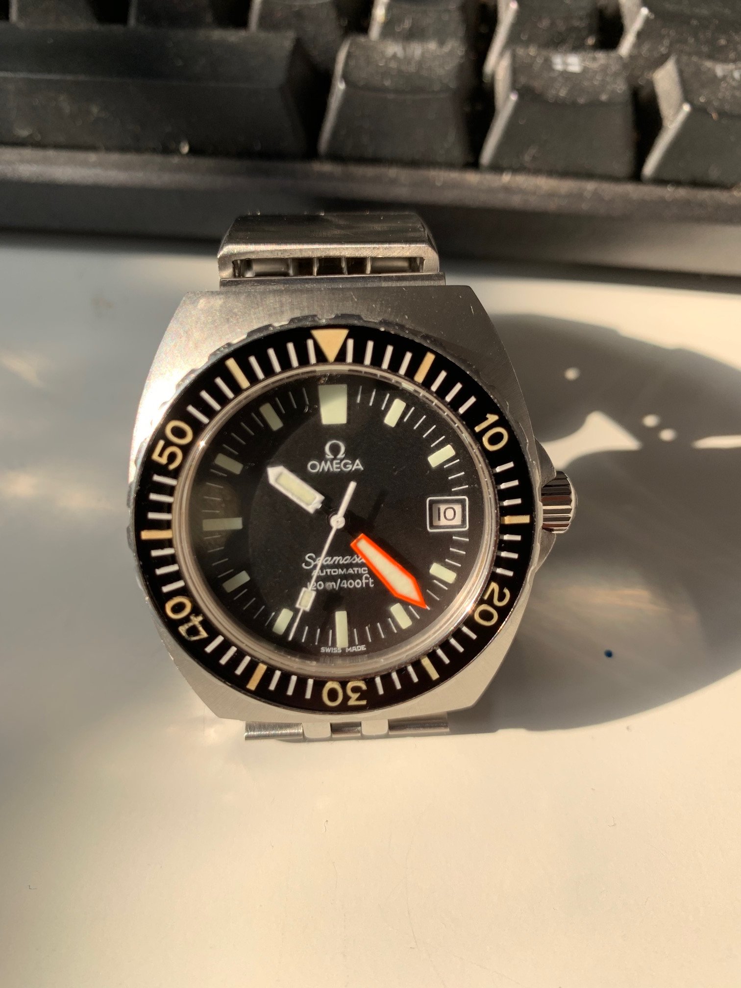

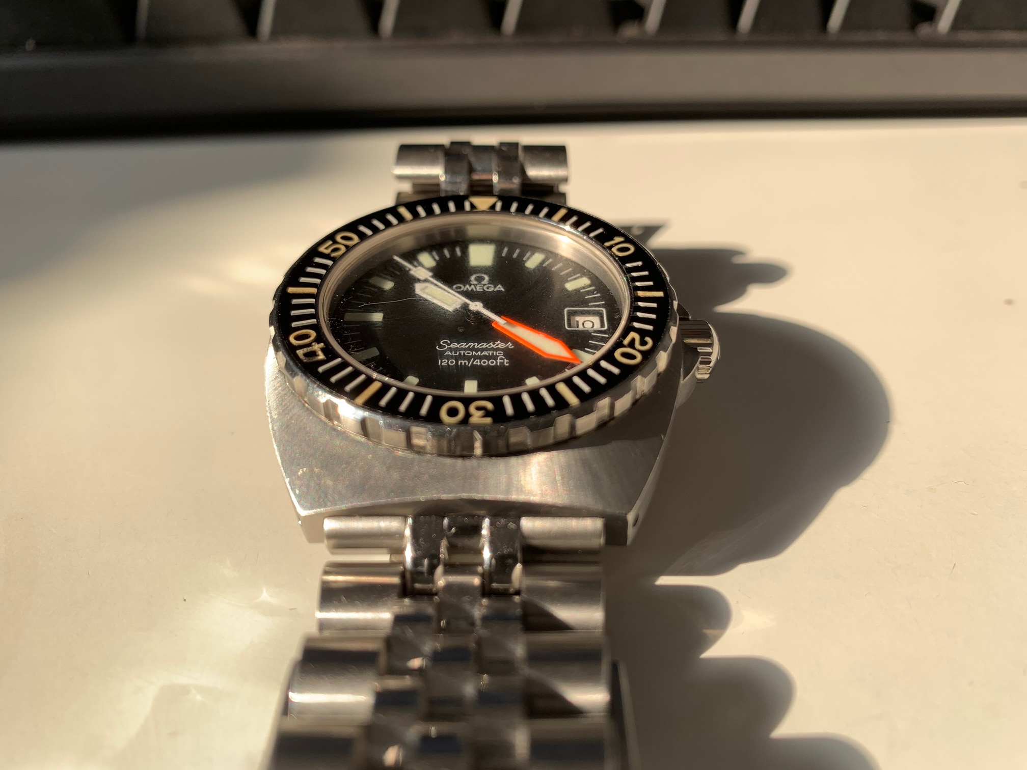

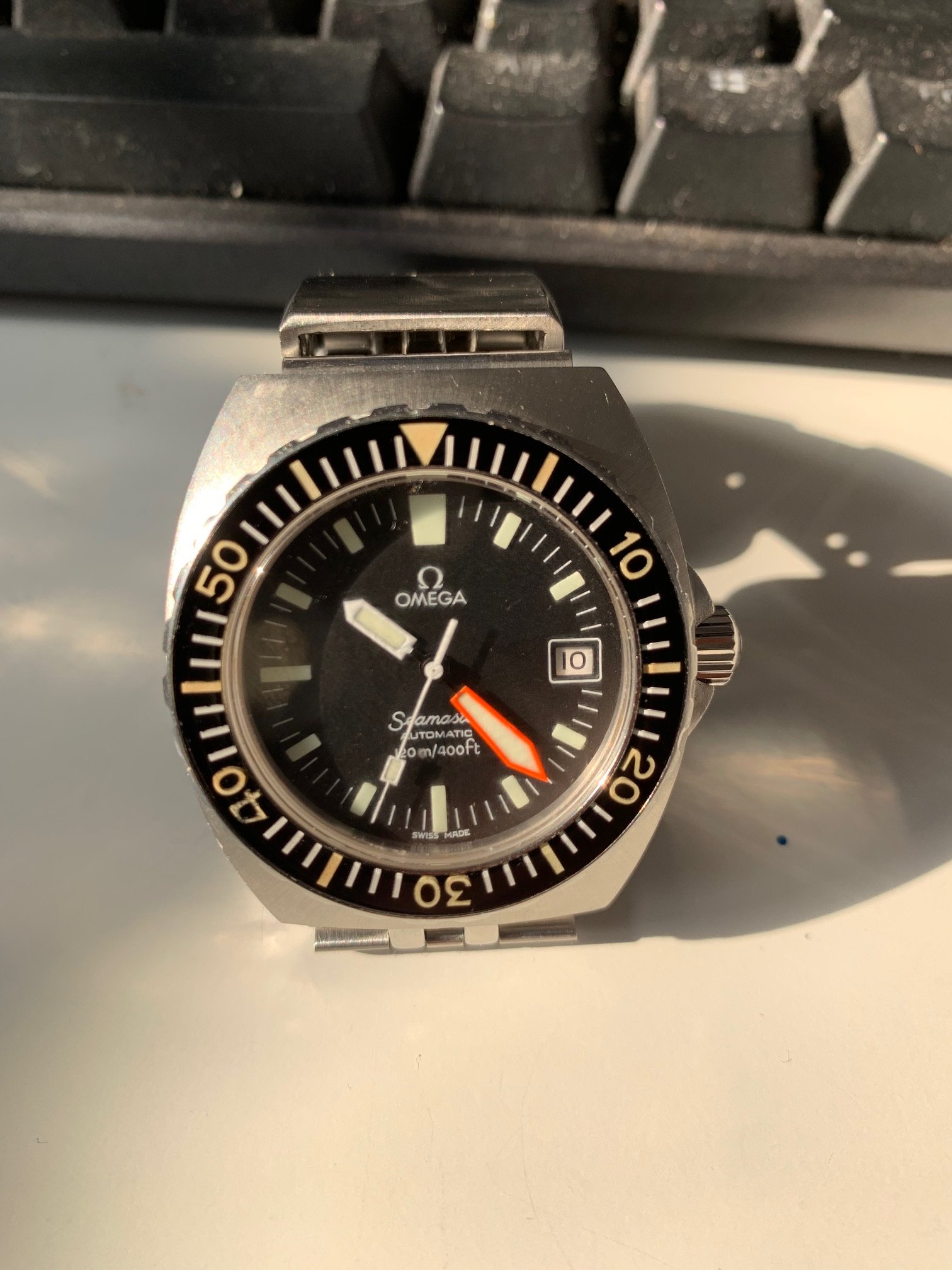

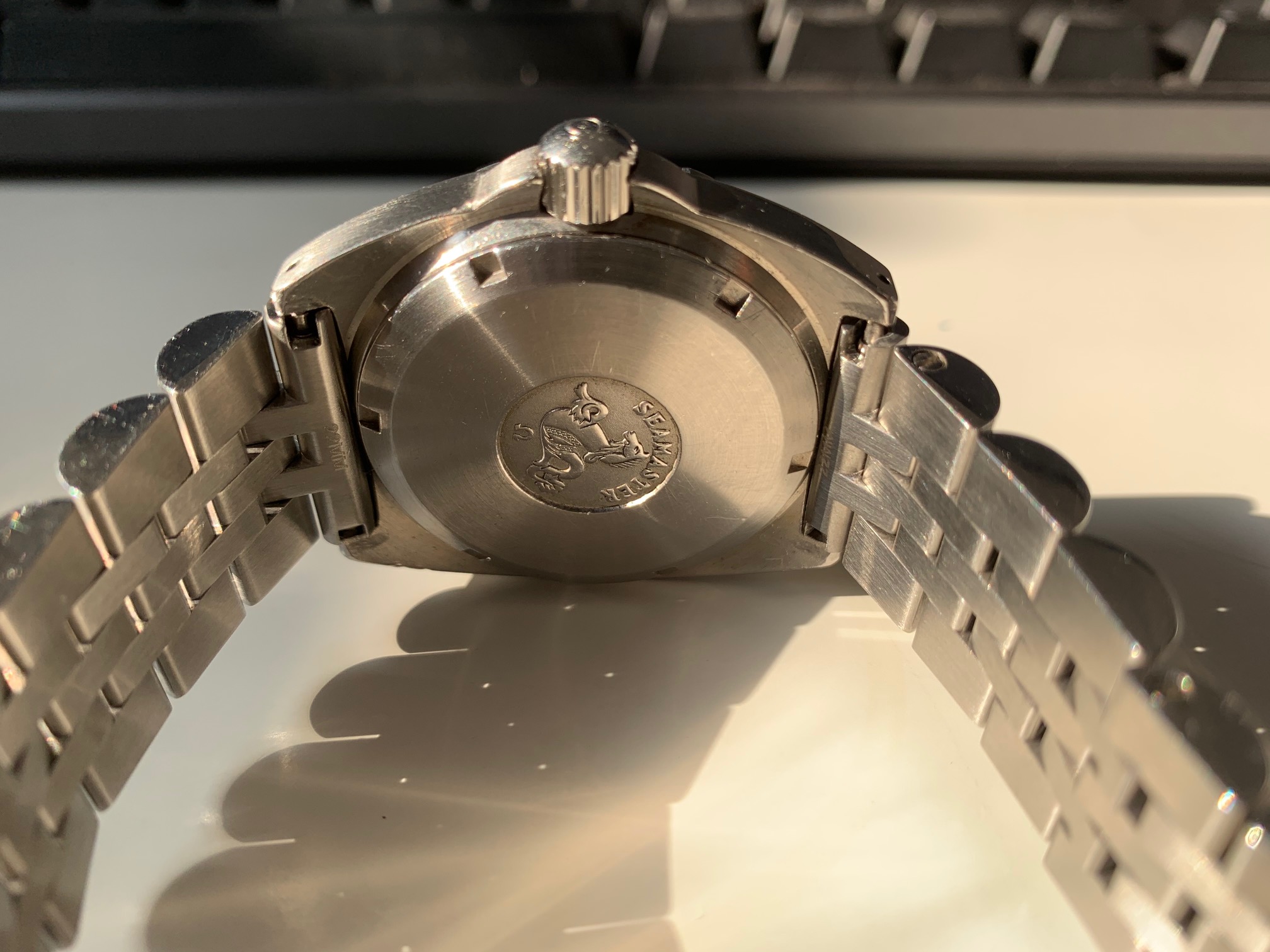

Let me know if I'm off on any of the above. Also here are a few more photos of the case and dial as some have asked.
When I look for Chrono24 and other listings, none of the Omega Baby PloProf are listed as Watchco's. What would a typical market value be for a Watchco version, if an original Omega is about US$4K to $6K today?
Why does it seem like there is a clear plastic layer over the markings on the bezel? I cannot see it visually with a loupe, only by touch and feel that it's smooth. The markings on the bezel do not seem exposed to the environment, yet they have patina'd over time. Is this normal?
Also, what's "OJTT" in these forums?
3,997
9,030
1. It is possible for Omega Baby PloProf 116.0250 to have 1973 production year and caliber 1012 movement.
You do not have a Watchco, assuming the case and bezel are ‘original.’
I’d defer to @simonsays regarding the bezel being original and so the case necessarily being original as well; as for the movement, it seems like the caliber and year-by-serial are consistent . If desired, the way to beat confirm that the movement was for a baby P, when and where it was delivered, etc., would be to get an extract of archives from Omega to shed further light on the movement/case/bezel origins. That’s not necessary, but could be a nice thing to have (including if you ever go to sell).
Meanwhile I stuck by the both the dial and handsets being service replacements (and I’m personally still suspicious of the date wheel being a service replacement as well).
As @simonsays mentioned, the scenario of having the dial/handsets replaced is consistent with, for example, a water damage event under the crystal having been repaired.

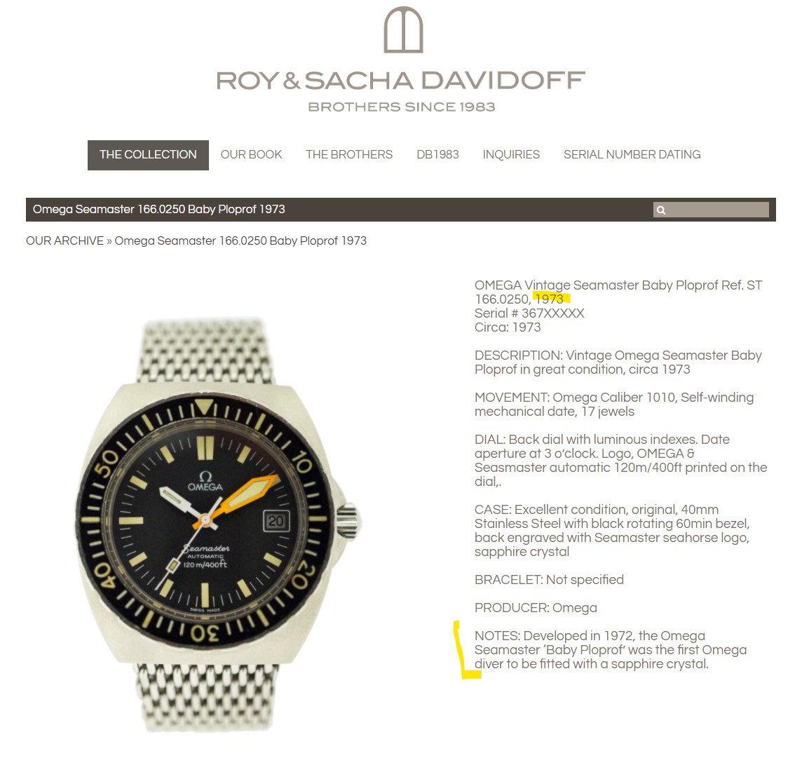

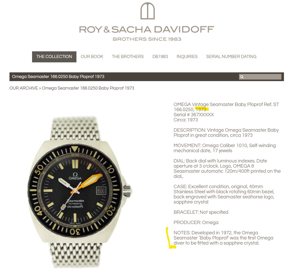

Are we sure the release date was 1978? I'm finding some indication on the internet that the Baby PloPro was released in 1972/1973, such as here: http://www.db1983.com/our-archive/omega-seamaster-1660250-baby-ploprof-1973
Omega serial number sequencing indicates my Movement 1012 of 37,xxx,xxx is dated 1973. https://www.bobswatches.com/omega/serial-numbers

Serial numbers are not all in date order. Different calibers have serial numbers assigned, and in different date ranges, out of sequence to other calibers.
Although Davidoff are experienced dealers, I would trust AJTT over sales patter
That their watch has a serial number in line with yours makes me think your watch is worth an EOA request, and is more than likely correct

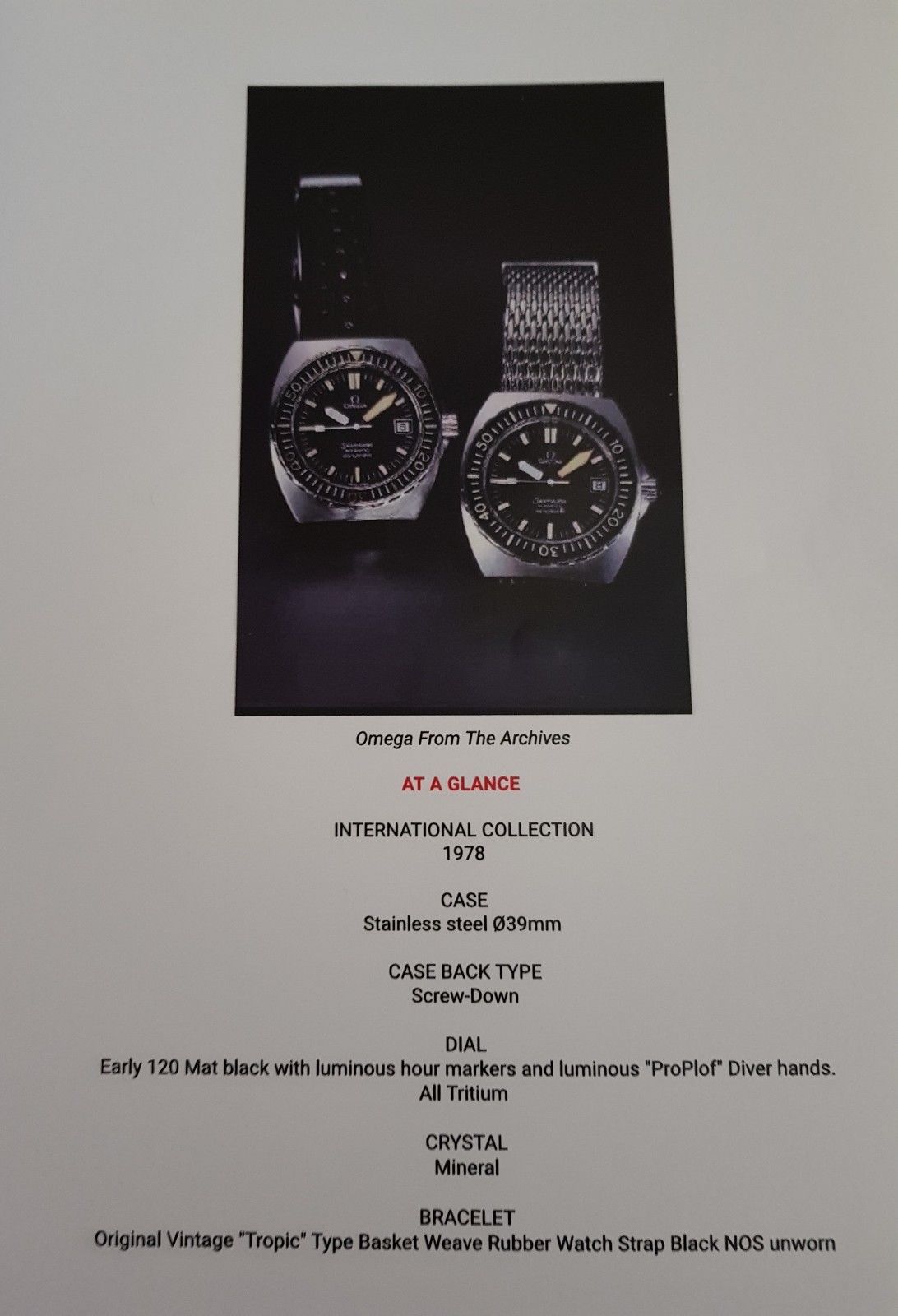

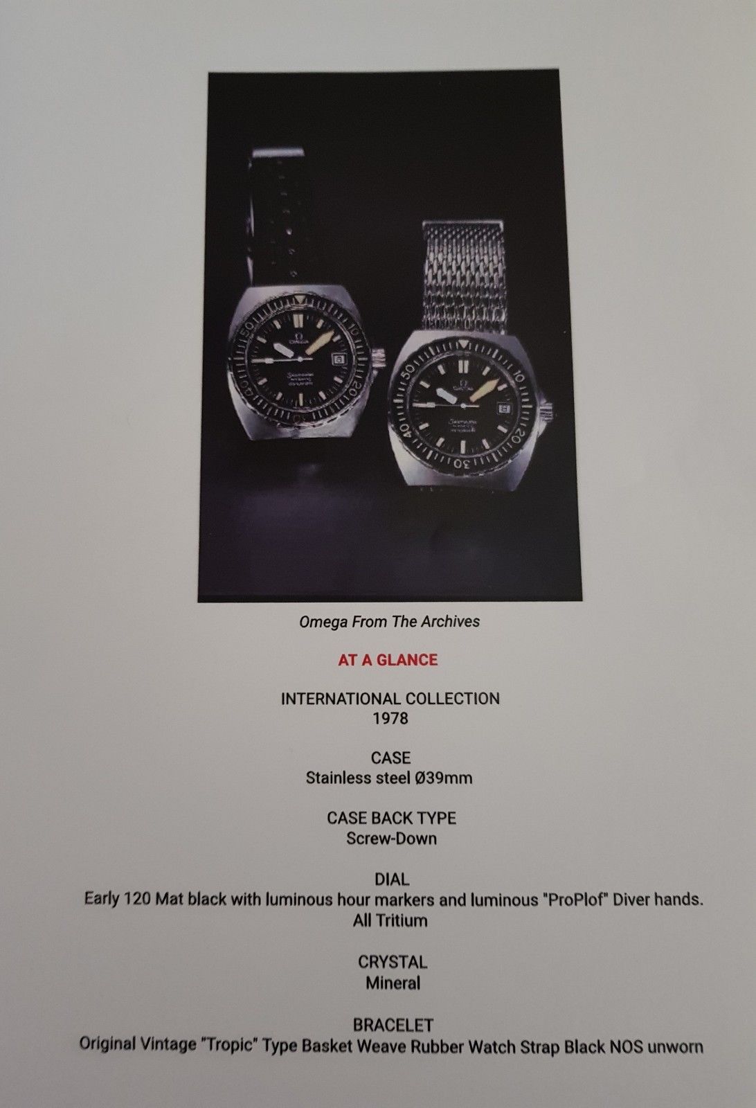

Hi Guys, I too own one of these beauties, this is from the Omega Website, 1978 is prod year, not early 70's as many watch sites claim in error. enjoy, Nik

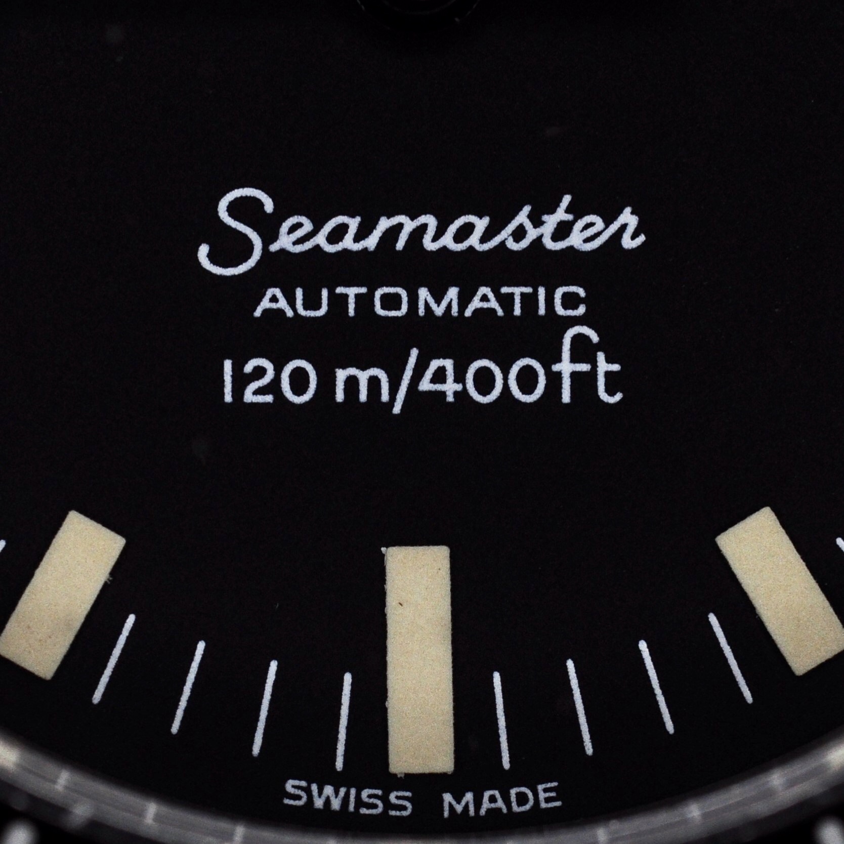

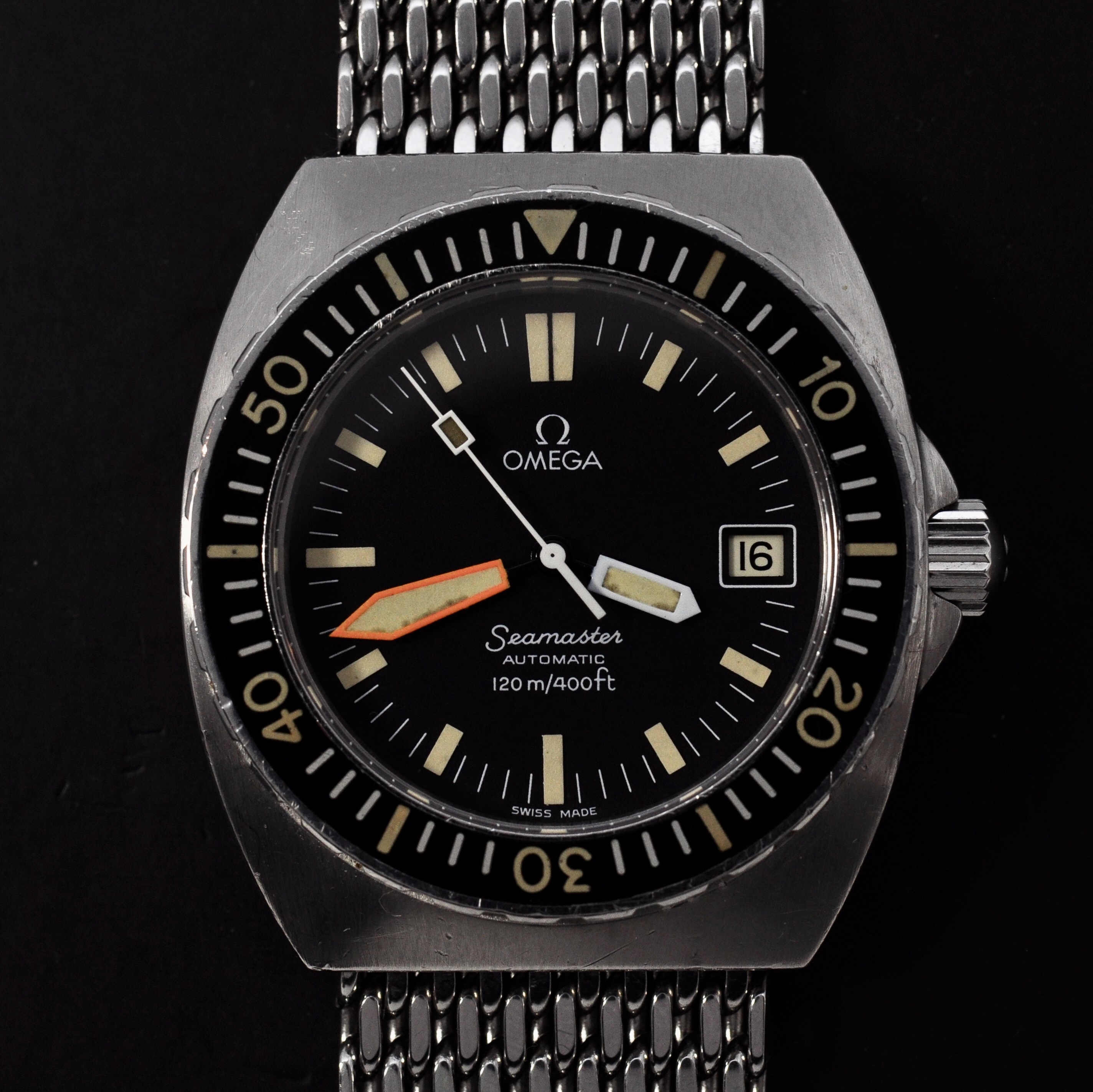

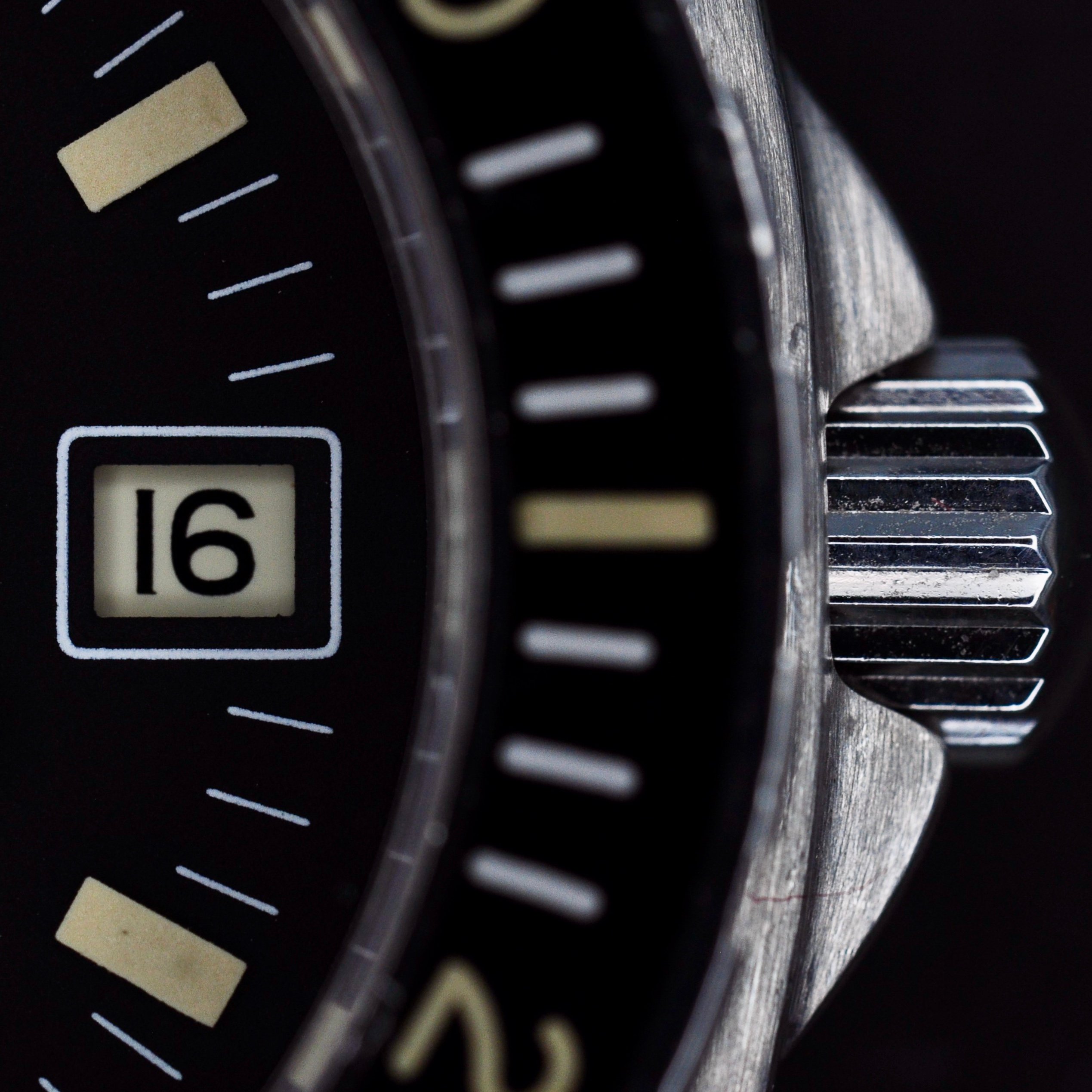

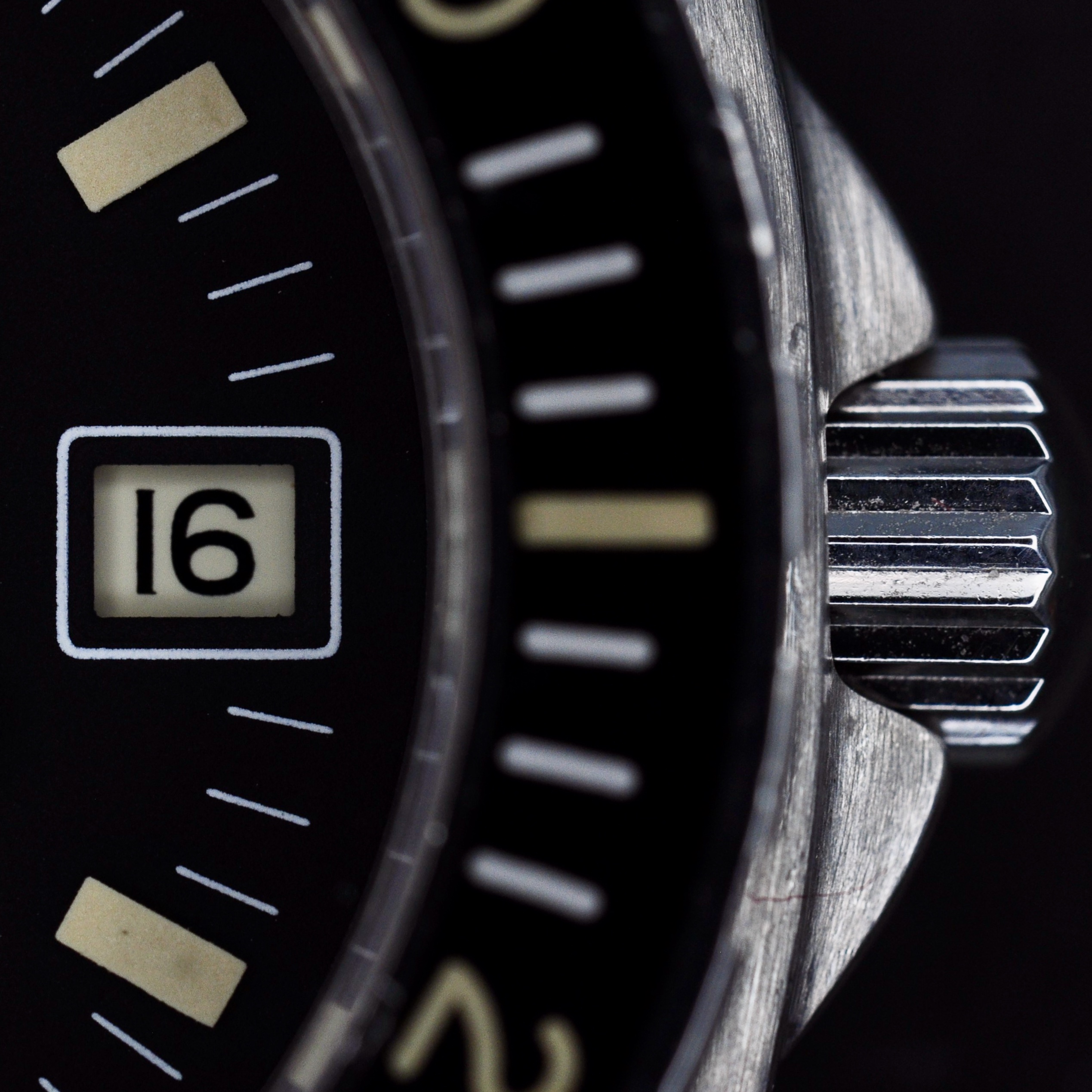

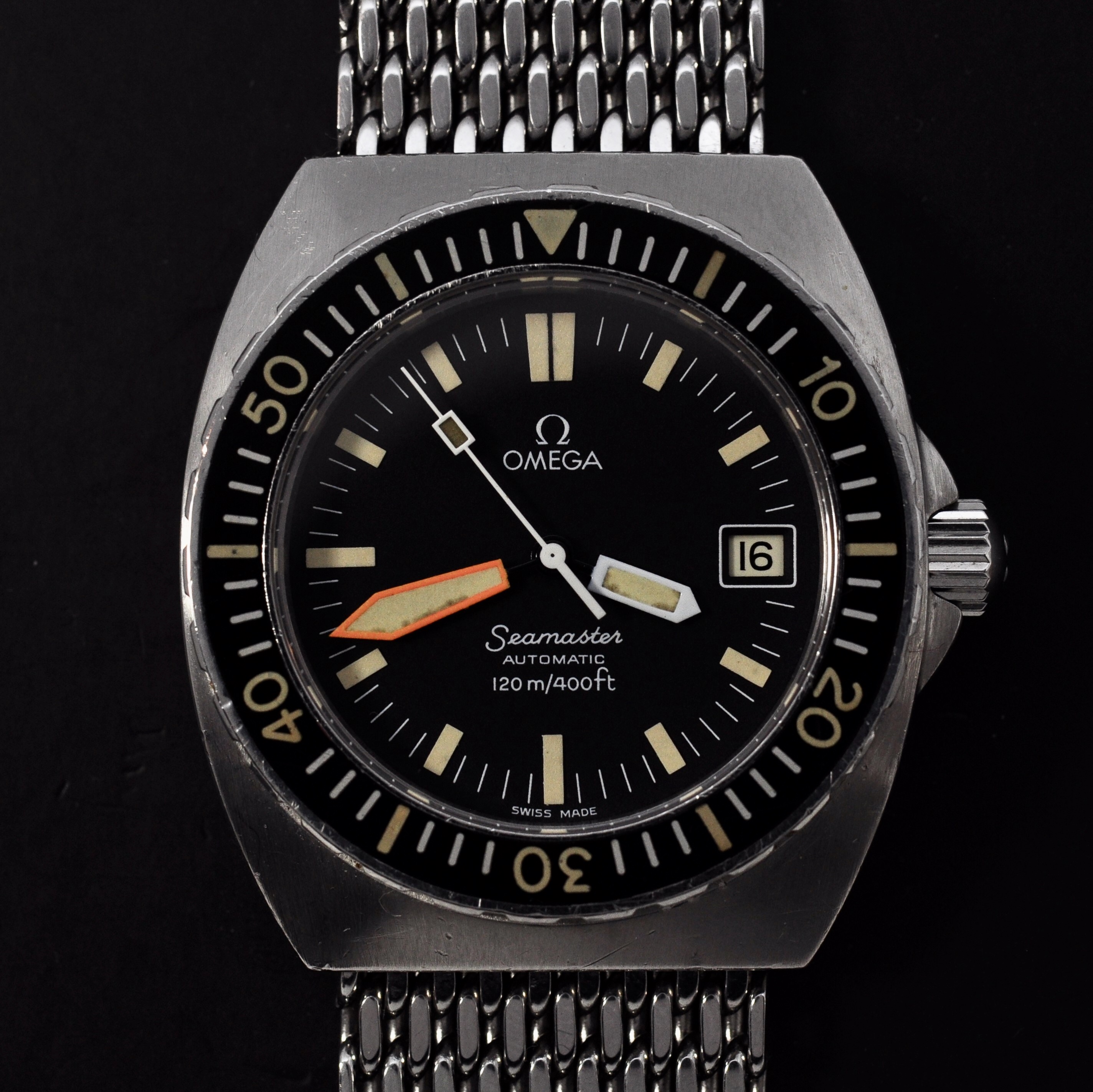

I observed also sigle piece at 12 tritium dials. To my experience the best way to recognize a service dial is to look at the indices: tritium dials have applied stripes of tritium with some tickness, it can resemble a sort of tritium tape, while the luminova ones have are more like a drop of paint.
here is a picture of an original tritium dial, unfortunately the stripes of tritium are not mich visible.
concerning the caliber, examples equipped with both 1010 and 1012 can be observed, It may be that both were used.
