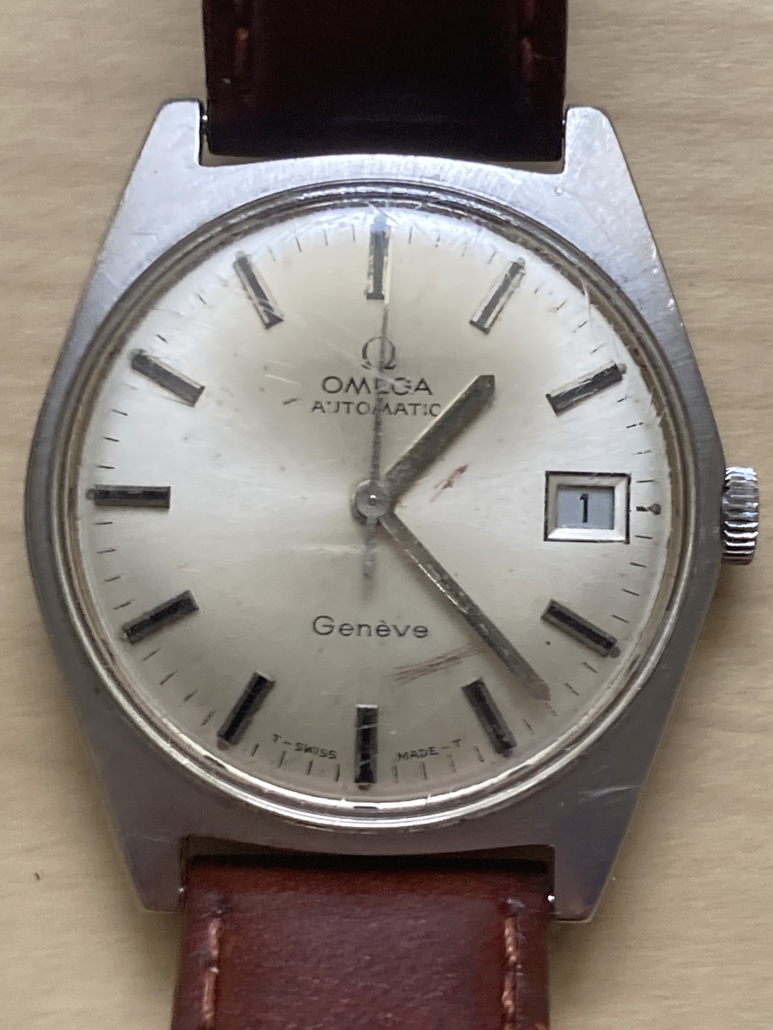

1. I’ve not taken it to a watch repairer yet but from my research I think this is a 166.041 cal 565. Any alternative views please?
2. My dad was under the impression it was broken and I don’t think he had worn it for c5years. However I’ve worn it for a few hours a day during the past week and whilst it’s being worn it seems to be keeping perfect time! Indeed it’s absolutely in line with my Seamaster. However it doesn’t seem to have the same levels of reserve and if I don’t wear it all day it then it has stopped by the next morning. I’m assuming if I wore it full time it would be ok?
3. I’ve always fancied a nice watch winder and as I’ve now got two chrono/automatic watches I’ve purchased a Wolf Cub. The Seamaster works fine but the Geneve doesn’t seem to benefit. Is it because it has insufficient “charge” or is it not suitable for a winder?
4. After so long inactive I’m guessing many of you will be suggesting I give the Geneve a full service? The photo attached makes it look rougher than it really is and of course given it’s history I don’t want to spoil it’s patina. However it does have two dark marks on its face. Would these clean off? I don’t want to change the face. Can anyone recommend a suitable repair shop in Bristol/Bath/North Somerset?
5. I also note it seems to have a non- Omega crown. I’ve spotted several on e-Bay for around £40. A good source?
I never bothered to visit a watch forum before when I bought my Seamaster but having inherited my dads watch I’m now keen to understand the model’s history. I look forward to your views!

The model and movement is on the caseback and movement. But your research makes sense without me checking.

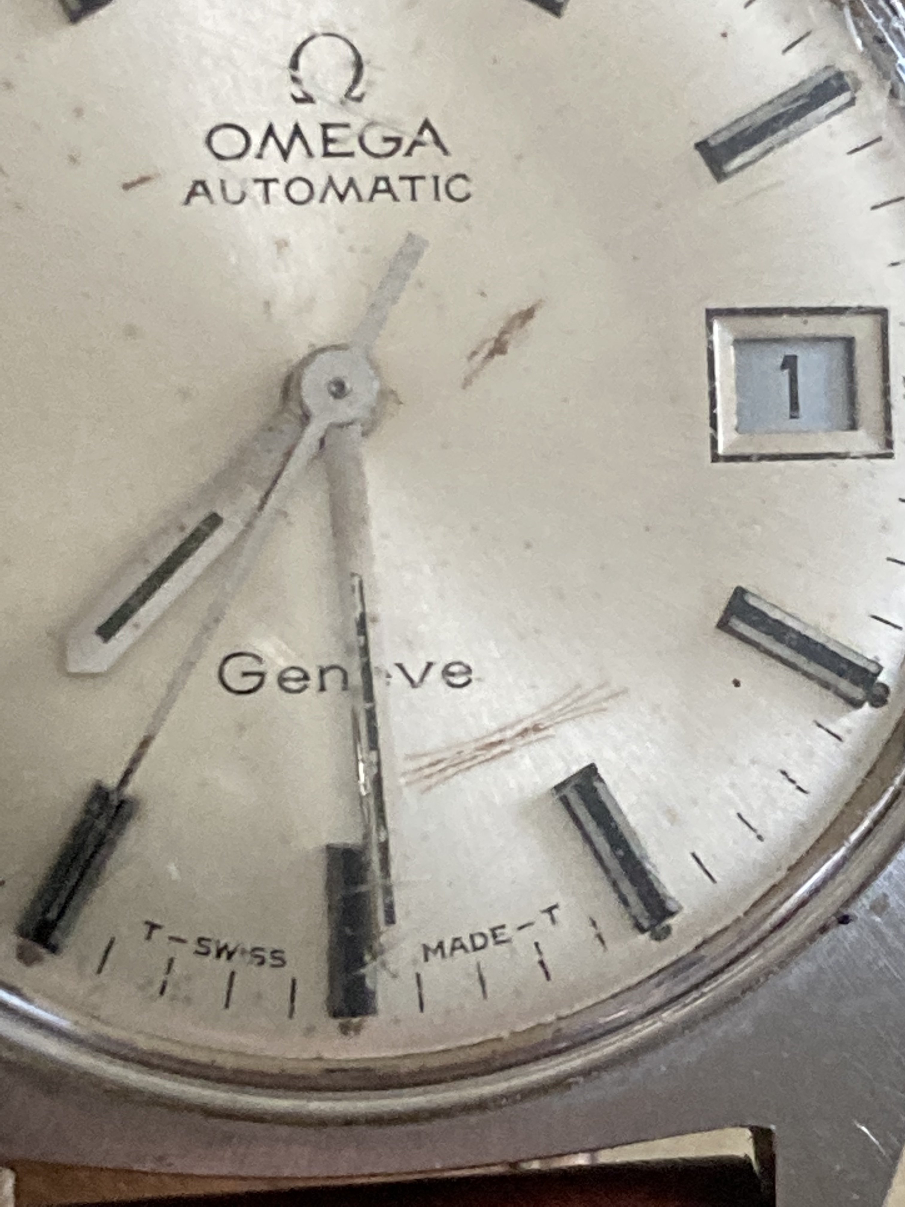

it needs a service. The hand is scrapping on the dial.

Thanks for your reply. I did wonder if the marks on the dial were new. Maybe they’ve only been caused since I started wearing the watch!!
I’ll get it over to a watch repairer asap.

Looks like it has the wrong hands, too, since the dial is luminous.
18,326
27,695
I think those are luminous hands actually.
If they where not luminous the it would be an obvious black insert.
2,346
1,475
I would leave the generic crown. Having a signed one is not major and it's already fitted.
New crown also means new winding stem + watch makers time to cut and fit the parts
Service and new crystal. Can leave the hands as they are to match the aged dial

Wow, any chance the marks are on the inside of the crystal and not the dial??? I know it's wishful thinking but.......
I think you're right. When I embiggen the photo I can see the lume in the hands, it's just similar in shade to the hands themselves. I would ask the watchmaker to relume them.
I wish it were true but it does look as if the marks are on the dial. It’s strange that the watch is keeping such accurate timing if there’s any drag from the hands onto the dial. My mum has no recollection of new hands being fitted (but then again she can’t recall a new crown either!). I’ve attached a closer view of hands and dial. Opening it up will make things clearer!
