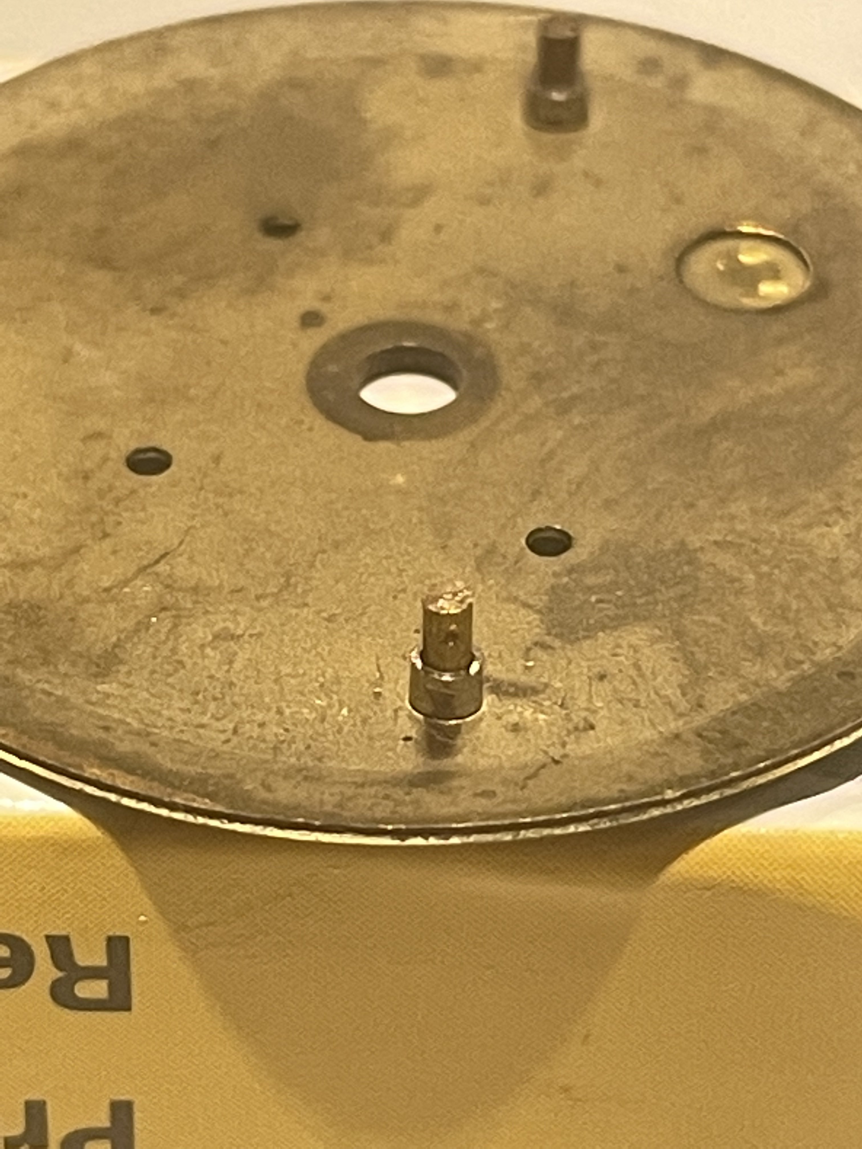

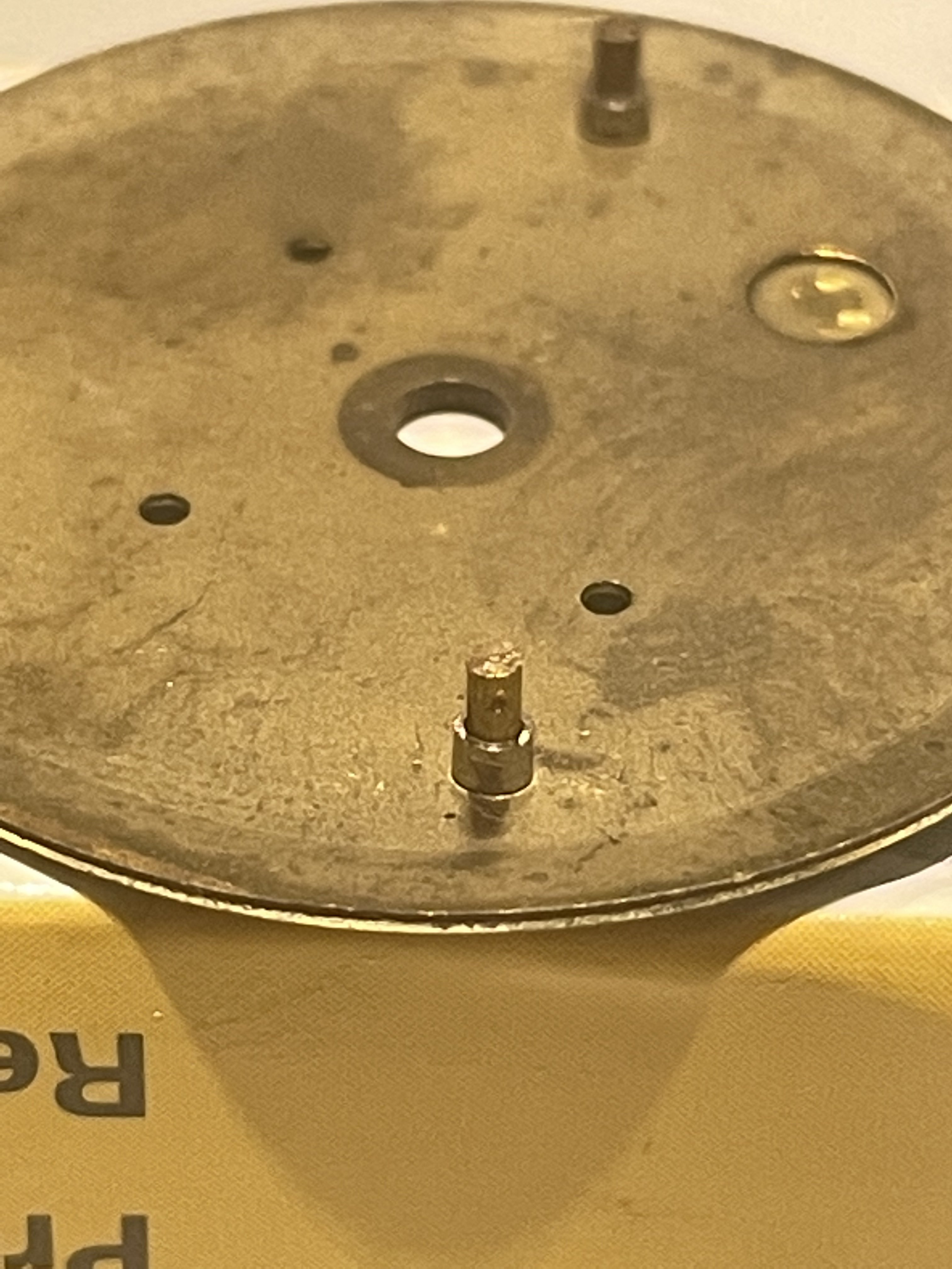

This is an old 321 dial with applied logo, the dial feet have been filed down and it has been put on a 861 movement in the past, you can see the small hole the screw has made to the side of the foot.

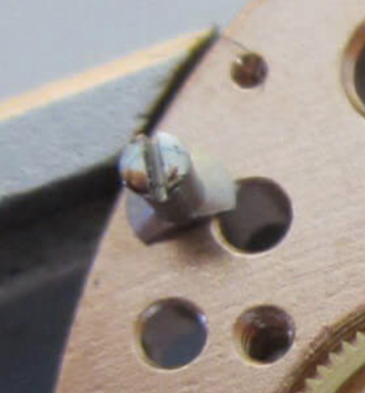

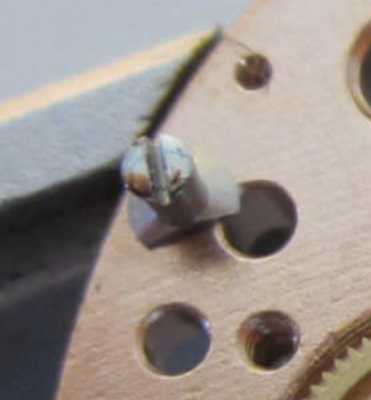

The 321 movement has a dial screw like pictured, I think a 861 dial should fit without any probs.

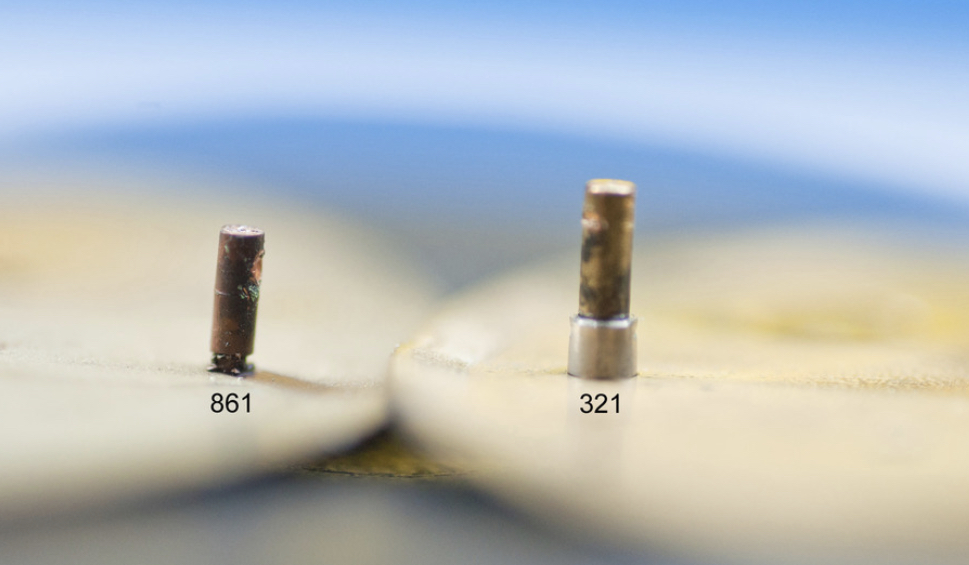

One of the photos below is credited to Al Archer.
Hope you don’t mind Al, but if you do I will take it down.
30,303
78,234
No worries...it's a good illustration of the difficulties involved.
