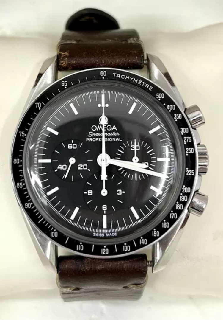

Hello,
Could you please help me authenticate this july 71 ?
This is the best shoots i have before deciding to pull the trigger on.
i'm neewbie on speedmaster, from my research it seems ok but ... ?
10,125
57,950
It's impossible to properly evaluate the watch with these photos. The lack of a photograph of the movement would be enough to keep me from buying the watch. What I can see from these photos is that the lume on the hour and minute hands is nearly or completely gone. That would make me wonder whether any of the flaked lume has worked its way into the movement. The case shows some significant scratches particularly on the lugs. There is some scuffing on the crystal (not a big deal) and there may be some marks on the dial (again, hard to tell without better photos). There are some minor chips on the bezel. I can't tell whether there is corrosion on the inside edge of the bezel where it meets the crystal or that may just be accumulated dirt and grime that will go away with a good cleaning. The bracelet looks like an Omega 1171, probably with 633 end links, and may have some stretch, but again it's impossible to verify without better photos. Do you know when the watch was last serviced? What's the asking price?

An you share your thoughts on it? What do you think of the case/dial/bezel?

It's impossible to properly evaluate the watch with these photos..,
i see, thanks for what you saw with thoses poors pics
the bracelet is 1116/575 (saying the seller).
OK i have compared with authentic 71 from others posts, dial seems accurate (for me), but no idea about those 'green lumes'.
I have to think about the price now ... (have to make an offer)
thanks

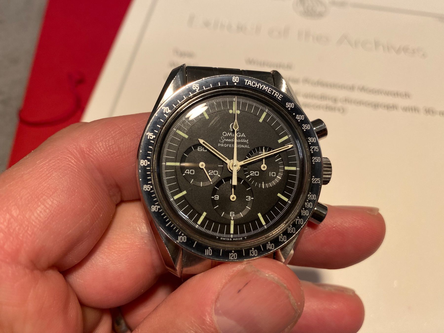

The 1116/575 is one of the correct bracelets for this watch. The green lume is normal although not everyone finds it attractive (I do, but your tastes may vary). I've attached a photo of my 1971 for comparison. Again, I would be very cautious about buying this watch without good clear photos of the current state of the movement and information from the seller about when the watch was last serviced and what was done. Unless you are planning to leave the hands as they are, your options are either to source a replacement pair of tritium hands, which will be quite expensive, or to relume the hands with superluminova which will devalue the watch as a collectible piece.
