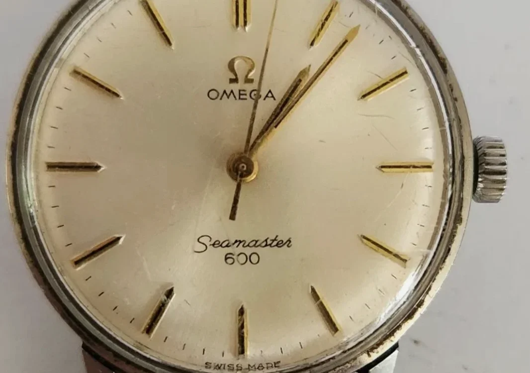

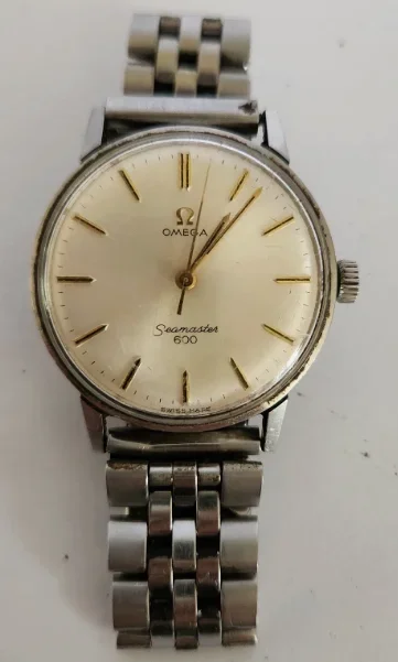

Hello all at the Omega forums - first post so nice to meet you all.
I love Omegas, specifically those from pre-1970 (although I'd love one of the Bond modern seamaster 300m professional if they weren't so large - 42mm seems a bit bulky for me).

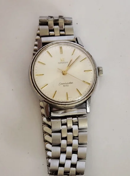

Can someone please help with an authenticity check on the dial for the above Omega Seamster 600 ref 135.011? It's a cal. 601 so based on that along with the 'seamaster 600' print I think it dates to the 1964-66 period.
Context is I got it on ebay for an Ok-ish price - the crystal is very scratched and the bracelet is bullshit and will be replaced with leather strap, crown also doesn't look original so will replace that, needs a good clean and service too.
Looking for some expert guidance on whether the dial seems legit - I know Omega did a million diff dial variations of this model and the above colourway was one of them, Not easy to see past the scratched crystal but the typography all seems sharp and well printed, and I wanted to check with some experts if they thought it is original, or a reprint.
The one concern I'd had was the 'swiss made' at 6 o clock, ive seen that on other dial colour variations, but when i've seen this particular dial before its always had the 'T swiss made T' for the lume.

The dial is fine. There are no T’s as there’s no lume.

The watch looks nice and I agree with you about replacing the bracelet with a comfortable leather strap.
So far as the crystal is concerned you can polish out the scratches with Polywatch. Your photos aren’t sharp enough for me to see but, check if there’s an Omega symbol right in the centre. That would show it to be an original signed crystal.
You don’t want to over polish the case, and I’m assuming that the bezel isn’t missing, but you could use a soft wooden cocktail stick and some CapeCod to remove the grunge and clean it up.
I believe these do not have a bezel.
Thanks Davidt, apreciate the response, just wanted to double and triple check as I know there are so many dial variations of this reference and I could deal with fake bracelet or crown as easily replaced, but wanted to avoid a dodgy dial
