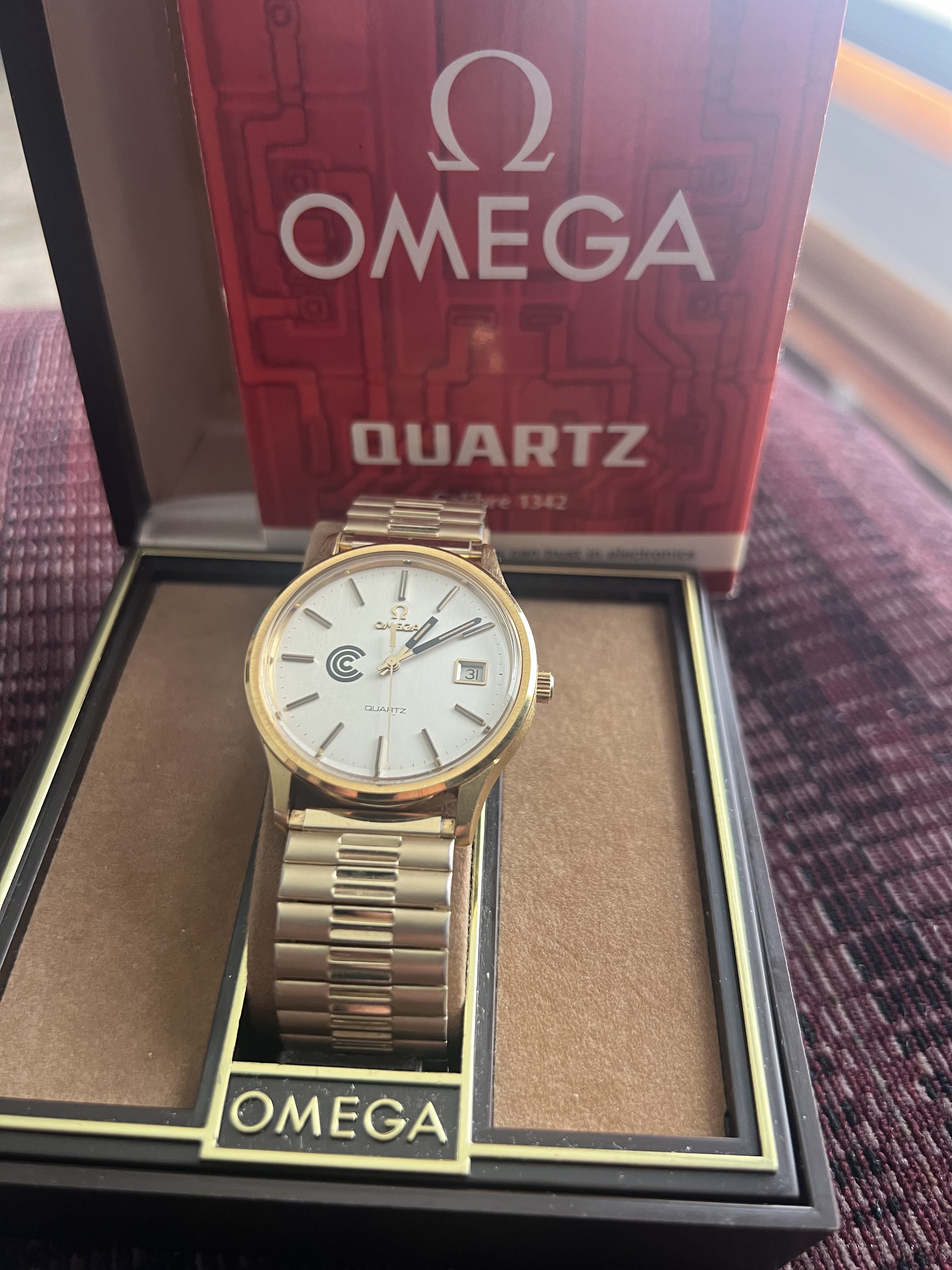

I picked up this Omega Calibre 1342 Quartz retirement watch for $150 at an auction. Came with all original paperwork and box. I sent it into a reputable watchmaker for overhaul. Was quoted $450 for battery, replacement parts, cleaning and lubrication, and calibration. I’ll have about $600 into it when done.
I like the watch and happy to bring it back to life and add it to my small collection. How bad of decision was it to save it from the sock drawer?
