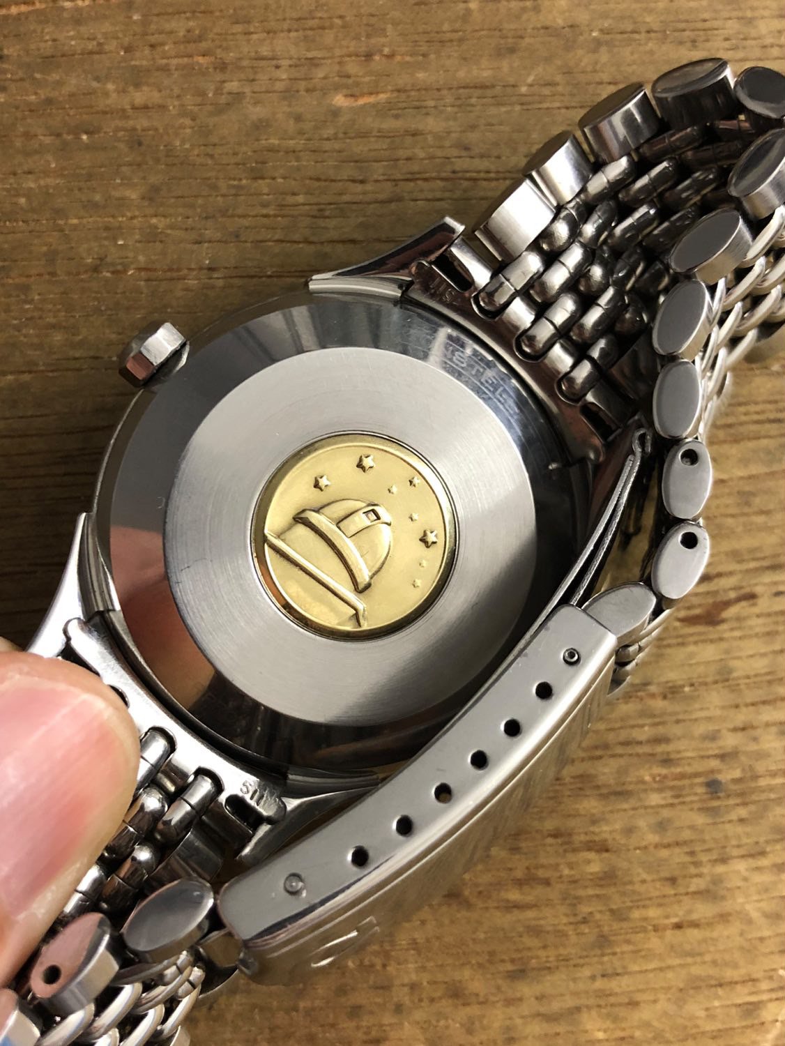

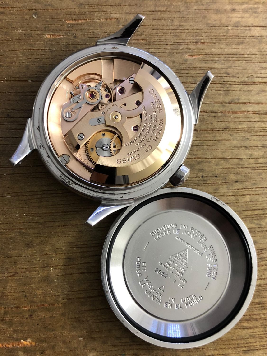

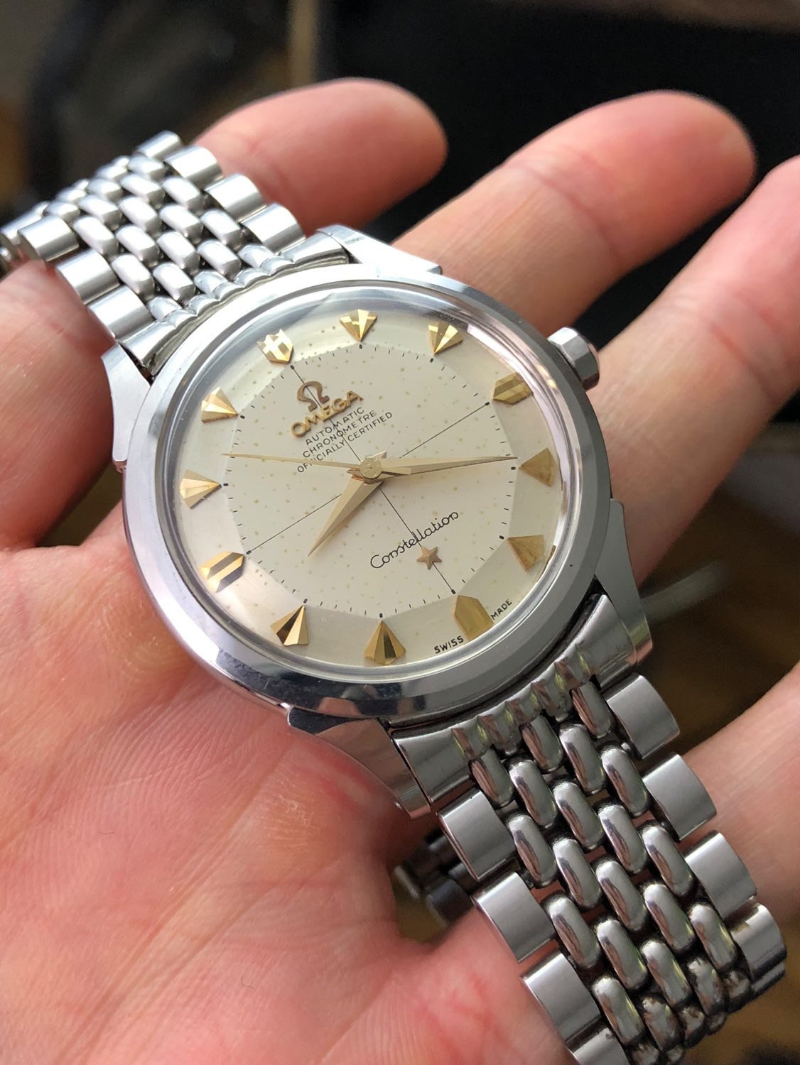

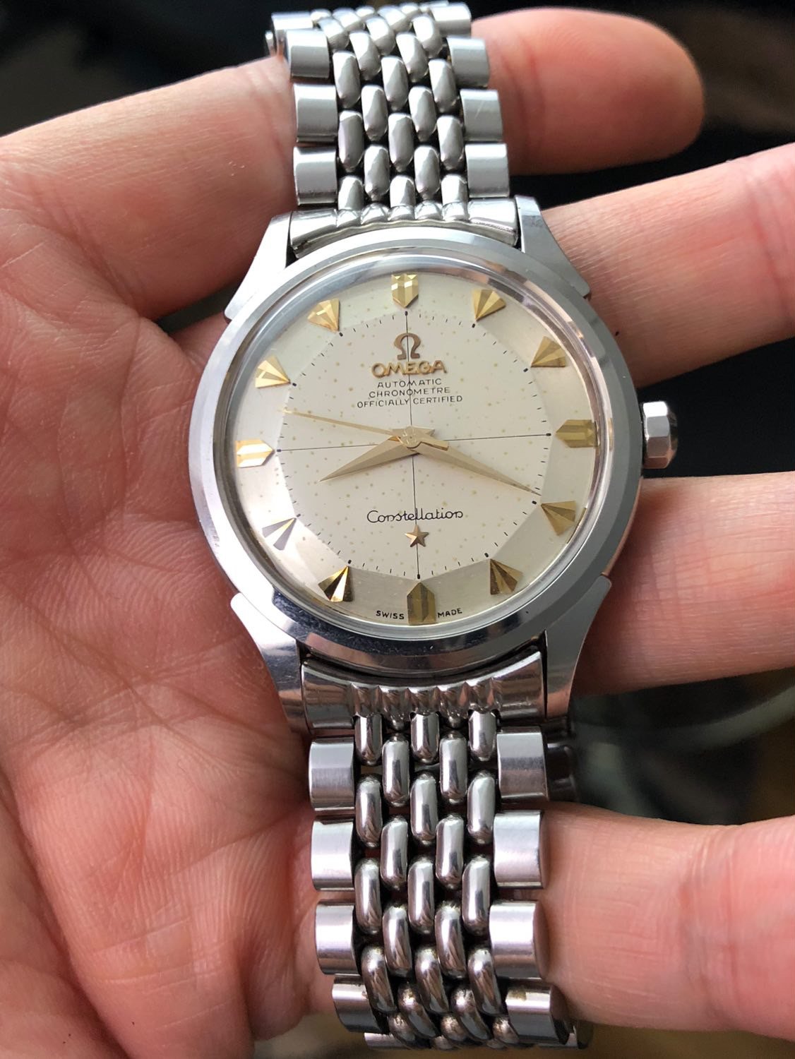

Good day all - I’m quickly becoming an omega fan boy after purchasing a Moonwatch speedy.
I recently have become a bit obsessed with finding a 56 constellation pie pan - it’s the birth year of my father and thought it a great way to honor.
I’m not a collector and want to make sure I’m not over spending. My understanding is the arrowhead markers make this relatively rare in this condition.
What do you think is fair value for a 56 2852-7-c in shown condition.
any red flags or negatives to note? Appreciate you guys

Fonts look fine
Spacing looks fine
Delicate crosshair looks fine
medallion looks fine
Correct crown
Nice BOR bracelet

Fonts look fine
Spacing looks fine
Correct crown
Nice BOR bracelet
Agreed. Dial has some light patina and the medallion shows a bit of polishing, but very nice overall. It just comes down to the asking price and whether the movement needs servicing.

Asking price is $5,500 USD - Seems a bit high based on what I've seen but it is unique from what I've seen. Original BOR, minimal polishing, original box even (or least period accurate).

WAY, WAY, WAY TOO HIGH!!! $2,000 is more in the ballpark. It's a very slow market right now.

That seems to be at least 3x the value, especially given the condition of the dial.

maybe, and just maybe, for a black dial version and even then, a touch high.

Doesn't the SWISS MADE look a bit odd; font too thick? Or is it just the photo?

If you are willing to pay that much, maybe you should wait for one with a cleaner dial. The OP dial isn't terrible, but the degradation is definitely noticeable.
