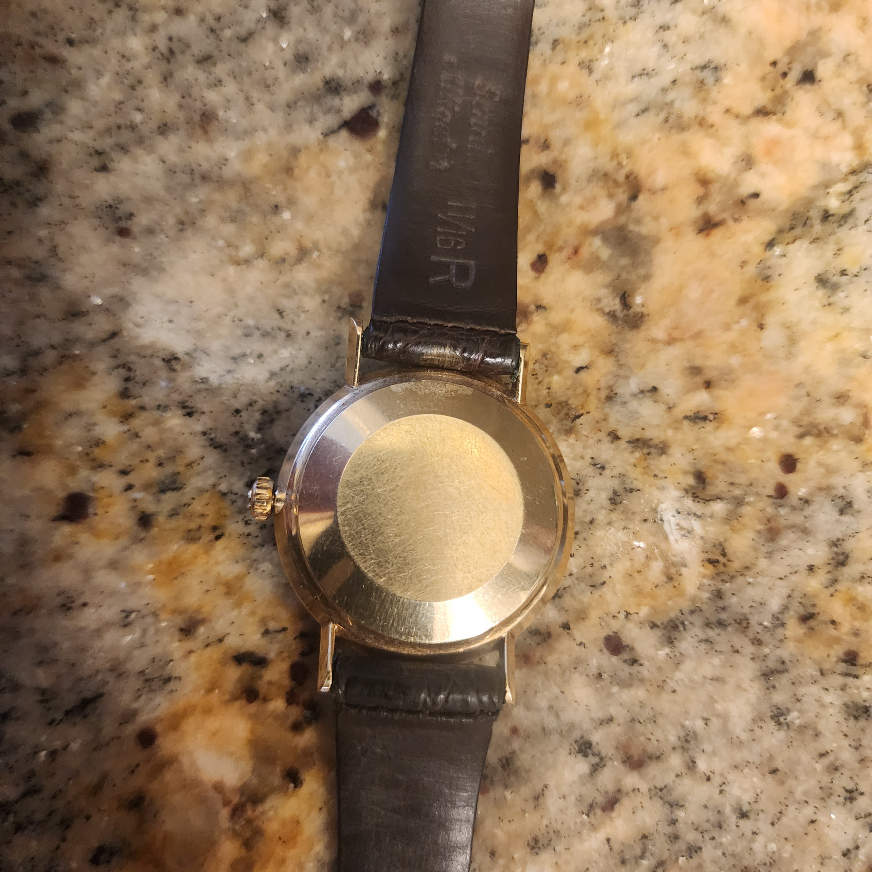

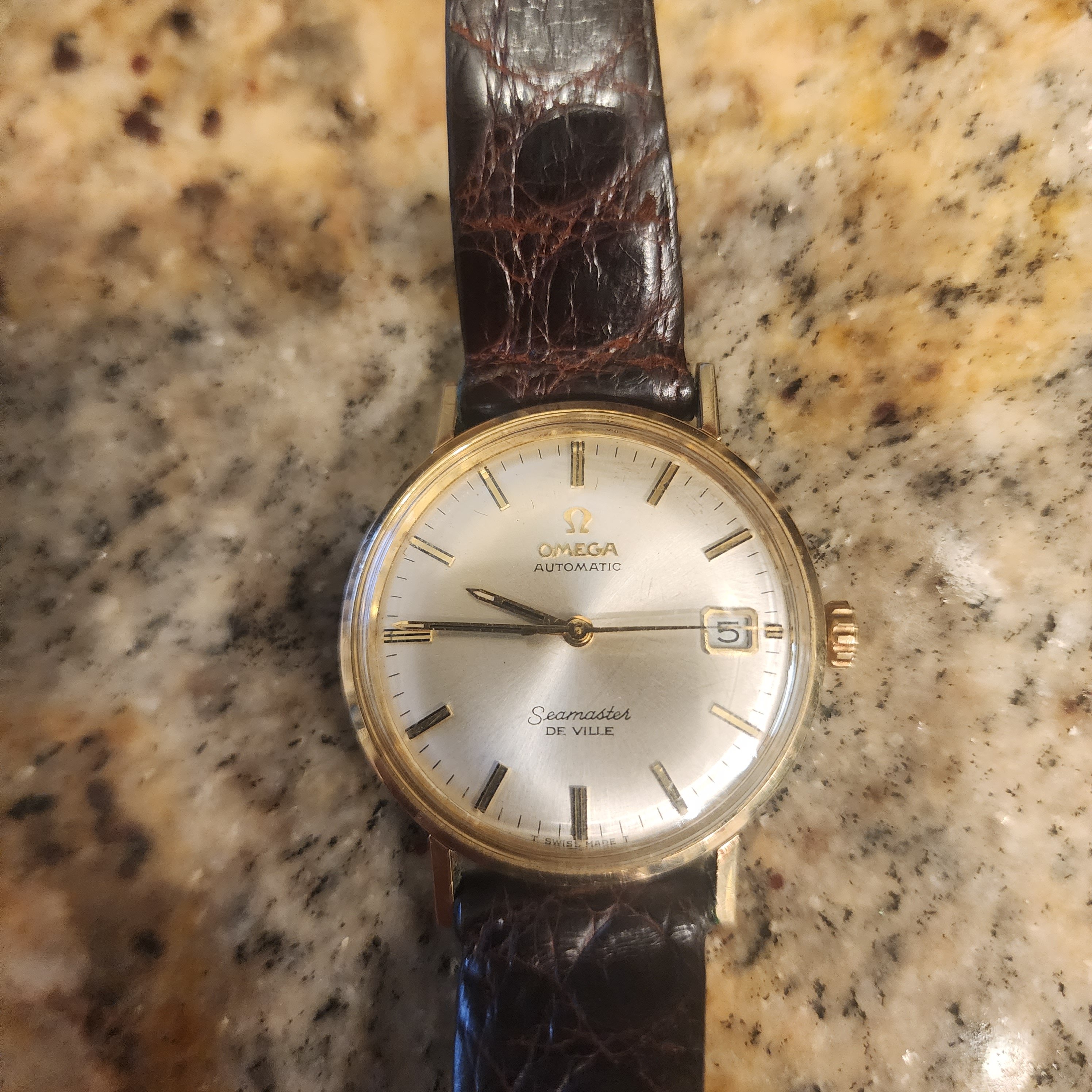

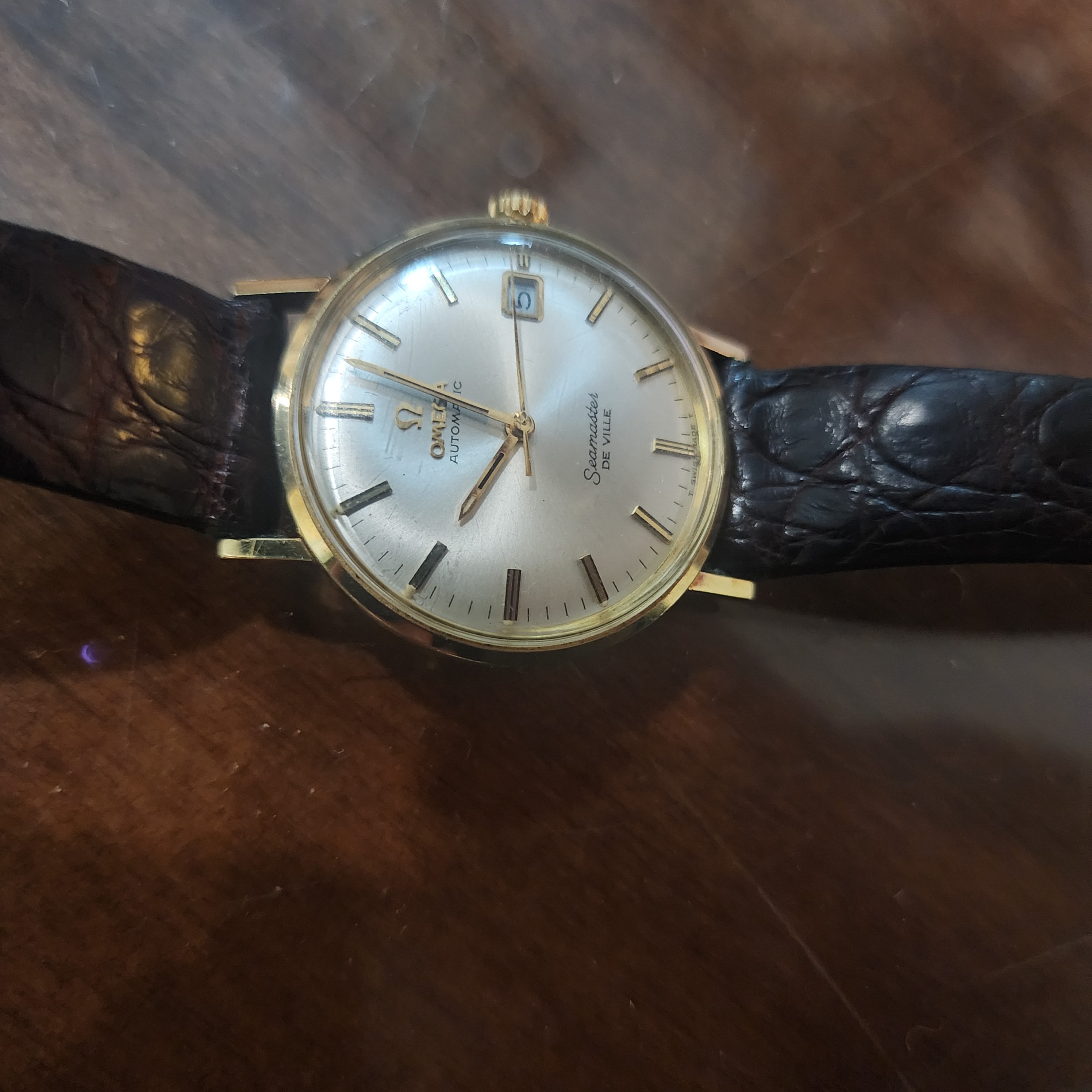

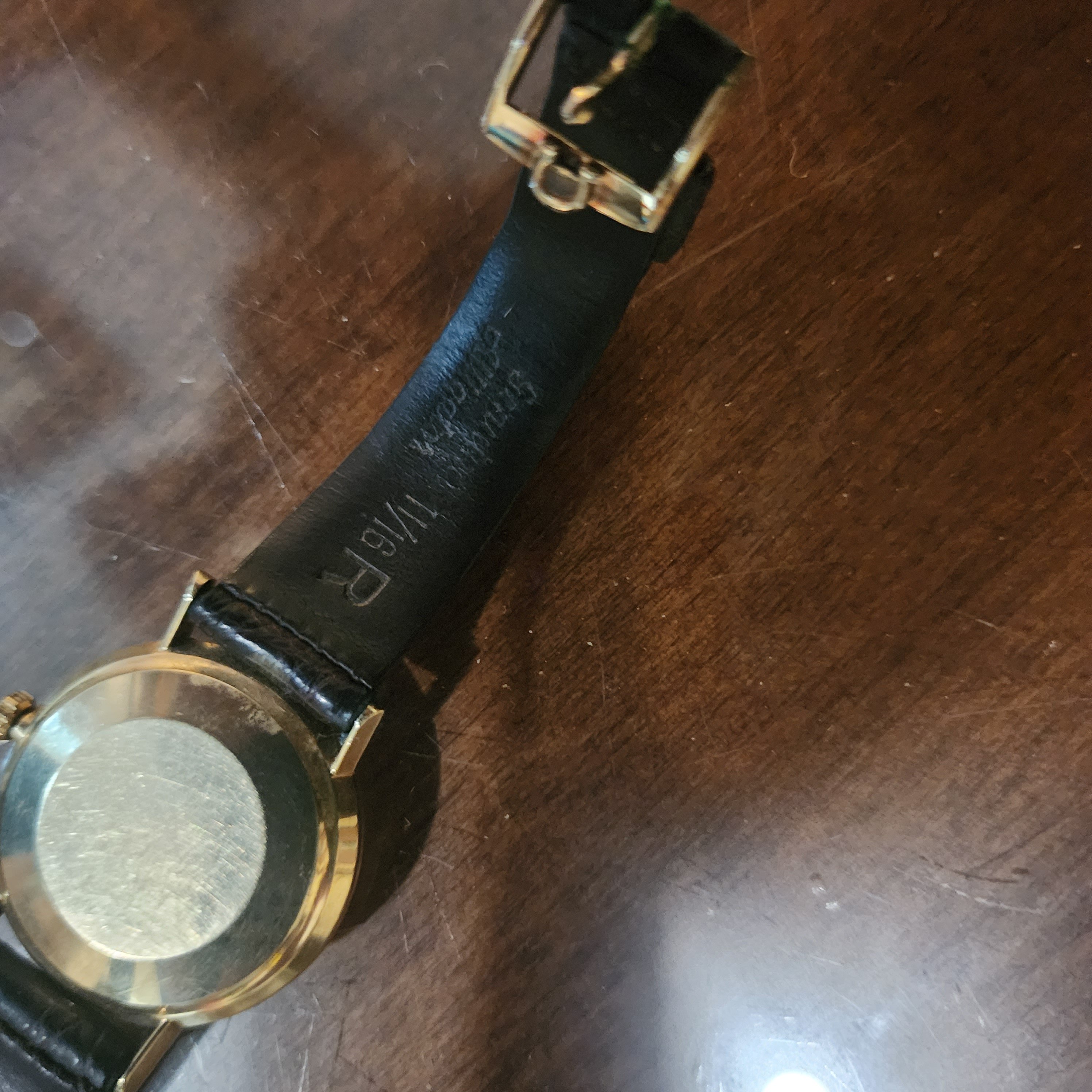

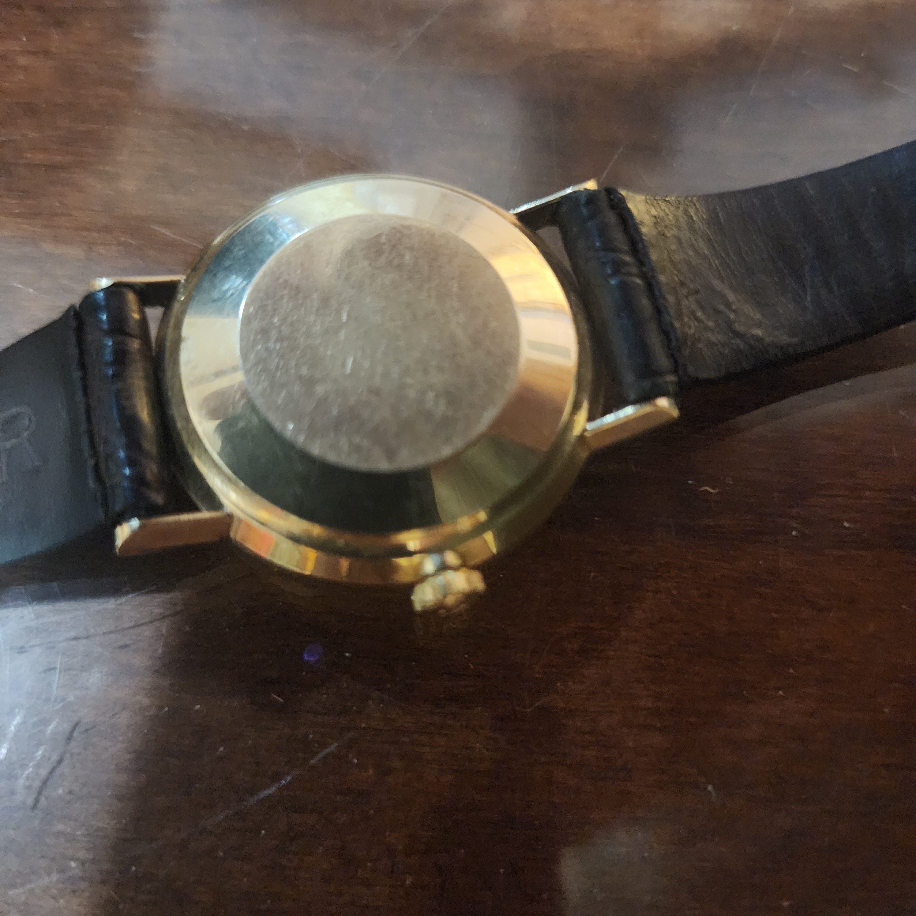

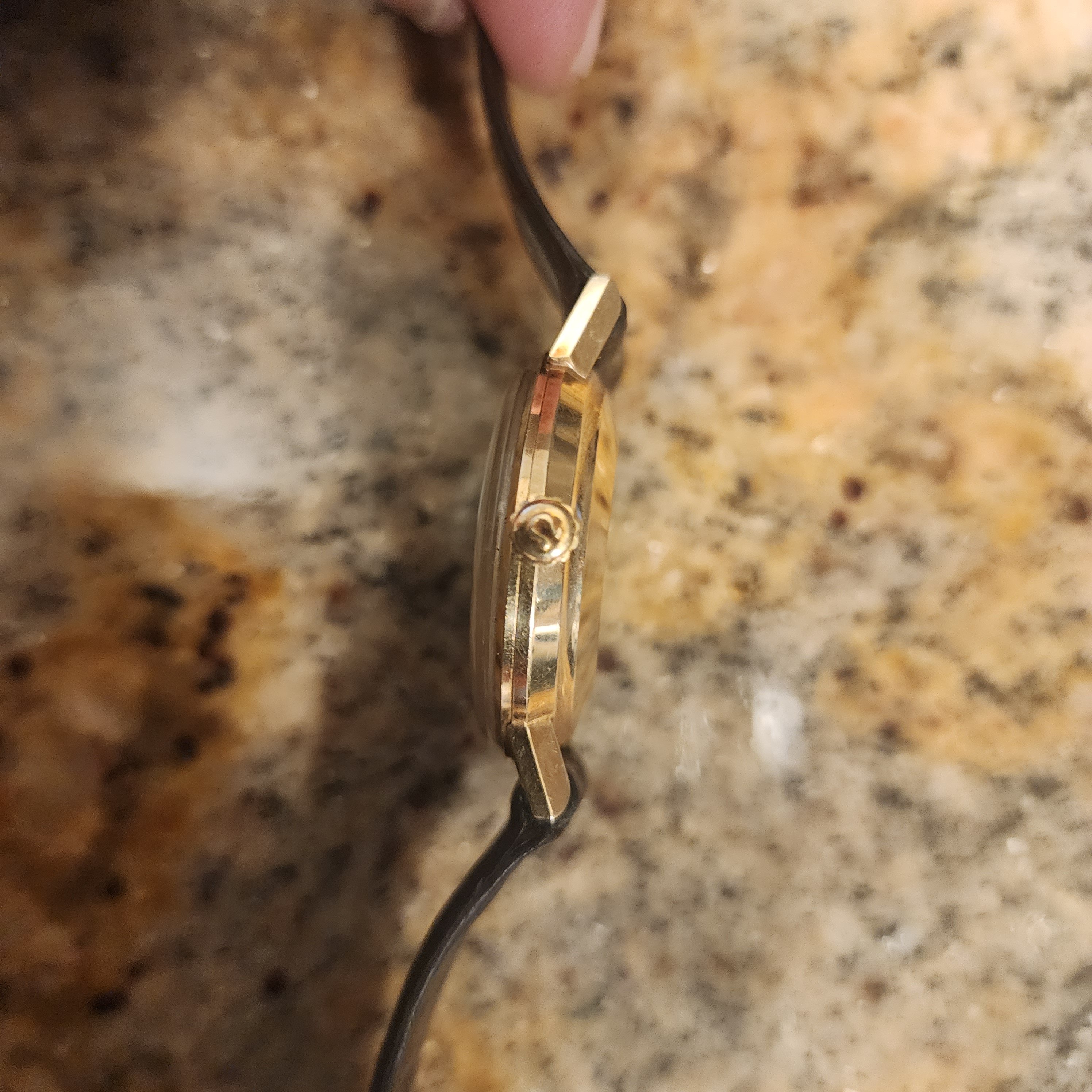

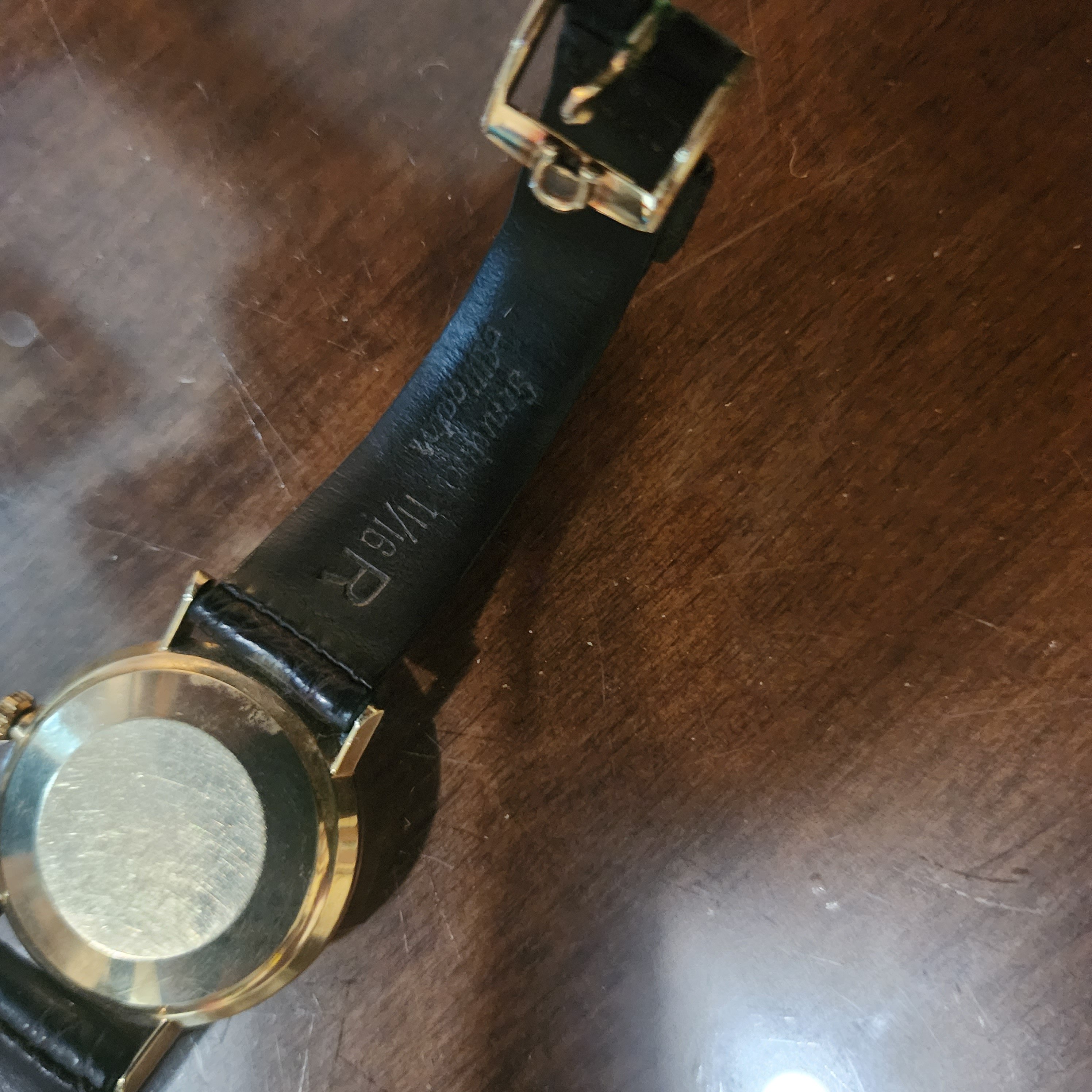

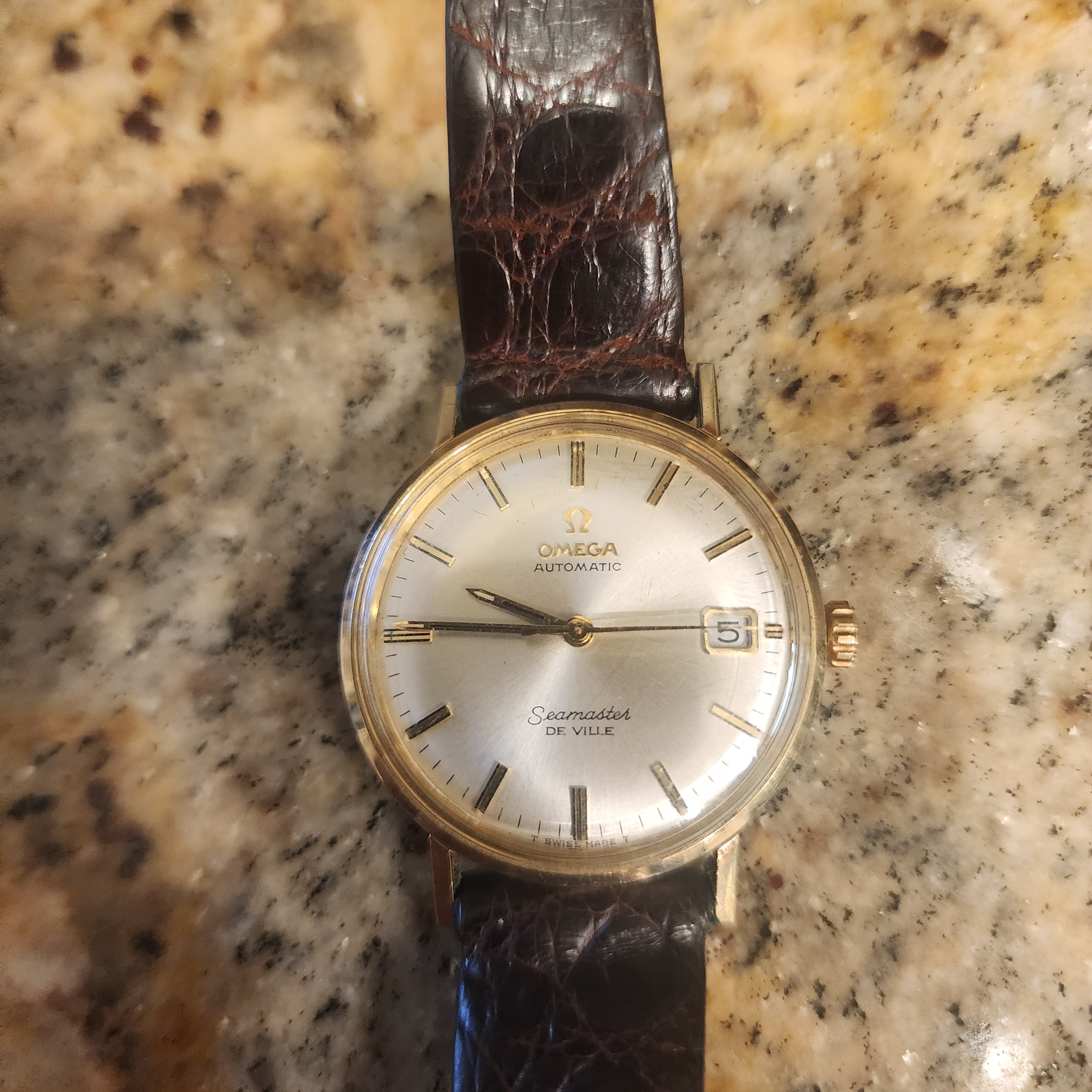

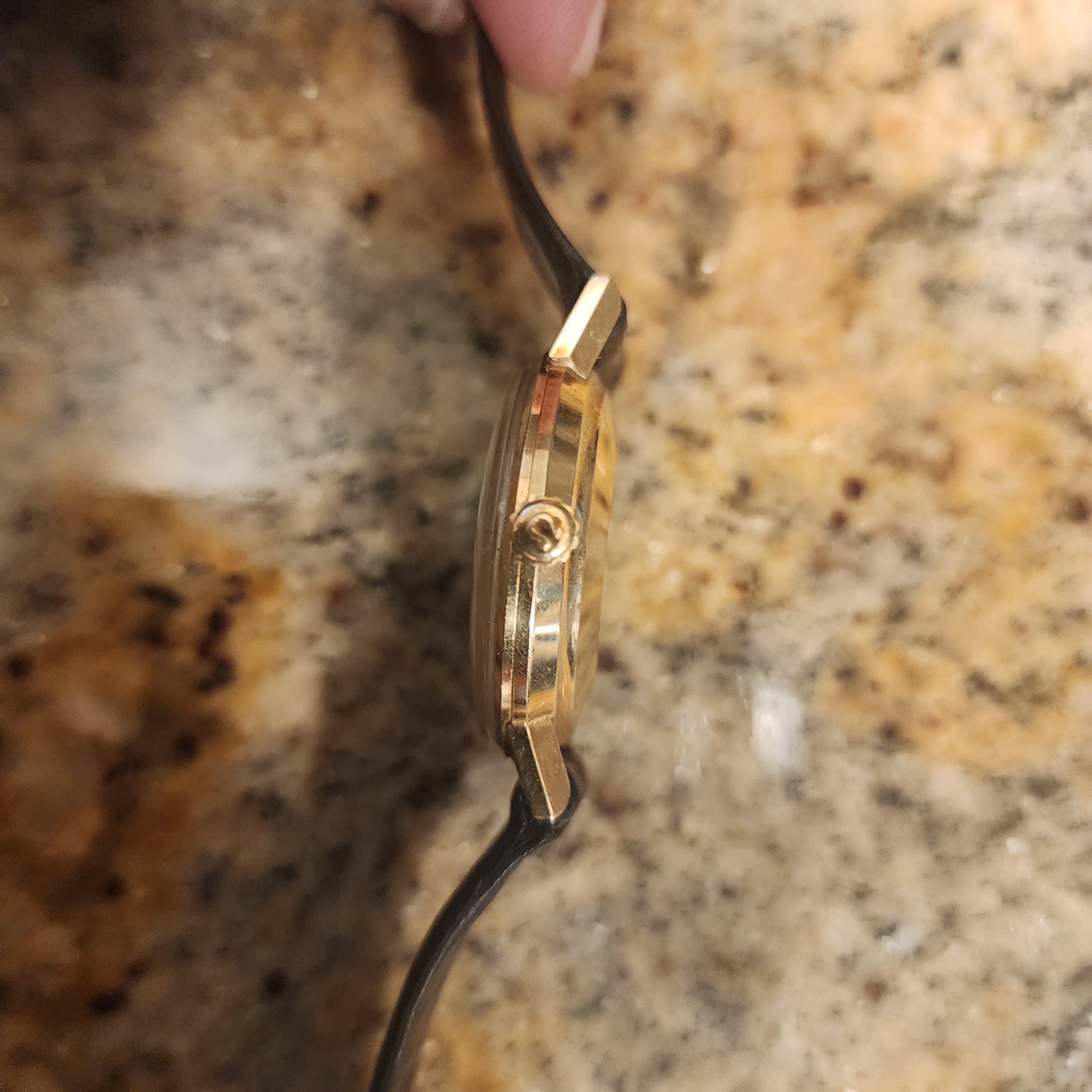

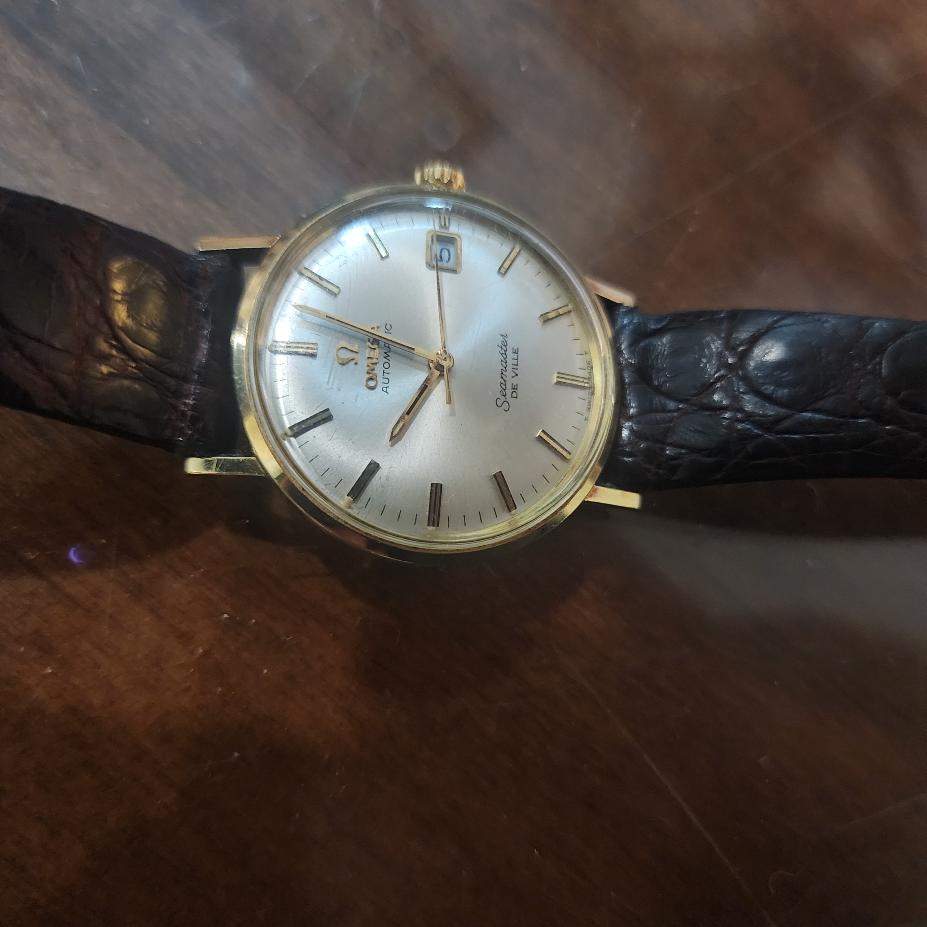

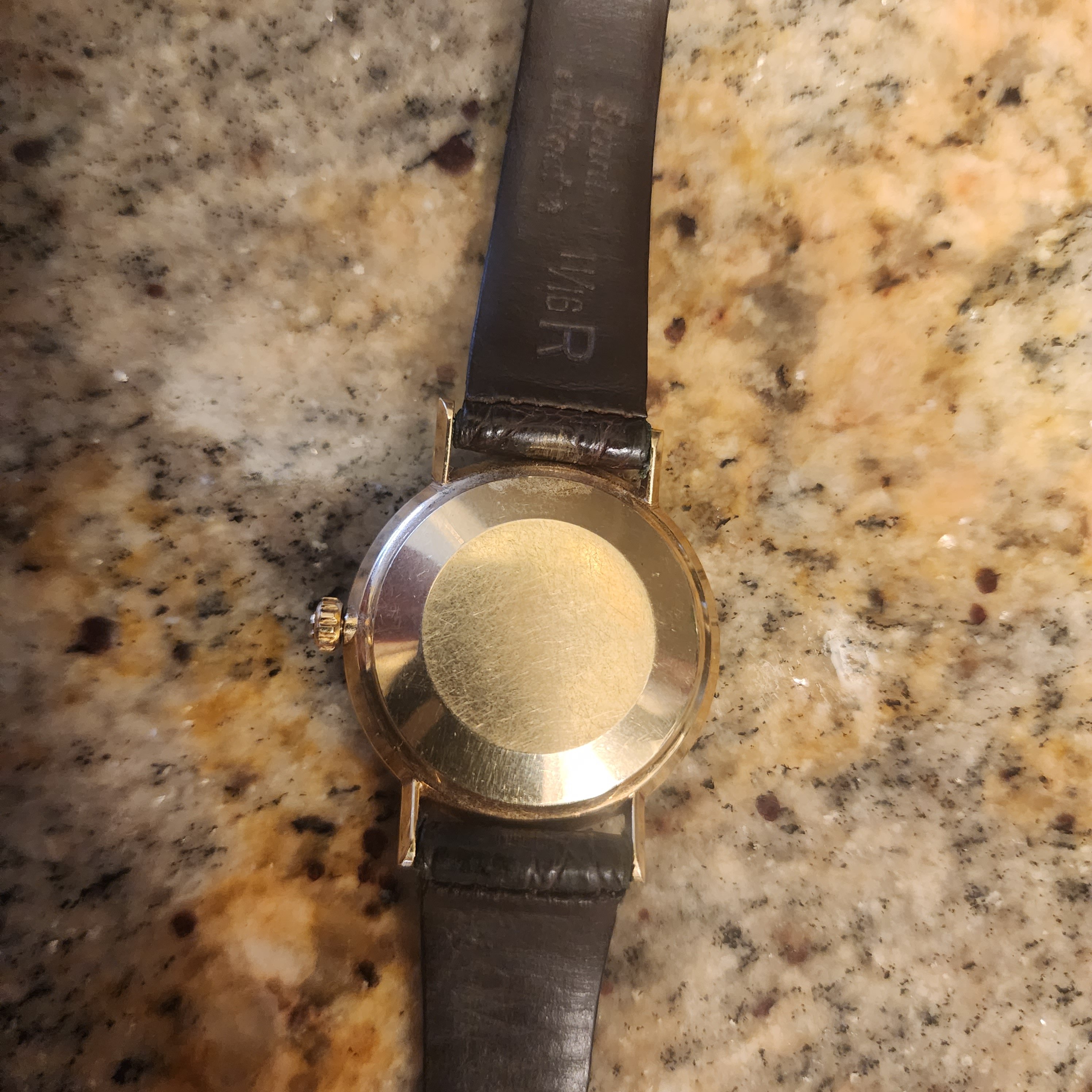

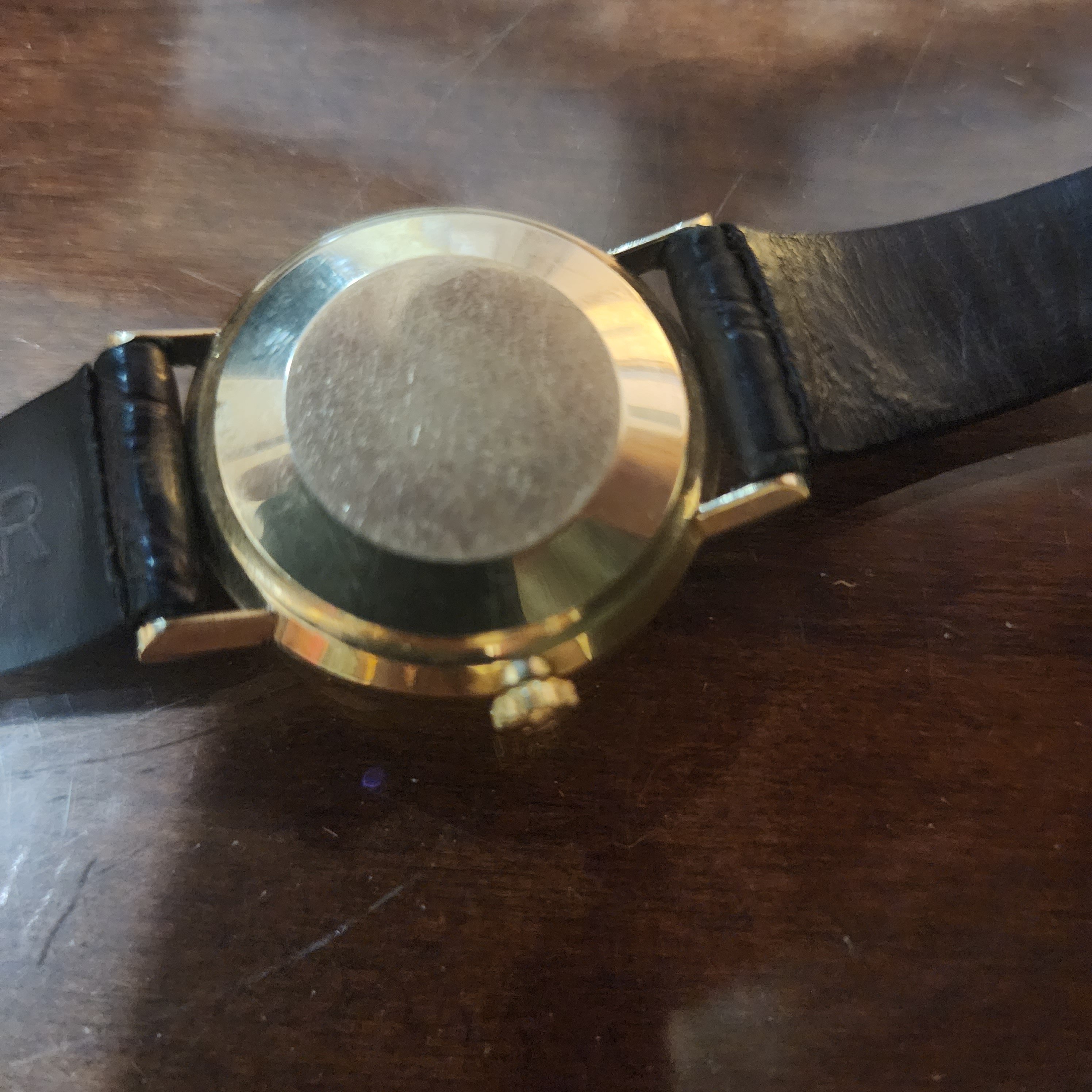

Hello,
I have a watch that I bought at a yard sale here in Charleston, SC (South Carolina, USA) for $5 about 6 or 7 years ago, not knowing much about the brand other than that it was of from Omega, one of the more recognized time piece brands that I'd heard of, I sprung the $5 for it.
I've worn it a few times, but I'm not really a watch guy, the movement is a little slow and seems to fall behind after a few hours from being manually set to the correct time.
Always wondered about the vintage, if it was authentic, year of production, s/n, etc. All the details you'd want to know to see if the $5 splurge was worth it, which brings me here to the Vintage Omega Thread in hopes some of you experts out there could help me out.
Backplate doesn't appear to have any markings, I've never tried to open it to see if there was a s/n inside for fear of ruining it.
Any information that could be provided would be helpful, so thanks in advance.
See attached photos (6) for reference.

Nice watch. Dates between ‘63-‘68, serial # on the movement could narrow it down to specific year- but not really important- you know the time period.
Watch is a front loader which means that you need to pop the bezel (which is fragile) pull the 2-part crown apart (which feels like you are going the break it) and remove the crystal to pull the movement out from the front- not for someone who doesn’t have the right tools and knowledge.
Running slow means it needs a service which is typical for any mechanical watch that hasn’t been cleaned and oiled in over a decade. Any experienced watchmaker can work on these, parts are proprietary to Omega and require a watchmaker to have a parts account (which means they are omega certified), but Omega does still support these which is a testament to their commitment to their heritage pieces. Even without a parts account, most watchmakers have their resources if wearable parts are needed so if you find a good one locally, they can give you an estimate for the work.
Plan $250-400 for a service, that’s about the going rate for a 3-hander. Price obviously depends on the watchmakers overhead (storefront vs home shop) etc. you are paying for their time and expertise (like a skilled mechanic) and these aren’t a 5 minute job with a multi-tool, so you need to evaluate if it’s worth the investment. For what you paid for the watch- you would still come out ahead vs buying one with unknown service history.

I am not a believer 😀. I do not belive that you bought this watch for 5 USD. Nobody sell an Omega for this amount even in worst possible condition. From your pictures it's possible the watch to be solid gold so one more reason do not belive that story.. Enjoy your watch 😀
13,521
23,458
Absolutely, cheery on top is that’s it’s a solid gold model. If you’re able to get the strap off (only try it if you’re confident of not scratching it) it will likely say 14k between the lugs.

It's in nice condition and a great buy for $5. I'm guessing it's gold-filled, but if it is actually a solid gold case, you got something special. I'd find out before deciding what to do with it. If you look carefully around the edge of the back, you will probably see some marking.
13,521
23,458
Actually, you might be right as the case profile on most of the solid gold gold cases is slightly different.
There should be a stamp between the lugs to confirm and it’s a great score regardless.
