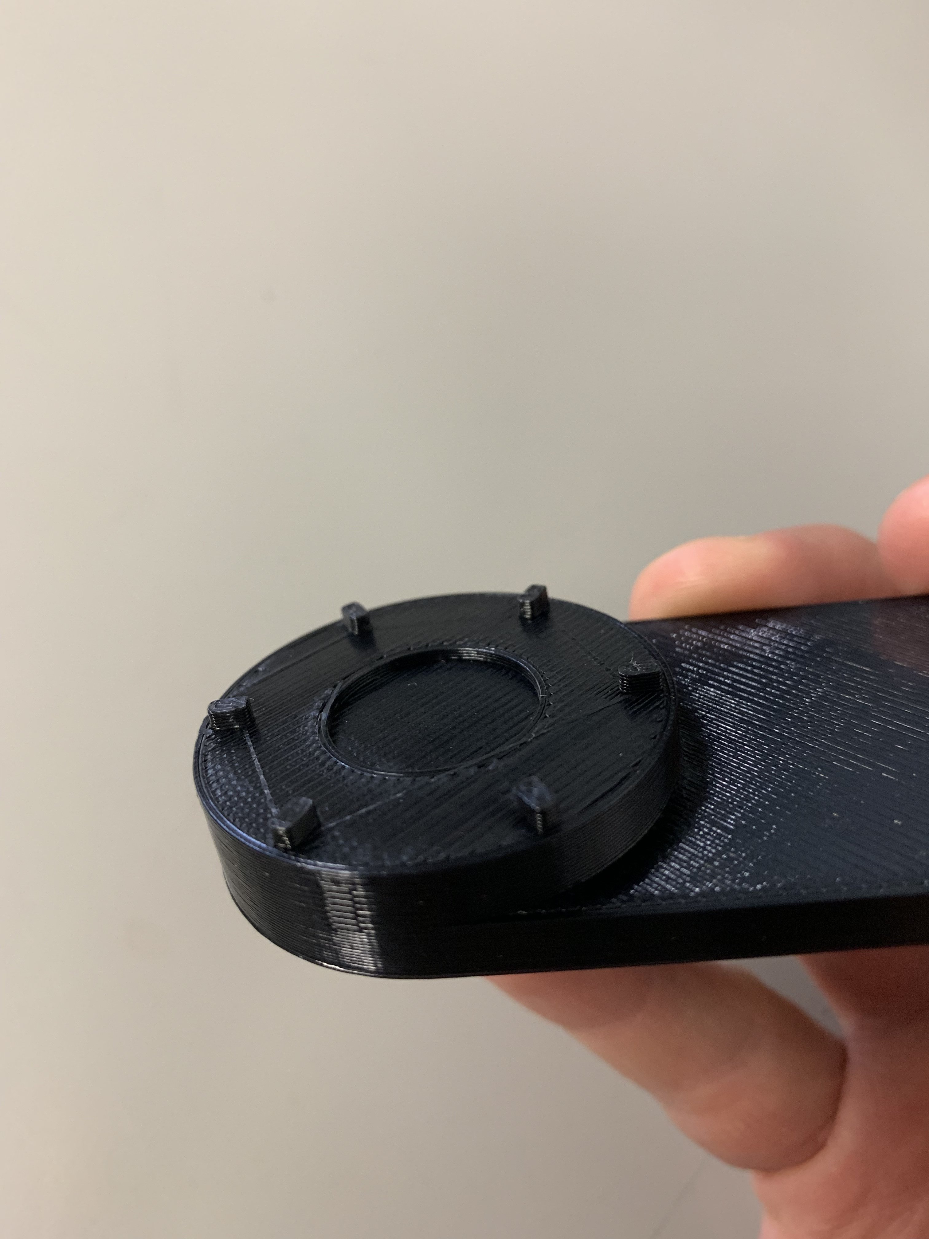

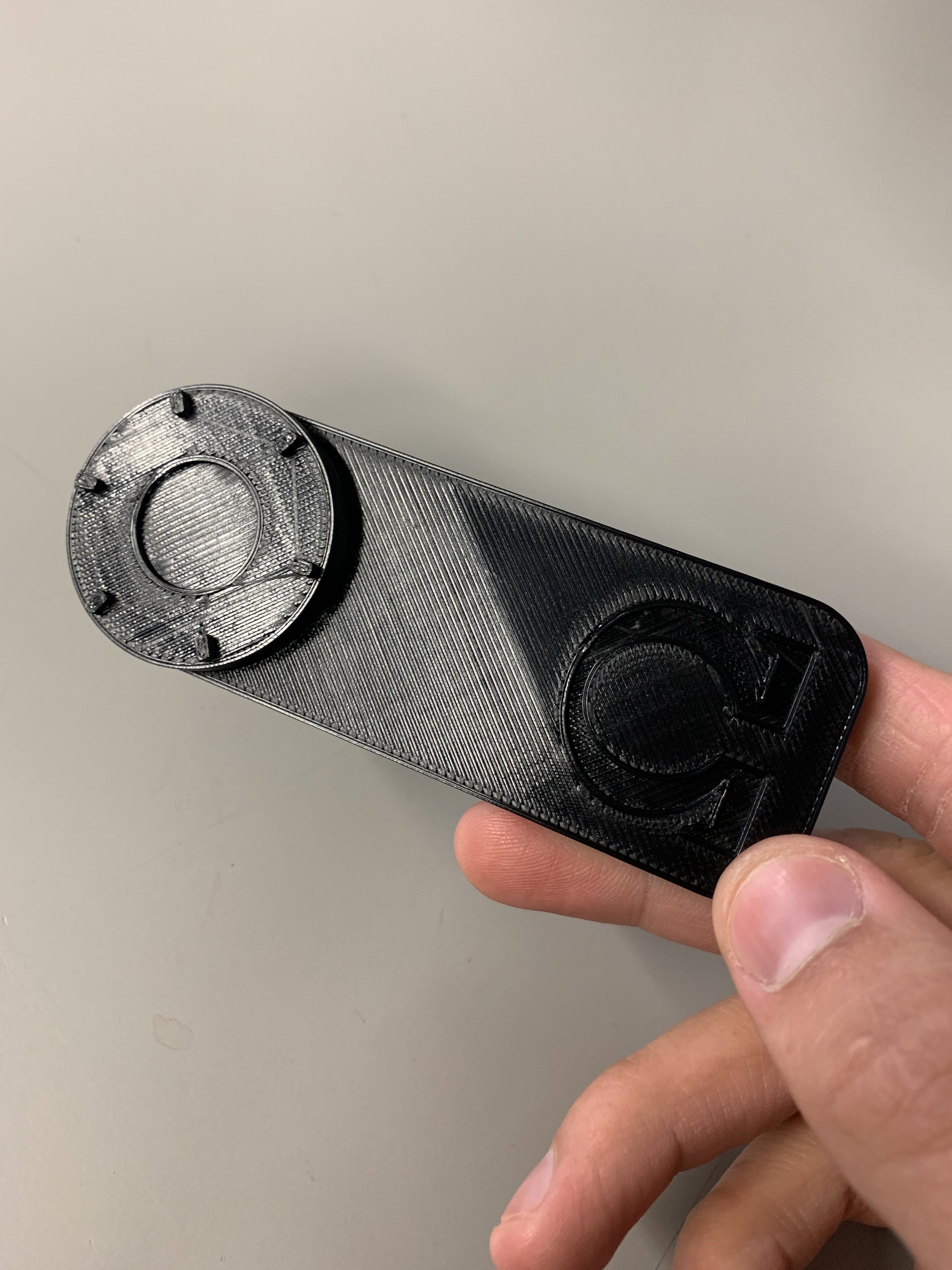

My friend just dropped this off to me this morning. We shall see how it goes. He said he made adjustments to the “infill” that the original creator had in the file to add even more rigidity for the teeth. Don't know exactly what it costs in material because I pay him for AR magazine speed loaders so the little $5-$10 stuff I ask for he doesn’t charge me.

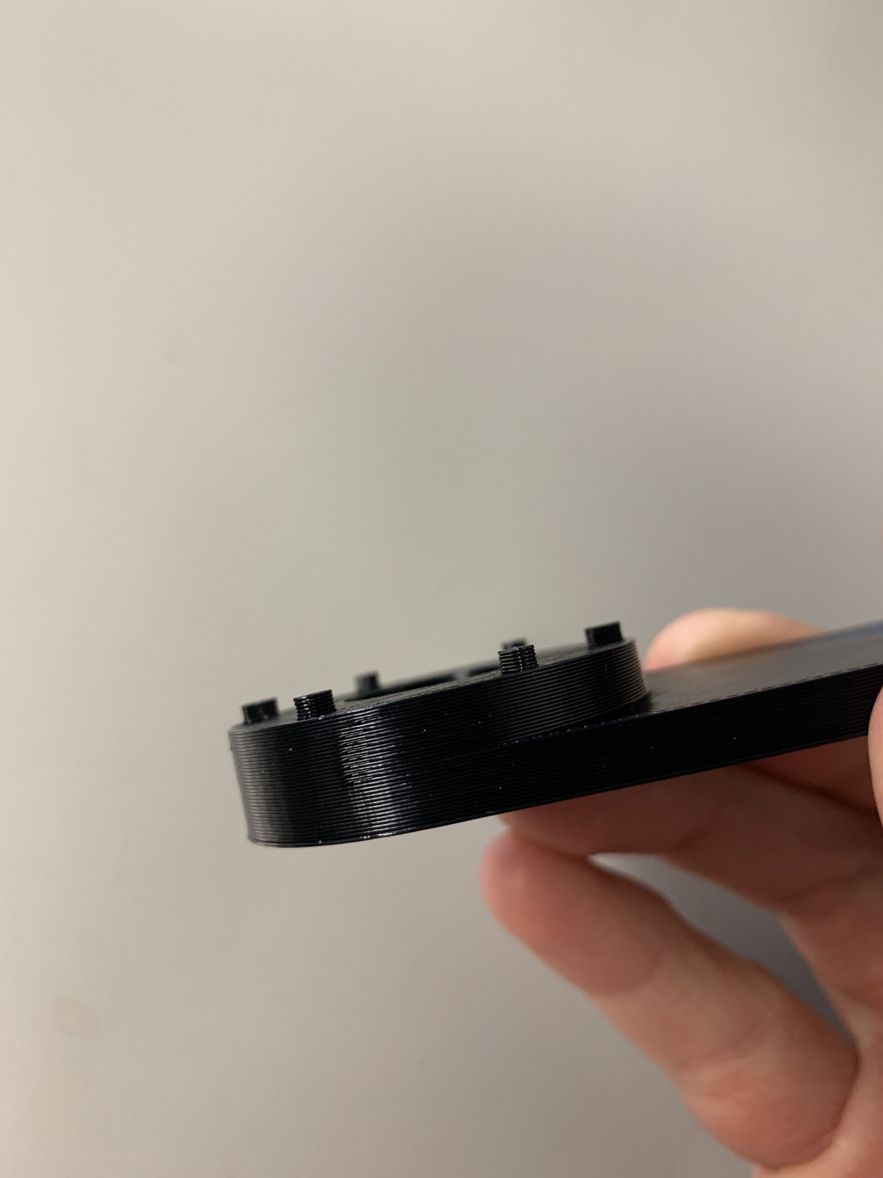

Hmm, print orientation is pretty important here. Stacked layers like that are likely to shear off when higher torque is needed to open a case. If it can be printed on it's side, that should be stronger. Supports may be needed, or breakaway fillets.

I suspect it is a lot easier to print in this orientation. If the shear is in fact an issue, it may be possible to reinforced them by driving in (and countersinking) metal pins.
Only one way to find out! Usage and time will tell. Testing free equipment/tools is less stressful than buying them ha ha.

The orientation of the fiber in the part tell me where is gonna break since you apply a rotation on the pin.
Since you created the file (BTW, the design looks very nice) you can print the part with service like shapeways in metal (they have several option).

Bit off topic - I would be careful using Omega logo, no matter if it´s only for own use.
5,501
9,399
It is the greek letter 'omega'. Does Omega really have the rights over anyone using the letter 'omega'? I've seen omegas on many objects over the years.

As long he doesn't make money out of it, he should be fine.
Yeah, the Greeks gonna come after you for the $$$ 😲

So, does it work, especially on a tight back? 3D printing is cool and all that but if the product isn't strong enough to do the job it isn't of much use. Let's see some action shots!

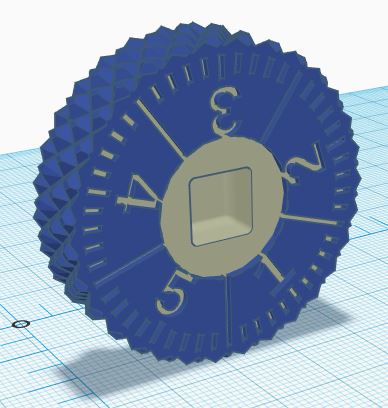

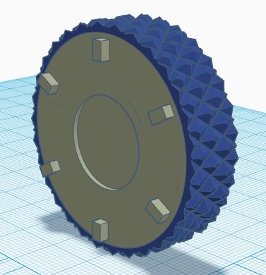

Just for fun, I remixed the wrench with a couple of modifications. First is making it round with edge-knurling instead of a lever-arm. Second is adding a 3/8" socket/torque wrench drive hole in the back side if additional leverage is needed. The indexing on the 'top' came with the example I used for the knurling, so I left it in case it's useful. It's not fit to print in this orientation without supports, but if anyone is interested they can have it.
[Disclaimer: I do not have a 3D printer and have not used this on any watch. Print & use at your own risk.]
