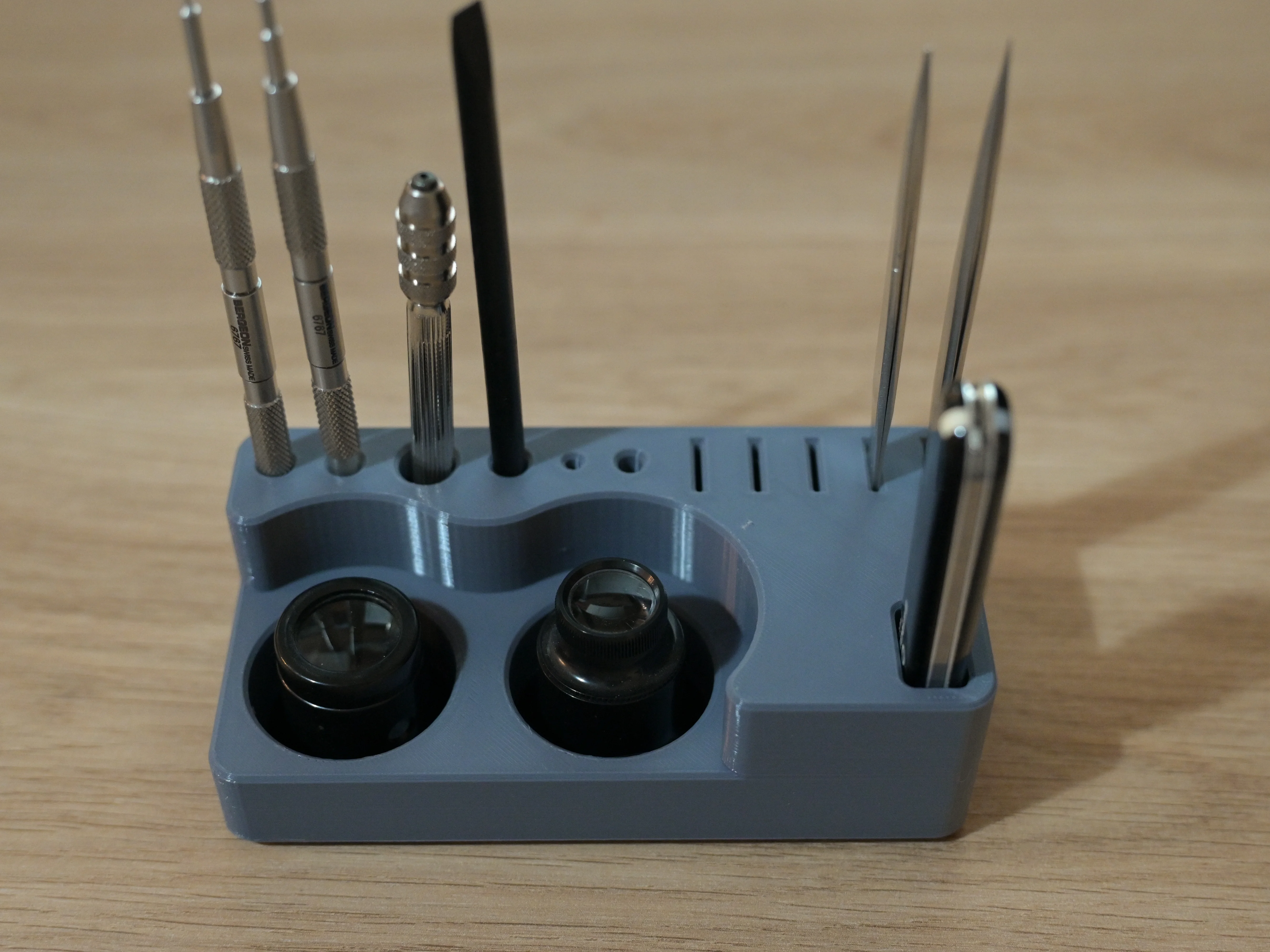

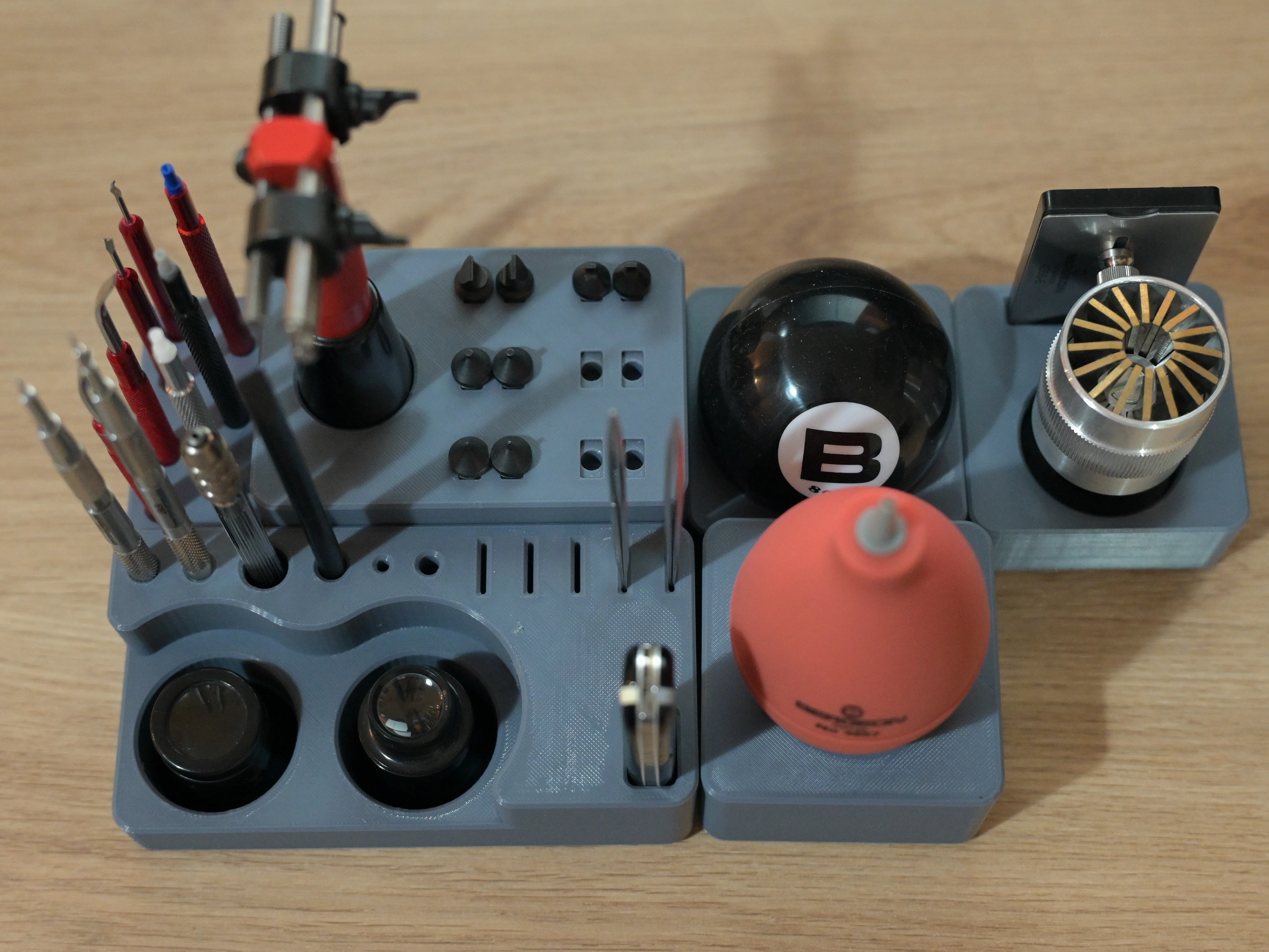

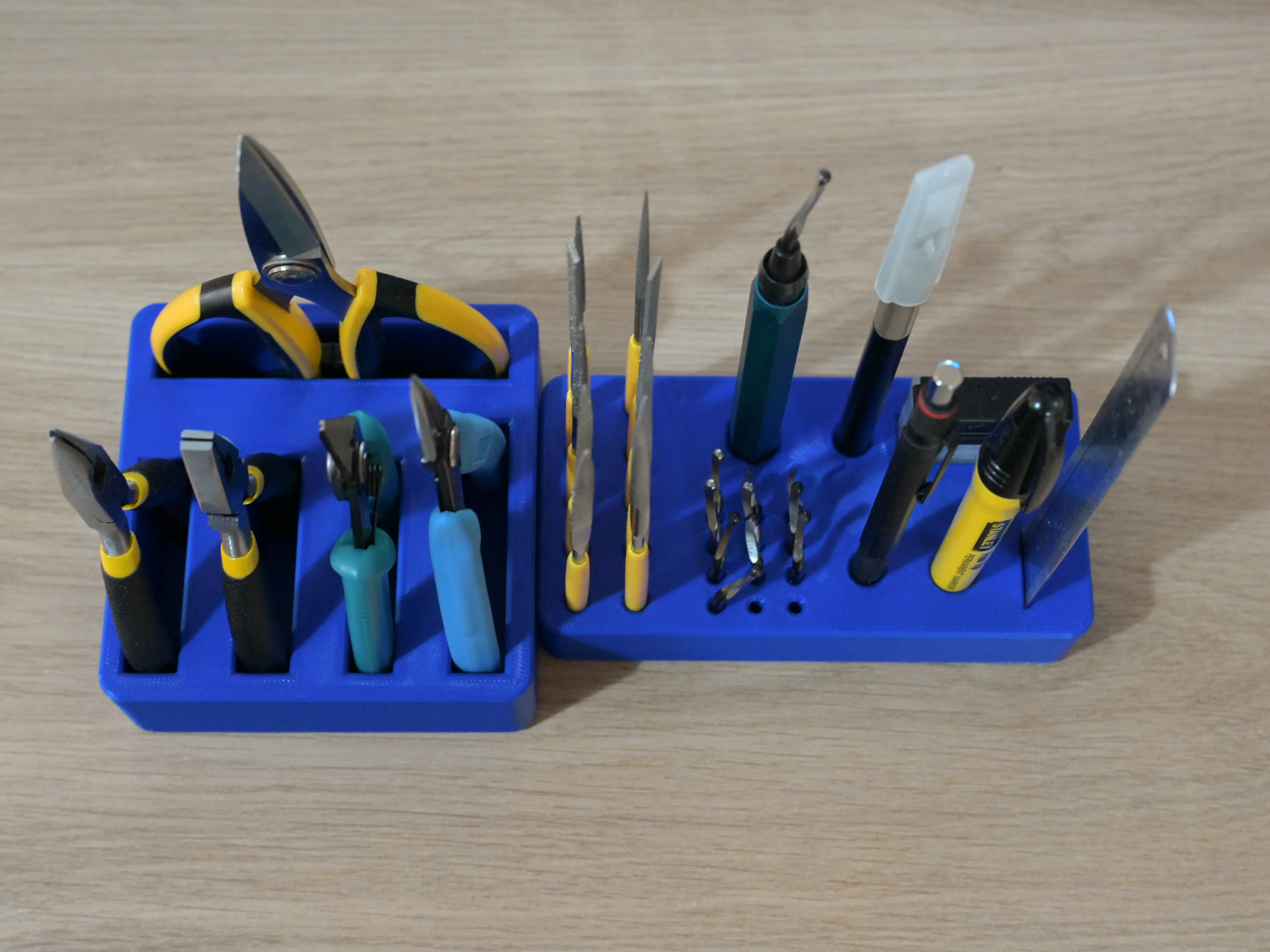

Hi all. I've been slowly building my watch tool collection over the past year or so, and it was time to get them out of that mess of a drawer and into some custom organizers. Went for a 35x35mm grid, so each dimension is a multiplier and they can fit tightly against each other. I may explore in the future stuff like gridfinity, depending on how it grows and evolves. For now I'm mostly exploring a good way to have the panels interlock on any side (without magnets!), so that I have the flexibility of a panel for each tool, but also group them into bigger sets.
Of course, ideas are more than welcome. If someone, for whatever reason, needs STL files, I can happily provide them.

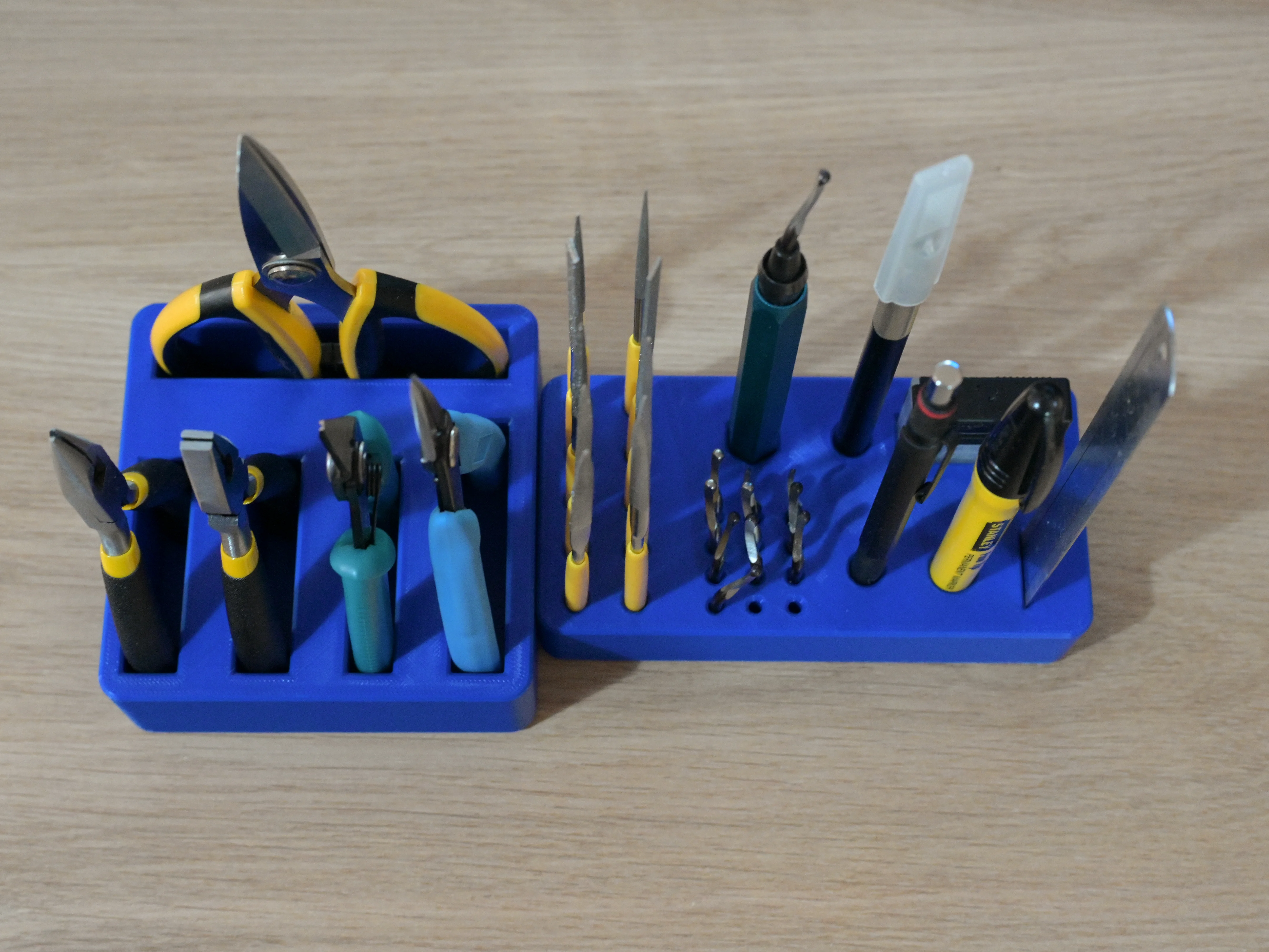

Nice馃憤 I've done these for my machine shop:
I should have made more pockets in the big one.... 馃榾

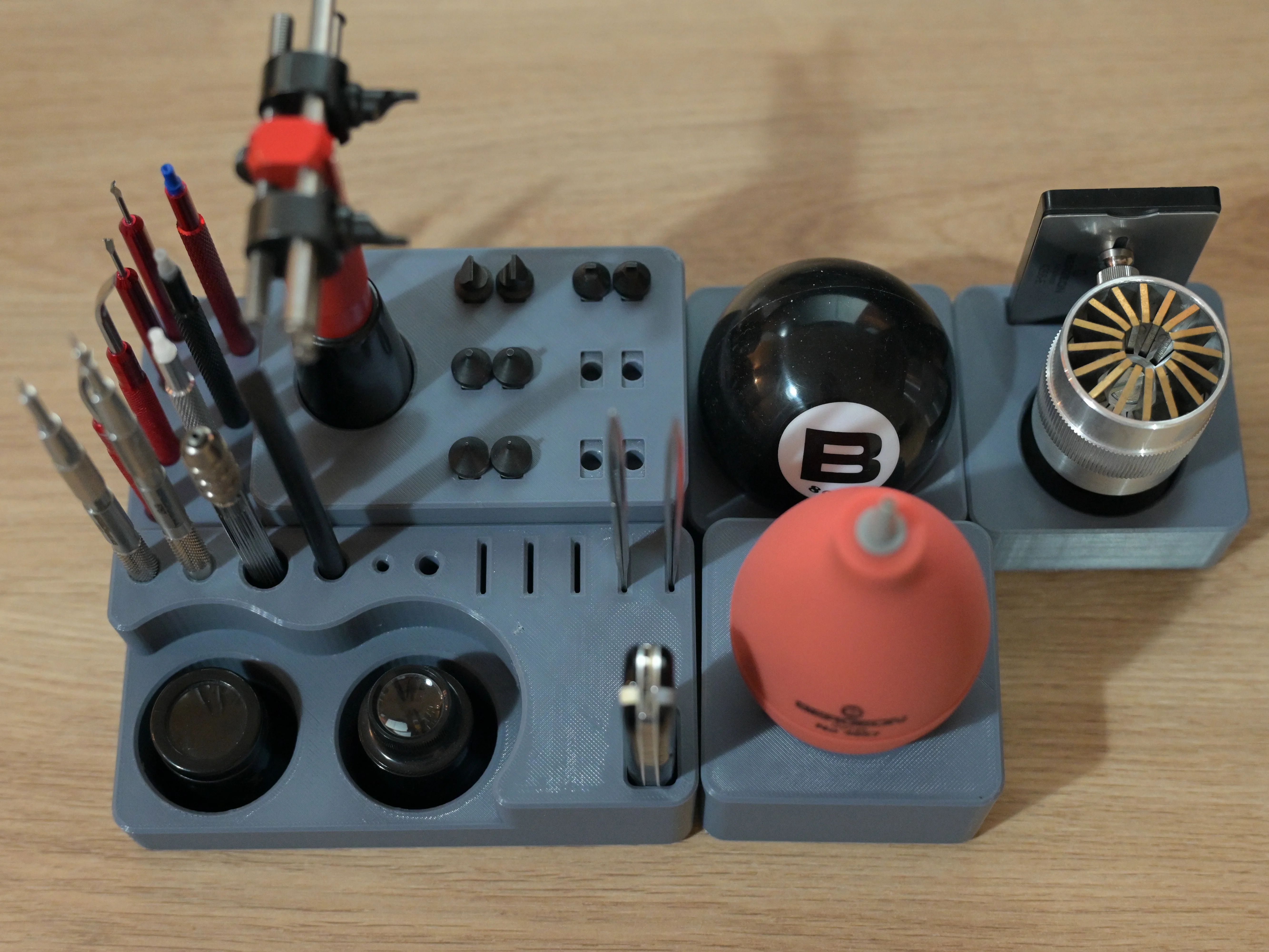

I love this. i have a rotating screw driver holder that i use, but man, I could easily use some of these for other parts. Would you mind sharing the STL? I'd be happy to donate to the cause and ease the burden of design.

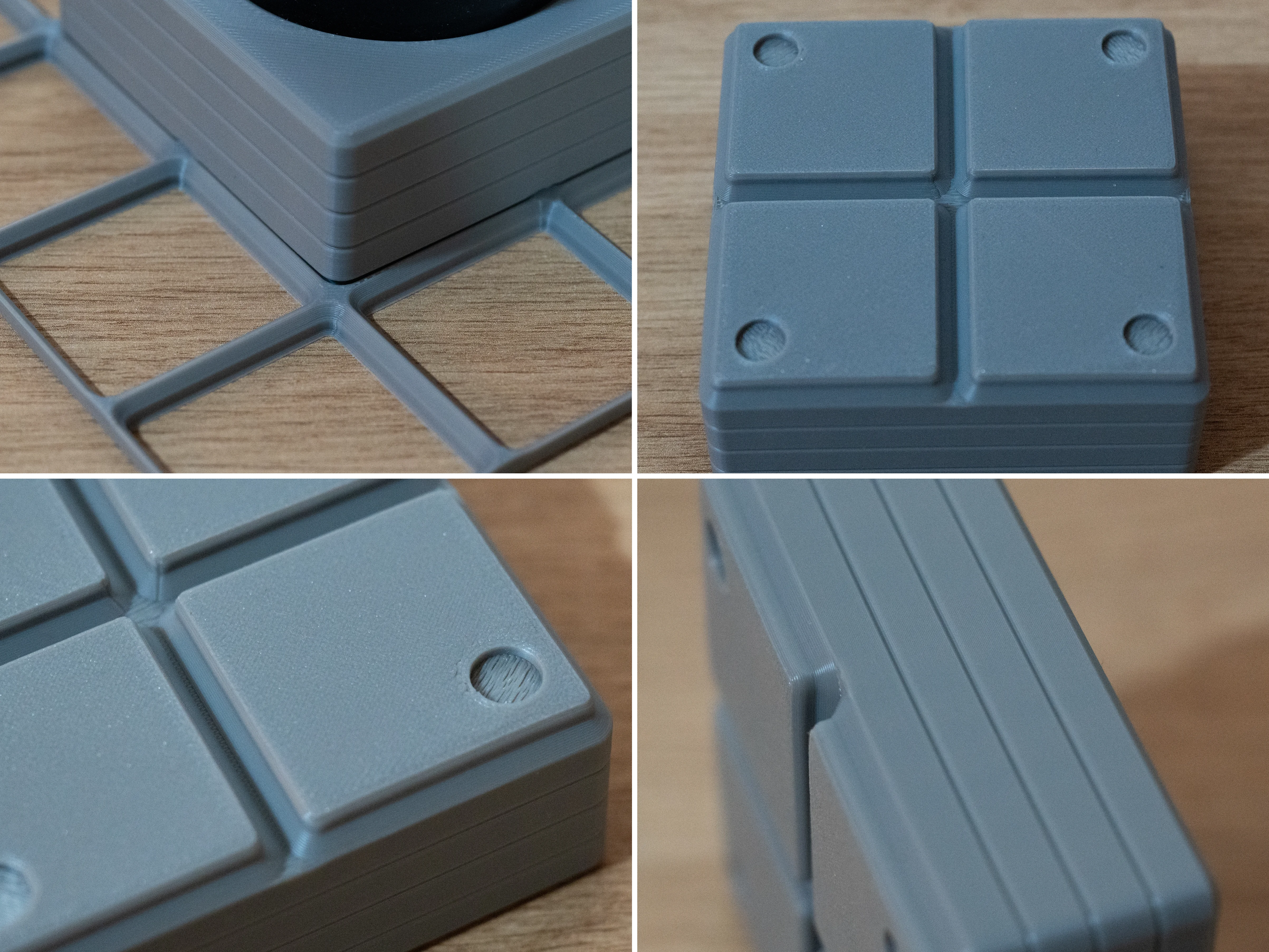

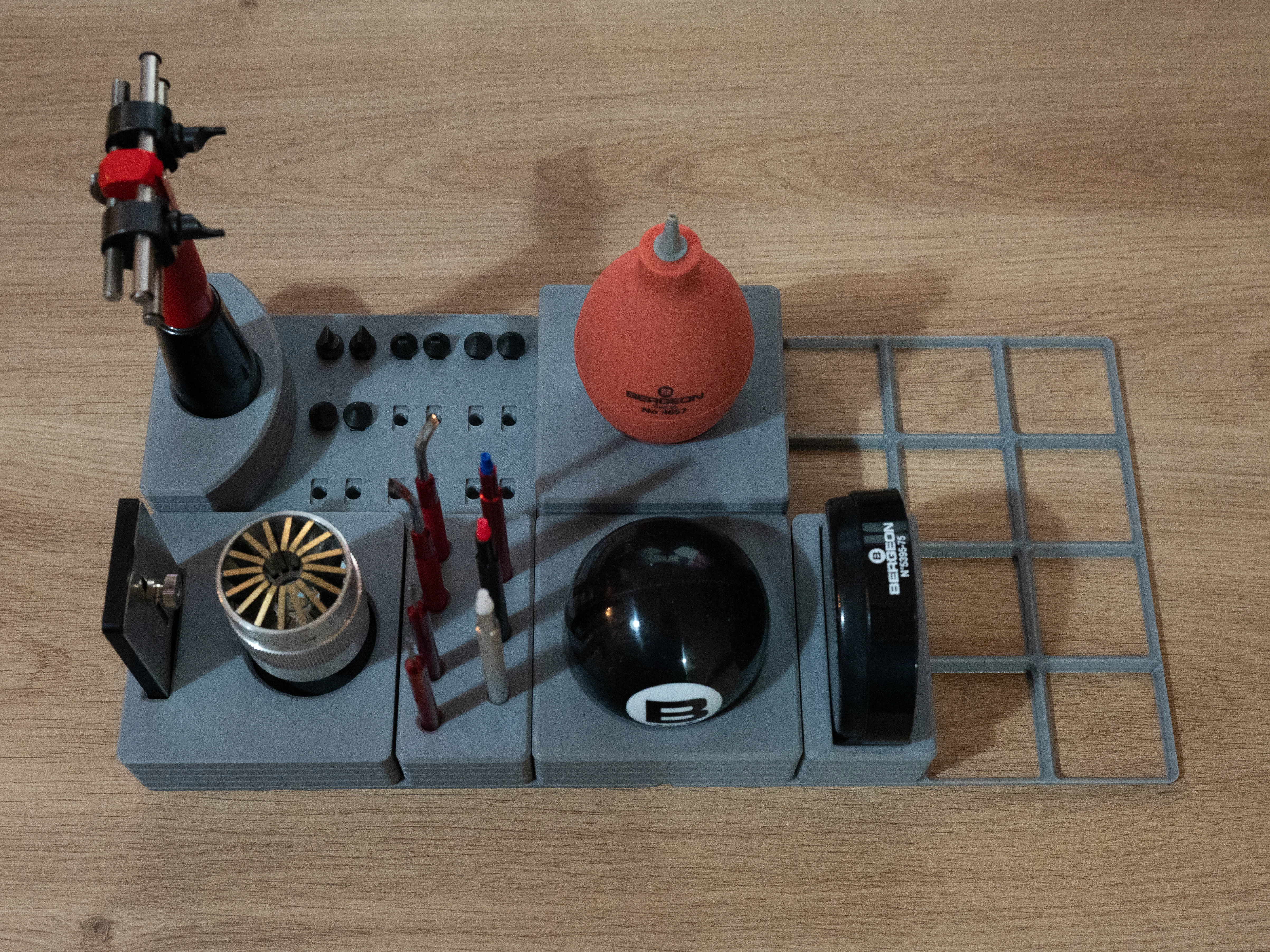

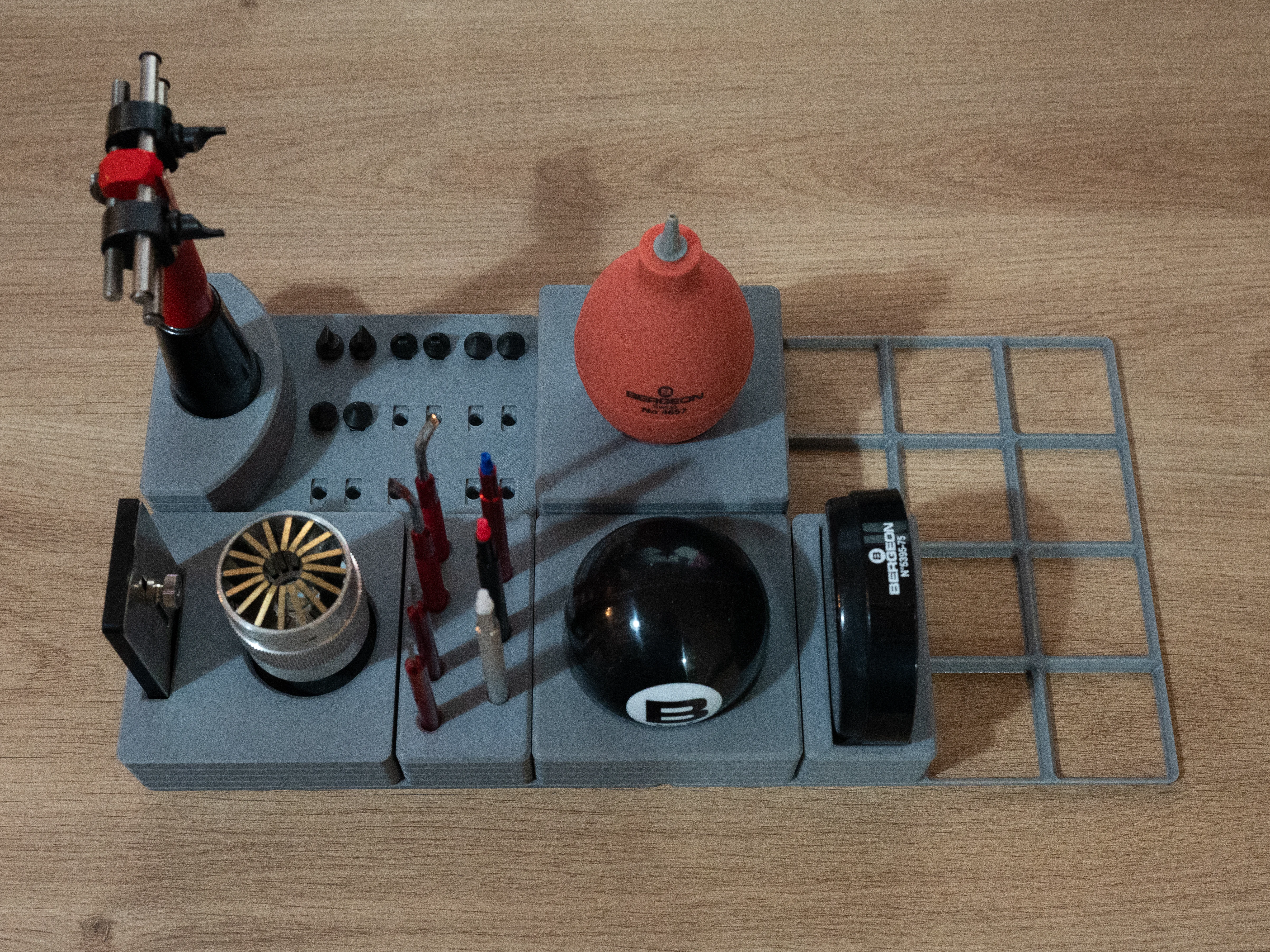

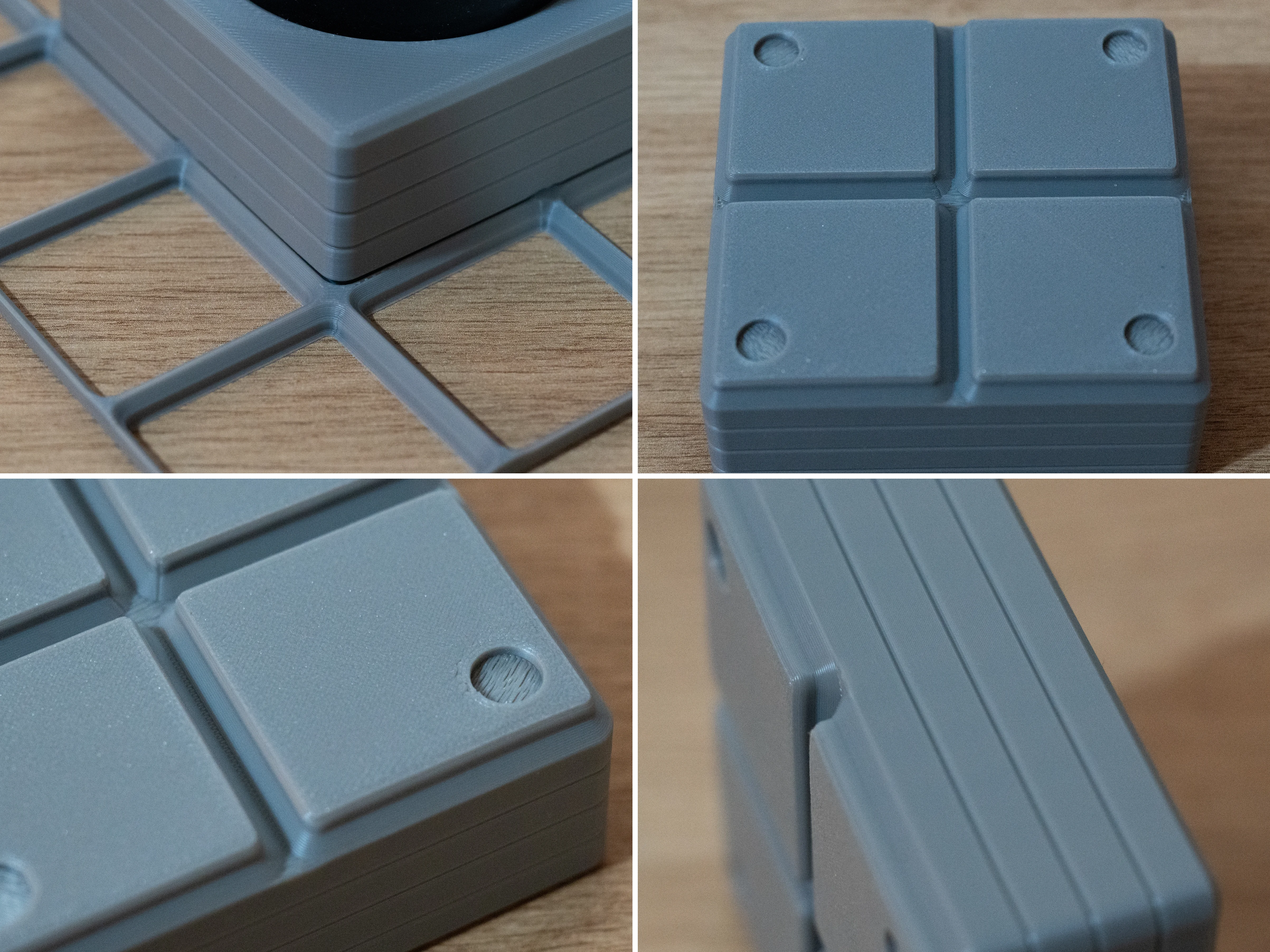

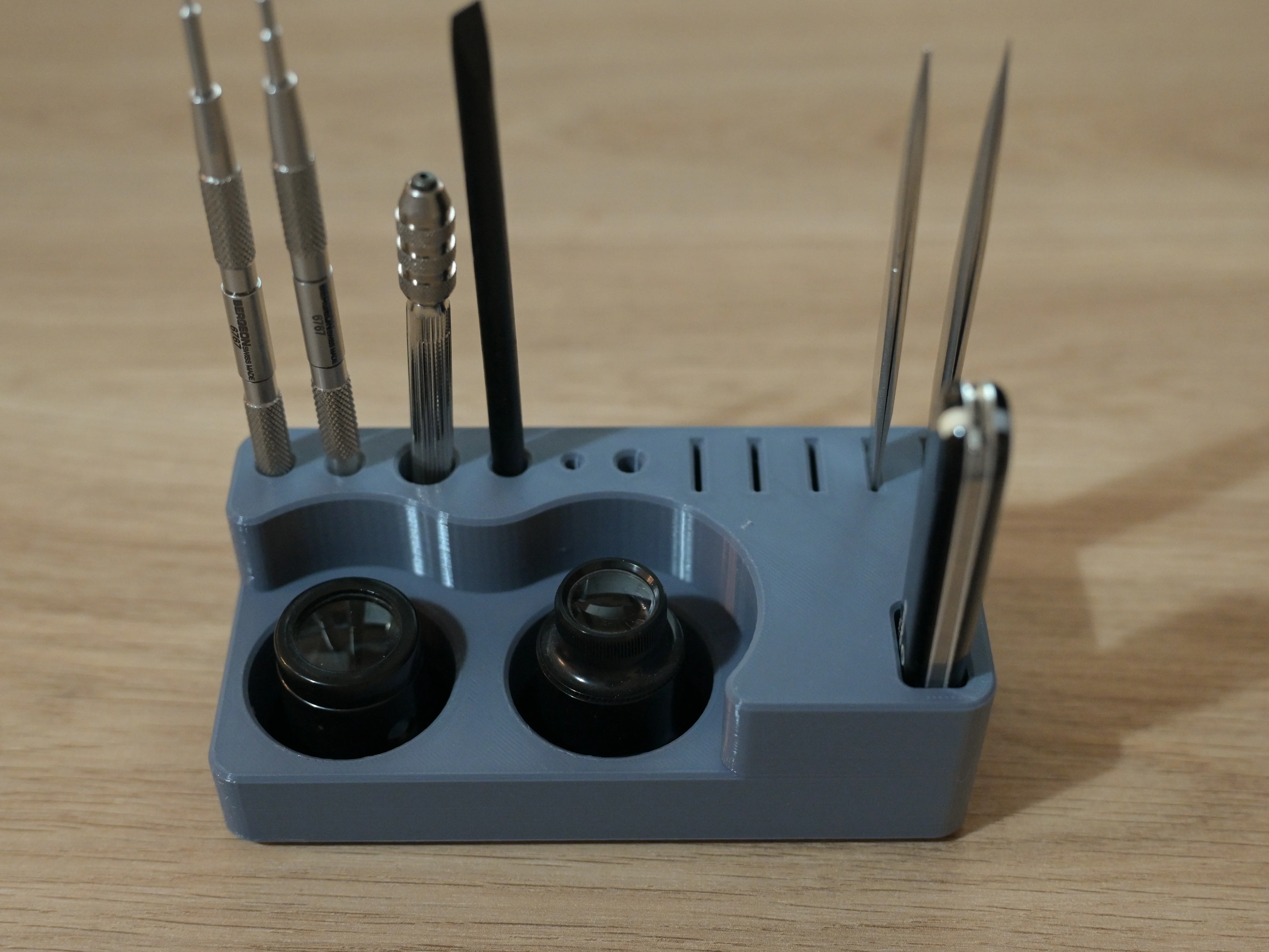

Redesigned the organizers to be Gridfinity compatible. I thought I wouldn't need to, but after using them for a while and having them move around when picked up, I changed my mind. It adds material, but it's a better system overall. To sum up the changes:
  • Gridfinity compatible: 42x42mm with a height that's a multiple of 7mm.
  • Holes at the bottom for 8mm silicone bumpers. These play no role in the grid, but are useful when moving the boxes to a work area.
  • Channels around the perimeter both for aesthetics and for added grip.

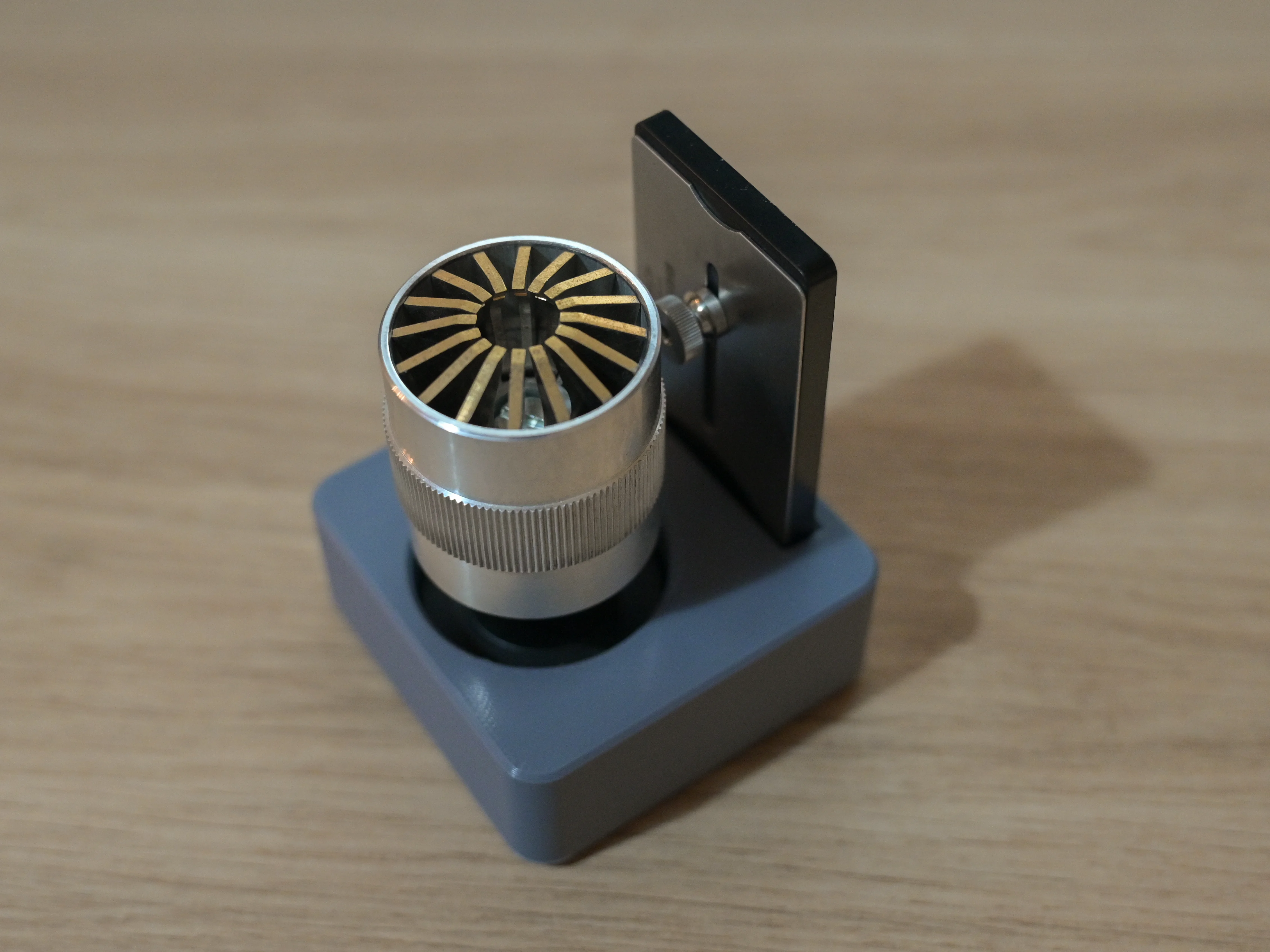

Since I can't upload STL files here directly, I'll try to upload them in MakerWorld so anyone that wants them, can easily download them. In the meantime, you can drop me a PM with your email, and I'll zip them to you. The organizers for the few tools I (currently) have:
Bergeon 8008 rubber ball
2x2x4. A loose fit so it can be picked up without taking the box with you.
Bergeon 4657 dust blower
2x2x5. Also a loose fit as it tends to stick.

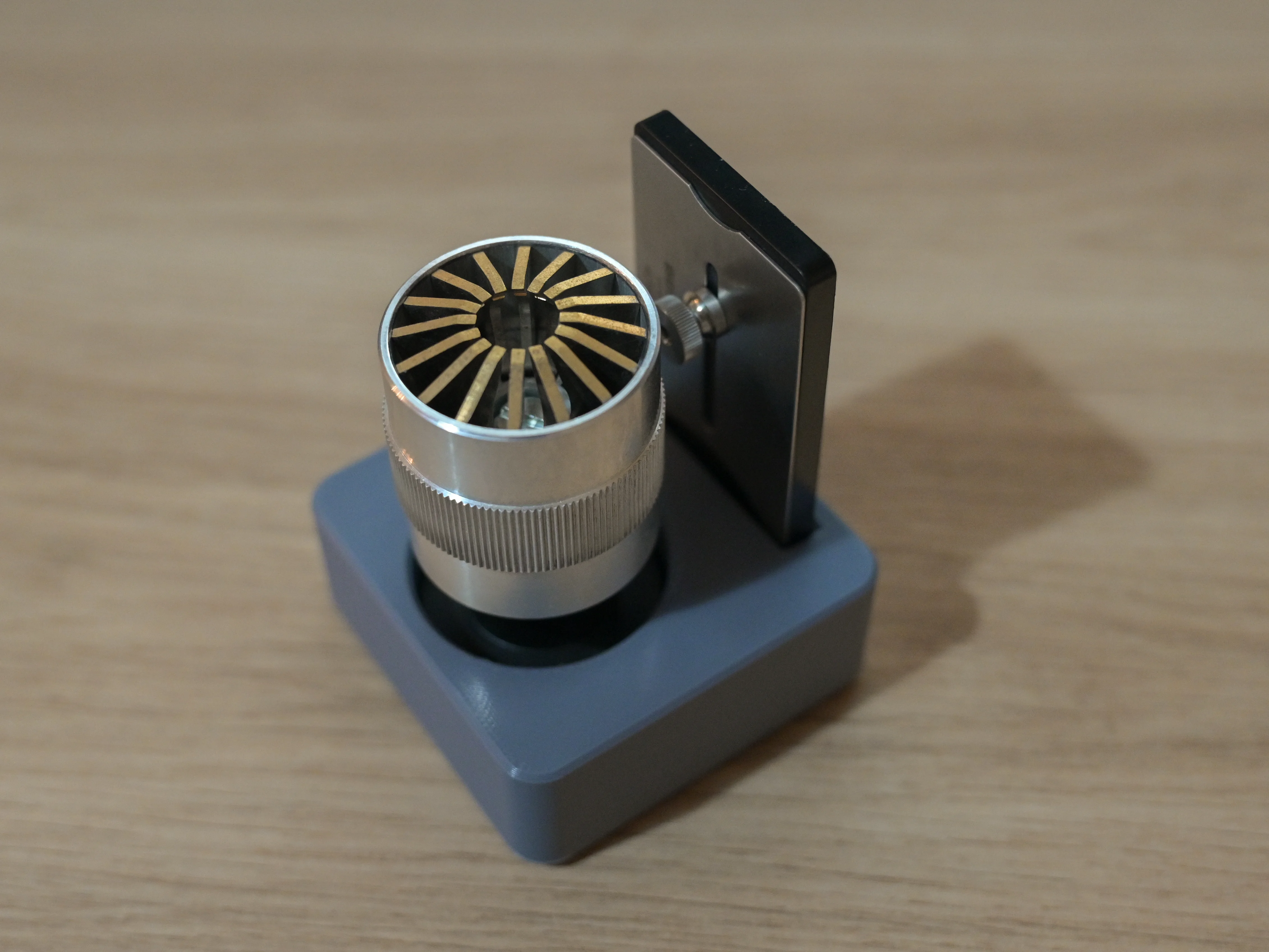

Bergeon 4266 crystal lift
2x2x4. The lift tool with the standard plate (4266-E). I may redesign if I acquire another plate.
Horotec MSA07 case back opener
2x3x6. Holds 9 pairs of pins.
Bergeon 5395-75N cushion
2x1x4
720
2,109
Silly me, it appears I can upload zip files. Attached is a zip with the STL files of the 5 boxes mentioned in the post above and an additional one I have for hand presses and levers. The latter are non-brand, specific sized ones that will probably not be that useful to most people.

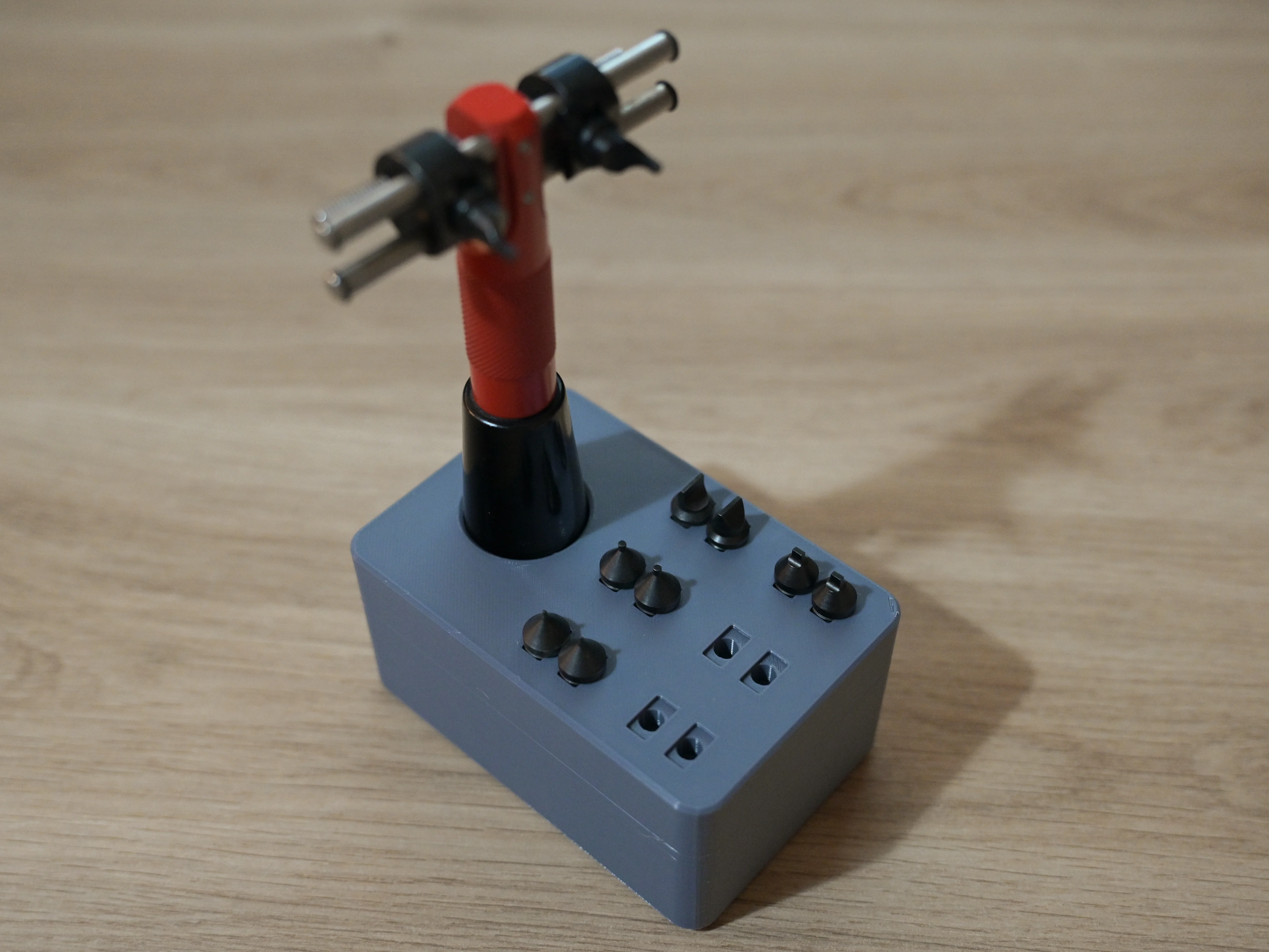

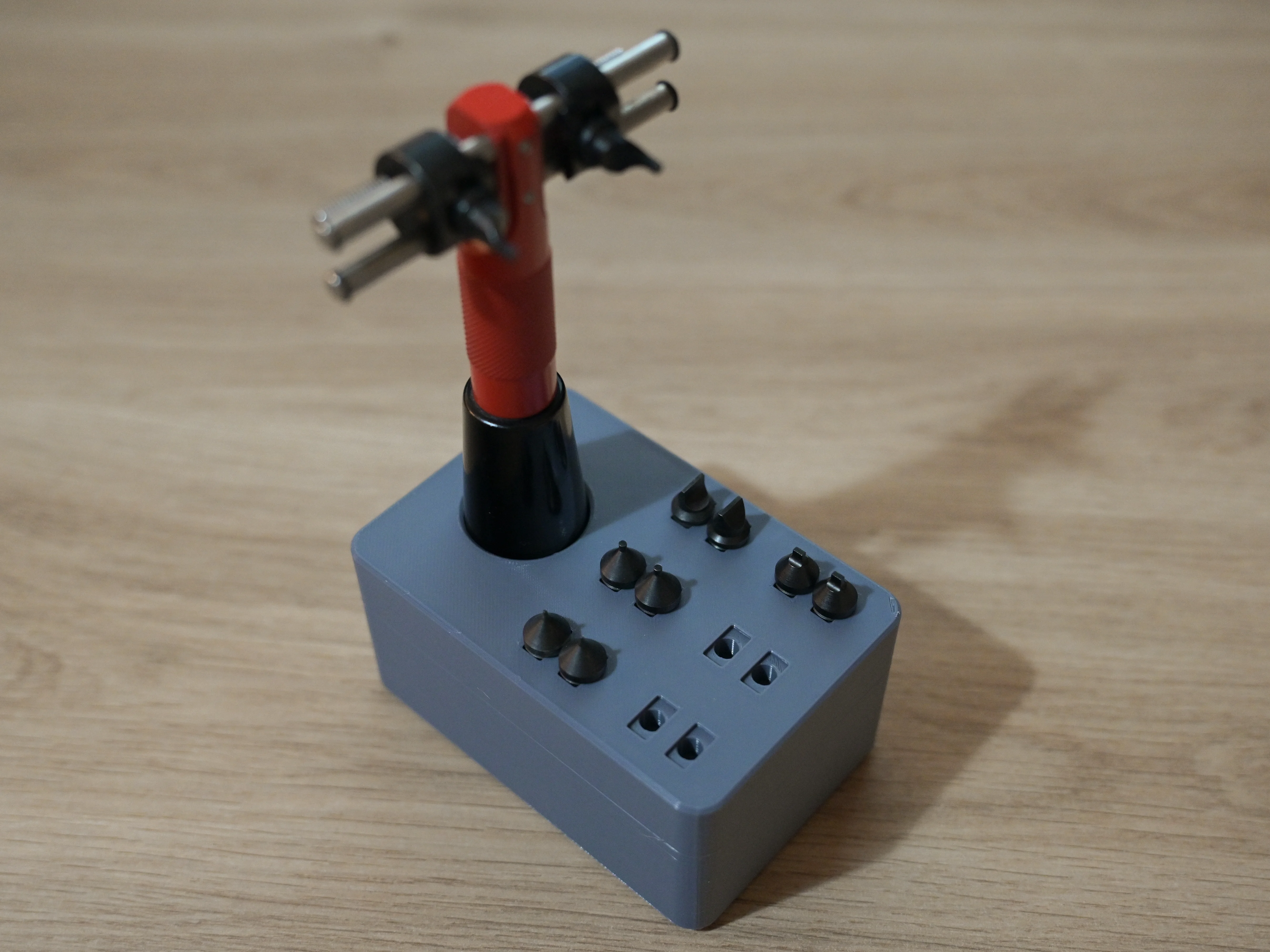

And for the Bergeon 30081-S rotating screwdriver holder with 2x2 gridfinity base
Nice stuff. I have a 30081 in the mail so will be needing it shortly.
