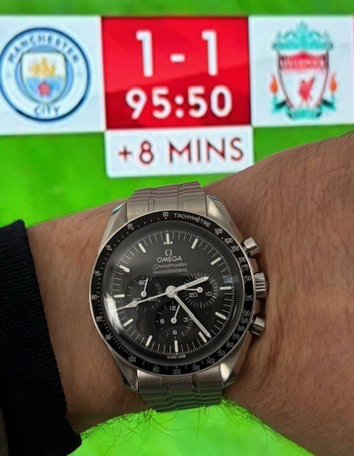

Further to my last post above, I just thought I would provide an update on my watch and see if anyone else had had anything similar.
After my watch had been serviced to rectify the issue of the watch stopping (4 weeks with Omega) and then returned immediately because the hands were not aligned when it came back (6 weeks with Omega), I finally got my watch back a couple of weeks ago.
I did a couple of simple checks such as power reserve on full wind (67 hours), running chronograph etc, no problems.
I then measured the accuracy a number of times over the last couple of weeks just using the WatchTracker App and unfortunately it is measuring +5.5 spd when it was previously +2 to 3 spd (in same position overnight, crown down). Which doesn't feel great.
But more worryingly I used my chronograph the other day whilst watching a football/soccer match to time the second half (just out of interest). I checked the watch as the game was coming to the end and noticed that the chronograph was registering about 3 minutes fast. I was genuinely shocked and took a photo next to the clock on the tv screen (see below). My watch reads 53 mins 43 secs against the time on TV of 50 mins 50 secs (ie 95 mins 50 secs minus 45 mins for the first half).
Has anyone experienced something like this, or have any advice?

I’ve never had a chronograph run fast - just slow usually because of chrono lag. Try rerunning the test but against your stopwatch on your iPhone. Check it periodically. My experience with Speedys, vintage and new (I have 13 of them, ranging from 321s to 1861s, is the chrono runs spot on with the main hands.
I've never heard of this happening before either, and am genuinely confused.
I have tried to replicate the occurrence twice using my phone stopwatch, for similar amounts of time, at similar times of the day (so it is the same length of time after I wind my watch fully when getting out of bed, every morning) - even to the point of physically jumping up to punch the air in celebration, to replicate Liverpool scoring, just in case such physical movement may be a cause (yes, it may have been more forceful than Apollo 11). But the watch reads correctly. I was that shocked by discrepancy that I took that photo whilst the game was still playing - in case I was misreading it in the heat of the moment.
I even replayed the match (having recorded it live) and timed the duration in case the TV channel clock had faltered - but it hadn't.

Regarding accuracy maybe test by winding the watch to full stop, lay it away for 24 hours dial up, check the gain/loss and same again for the other 5 positions and calculate the average. I'll bet it will be within 5s.
Yeah, you're right, I thought that too, but maybe not so stringent. I have recorded it in 6 positions when I take it off at night, giving the following:
12U 1.1 spd
6U 6.8 spd
3U 4.8 spd
9U 2.7 spd
DU 5.5 spd
DD 5.8 spd
Ave = circa 4.5 spd
Granted this is not particularly scientific, but it is consistent insomuch as in all instances the watch is laid down at 11pm and then measured at 7am (and then fully wound straight after). I'll maybe try your suggestion and set the watch in each position for 24 hrs after fully winding, to see if their will be much difference. I am also now laying my watch down in the 12U position at night to counter some of the daytime rate of over 6 spd (assume due to general movement and my wrist position on my desk/keyboard/scratching my jacksie all day long)
However the main point remains - real world wearing used to be a very happy 2 to 3 spd. And now, after the service, the real world is a deflating 5.5 spd. First world problem, but still....

One further point, when I measured the watch immediately after noticing the chronograph had gained time, it showed that the watch had gained 2.5 seconds since the last time I'd taken a measurement, 3.4 hours earlier - which equates to a rate of 17.6 spd. A bit concerning overall.

The 3861 has had a few cases where moving your arm around can cause the minute recording hand to jump, so that's likely all it was.
7
As stupid as this may sound, that's a bit of a relief - I was starting to second guess myself.
I know this may be difficult to say but, is that generally something to be expected, if I'm jumping around celebrating? It was a good goal, but I wasn't exactly going into orbit.
