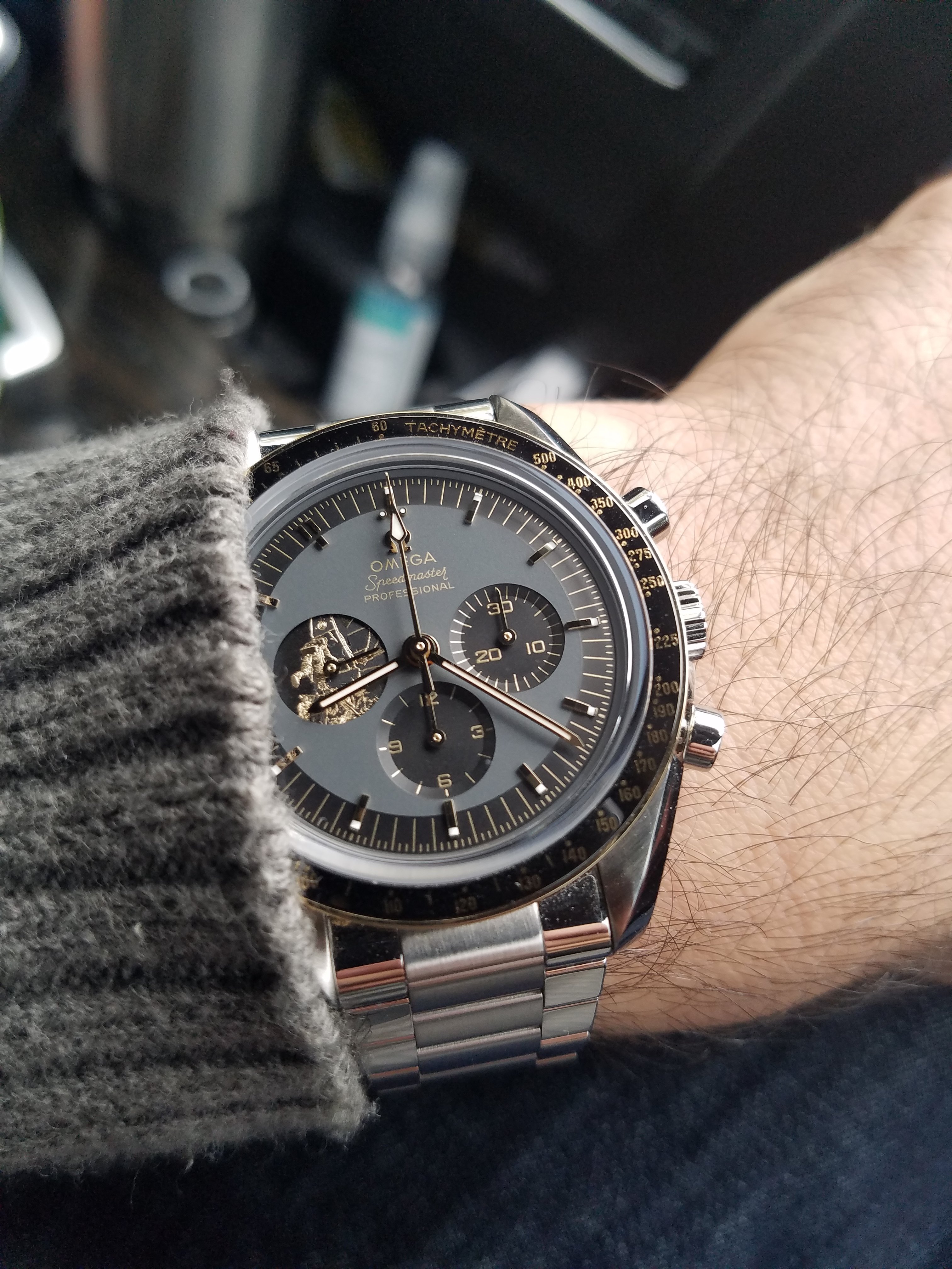

I've been obsessed with watches for a while and have read many threads on this forum and finally decided to give input after your post. I've had the moon watch (ref xx.005) but just recently bought the 50th anniversary with the new movement. I've worn it for 2 weeks straight so far, and absolutely love it. As far as comparing the 2, it is more accurate as we all know. The only negative so far I would say, it's tighter/a bit harder to wind. Anything specific you wanted input on?
Beautiful shot

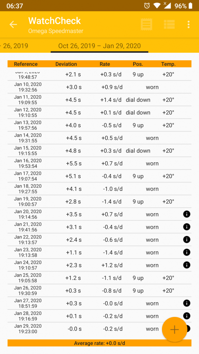

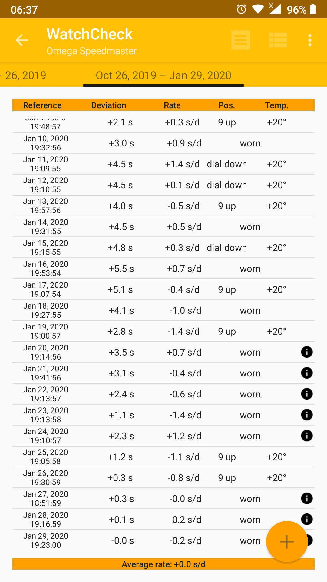

Al, I’ve had mine for a couple months and it’s a precise timekeeper within +1. As subjective as it is, it seems to be a solid movement that seems to be of better quality than my Pro with the 1861
5,995
28,697
After setting time 3+ months ago gain/loss yesterday was back to zero, incredible.
