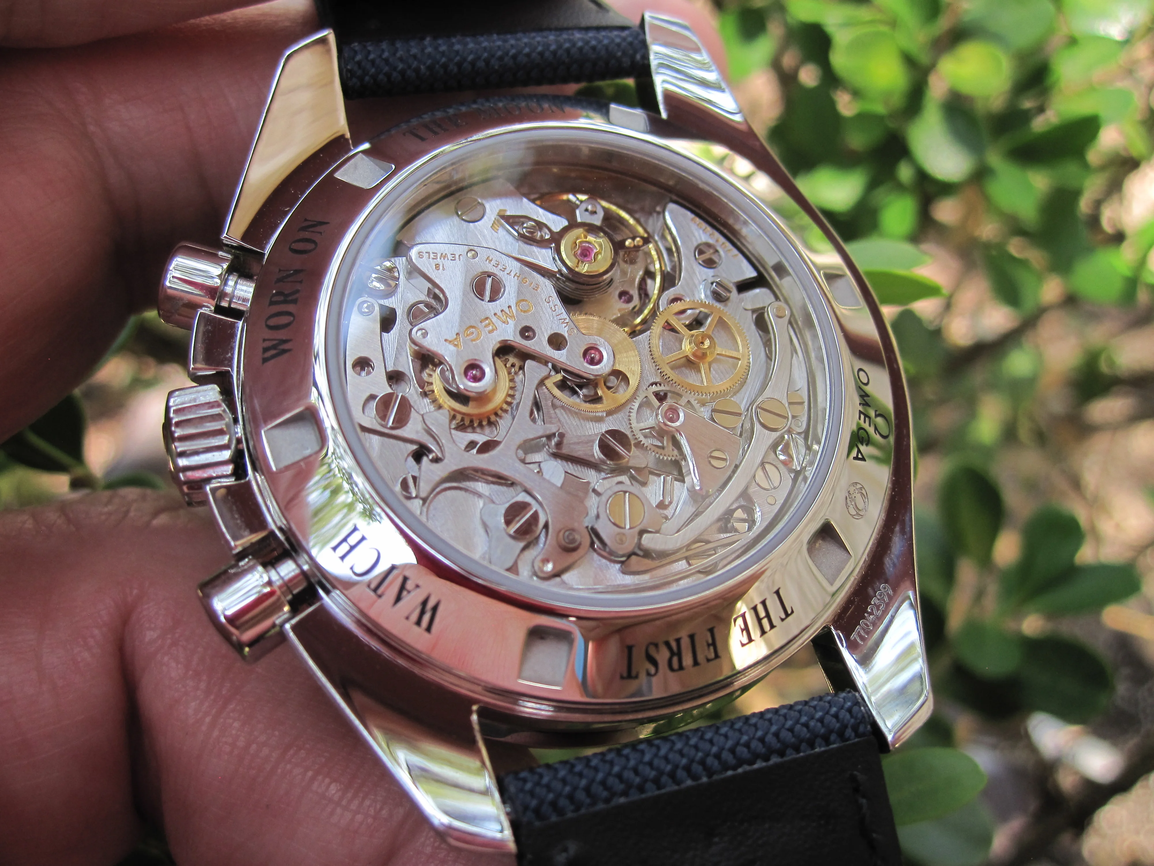

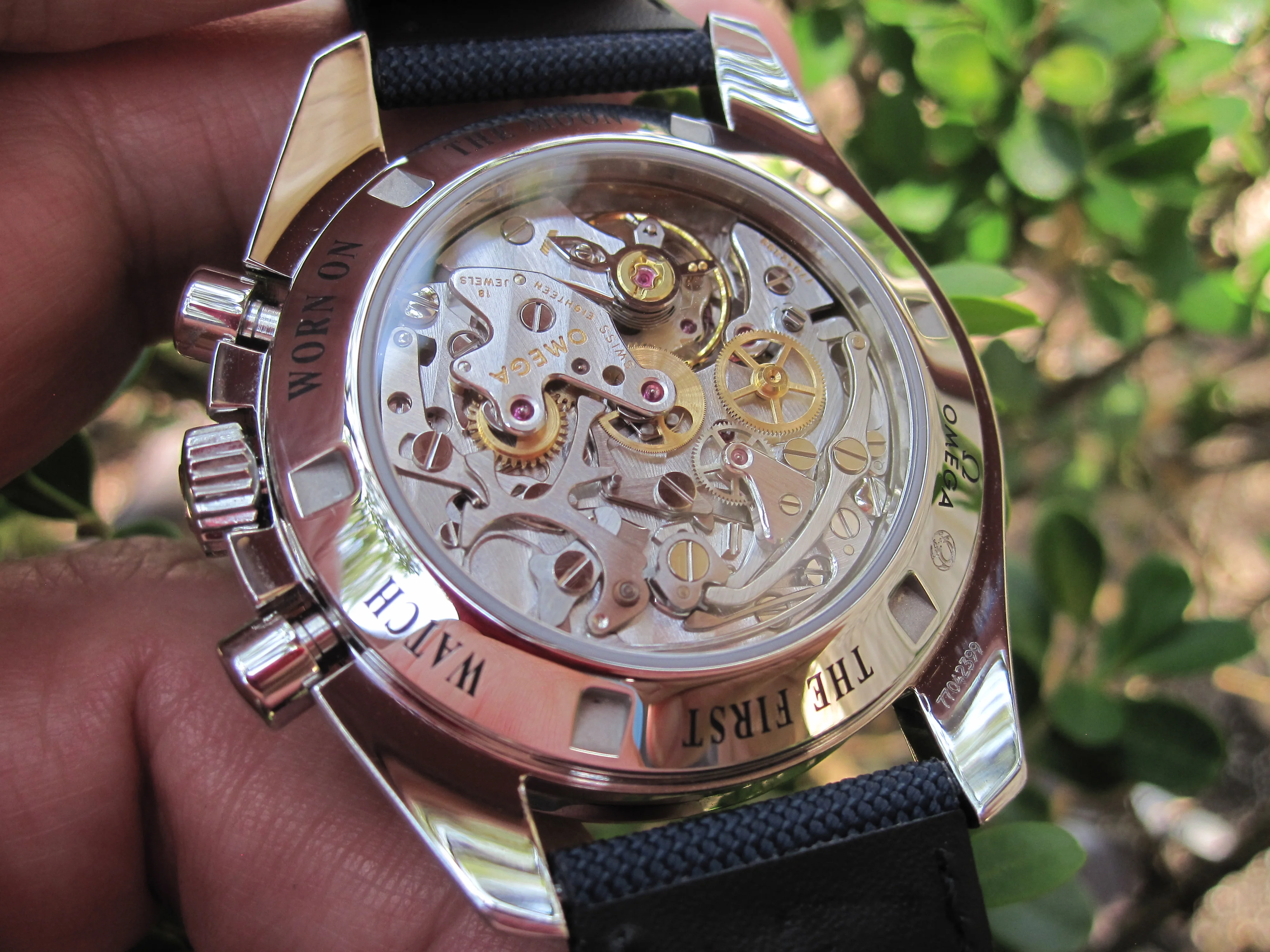

7,789
14,387
Comparing the new 3861 with an 1866 from around 2002 (same as the 1863 but with date/moon), the 1866 has a smoother, more polished look to the bridge surfaces and the anglage looks hand done. With the 1861 its obviously all machine done, and it's pretty obvious even with the naked eye. Mosso's observations noted above are pretty much spot on. Both are nice to look at but the 1863/66 versions are better finished. The one here was rebuilt and overhauled by Adam Lewis in Perth in 2021.
