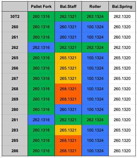

Hello Archer.
Thanks for the above information, which at first I was quite confused by and so I went off researching those numbers. I had no idea that there were quite so many variants of the 30T2. This spurned me into downloading all the data sheets for these calibres plus others in the 30T2 family and compiling a table of the different combinations of pallet, staff, roller table and bal.spring (please see attached).
From this exercise, what has now become evident is that the early non para choc 30T2 version has a balance completely compatible with Cal. 262 and the Cal. 281. I verified this, as the omega data sheets for those two calibres show pictorially that the balance cock isn't installed with a shock protection device, whereas all other calibre photos did show the shock protection devices fitted.
It is a pity that the roller used on the 30T2 (non para choc) isn't fitted with roller part number 100.1324, as this is used quite commonly throughout the family of calibres (260, 216, 265, 266, 267, 268, 269, 280, 283, 285 and 285). Nonetheless I have now widened my chances of finding a suitable roller from just the 30T2 to now include Cal. 262 or Cal. 281 as well. Of course the alternative is to find an omega impulse jewel 100.1322 (or equivalent). I don't know how critical it is to have this exact jewel, or whether an alternative would suffice?
Once again thank you for your information which spurned me in the right direction with my research.
Kind regards,
Darren
Table of Omega 30mm Bal.Staff and Roller Compatibility.
Thanks to Skunk Prince for help.
70
59
