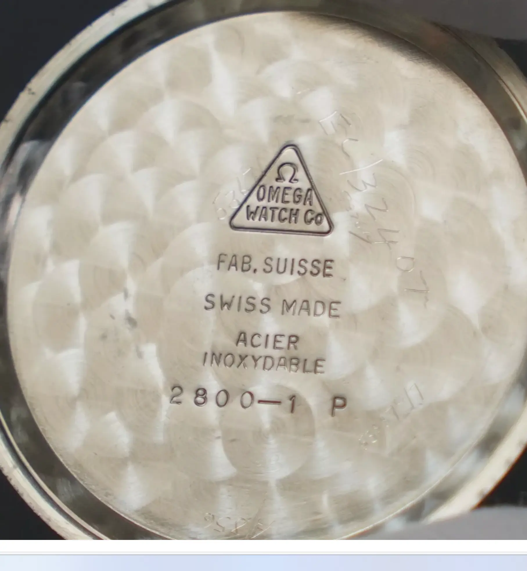

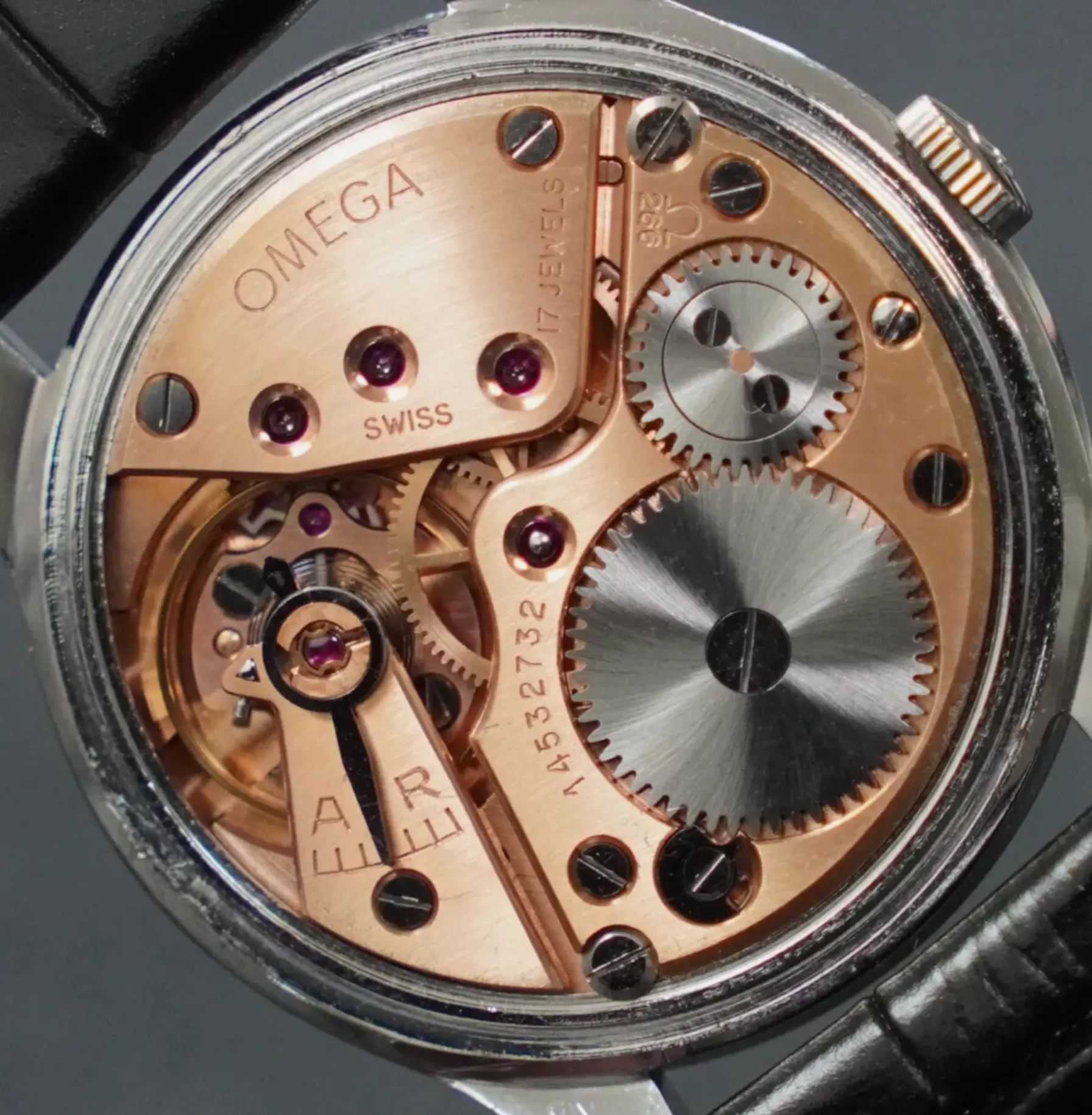

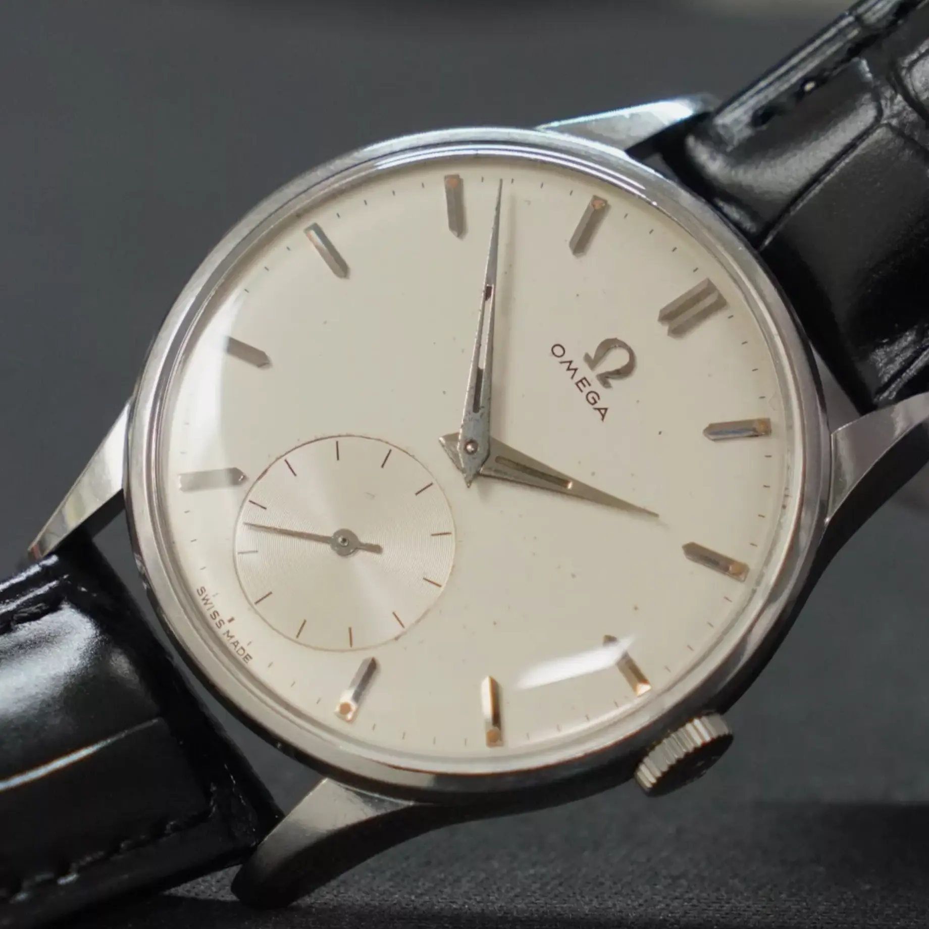

Apologies - Forums usually don't like pics as it fills up the server! I've put some of the key ones below;

  • IMO the strap does not affect the value of a watch at all. Just change it to whatever you like.
  • I don't think that is a redial at all, it looks good but the minute hand lost its lume.
  • The movement 266 is correct for this model and it looks good, all the teeth are there and not worn. It should keep good time (+/- around 5s per day) after having a properly service.

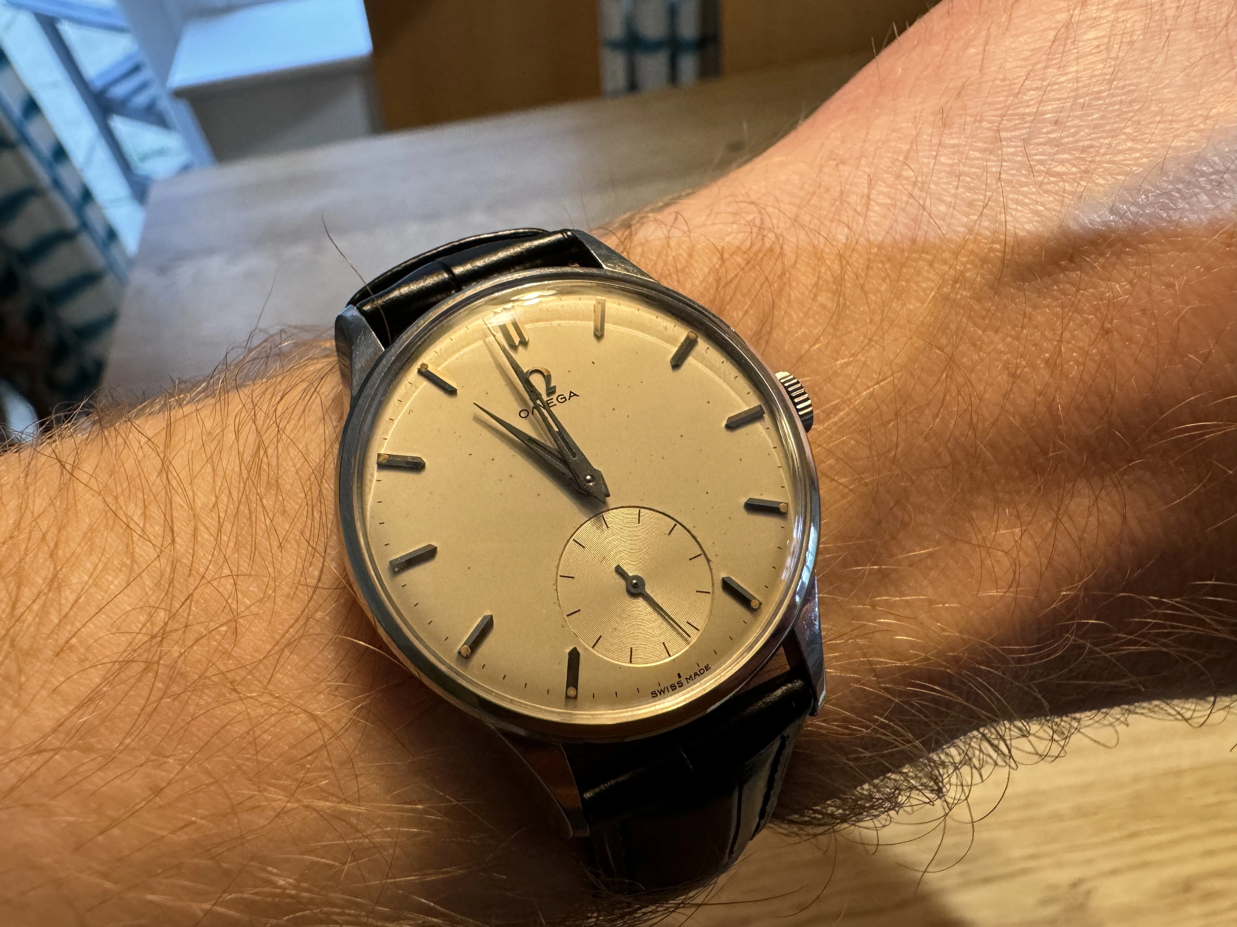

Follow up question now it's here - I can hear it ticking away when it's on my wrist. It's a quick tick as the second hand is sweeping around, rather than the normal tick from a quartz watch.
Some things online suggest an Omega making noise indicates its fake, other things suggest this a myth.
With a model like this, should I be worried?

It's not fake, mechanical watches make a ticking noise. Some are very loud, some you need to listen carefully. I think what the internet means to say is that the sweep hand generally moves more smoothly than a quartz watch, although it's not totally smooth if you slow down a video. Your movement beats 5 times a second, IIRC. Note, there are some rare mechanical movements that do move the sweep hand once a second.

it should ticks 5 times/second. It’s a mechanical watch, not a quartz watch. As long as you rewind it every morning, it should keep running. Nothing abnormal here

I reckon it's about 3 times a second it's ticking .
It's very nice either way! I'm used to wearing big 42 - 44mm things so quite like having something a bit lighter!

The beat rate of your call 266 is 5 per second (2.5 Hz), or 18,000 bph.

I'm counting the ticks but not the tocks!
